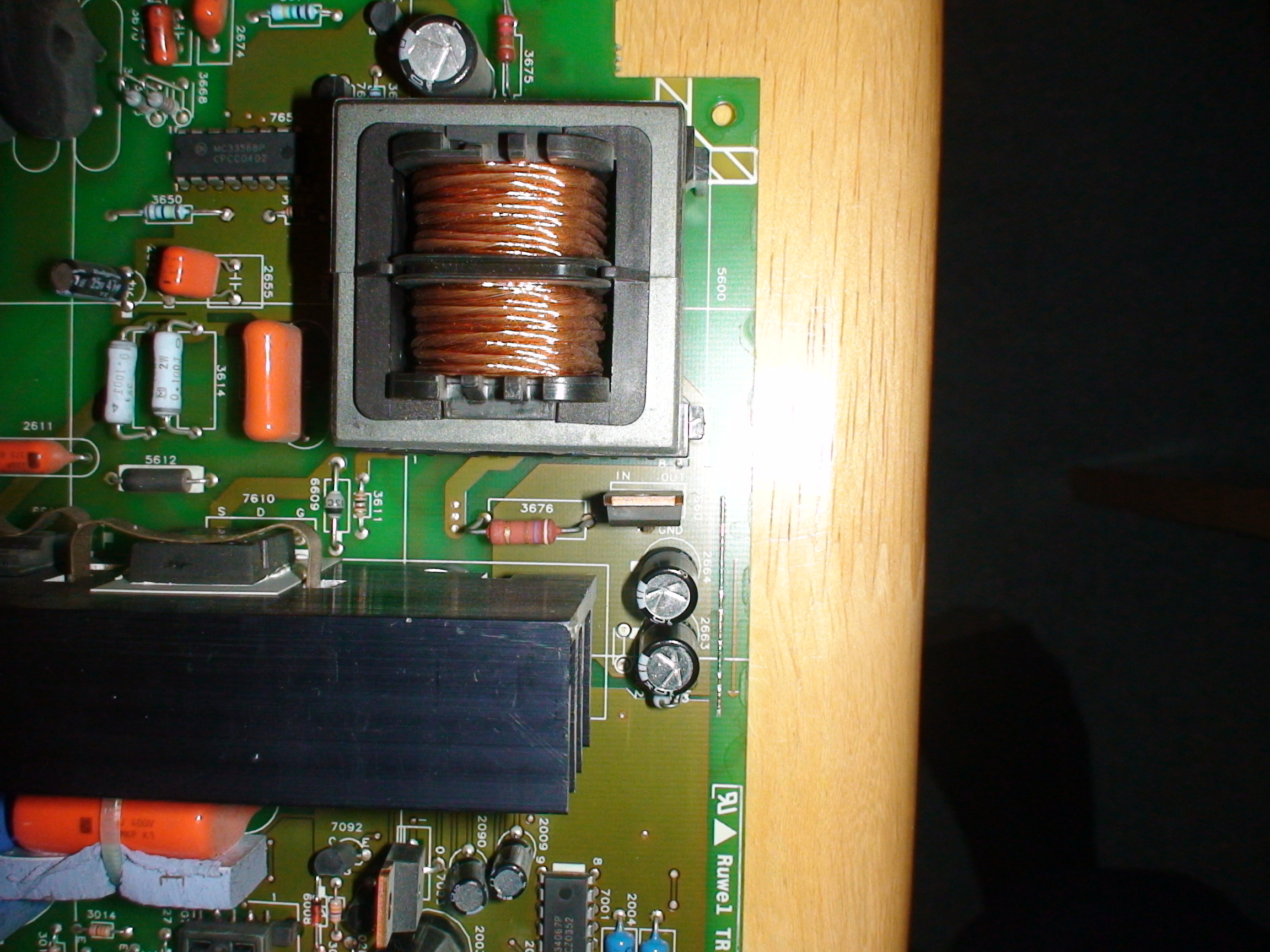

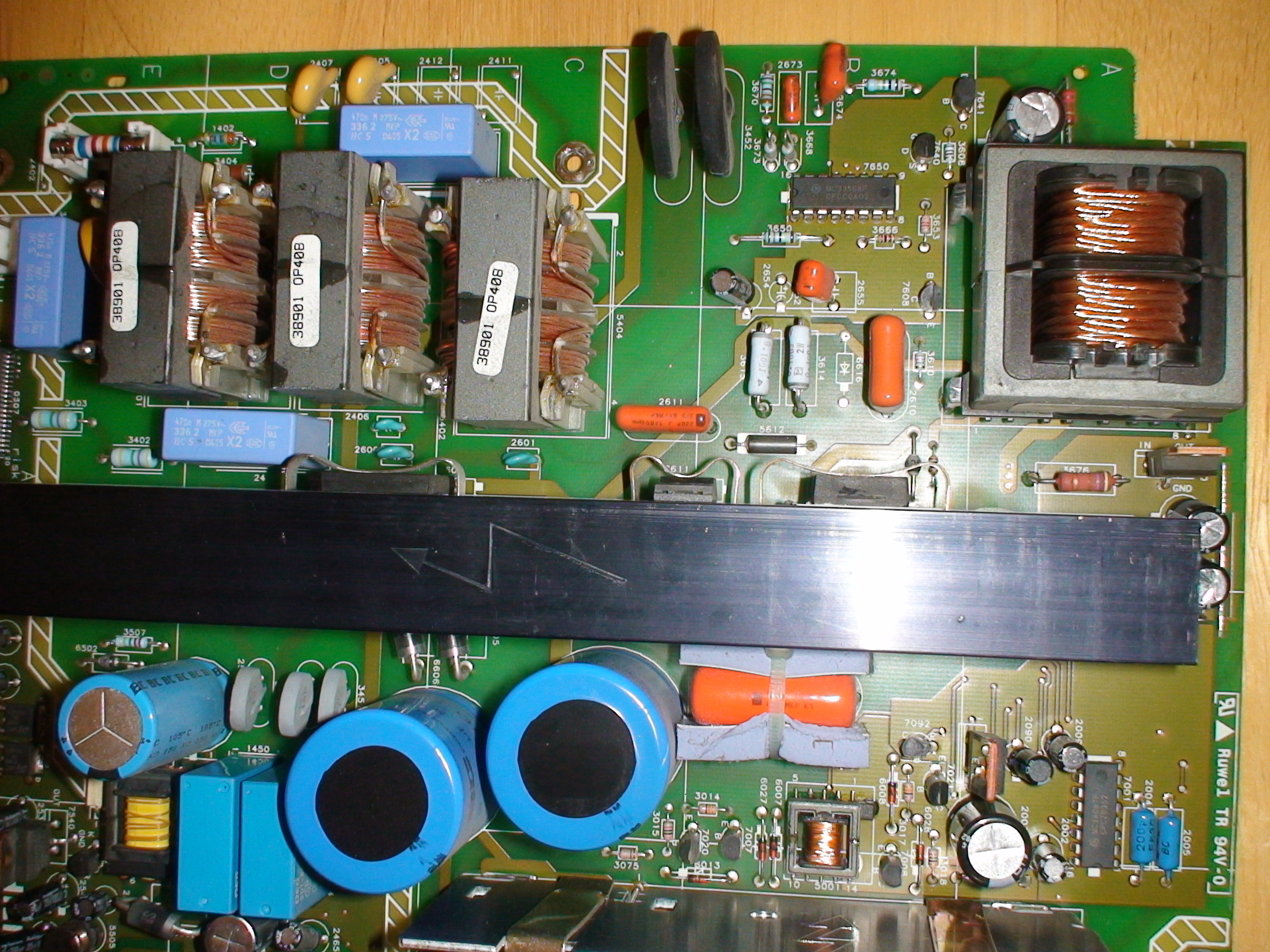

    So I've recently been given this as it has a start up issue, initially there is nothing, then it starts to click, just one relay clicking about twice a second, after a while a second relay may start clicking but still no power up. I have used a hair dryer to heat up and localize the issue and it seems it may be a voltage regulator that is at fault(the Tv will start up as per normal once heated up), it's an L7815CV and my confusion starts here. I've measured the output whilst it is clicking and it's just a mess of alternating voltages but once warm, and the Tv is going, it's a steady 93v, now this does not match up with the data sheet I have found or at least from what I can tell: http://pdf1.alldatasheet.com/datashe...S/L7815CV.html. There are also two Rubycon 100uf 50v caps located right next to it with two resistors, one either side, could these be at fault maybe? I suspect it's the VR but I can not be sure, any help on the above will be gratefully appreciated, Andy.

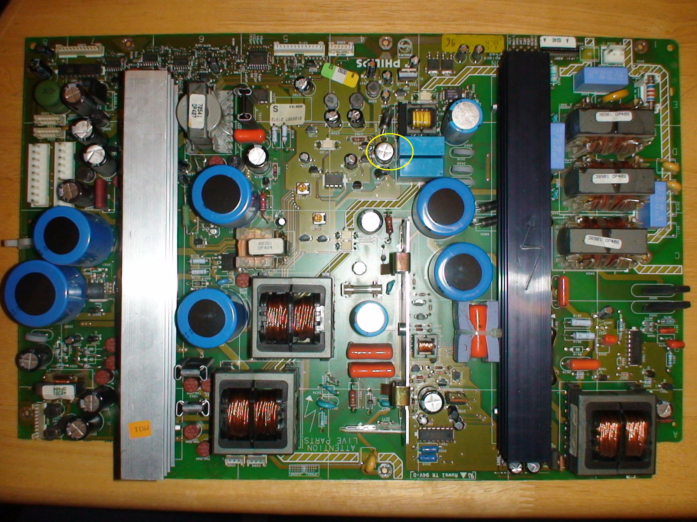

              That one cap. near the relays (circled) looks like its skin may be pulled back a bit indecating it got hot, It might be bad if its for the standby voltage that drives the relays.

                  Just had a good look at it and I'd say it's purely a manufacturing defect, seems to test fine, indeed I just checked both caps that I've exemplified using the diode setting on the DMM and both measure differently, could be other things influencing each of them, I don't know, but they measure 738 and 499, I did measure two other paired sets and they were very close to each other so my guess is the low reading could mean a bad cap, it's the nearest one in the photos.

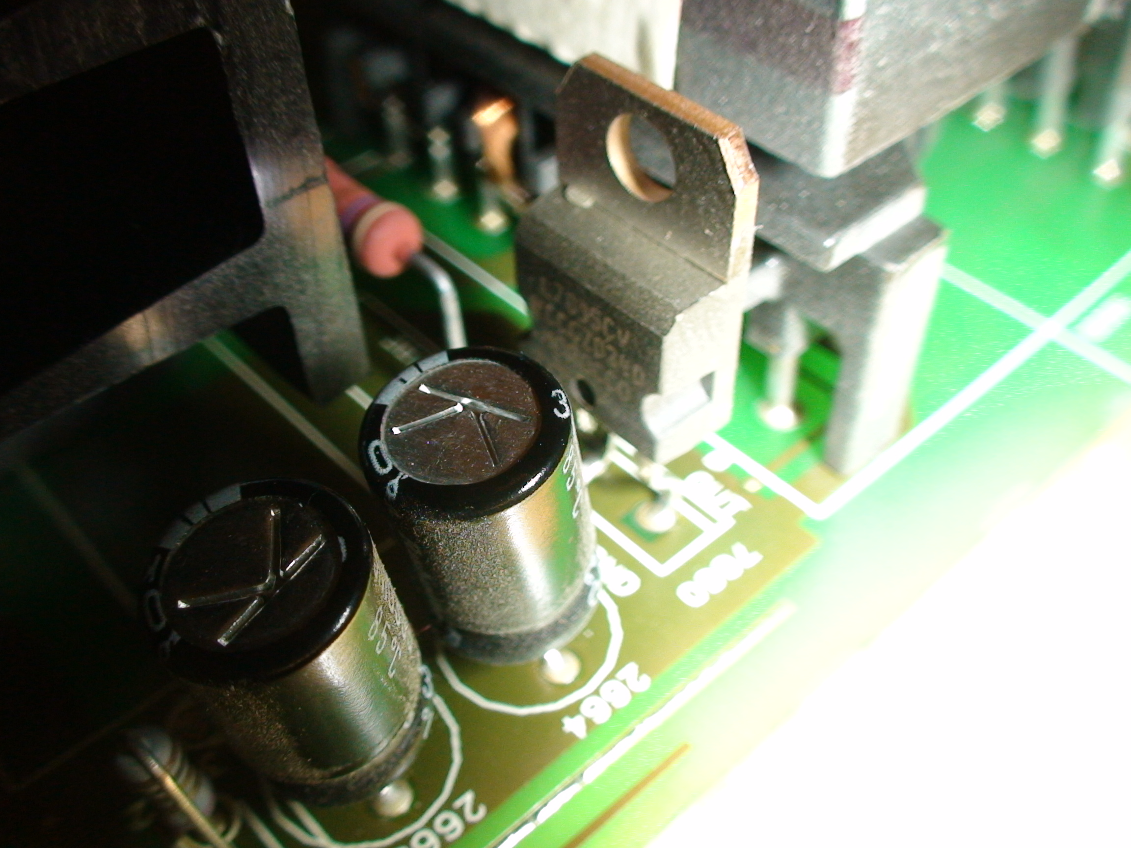

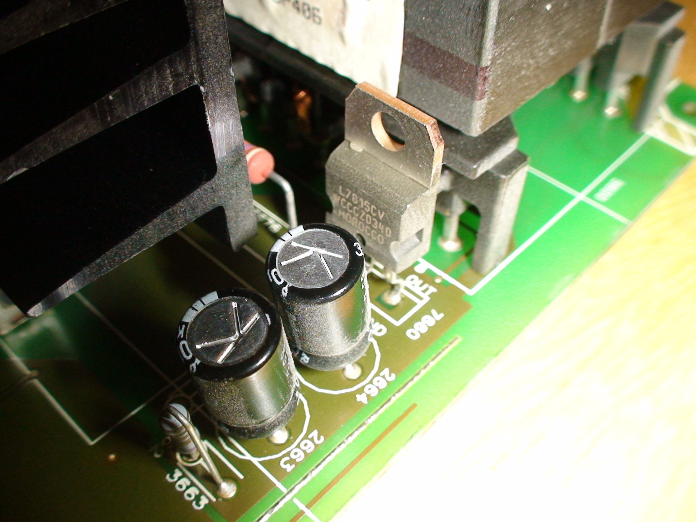

                      OK, as a matter of ease I've decided to change the capacitors first, all I've managed to get are 220uf @ 50v, the ones on the board are 100uf @ 50v, are they interchangeable?

                          So I've now changed the voltage regulator and the two caps pictured above, the Tv will now start on it's own from cold but as before it takes a while, to describe what happens: firstly, there is no standby light, this will then appear within about 30 seconds followed by the first relay starting to click, within about 10 seconds the second relay will start clicking till both stop, you will then hear a faint noise from some caps charging up followed by that same noise again and then the Tv will start, the YSUS can make a slightly louder noise than usual then quietens to a normal steady buzz/humming sound. So it's getting there but still not as it should be, yet again heating the area I described above gets it working very quickly, any ideas are all welcome, thanks, Andy.

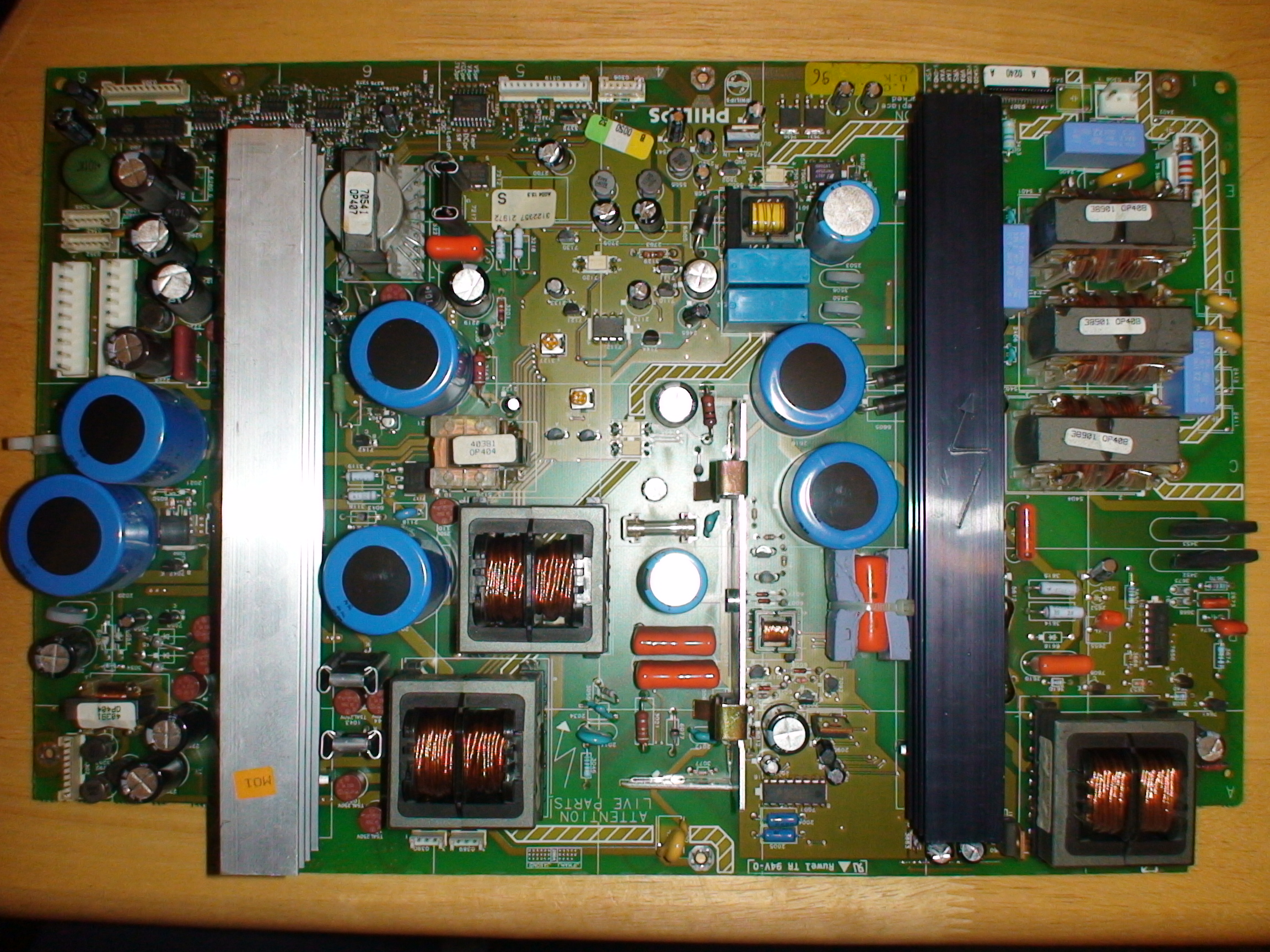

                                      I've been doing a little more digging around on this Tv, it seems capacitors 2662, 2663 and 2664 are possible contributors to the fault, two of which I have already replaced so that leaves just 2662 to replace, I shall do that a little later so fingers crossed. There's also talk of a resistor becoming faulty, still to find out what one that is.
