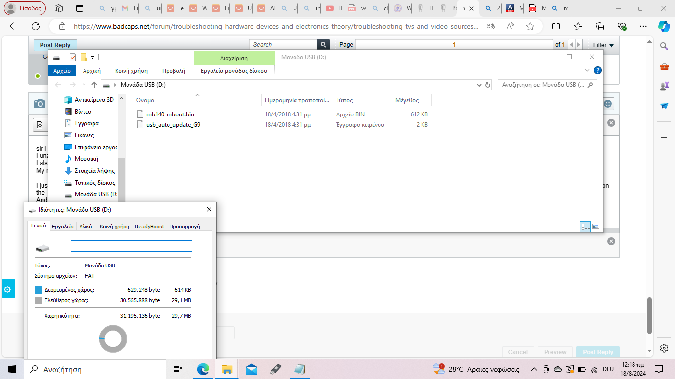

                                • wolf1976
                                  • Oct 2023
                                  • 104
                                  • Ελλάδα
                                  sir i have confused now
                                  I unzipped the file you gave me and put it on the stick of 30mbyte capacity
                                  I also send you a photo
                                  My mistake was that I didn't backup the original file of the completed MX25L12835F which has a character according to the manual of 128 mbyte correctly
                                  I just made several attempts to read the file you gave me to no avail when I pressed OK on the controller it would start and read the USB but then the USB would turn off and the light would go quickly on the TV
                                  And another time it stayed on permanently and the light flashed quickly on the TV to no avail until at some point it didn't even blink rather crashed the Now I have hopes of doing something to restore it with your file I mean also with the Programmer CH341A ?​
                                  • lotas
                                    • Jan 2016
                                    • 4472
                                    • Russia
                                    MX25L12835F - 128Mb bits serial Flash memory, which is configured as 16,777,216 x 8 internally. (128 Megabits =
                                    16 Megabytes)
                                    All three files should have been unpacked on your USB flash drive..
