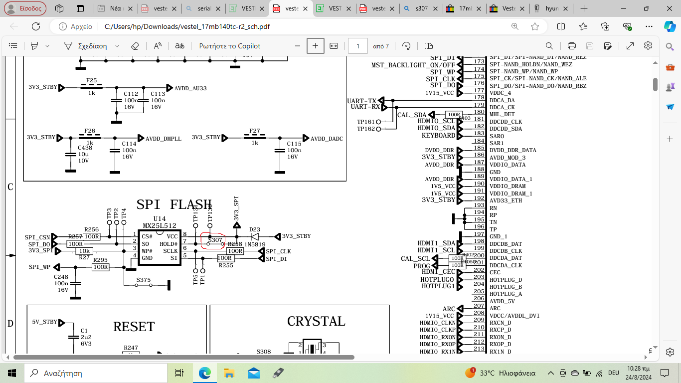

      hi again
      i want to ask if someone has a mainboard 17mb140 and tells me between the pins 7 and 8 what is the value of the smd component
      because from my mistake i damage it
      from the electrical plan that you can download from electrotanya seems to be S307 so its like shunt or resistance 0 ohm but i ask just to be sure and the pin 7 connects direct without resistance to pin 8

        There must be a resistor with 0 Ohm or put a jumper.

          ok thanks sir
