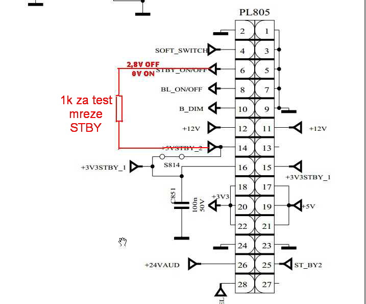

                      Re: Sigh, another dead VESTEL 17PW25-4
                      Don't worry, I've done that before on an old 17PW20. I ended up replacing it, so had a surplus power supply. It was rather fun to destroy the old one with a sledgehammer. It's AMAZING how much stress that relieves.
                      • crnisale
                        • Jun 2012
                        • 2
                        • Serbia
                        PSU test stby.

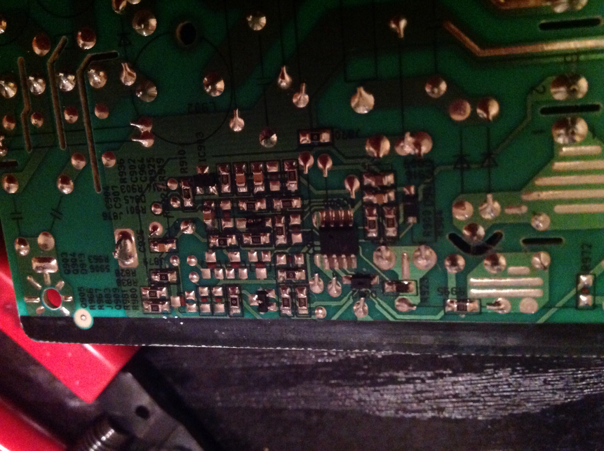

                                    Me again.. I have attached a picture of the back of the 17pw25-4 pcu. Could anyone please provide me with a list of the part list for those surface mount components (that looks damaged)? And what do you think would be easier to repair (with those common psu failure) or perhaps buy a "similar" 17pw25-4 from eBay. Thanks
                                    Any feedback would be appreciated.
                                      Look up a 17pw25-4 repair kit on ebay it has all of the parts that are picture that have blown, looks pike the pfc chip has blew due to a bad diode on the out put.
                                        Thanks but unfortunately I can't find the one I am after. The only one left is the ic800 one. Any other ideas?
