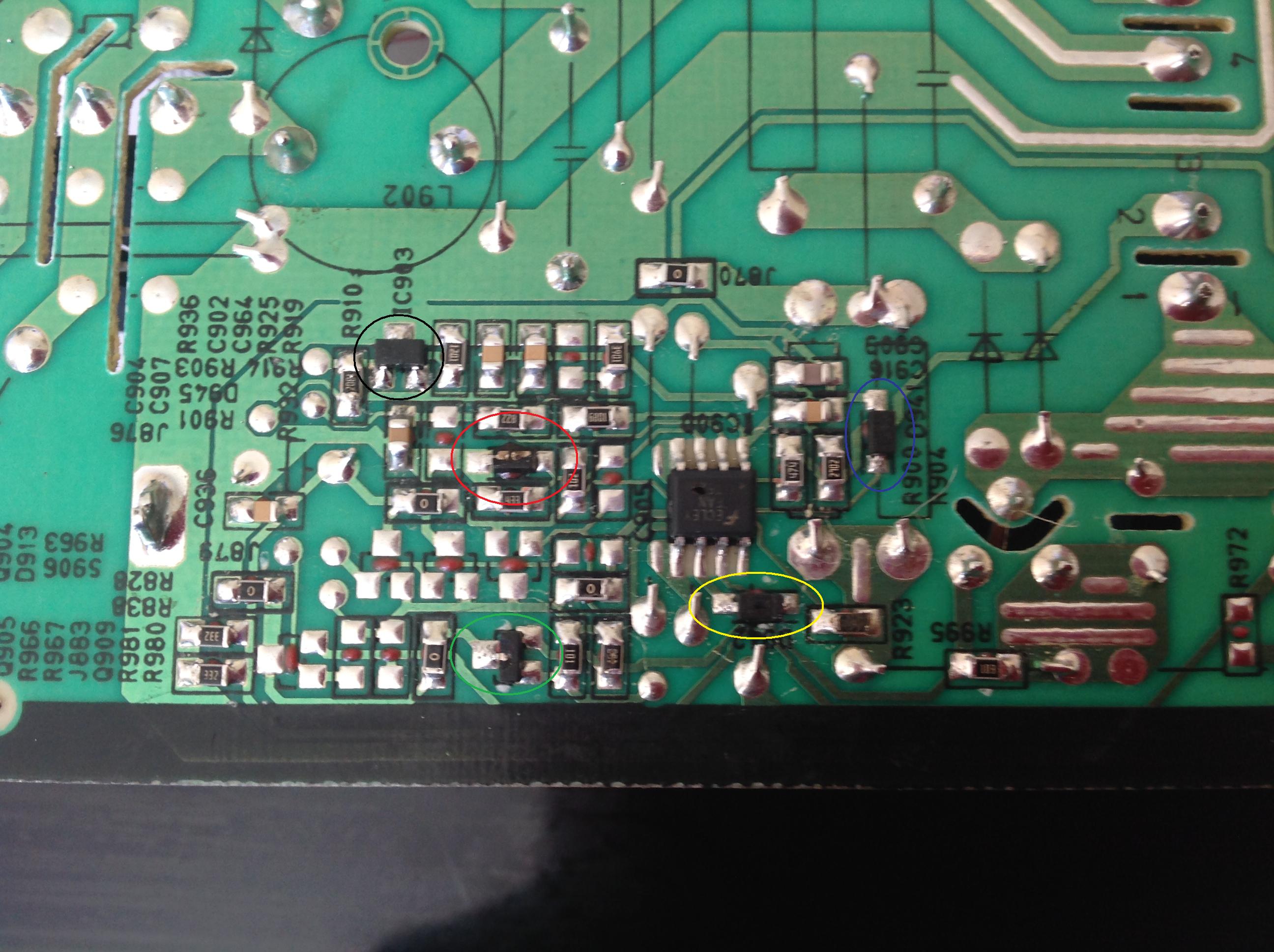

Sigh, another dead VESTEL 17PW25-4

    hi,
    I have attached the 17pw25-4 board (backside) picture and highlighted in circles the components I am interested in. Does anyone know the name/part number of these components, I cant really see the printed name on the psu board.
    Black :IC903?
    Red:
    Green:
    Yellow942?
    Blue: D941?
    Thank you
    • Amjama
      • Jun 2015
      • 24
      • England
      Re: Sigh, another dead VESTEL 17PW25-4
      Anyone? Just missing the green highlighted circle.
      Blue:. D941
      Black: Ic903
      Red: D945
      Yellow: D942
      Green:???
          Thanks tom66, I was after the part number c10v sod123, what does the "c" stand for? Is it equivalent to ZENER DIODE, 0.5W, 10V, SOD-123? Thanks
            Yes, that looks like an acceptable substitution to me.
            Although, SOD123 may be too big, so consider SOD323 option.
              Update, so I replaced all the defected components associated with short diode. However when I check my 5v, 12, 24v they all fluctuate a lot. From 5v to 17v for the 12v and 24v is 30v? Basically all my values are all over the place.. I get the blue n red flashing led indicating possible short? But can't find it! When measuring diode mode D941 I get 0.041 both ways however when i remove R923 I get my normal value of 0.540 one way indicating that the diode d941 is ok. Any advice? Thanks

                    #29
                    That makes sense, since the other side of R923 has two 0.22R resistors in parallel to GND. D941 is probably OK.
                    But with so many things blown around IC900, it may also be bad. I also see a black spot on it in the photo. Could be a hole?
                    Well, what can cause all my voltages (5,12,24v) all fluctuate that much, for example the 12v is all over the place from 10v to 15 sometimes even from 0.2 to 17v.
                    Power supply controller is power cycling. This can be caused by several things. One of them is shorted components. I suspect there is still something shorted you have not found yet.
                      Yes, I have replaced the ic900 as it also got damaged when diode it shorted. Yeah still looking for that possible short somewhere by the ic900 area. But why would all my reference voltages be fluctuating, the something is shorted in the ic900 area surely the only one or possible 2 of the reference voltages should be unstable the rest should be stable. Does anyone have the reference point of what voltages around diodes n ic should be? Thanks for your respond by the way much appreciated
                        What is the condition of the standby rails? Are they OK? Where did you measure the 5v rail that was fluctuating? Are you talking of the +5v rail or the 5v standby rail?
                        I don't consider myself a PSU expert, and it's late at night, so is it just me - or was this PSU (and schematic for that matter) apparently designed by madmen?
                        It looks like the mains gets rectified and sent to C803 as the primary filter capacitor, which in turn powers IC800, and that creates the 3.3v and 5v Standby rails. Fair enough so far...
                        But when the mainboard sends STBY_ON\OFF to the PSU, they switch on IC900, a FAN7529 PFC controller IC. Except it's not being used to do PFC, it seems. Rather, it drives TR900 as the main 12v/24v rail PWM controller. Insane or clever? I don't know. Why on earth they use a million diodes in parallel instead of using the already-designed-in board layout for proper heatsink-mounted recifier pairs I don't know. Unless they want the thing to blow up... HMMM....
                          Well, I think is design to blow or they just trying to save money. Clever I don't know, risky for sure!
                          My 5v and 5v standby (3.3v I think)are all fluctuating from 0.1 to 5v.
                          Is been a fun project to tackle from the start now it just 1 more
                          Min and I will throw that p** of s** out! But got to stay strong. But good learning experience. If I could at least get the 5, and the 12v stable I can look into the 24v which is flicking to 32V! Sad days
                          Don't want to spend 25-39£ for a new board! But might have to....
                            Sounds like something could be bad in the standby circuit then. Check for shorts on the standby rails and any rails derived from them.
                            Also, IC800 has UVLO of 10.5v on the Vcc pin, so check that its voltage is not dropping below that.
                              This PSU has OVP/UVP/etc circuit which will cause 5V standby to fluctuate if any of the other rails are bad.
                              I never did figure out how to fix one of my 17PW25-4s with this fault.
                              Multiple parallel diodes are a cost saving method but one of the major downfalls of this PSU design. They fail all the time.
                              They truly are terrible power supplies...
