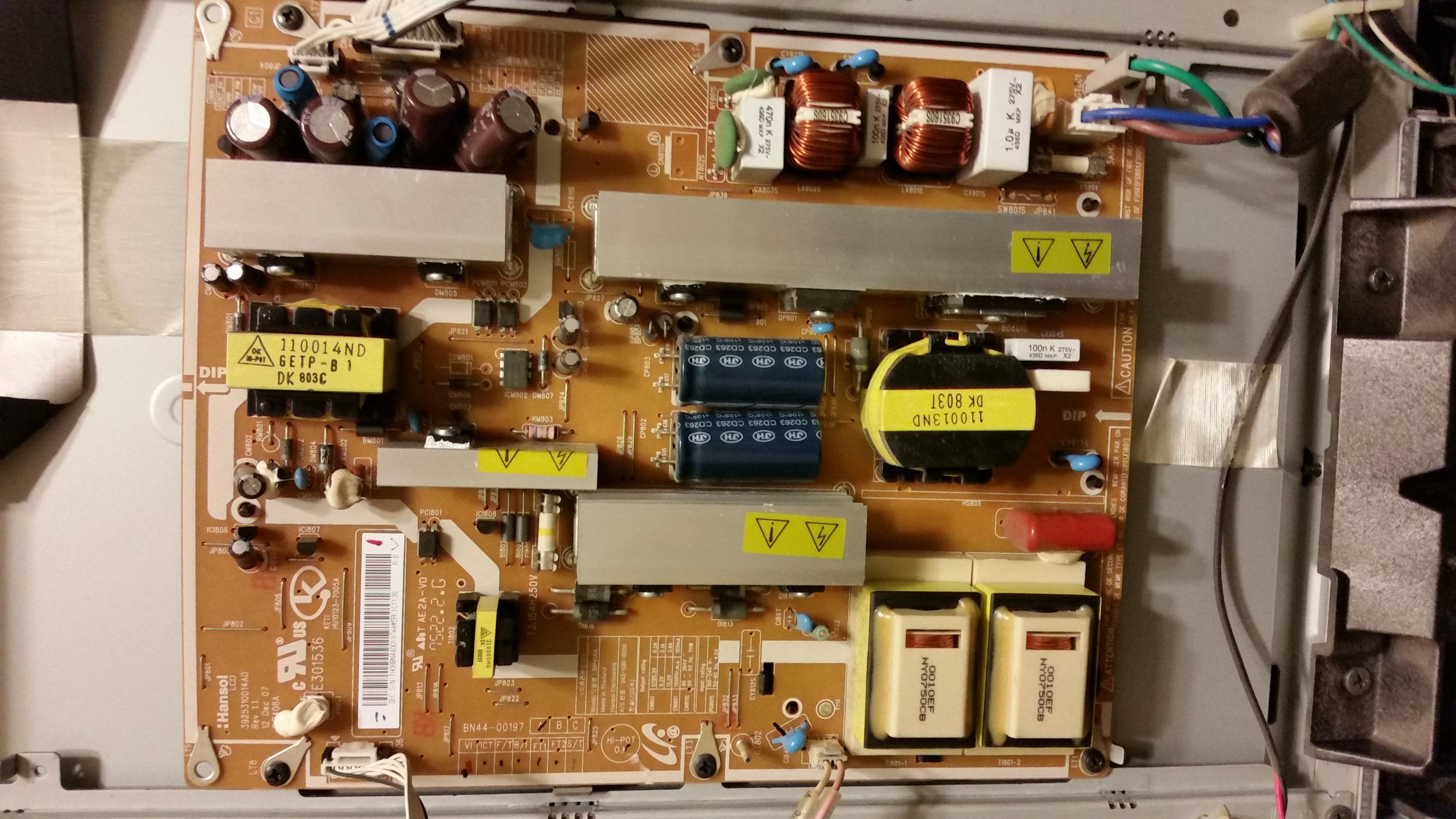

        It would be a good idea to take a good clear picture of the power board and post it.
        I looked through my notes and found that I had repaired that same model that had bad capacitors.
        Posting a photo will help verify if you have that issue.

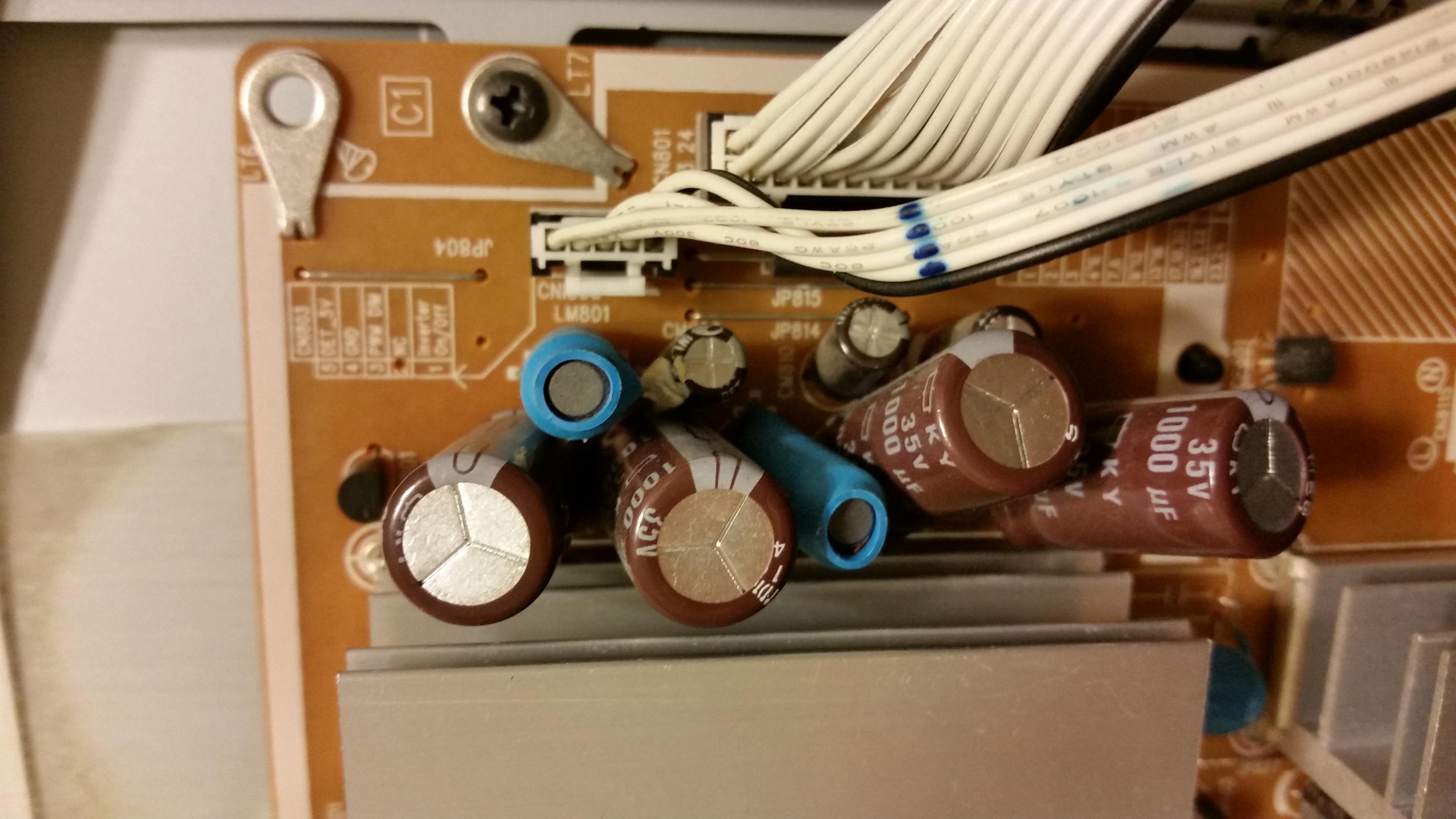

                Re: Samsung LN40A550P3FXZA video issues
                The caps look fine.
                No bulging or anything.
                    The model number is one of the models that were included for the capacitor class action lawsuit.
                    Even though the capacitors are not bulged they could be bad.
                    I would replace them with good quality Panasonic FM series caps. It isn't that expensive to recap the power supply and it might solve the problem.
                    Unless you have an ESR meter and and a capacitor tester you could overlook caps that are really bad but "look" good.
                    I've seen it a number of times.
                    Mike

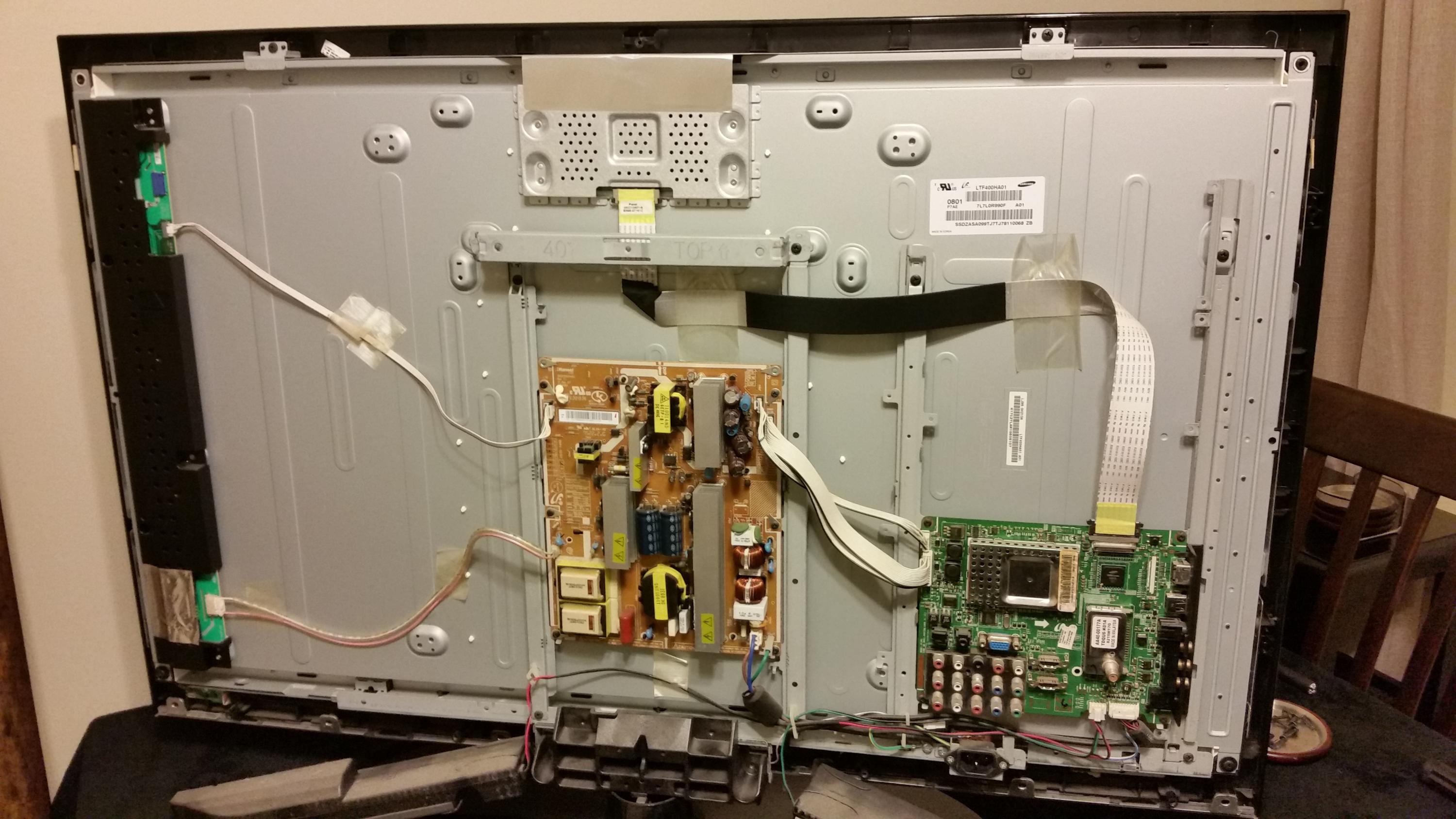

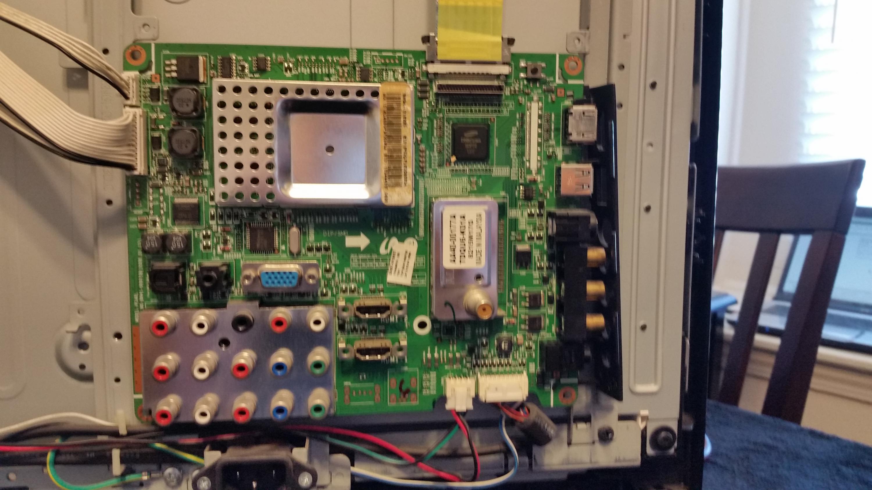

                              I have the exact same problem as described by darkweezil.
                              I have a LN40A550P3FXZA. When you turn the TV on, everything works perfectly. Then, after maybe 5 minutes or 2 hours or whatever time (not regular), the screen goes completely off (no glare, no stripes, nothing, just like if it was off), but the audio keeps going. Turning it off and back on works very rarely. Most of the time I need to let it sit for a couple of minutes at least. And when I turn it back on, it happens again. One thing I've noticed is that the failure occurs faster if I am watching cable (directly connected to the back, no box), and even faster if it is an HD channel. Component seems to work a little longer and HDMI the longest of all inputs I've tried.
                              The capacitors look good, though I have already read here that even if they look good they may not be working. Also, I am pretty sure these are not the original capacitors (I bought the TV from a friend who was getting rid of it about 2 years ago).
                              The boards I have are:
                              - Power: SIP408A (3925310014AD)
                              - Main: PEARL BN41-00975B(2008.01.13) (on the board)
                              BN97-01985T (on sticker)
                              BN94-01628T (sticker on top of "heat sink")
                              AA40-00177A / TDQU6-K01A / 8215M17G (on cable connector)
                              I am attaching some pictures showing all boards.
                              Any help would be very helpful!!
                              Sebastian
