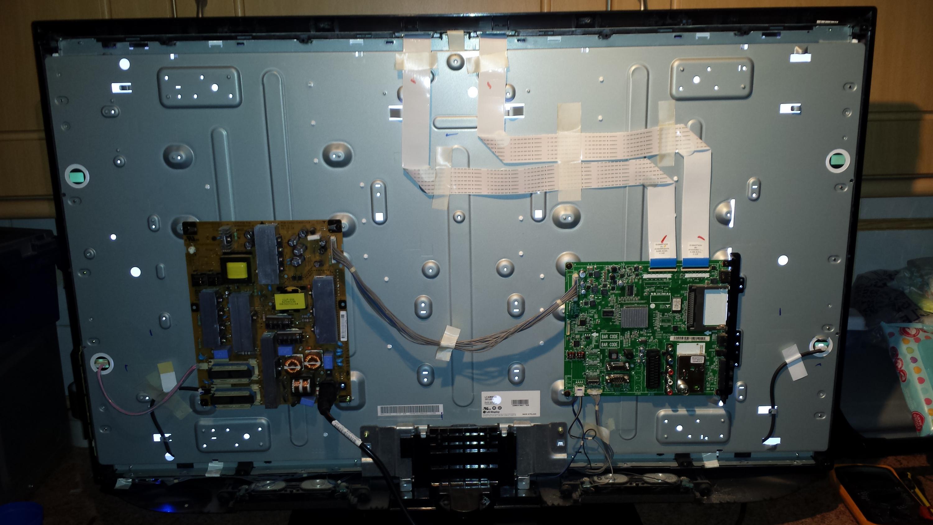

    Hi
    This tv picture is fine but it seems to have like wavy lines going horizontal on the screen and the main board seems to be making a squealing sound,the guy I bought it off said the picture would play up so he had the knock the back of the TV where the main board is positioned
    Any ideas ?

    Opps forgot the picture
      Re: Lg 42ld450
      Try changing input source frequency - one easy way is changing the output of a PS2 or PS3 (over composite video cable, yellow white red) from PAL to NTSC (50Hz/60Hz), or by using a computer and changing the frequency. When you do this, do the lines behave differently?

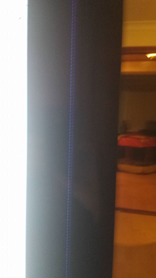

                    no tom tried 50 and 60 hz the tv has horizontal lines going up and down the video did not really show this but the noise is another thing its coming from the main board

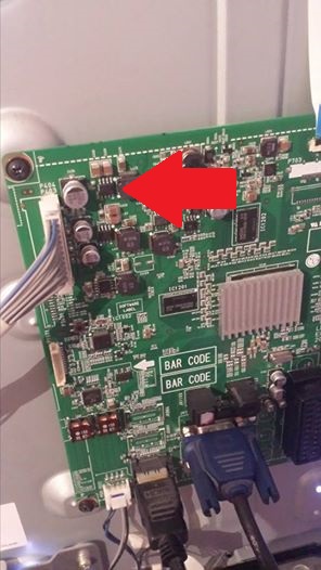

                      Can you locate where on the main board the noise is coming from?

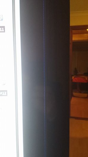

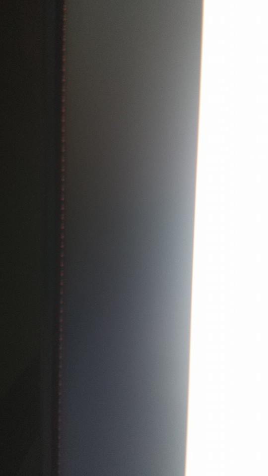

                        hmmm thats going to be hard but ive also noticed to the right of the screen next the the plastic housing blue dotted lines going all the way down and red dotted line going all the way down on the left would have been hard to spot
                          Re: Lg 42ld450
                          Try using a toilet-roll tube to locate the source.

                            Re: Lg 42ld450
                            clearer picture
                            • sordids999
                              • May 2013
                              • 2158
                              • uk

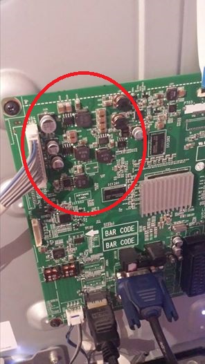

                              Re: Lg 42ld450
                              @tom i just put a toilet roll holder over on this part and it stopped the noise
                                Re: Lg 42ld450
                                That looks like a DC-DC converter section. Check the output voltages from the power supply, are they within range?

                                  Re: Lg 42ld450
                                  Pin 1 nc pin 1 error
                                  pin 2 12v (12.19) pin 2 p.dim (2.48)
                                  pin 3 12v (12.19) pin 3 a.dim (1.70)
                                  pin 4 12v (12.19) pin 4 inv on/off (2.80)
                                  pin 5 gnd pin 5 gnd
                                  pin 6 gnd pin 6 gnd
                                  pin 7 3.5v (3.37) pin 7 3.5v (3.37)
                                  pin 8 3.5v (3.37) pin 8 3.5v (3.37)
                                  pin 9 gnd pin 9 gnd
                                  pin 10 gnd pin 10 gnd
                                  pin 11 20v (20.1) pin 11 20v (20.1)
                                  pin 12 power on (3.0) pin 12 20v (20.1)

                                    Re: Lg 42ld450
                                    tom if i touch this with my meter leads the noise goes but comes back after 30 seconds
