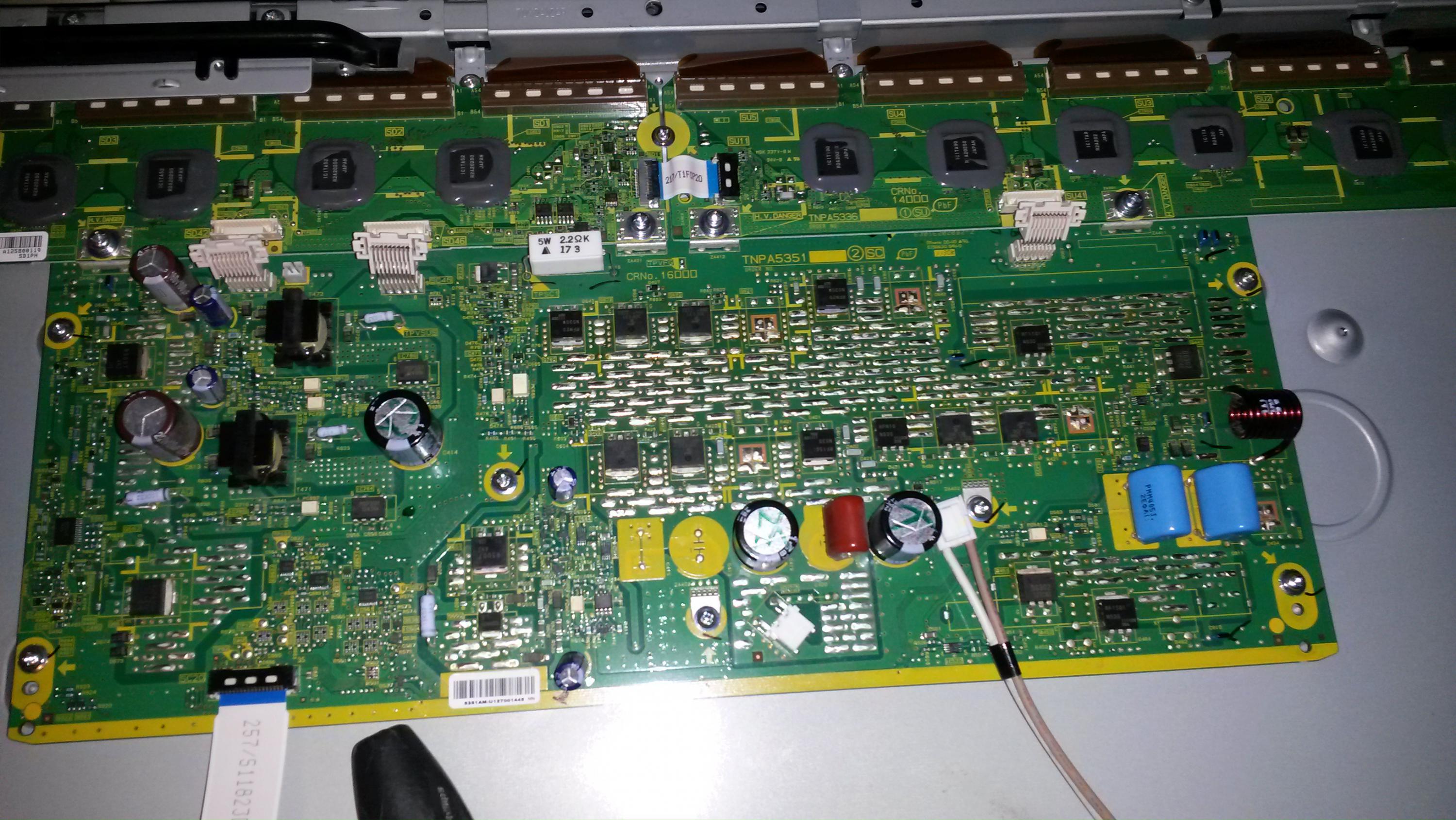

    I just picked up a TC-P50S30 that had 7 blinks. After reading all the threads out here, I was able to get the screen on after disconnecting the SU and SD cards and jumpering SC50 on the SC board.
    I tried the SU and SD one at a time, but still got the 7 blinks. Does this mean the SC board is maybe ok, and the problem is the SU/SD set?
    Thanks,
    Brian

    generally speaking if the TV turns on with Sc50 jumped and no blinks and the onboard LEDs are lit on the SC then it's a pass.
    When you tried SU/SD on their own was Sc50 jumped? If not SOS7 will trigger with either of those disconnected.
    I personally would rather resistance check those than risk using the SC50 jump and having a bad buffer board blow the SC which can happen. Not sure if this series is immune to a buffer blowing the SC but on a 2010 I shorted out a SC attempting to run it with shorted buffers.

      I don't see any onboard led's on this SC, physically. No major shorts on the buffers that I could find with my trusty old fluke 77. But the test with the both su and sd, sc50 was jumped. When I tested su and sd one at a time connected to the sc, sc50 was jumped. I'll pop out the sc board and double check it again though just to be sure. I'm wondering why both boards would be bad, maybe a few bad assorted chips.
      Everyone's out of stock of the su and sd, and on ebay there's just an su I believe. I did see a guy selling a whole set, sc, su and sd, but for like $180. This one can sit against the wall until I find cheaper parts.
      I still can't get over how panasonic doesn't offer extended warranty for this model. I heard a lot of bad stories associate with this model. Although the panasonic picture is outstanding when they do work.

        So when you say got the screen on with SC50, what exactly did you see with the buffers removed?
        If the TV was on and SC50 was jumped and it passed/running you would have seen a green LED shining D583 on the SC board. I can see it in the photo. It is located below the 2 blue polyester caps near the white optocoupler.
        The SS board LED too would have been lit, D254 located also below the 2 blue polyester caps near the white optocoupler on a TNPA5357AM SS board.

          Ok, I got the led's on both boards green.
          What happens with the su and sd out of circiut is the front panel led, stays solid red, and the HV stays on instead of dropping out, and as I mentioned above, I have the green led's on the sc and ss board.
          As far as the wait, I picked this set up for $50. So I can gets a few more set out the door to pay for parts..

            try this and post up the results.
            On the SD,SD42 measure the following resistance with respect to the gnd plates on the board. This is with them disconnected from the SC.
            Pin 6 VF_5V
            Pin 1 VFO
            Pin 2 Vscn_f
            On SU41
            Pin 2 VF_5V
            Pin 8 VFO
            Pin 6 Vscn_f

              Not to sound stupid, but were you referring to the HV plates? I can't see any common on the two boards. There's some commons from the sc going in on sd46. But it seem slike a bad common for the sc and su.
              However, I measured from the points you gave me to the HV plates, the readings are (in ohms)
              sd42
              pin 6 1.2M
              pin 1 5.6M
              pin 2 10.5m
              su41 (looks to be a culprit)
              pin 2 9.6
              pin 8 55
              pin 6 1.89M
              From the gnd that goes in on sd46, all pins are open.

                yeah, so the grounding plates where the screws go.
                don't understand what you're saying about SD46, 9.6 ohms on the 5V is definitely bad so too 55ohms on Vscn_f.
                Ironically 1.89M is what I expect on Vfo or at least on a 2010 FHD buffer that's what mine are.
                As for the SD, the results are quite high? This can depend on the polarity of the leads.
                Could you try that one again in both polarities and also disconnect the ribbon between the 2 boards just in case it affects anything.
                These are typical results for my buffer and I expect these will be very similar for these. Do me a favour and keep the name tag in the results, I don't remember pin numbers well.
                VFO 2.2M
                VSCN-F (TPSC1) 221K
                5V_F 5.7M
                your results
                Pin 6 VF_5V 1.2M
                Pin 1 VFO 5.6M
                Pin 2 Vscn_f 10.5M
                No low ohms so that's a good start.

                  Getting eronious high readings either polarity, probably due to a cap charging up.
                  SD46 has a couple of connection going to chassis ground through the SC, it's the second connector on the SD. The SC isn't connected as you said for all these tests.
                  The readings on SU41 were a bit low.
                  Do these cables pull out after unlatching the lock. I popped up the latch and the cable are still in there pretty good, I didn't want to pull too hard. Maybe I'll wait for the replacement to show on how those cables come out. I pulled other ribbons out on other models, especially samsungs, but never a panasonic.
                  I managed to find a set of boards on craigslist from a guy with a busted panel. I just hope the boards didn't get damaged when the display broke. $35 for the set including shipping. I paid via paypal, hopefully the guys honest, since it wasn't a local deal, but with paypal, if they don't show, I can get my money back. I used searchtempest.com to search craigslist, it pulls results from all over.

                    Do the same resistance check before install. A cracked/shorted panel can kill the buffers if it was on when it cracked. i have purchased a set from a 3D Vt20 model, the Sc was ok but the Sd was shorted, Su ok so there's a chance of getting bad buffers. Don't install blindly, you want to make sure you preserve the SC as they asre even harder to get and costly.
                    With mine 12 months ago you could bet a SC easily and $50-70. Now almost impossible to get or $150 upwards. I managed to work out how to repair those and have a couple spare to cover me with my TV.
                    If you're referring to the panel ribbons. yes they wedge in a bit. They will pop out but I use 2 fingers either side and gently pull back straight, maybe a little wiggle but I guess you want to control it in such a way so that when they do break free, your wrist does not go flying backwards and tearing the ribbon. Lift latch fully.
                    Putting back in, reverse, they slide in easy then just a little bit further they'll wedge in. Usually there are markers to judge they are in and straight.
                    Most of us have had to have a couple of goes judging by other posts but it's a feel thing. First time I did one of these it took a couple of goes, but now I can get it first time.
                    If you do need to reseat, do it with the TV off! A few have made the mistake doing it with panel on and you will blow both the buffer and good chance the Sc as well.
                    I was having a look at the P0GT30 buffers, I reckon they would work too and only thing I can see are the heatsinks that make this different. None on yours. this is similar to the S20 & G20 models which my is an equivalent, the heatsinks are on the G20. Can't gve you 100% promise but that is what my eyes and gut are telling me.
                    If you get high boths ways, it might still be ok for that buffer, but the low one , I'd say is gone.
                    Might also be worthwhile just checking the 5V reg on the Sc that feeds VF5v to these. IC724, next to the SC46, SMD IC. I've had one of these bad with a buffer set with shorted 5v at the buffer.
                    GND-pin3 should be around 2.6K. also check pin 1-3 is not shorted. I've also had one where the first test was ok but later found 1-3 was short so no longer a 5V reg and allowing the 15V to go through. 15V in on 1 and 5V out on 3
