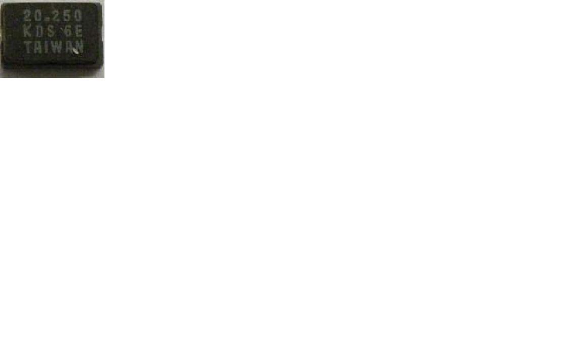

        Lamp error caused by the crystal X3001.
        Second line should NOT read KDS 6D or KDS 6E
        if it does its a bad crystal
