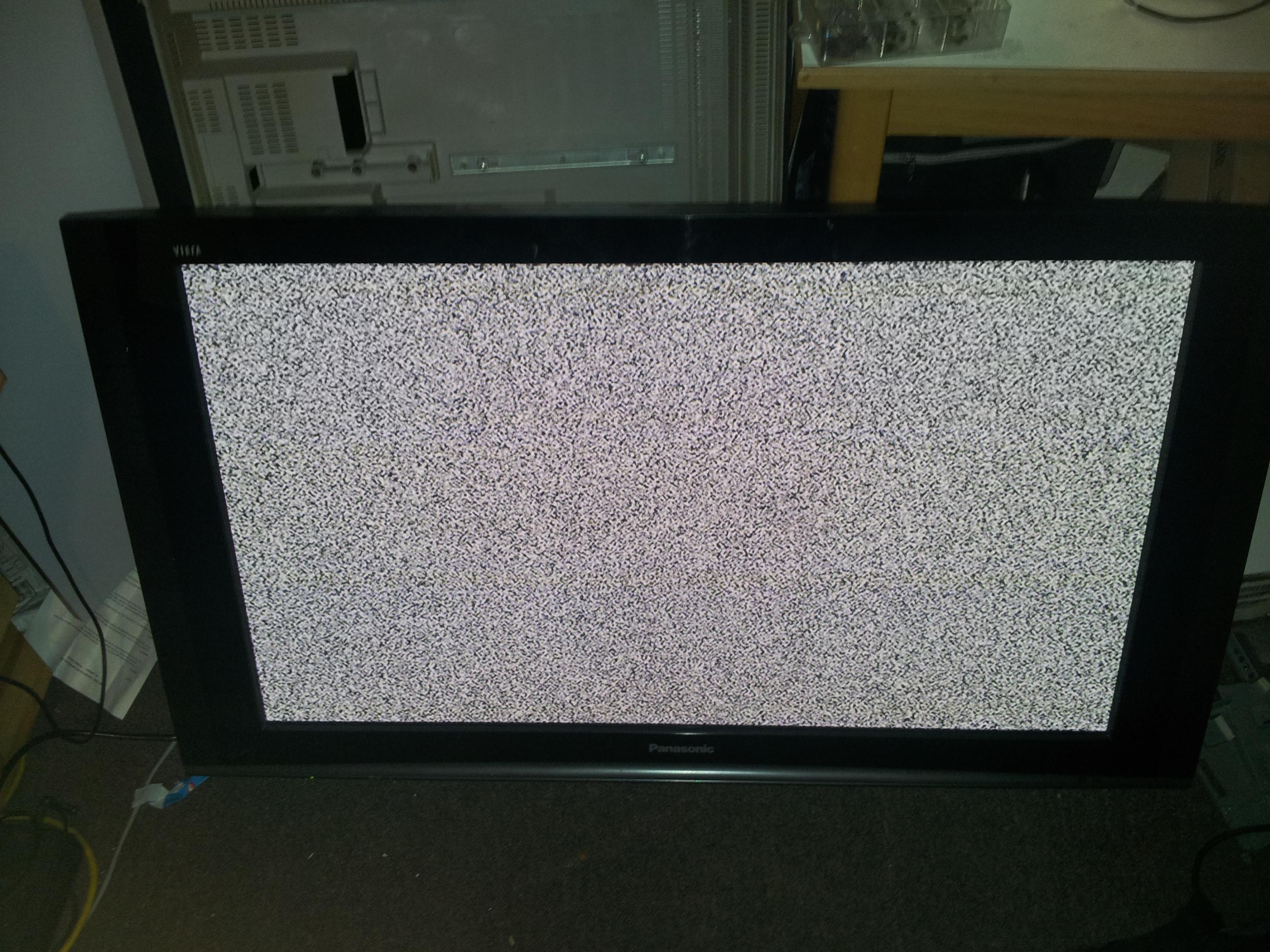

TH-42PZ70BA 10 bllinks not intermittent

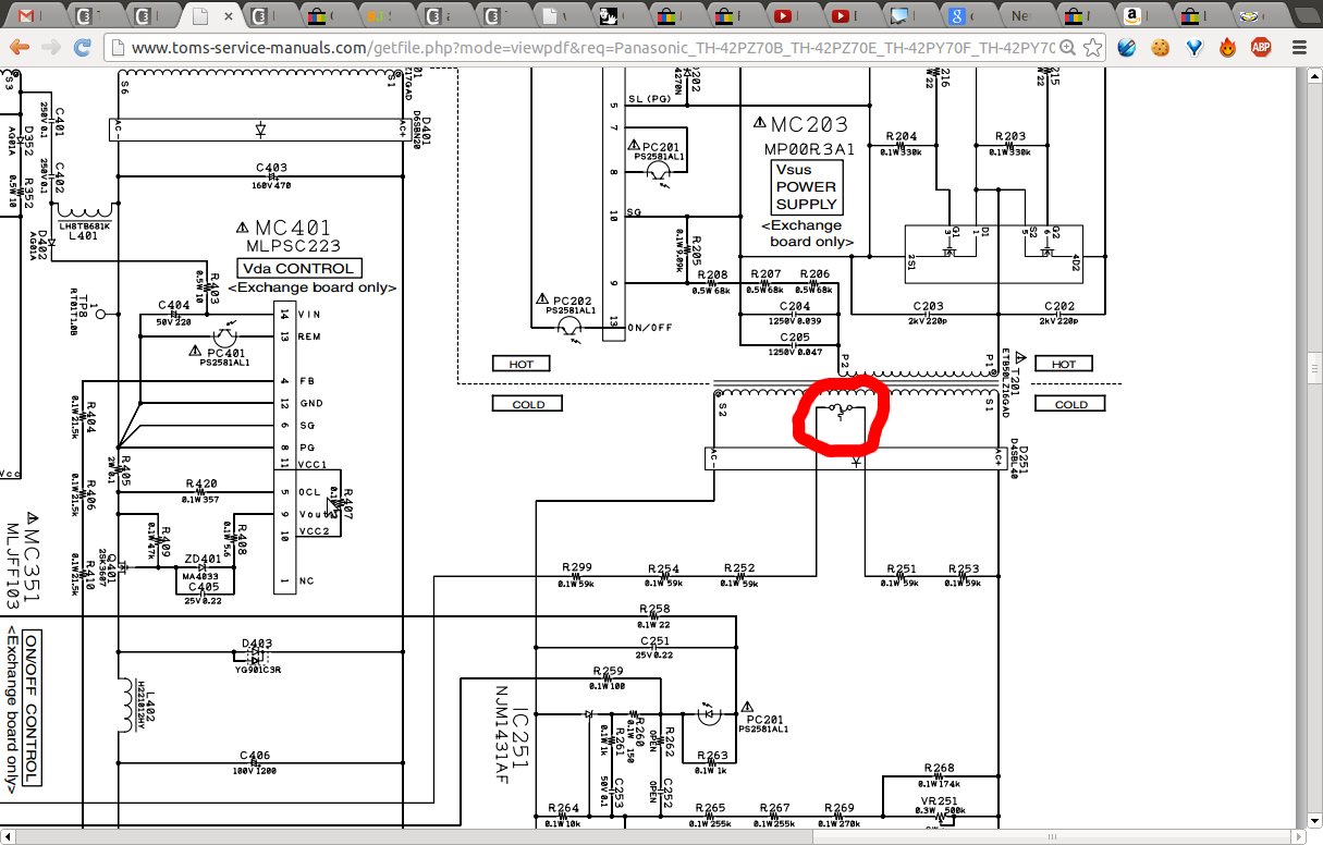

    Fixed it was that thermal fuse.
    cool, which one? so the TV runs now, no blinks. That's one to learn from.
      Re: TH-42PZ70BA 10 bllinks not intermittent
      One embedded in VSUS transformer.
      Runs great, has 8000 hours on it. No burn in, no maldischarge.
      Probably going to tweak black level down, it's quite a lot higher than my PZ80. But it is also a lot brighter. Then again it's rated for around 600W instead of 470W.
      • tw2005
        • Oct 2011
        • 6458
        not shown in the schematic? you're a clever dick.
          It is...
          Tested at 20Megs so pretty close to open circuit.
          No load current flows through it, purely a thermal sensor. Odd that they'd bother, given all the other sensors. Just used a spare thermal fuse from my parts bin.
          And it's per that other memory of that video:
          http://www.youtube.com/watch?v=qQ_iLxx3Fj4
                      I got a Q because I'm not getting something. If the fuse was in T201 vsus, how does that tie on with T301 for Vda? I have not watched the video yet.
                        #31
                        Has nothing to do with it - it was waiting for Vsus to rise, could not see it rise so then dying. So it never got to fire up Vda. Vda only comes up after a second or so of fans spinning.
                        The fuse is only an indicator, it does not carry any load current.
                          Yep, just got to the juicy bit about the sus out sense. That's a very tricky one. Really impressed
