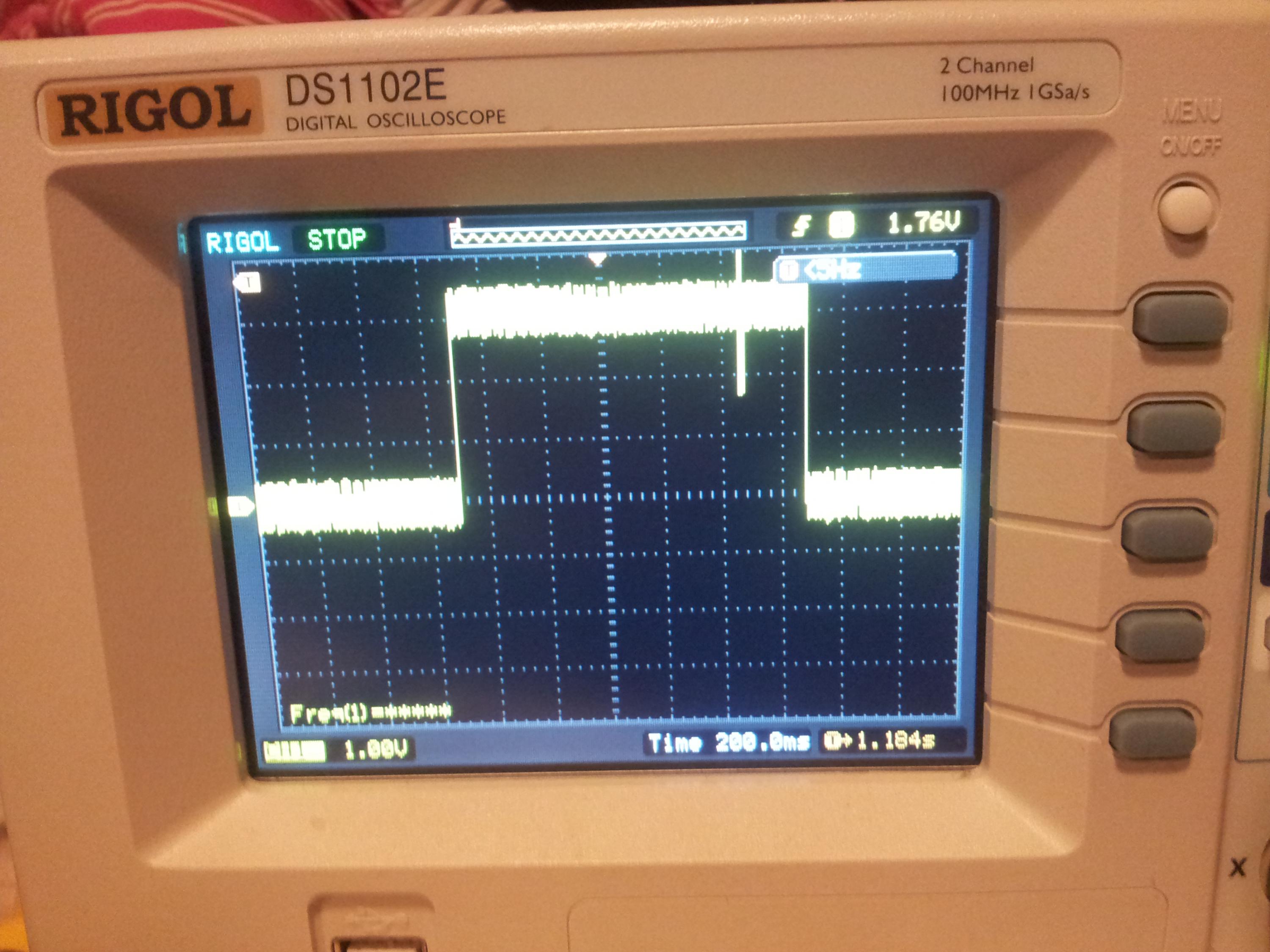

                                  Reason is, was just checking TV_MAIN_ON, TV_SUB_ON etc... and these signals stay high AFTER the relay clicks. Usefully, my scope picks up a little noise spike from relays disengaging and I can see this... These signals are not adulterated by the D board either, they are DG-only.
                                  So surely it can only be the P board. Then a little memory, back to this video:
                                  http://www.youtube.com/watch?v=qQ_iLxx3Fj4
                                  On the PZ80s, Vsus_DET failure leads to 2 blinks.
                                  On these, it may well lead to 10 blinks.
                                  Both 10 & 2 will detect the 15V fault (which occurs after Vsus failure), I guess it's a matter of which wins first. Which is odd - I wonder if Panasonic have a priority system for simultaneous errors? Which is shown in the case of two signals at once?
                                  Going to check that Vsus_DET signal now. And maybe I'll get lucky .

                                      Re: TH-42PZ70BA 10 bllinks not intermittent
                                      Here's TV SUB ON showing it staying high AFTER the relay clicks. The spike in the high portion is the relay(s) disengaging, causing a small electrical arc. This wideband rf spike interferes slightly with the scope ground lead.... One type of useful interference... The noise/other interference on the signal is due to deliberately poor grounding (to make spike more visible.)
                                      Clearly showing the DG board diligently attempting to remain functional after the relay clicks out, telling me DG is not causing the fault.
                                      Hmm...
                                      Apologies for the photo, as I can't find a memory stick to directly extract an image of my scope waveform.
                                        Fixed it was that thermal fuse.
