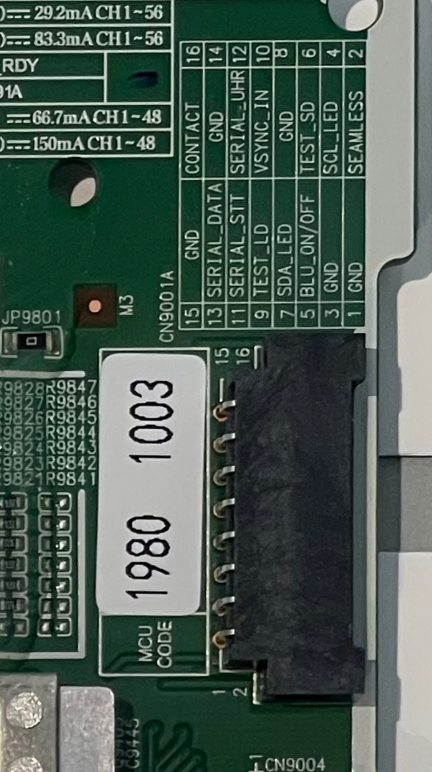

      Do you have a legend like this one does? If so does it show it as 3v point 1?

        So that is what I have on the 16-pin connector CN9001A. (I didn't measure the serial pins since I don't think a reading with the multimeter will be relevant. Just tell me if I should measure it or scope it.)
        Pin Name Measure
        1 GND 0V
        2 SEAMLESS 0V
        3 GND 0V
        4 SCL_LED 2,71V
        5 BLU_ON/OFF 3,223V
        6 TEST_SD 1,38V
        7 SDA_LED 2,70V
        8 GND 0V
        9 TEST_LD 0,9V to 1,2V
        10 VSYNC_IN Skipped
        11 SERIAL_STT Skipped
        12 SERIAL_UHR Skipped
        13 SERIAL_DATA Skipped
        14 GND 0V
        15 GND 0V
        16 CONTACT 0V
          You are right I have the pin description table and I'm sorry I cropped it on my previous closeup picture I totally missed it. Here it is and you are right it show 3.3V... Do I have so bad luck that I've managed to order a defective driver board? 😥

            MB are fine... driver boards or LED fault

              I think also, I was able to find which pin number 1 on that legend was connected to, to the main board connector. When the connector was plugged in (all normal) that pin read 1.4v for me but when I disconnected the connector from LED driver to main and then tested that same pin (now at main board) the voltage was 3v.
              Let me know if that made sense lol.
              And I don't know for sure. But as that picture shows when it was working correctly for me that line was 3v.
              See if you can find the pin 1 is connected to, to the main board

                Sorry, I don't think I understand your message..
                - If I unplug the cable coming from the motherboard and going to the driver board with the TV ON: I read 0.7V.
                - Then, as soon as I plug in the cable, I have 1.36V.
