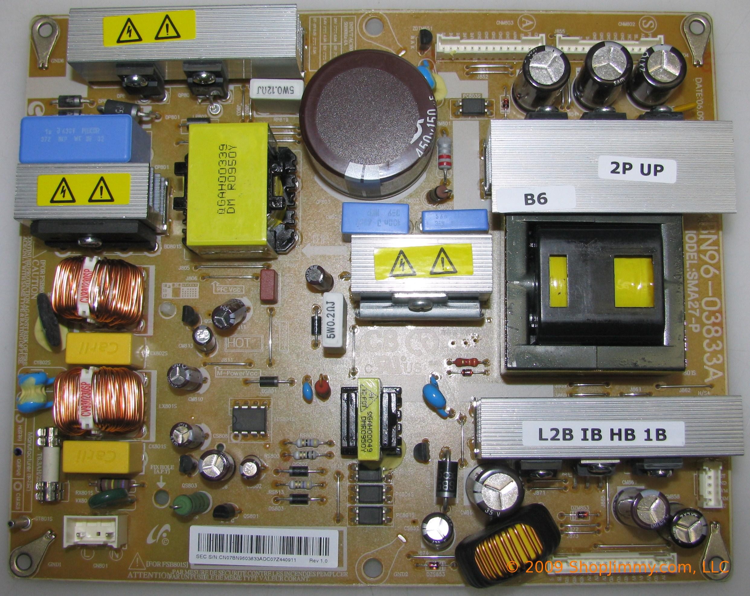

    Another project , this time another Samsung LCD Model: LE26R74BD
    This has the notorious 2 seconds black fault. The LCD Panel works , this was tested in dark with Torch
    Four bulging 1-MilliFarad Caps were replaced on the PSU ( Model BN9603833A) . The fault still resumed
    . Originally the backlight switched on for around half a second . This was improved to 2 seconds after swapping Inverter board

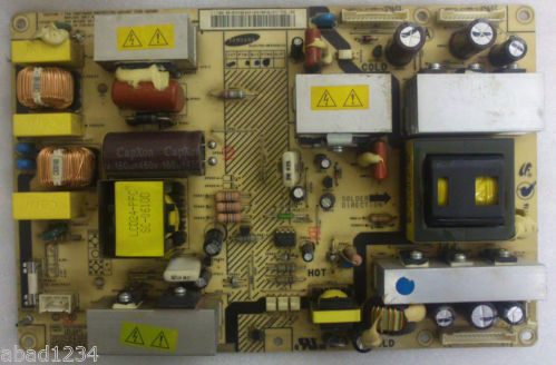

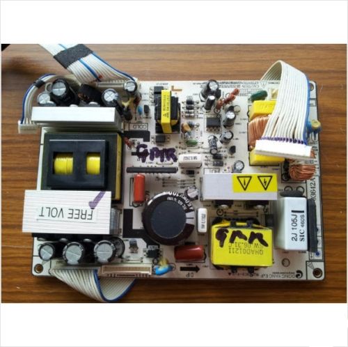

    I suspect either I have a faulty lamp CCFL or PSU component . Seemingly there are several compatible PSU for this TV ( BN96-03057A , BN96-03642A to name a few )
    Before swapping out the PSU or checking the lamps , it would be nice to hear your thoughts , suspicions, experiences and hunches with this issue
    I am fairly experienced with electronics and Meters , I just lack time to check everything at the moment
