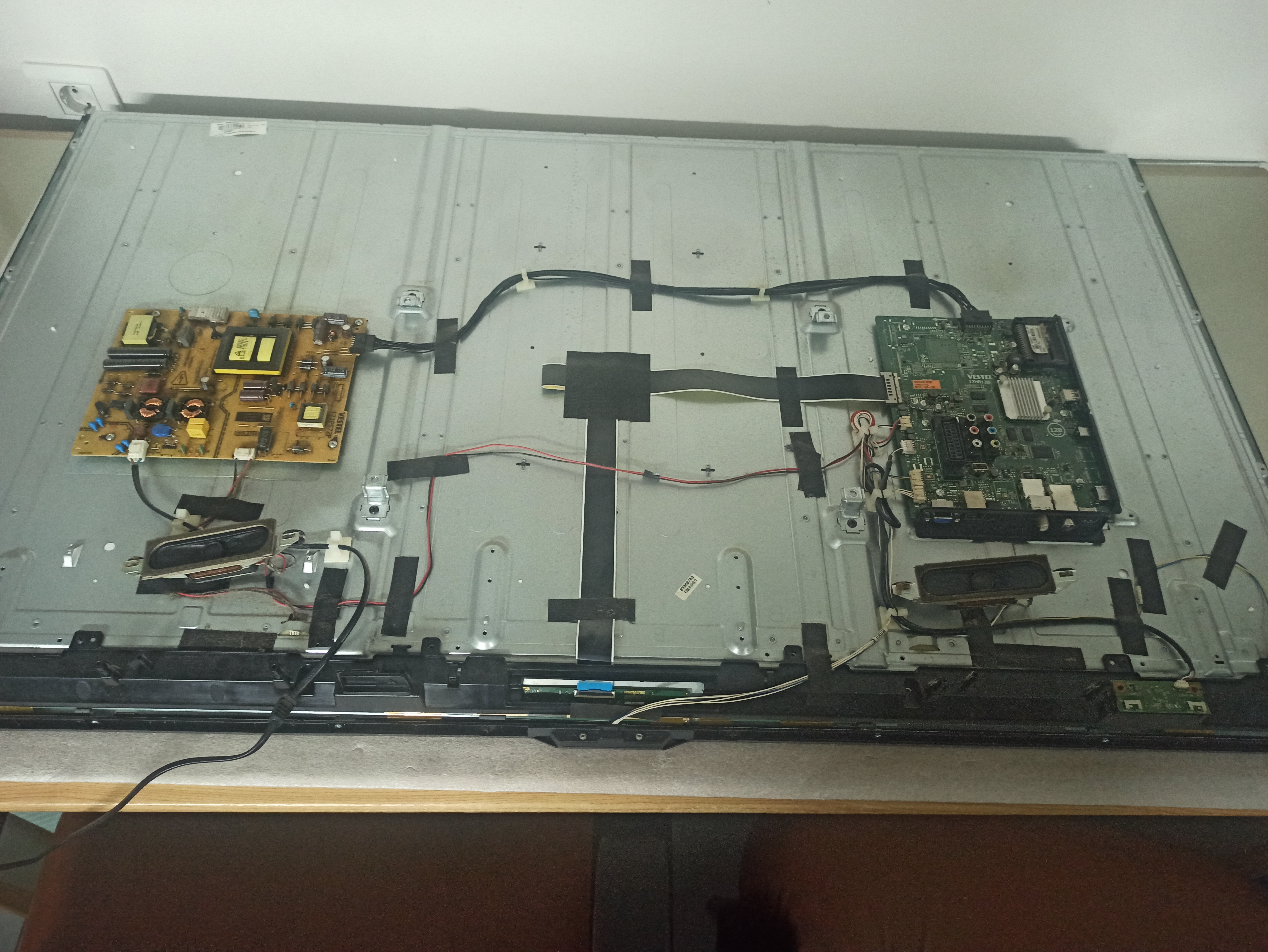

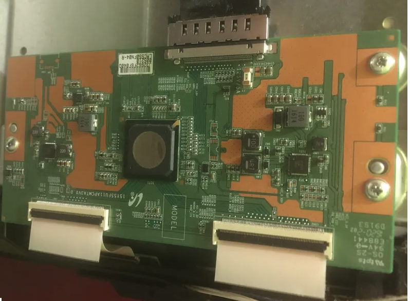

    good night! I have this TV, with quite poor build quality. It has a tcon integrated into the panel, a single flex from the tcon to the panel, and the 2 panel controller boards joined by glued flexes. There is no way to separate them.
    The symptom is that the image is not visible, but the backlight works. How to know if the problem is in the main or in the tcon-panel? I can't override zones.

    Philips 55PUS6031 t-con is not built into the motherboard, it comes separately...

          In the marked place there should be a fusible​. Check if it is good and if they are 12V. Have you rewritten other software?
            fuse ok. It's the first thing I did. I haven't rewritten my software because I don't know how to get it. I understand that you mean doing it via USB format. thank you
