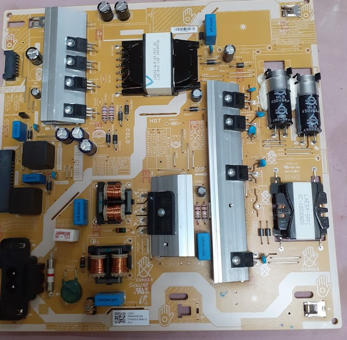

    Anyone has a circuit diagram for this Samsung Power supply pls?
    QP801CS shorted. Blu Cap is not cracked.

    Common fault, replace it and blue cap. If there was 2 of them replace both with both caps.

      I repaired a similar board with a similar problem earlier this year. Search for that post from me if you want some part numbers and other components to check.
