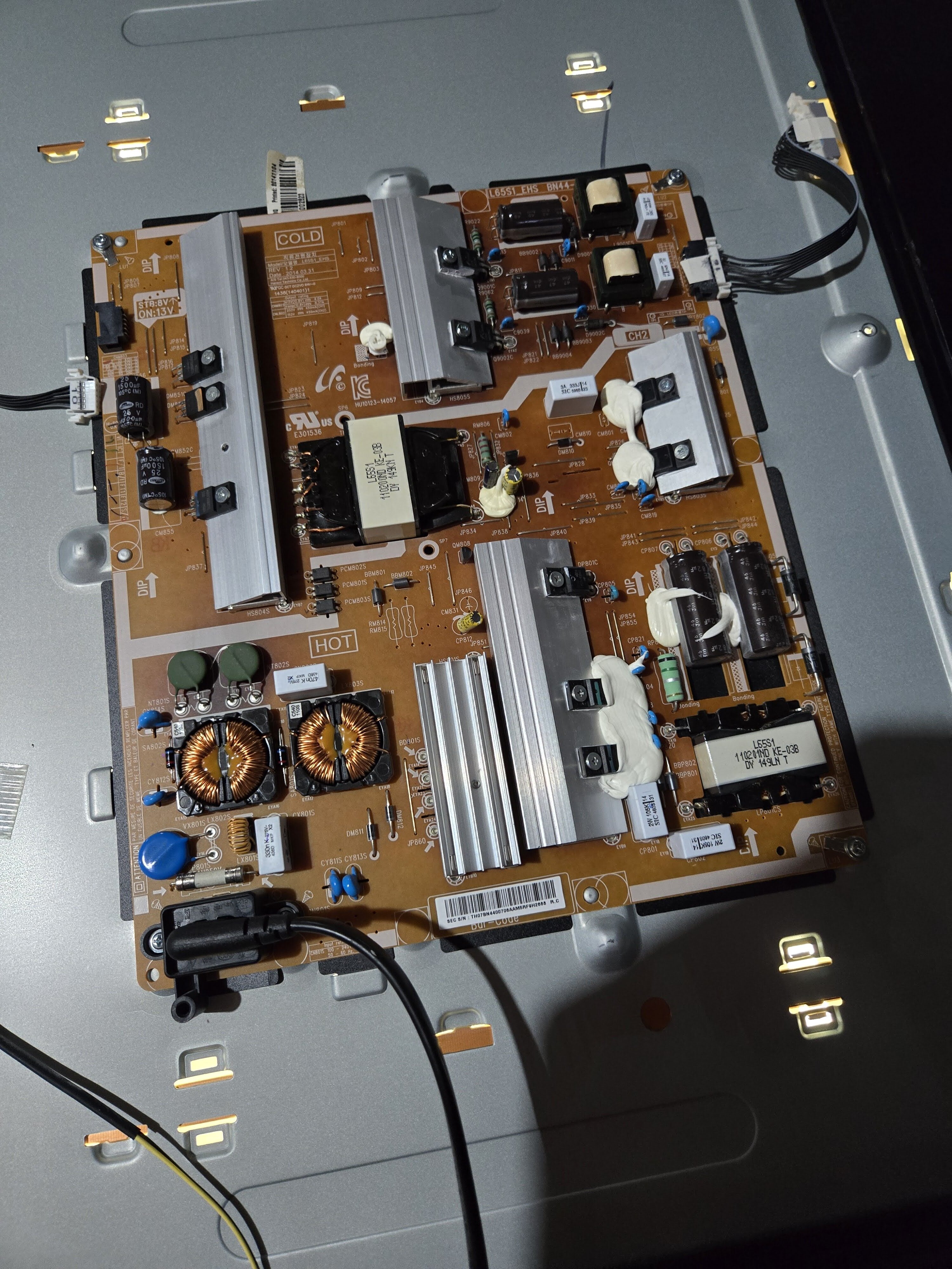

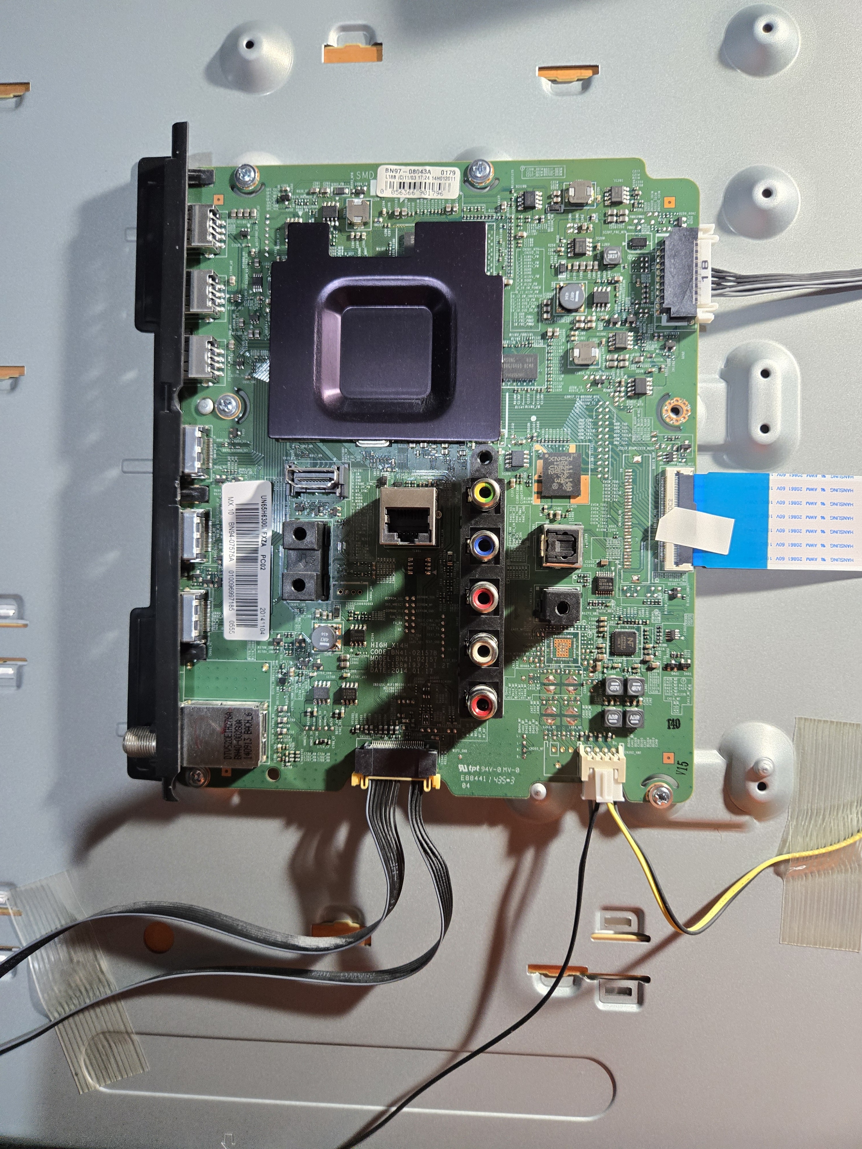

    Hi as you can see from title, I have a samsung tv here that will show the smart tv logo and then no picture after that even hitting input or menu on remote and shows nothing but the backlight still appears to be on. The tv will turn itself off after a minute or so automatically. I'm somewhat confused if this is either a eeprom problem or a bad led strip problem. The power supply makes a pretty noticeable humming sound when it's turned on leading me to believe one of the leds are shorted but idk honestly. Any of you guys have any help for me? I have a good multi meter and can take pictures of whatever you need. I've also replaced entire led strips in tvs before so I kinda know the symptoms of a bad led tv but this one is throwing me off a bit. Thanks.

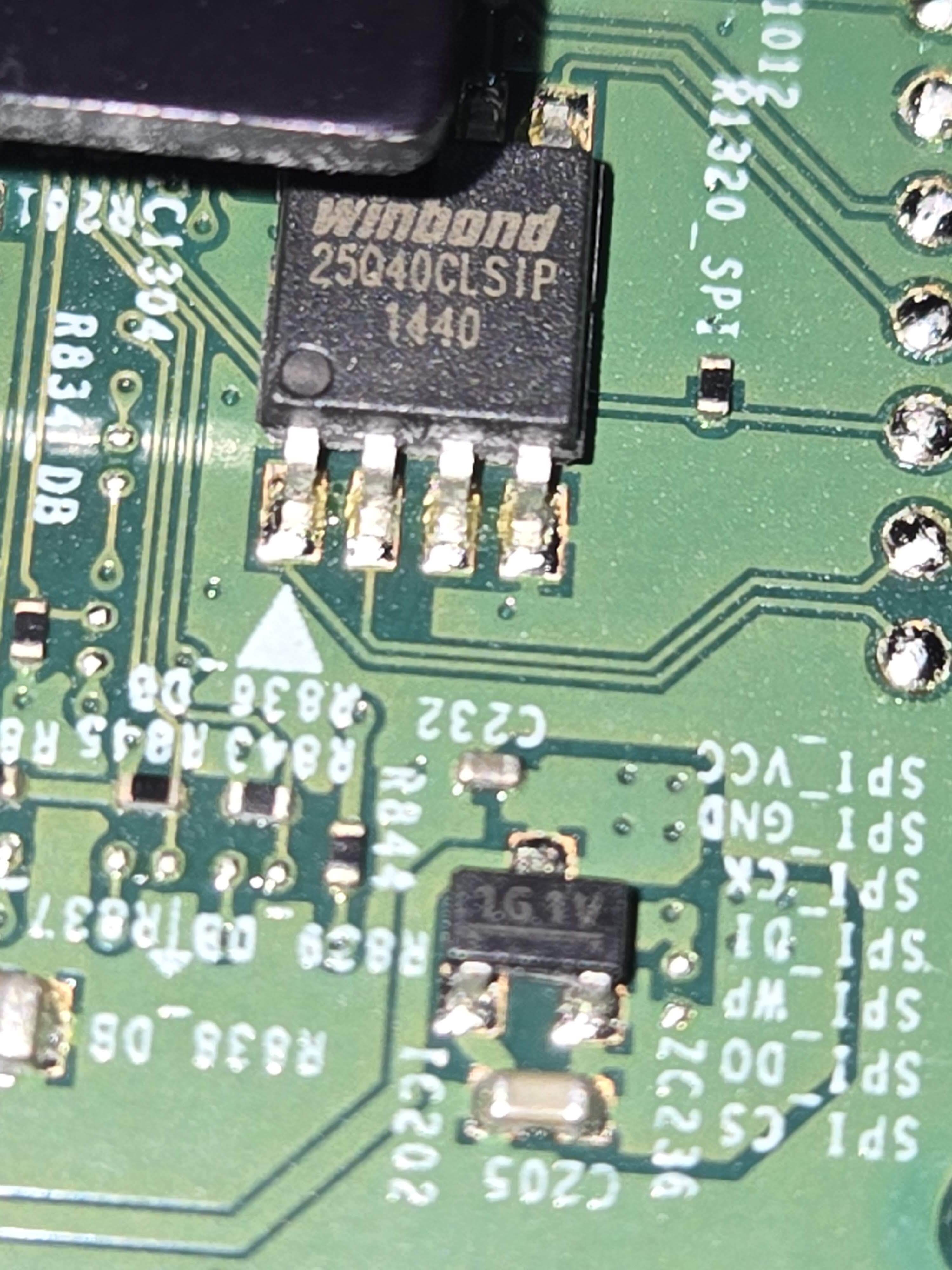

    My friend, there is a 8 pin eprome ic attached to this board.rilace it with the new one same nomber remember you do not need to program new ic place the ic as it is. Thx

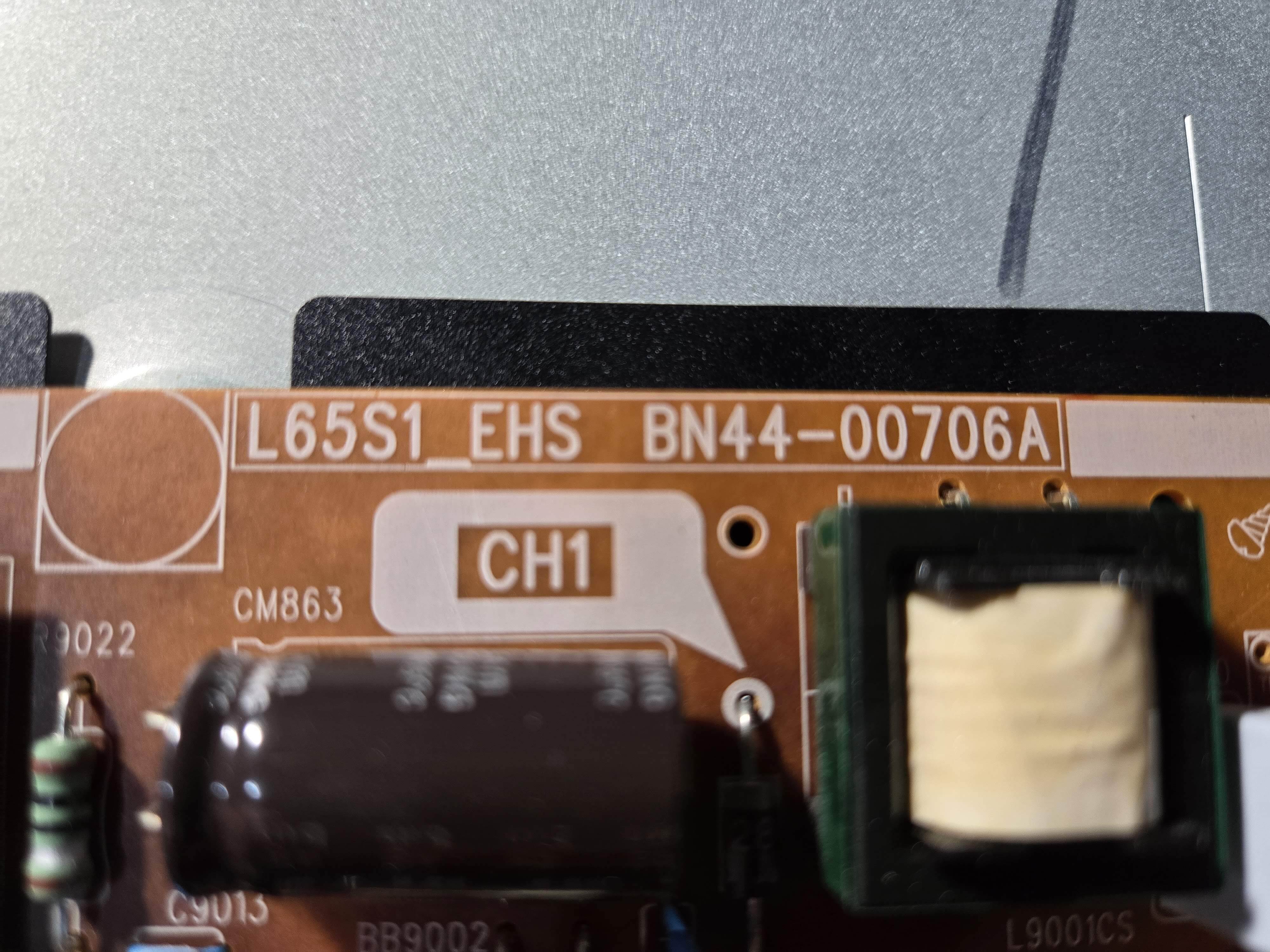

        Post the BN44- code of PS board, so i can search good pictures, or report the list of the PSB->MB connector signals..
        My 2 bets are for Bad leds or bad BGA solder on MB..
            The small chip is a closeup of the eeprom on the motherboard that bholu pointed to may be the issue.

              Originally posted by Diah
              you have multi issue to narrow the issue

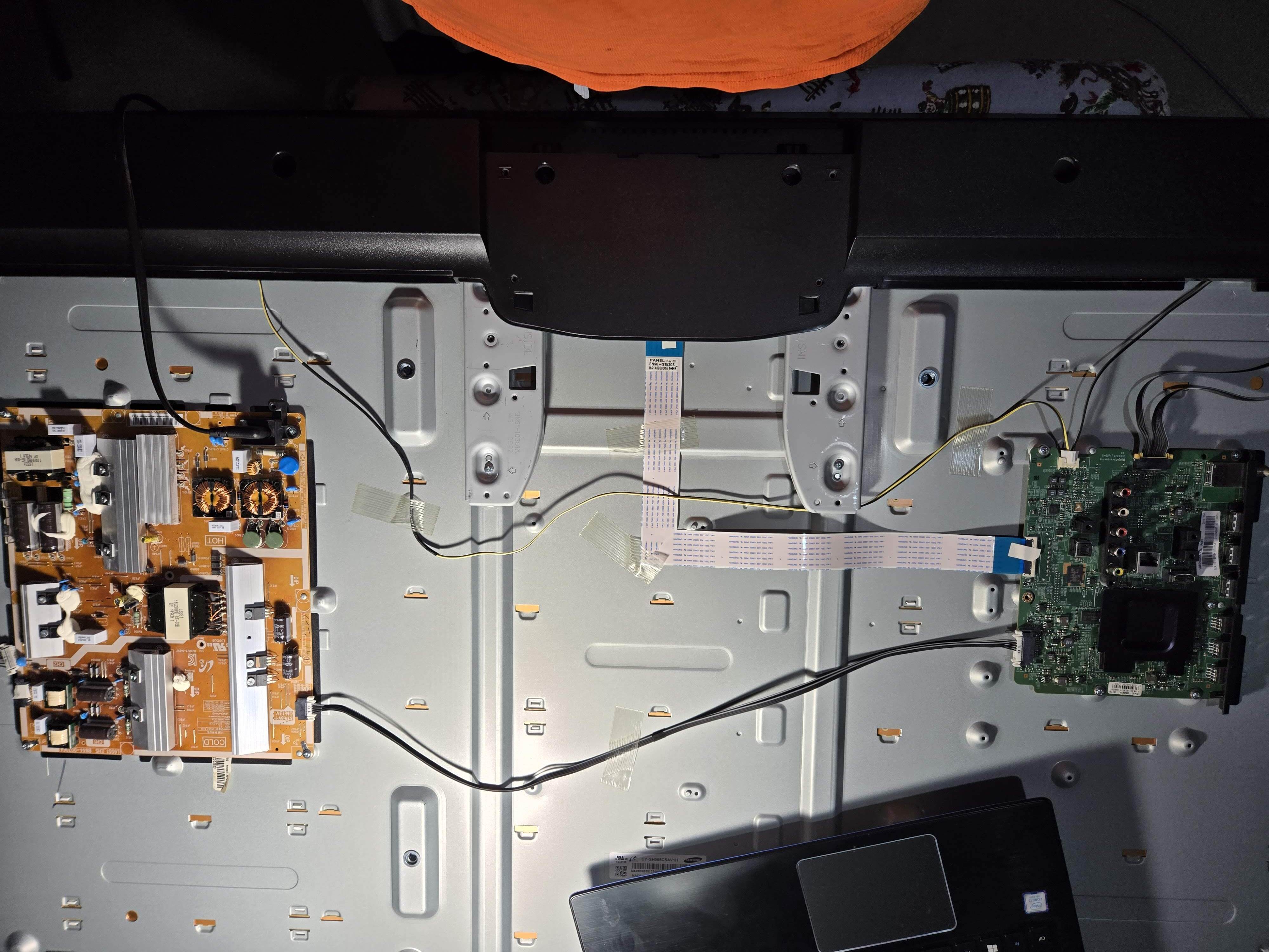

              1- disconnect the socket between mainboards and powerboards, plug in wall and see if the BL come one and remain... if not... you have many burned area at the powerboards... take it out from the TV and inspect resolder all parts again at any heated burned area at the hot area and cold area... be careful it will still charged at hot area
              Disconnected mainboard and left just the led backlight plugged in and the leds light up and remain lit with no mainboard attached.
                use freezer spray on the SPI winbond and the NAND to see if it boot complete.

                    his issue boot loop, the stage at loop he had just the logo.. this part at SPI, the rest at NAND. if NAND didn't response the SPI will repeat the start script.. freezing both first then each alone later... or you are waiting from me to write replace mainboards !!!
                                Froze the shit outta those both chips to no avail. Used almost a whole can freezing the whole board and nothing changed. Tv turns on displays the smart tv samsung logo and screen looks like it is on but no picture comes out and no visual. It then shuts off automatically after a minute.
                                    it sound firmware or dead eMMC , try download from Samsung usb firmware and try it
                                      Froze the shit outta those both chips to no avail. Used almost a whole can freezing the whole board and nothing changed. .
                                      You were hoping for a miracle; freezing cannot restore the data in the chips; only a programmer will help.
