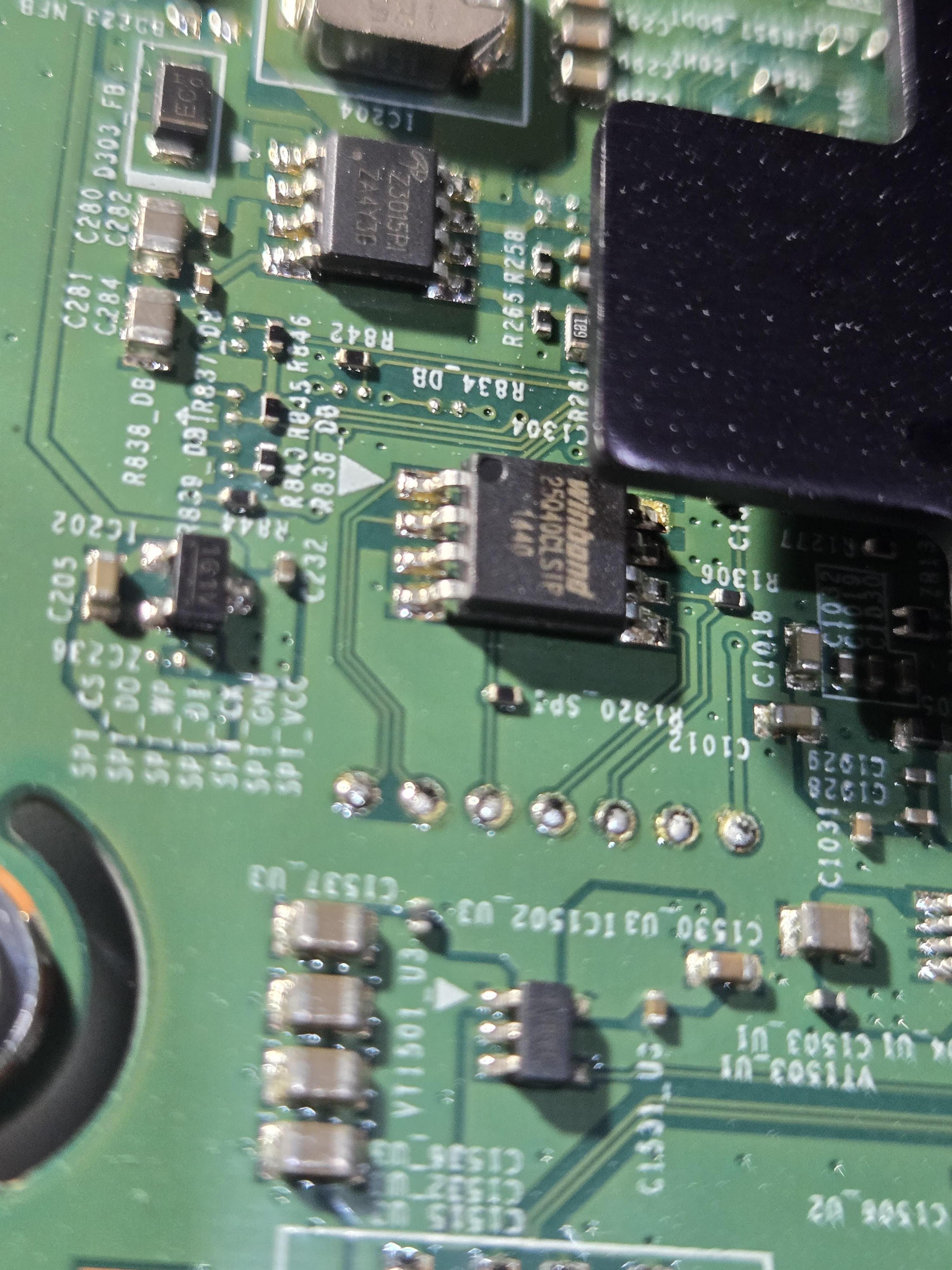

Samsung/UN65H6300AF LOGO APPEARS AND SHUTS OFF

    it sound firmware or dead eMMC , try download from Samsung usb firmware and try it
    How would I go about installing new firmware when all I can see when the tv turns on is the samsung smart tv logo and nothing after that. Is there a way to reinstall firmware without having any display on the tv?

      well to tell the truth its hard ... in yours case only replace mainboards ..... but you can try this
      go there and download firmware version 0000 its German one , which we use it to downgrade then we can install any other firmware or root the TV.
      in yours case you need for yours H this one T-MST12DEUC.zip
      ready USB stick as small capacity as you can no more than 2GB.. formatted in FAT MBR mode... and try different way by just the last file upgrade.msd to put it on the stick.... or image.... or the complete folder of T-MST....
      good luck

        In fact there's no way!! Samsung update via net / usb needs entering sub menu..

              This won’t work with Samsung, it doesn’t have a recovery mode, firmware restoration, if you have the cheapest CH341A programmer, then you can try to reprogram the spi flash 25q40cl chip, if it doesn’t help, then sell it, since the node will already program the eMMC, then here you will need an expensive programmer to work with eMMC and knowledge... I will provide you with the firmware for 25q40.

                yea, I have a replacement 25q40 coming in the mail. The one guy said that it doesn't even need to be programmed which I find hard to believe. But yes I would much appreciate the firmware for that chip and I'm going to pick up this programmer.

                      The problem here is not the bga soldering, the problem here is a malfunction of the spi, eMMC ("H" series) firmware.

                          Spi sold on ebay are programmed... but some used one size dump for example 50 and sell it for all size.
                          however since yours 65 , it will worth to look at the panel edge boards... you may will find on left and right side U ribbon connect 2 half side.... if this the case disconnect on atime and turn on.. just to be more sure.

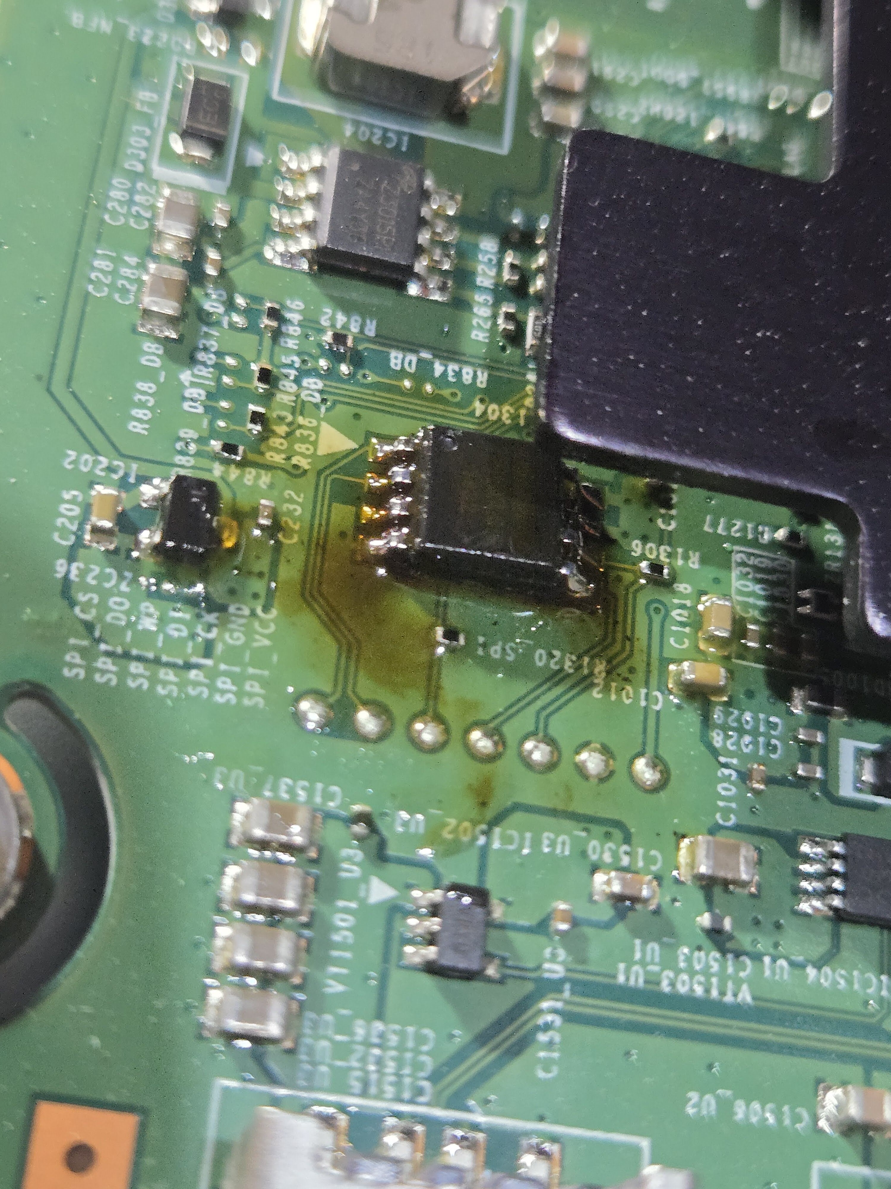

                              Well bholu was absolutely correct. I literally thought this wouldn't work but I bought a Winbond W25Q40CLSIP erased eeprom with no programming what so ever. I just got it today and soldered it in and really had low hopes of it fixing my issue. I soldered it in anyways thinking I have nothing to lose. Well when I turned the tv on after installing new eeprom it did the same thing smart logo then blank... turned it off and turned it back on and wouldn't you know it that it came alive right before my very eyes. What a great surprise. Thanks to all you guys for your help.
                              Edit: and yes I'm going to clean up that rosin flux all over the board lol.

                                  Well I spoke a little to soon as it did power on and somewhat function but it kept turning off and freezing. It will display a image at least but like I said after 3 mins restart itself for no apparent reason. So it looks like a motherboard replacement is the only thing that will fix this tv at this point.

                                        Well just a little update I put the replacement motherboard I bought offf e-bay in and it's working great now. It no longer shuts off every 3 mins like it did when I replaced the eeprom memory chip. So I would call this fixed. Now all I have to do is replace the psu as it makes a horrible buzzing sound that makes watching tv unbearable. And the one other issue is some of the led diffusers fell off so they will have to be re-glued but no big deal. Main problem fixed. thanks everyone.

                                          It was the eeprom chip not the memory chips and it was easy just put some flux on the chip flood it with lead solder (both sides) and heat both sides up and slide the chip off, Then use de soldering braid to make the pads flat and put new chip in no big deal.
