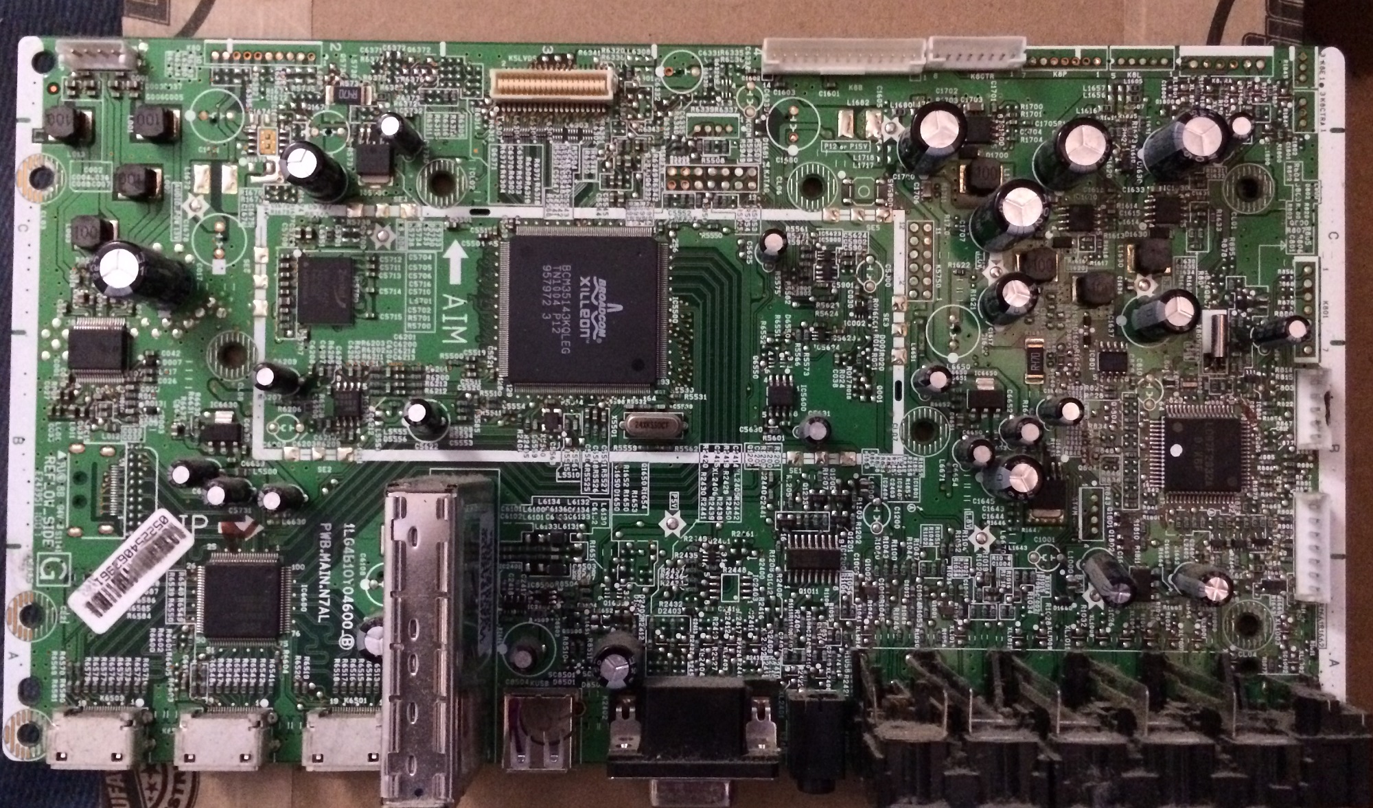

    Hey I just picked up a DP50740 Sanyo. Once the power button is pressed the tv would flicker for a second and then clicks. Then it would cycle like this every 15 seconds.
    I've been reading online that this is a common problem with the main board and there is an available repair kit for it.
    http://www.coppelltvrepair.com/p/111...d-pwbmainj4fkf
    Upon further research the best I found was that there are 3 SMD components on the main board that need replacing. Does anyone know anything about this problem and which components they are?

        I just replaced the entire main board. The TV turns on fine but now I have another problem...
        There is an annoying static sound over the audio whenever louder sounds play. Its very annoying as it almost sounds like a blown speaker. I tried switching out the speakers with others that I salvage but the static is still there. I tried 5 different speakers but no luck...
        I looked near the speaker outputs on the mainboard and saw the STA333BW chip for the audio processing im guessing. I took it off and replaced it with the one of my old main board. But no luck either... static is still there.
        This is so annoying having fixed one thing and having some other problem.. is this still a problem on the audio circuit???

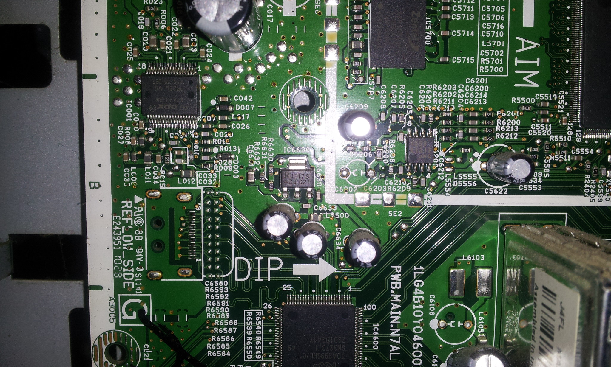

          I have one doing the same thing too. I thought I had a bad 1117 LDO IC 6630. because there was not output voltage. I replaced it. Still dont run. Should have followed instructions in manual I found on trouble shooting the TV. The 3.3v is shorted to gnd. Should have checked output pin to gnd and I would have seen it earlier. IC800 (sub-cpu) monitors voltages for problems and kills the PS-on comand. On my set evidently it almost looks like the IC001 the STA333BW audio amp is shorted to gnd. The other LDOs
          were not shorted. I get the lowest resistannce on the 3.3vdc line as I get closser to the
          audio IC. It and the circuits associated with it use 3.3vdc The audio amp also uses 13vdc. Next week I will get my LeekSeeker out to pinpoint the short. The IC001 had lots of pins shorted but the leads are soo close together it hard to do with fine pointed leads and a magnifier/light. Dont know if I was actually across two pins thinking I had more grounds than the print. Guess I could just unsolder it and see if it goes away but sometimes parts dont come off and go back on very well. Normally if I remove it, I replace it.
          • Ltank
            • Jun 2013
            • 776
            Re: 50" Sanyo DP50740 Cycling on and off (Common problem?)
            Audio Amp and LDO

              I have same problem on mine i believe it is main board but i am trying to fix it at compentent level. I dont think it is the regulators.also i check on ic800 pin 48 i am getting a voltage reading of 4.5 which tells me that power fail circuit is good and also i have green light and tv responds when i push power button.i also have all my voltages in my power supply.any ideas

                Here are my voltages on my regulators
                Ic6630
                Pin1 .570
                Pin2 1.821
                Pin3 3.302
                Ic6650
                Pin 2.097
                Pin 3.349
                Pin. 5.042
                Ic1660
                Pin1 7.824
                Pin2. 9.072
                Pin3. 11.955
                They are regulators 1117s adj009 do these voltages look ok.the one i have my doubts on is ic1660

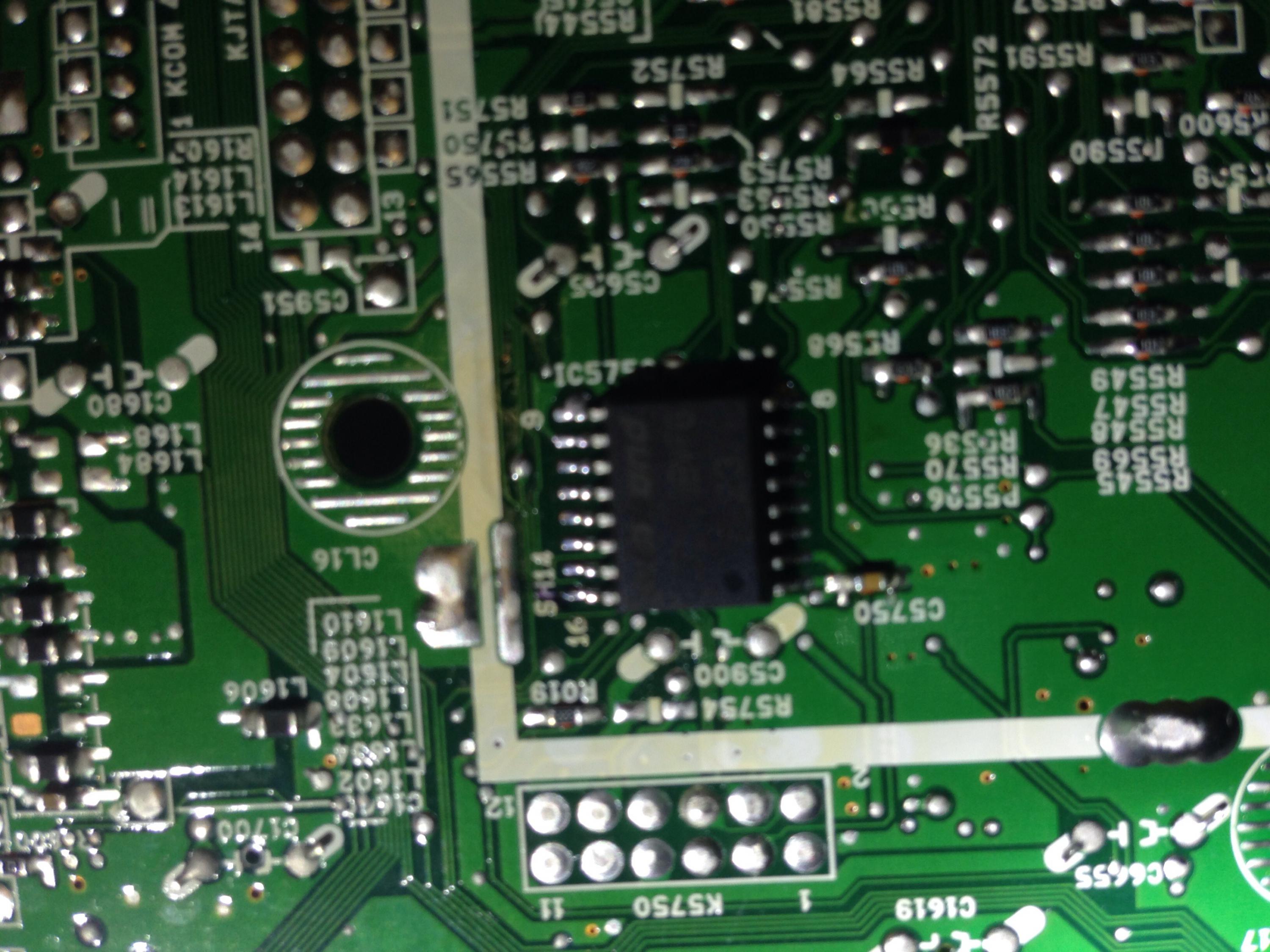

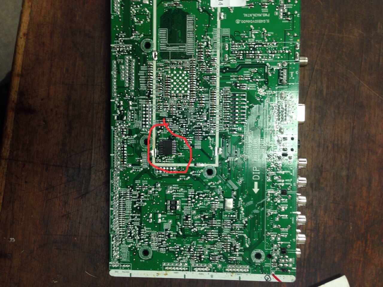

                          I sent mine out to get fixed a placed marks on items i suspected might be bad.he did nothing to regulators but the only thing i did notice he did do something to ic5750 new part number on it is 25q128bvfg.i assumming by what i can tell he replaced it.You can order one on ebay just make sure u order the one for your model number for example mine is dp50740-00.the last two digits are important since the eeprom will be programmed for your model.just make sure it says it is programmed and not a blank chip.hope this helps u.
                          • ricosavy
                            • Jul 2012
                            • 457
                            • united states
                            Pic of chip location

                              Well after installing part still same problem even thought place i took it too said it was bad.the only part i did not have to test was the sc board which now i am thinking is bad too.so looks like i have two parts that are bad.tnpa5063 ab will see if i can repair the part.
                              • ricosavy
                                • Jul 2012
                                • 457
                                • united states
                                Had a tnpa5063 no suffix off a tc-p50c2 put it in and that fixed my problem the sc board was also bad. Tv is now up and running.
