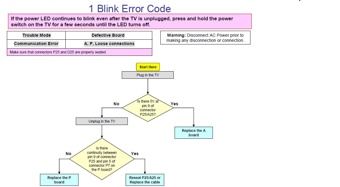

            Just dug into an 42X1 manual which is the same generation using a TNPH0800 A board and the 2009 troubleshooting guide. fault description a little different than I was expecting.
            SOS1, No particular checkpoint, Panel status, STB 5V SENSE timeout.

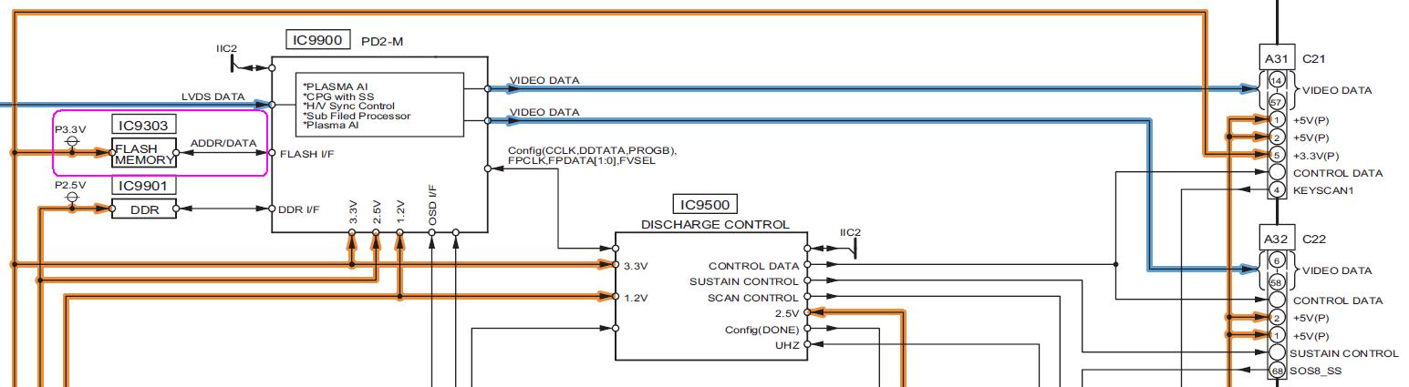

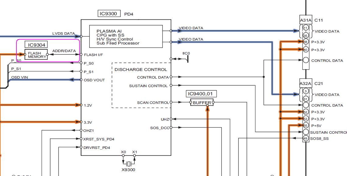

            Also I'll have to correct myself. After looking at the manual , what I replaced was an 8 pin chip labelled flash memory , ADDR/DATA which goes to the PD4 processor.
            On yours though it's looks a different setup and the IC that's labelled FLASH MEMORY, ADDR/DATA is a 48pin and in the schematic called the PD2M ROM.
            So me trying to suggest which chip to take a chance with should probably be disregarded.
            Still expect A board issue but they do offer this flowchart for 1blink, unusual as generally they just say replace A. I think they've made a typo mentioning D25, should be P25 I would think.

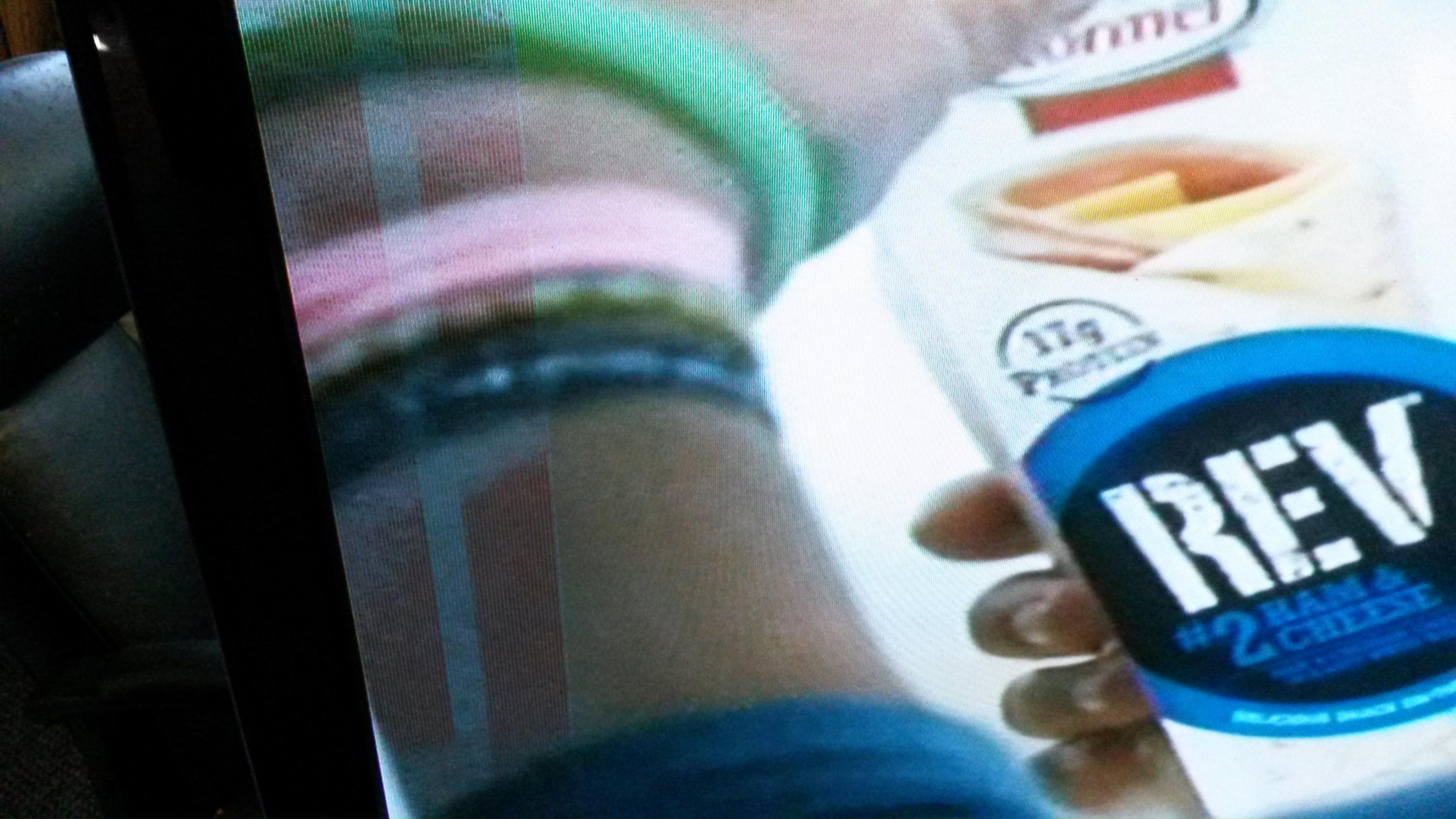

              I got the mainboard in and replaced it. TV comes up, but now on left hand of display, I get vertical lines. Is there a config for the mainboard I have to perform, or is there somehting else wrong with it? I reseated the cables to the board and no change.
                Re: TC-P50C1 Single Blink
                I would check connections from C board to PDP (panel) are properly seated, that far left one in particular. Note, do NOT reseat any connector on there with power applied or you may fry the panel.
                I had a PZ80 doing this too and it turned out when I'd removed the A board I'd sliced through one line of a ribbon cable. Powered up but either half screen was missing (cable one way) or one bar was pink on every 2nd vertical line in the image. Managed to get a replacement ribbon and all was well after that.
                  Reseated all the cables. I'm wondering if it's a possible bad connection from the board.
                    Even the ones on the C board to the panel? Checked all cables are intact? Could be bad C board then.
                      C board is on the bottom correct? My first Panasonic, can ya tell? I reseated both on the A and the C board. There was a screw down against the c board when I brought it home, behind the A board, it may've scratched a trace on it....Darn!

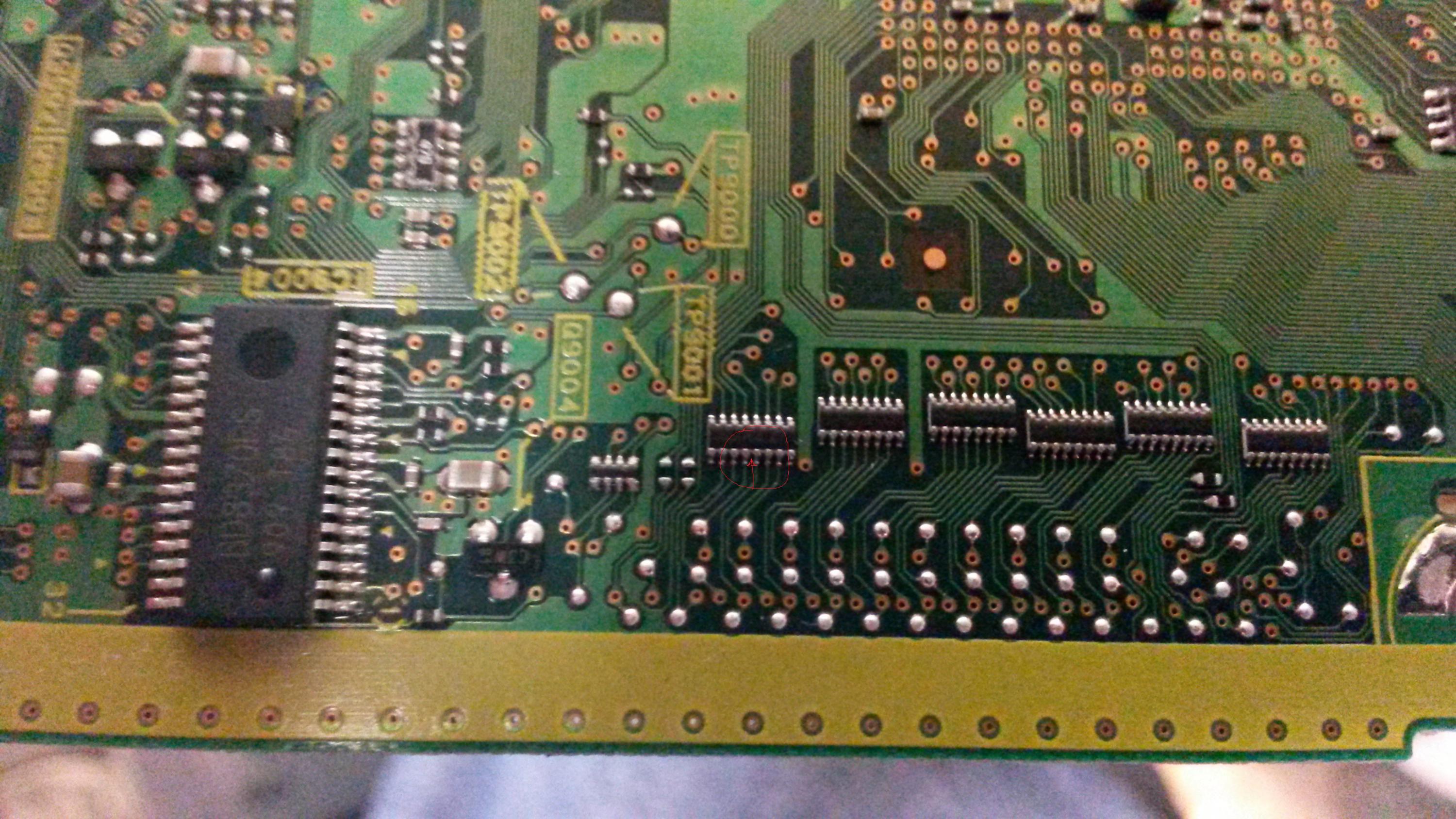

                        Fixed it! It was the replacement A board. I looked on the back of the board where the cables plug in, I saw a chip that may have been reworked.
                        There were two pins touching. I was able to take a very fine point and clean the two legs, and the picture looks 100% now. The picture I'm attaching is the old bad board, but points out what points were touching.
                        Let's make sure the rest of the tv works, but thanks for everyone's help so far.
                        Brian

                          They're resistor banks. interestingly i bridged one of those similar repairing an A coming from a flash chip by error and created 13 blink.
                          Good job finding that, I was wondering if it was still A looking at the regular lines.
                          What made you look there?
                            I have a habit of looking at boards for defects before I rip into them. It didn't look right to me, I thought it was my eye's playing tricks, so I grabbed a jeweler's loupe to get a close look.
                            I looked at that exact spot, it was on the other side of the where the ribbon cable goes to the C3 board.
                            I don't know if it was a repair or if it came out of a tv like that. It looks like the solder itself was flattened out, almost like it was sitting on something or something hit it.
