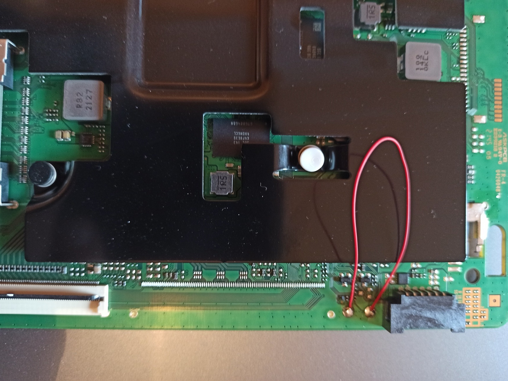

    Hello Community,
    As part of an ongoing learning project, I'm trying to perfrom a panel test (where, according to some, you jump 12v to the (Tcon) then jump 3.3V to panel test pin on the FPC connector). For the model I'm testing with, I'm unsure of where the test pin is located (providing there is one). So, I'm after some help to locate it. Here are some shots of the board (note mainboard, Tcon combo board).
  • Answer selected by learnmore at 03-20-2024, 03:09 PM.
    viking6791
    • Aug 2018
    • 44
    • My Desk

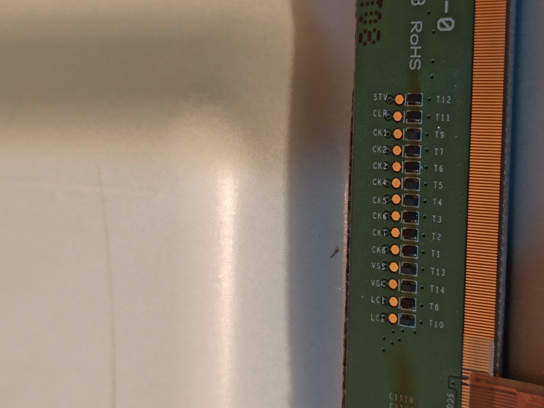

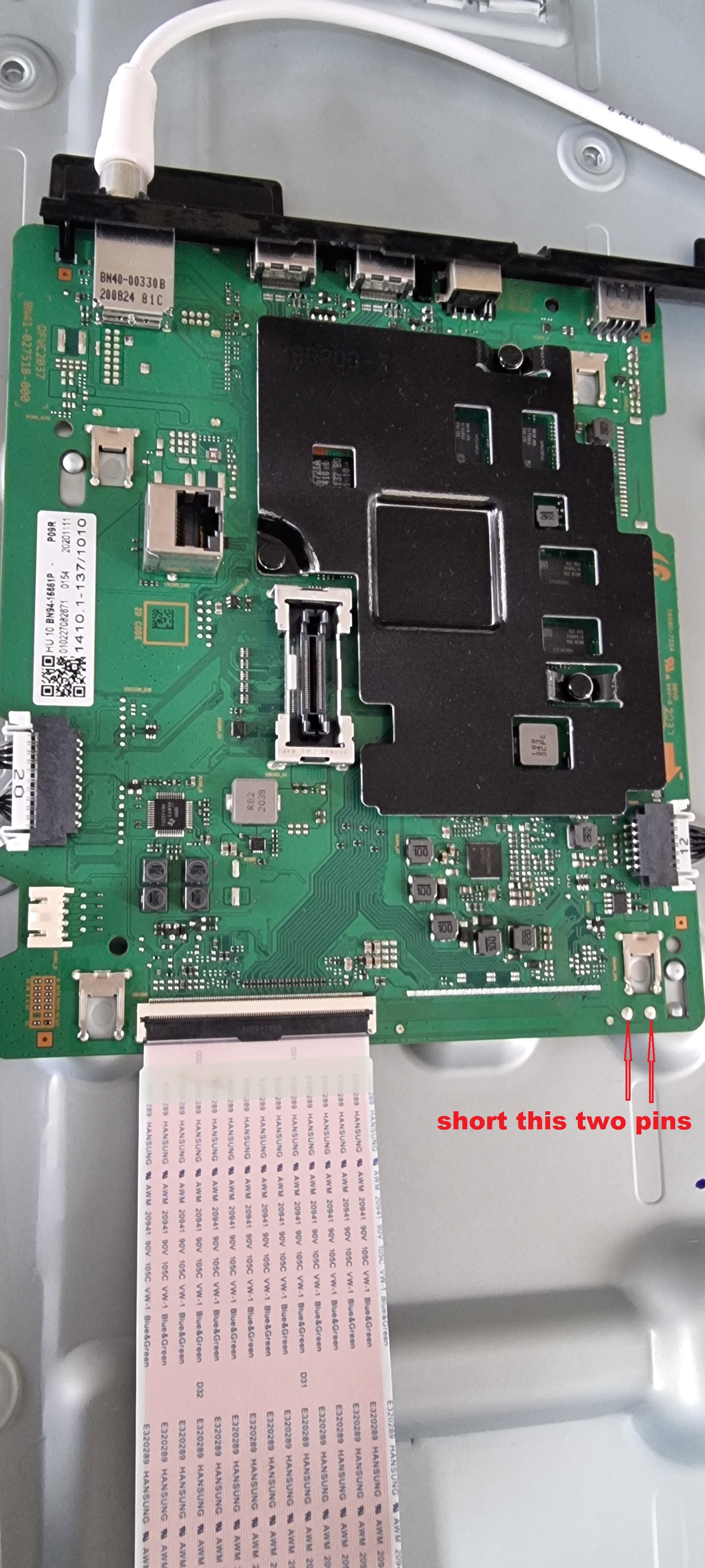

    See atached picture or folow this link https://www.badcaps.net/forum/troubl...ines-on-screen

        Thanks viking, I had a look at your post. It's def a panel issue for me. In the post you signposted me to you tell the OP to remove and mask to Clk signals from the board bridging ribbon cable. I know from experience this works. However, for me, it's always been trial and error and checking the image. How can you exactly track the Clk signals to the specific points on the ribbon to mask in your example? I see some cut the signals, but I like the idea of tape that can be moved and removed.

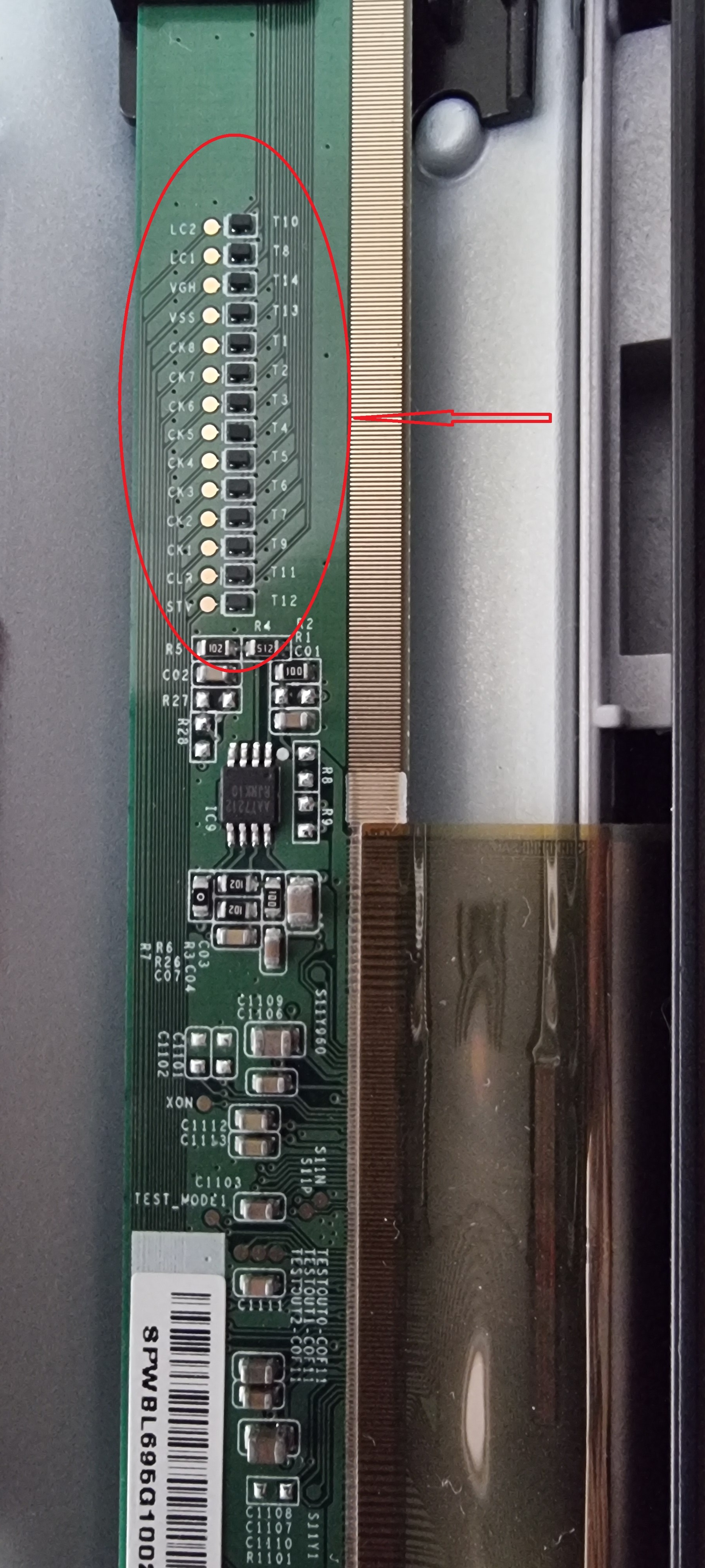

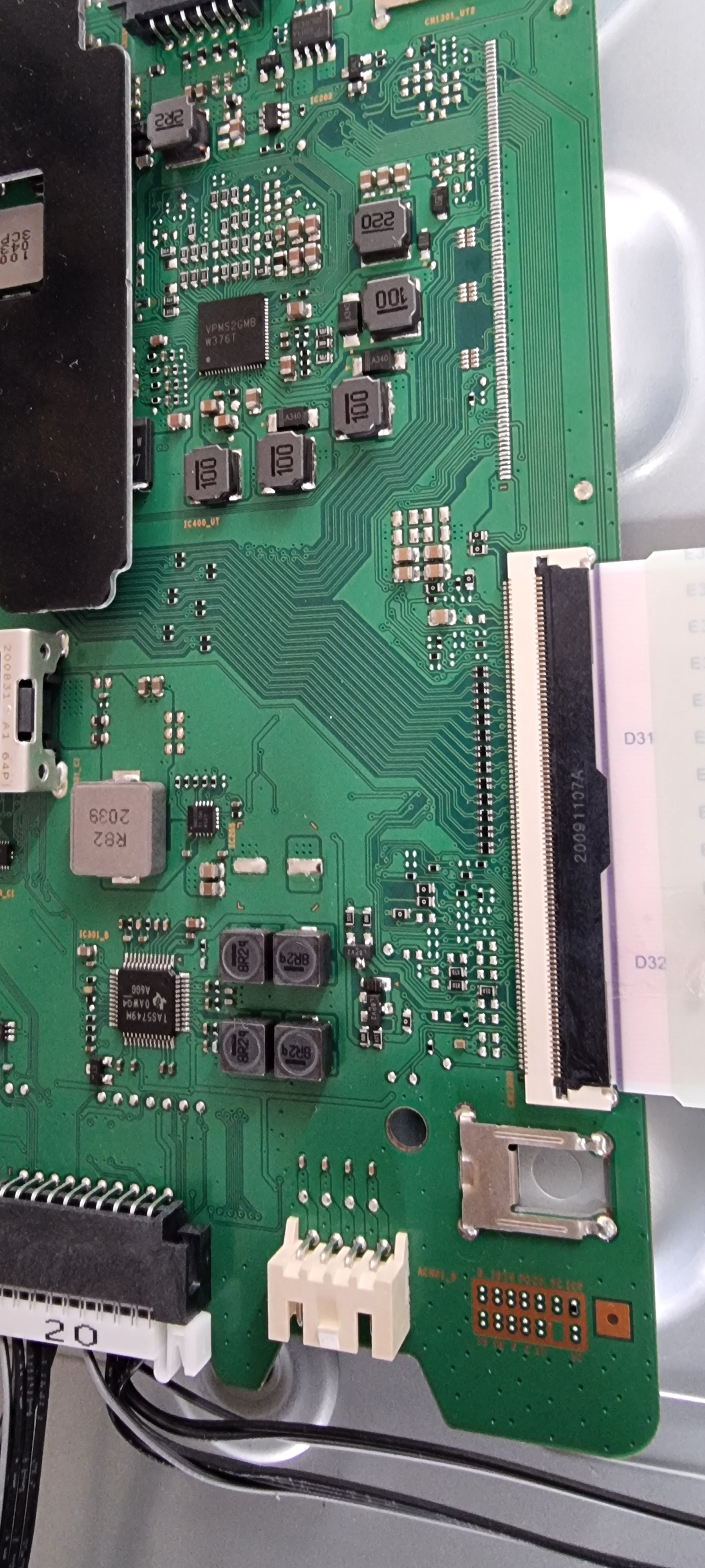

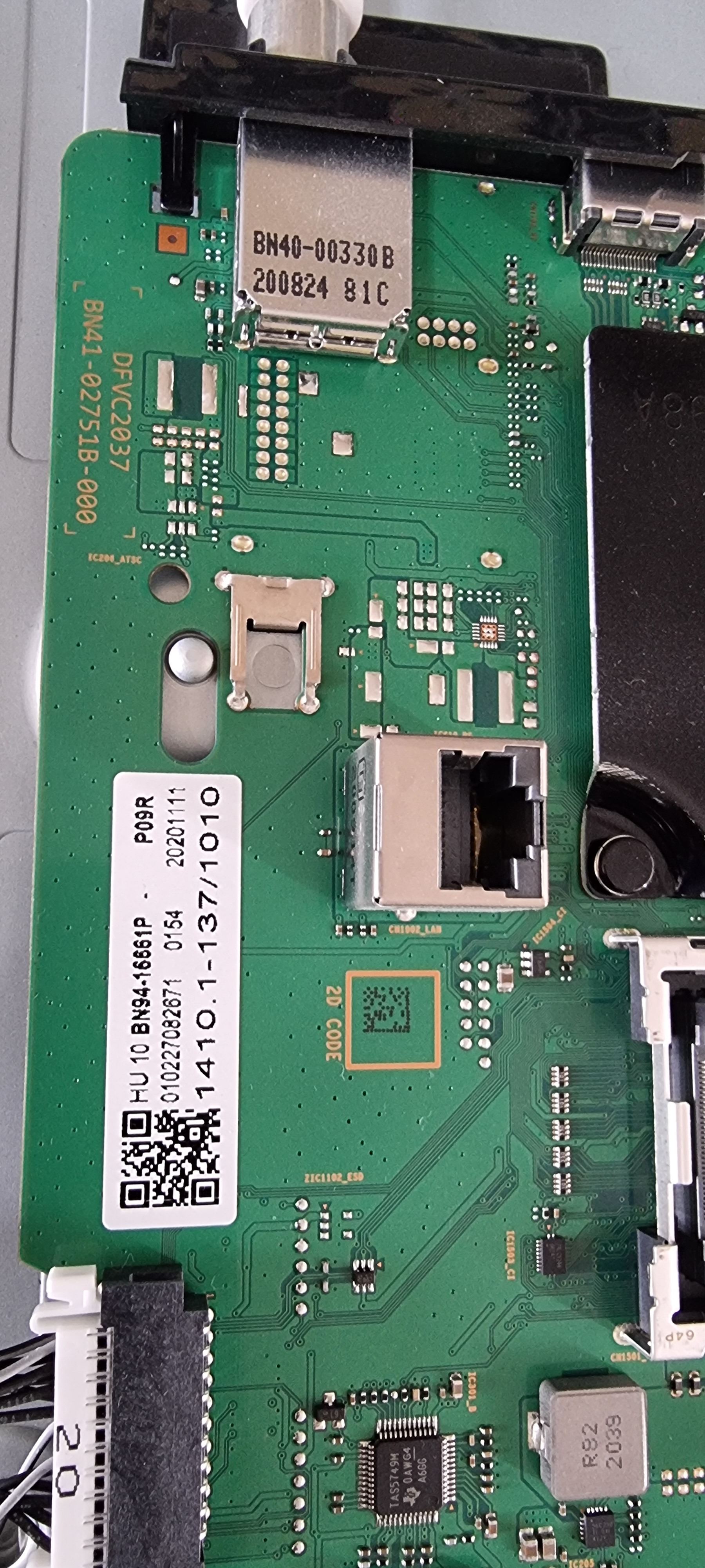

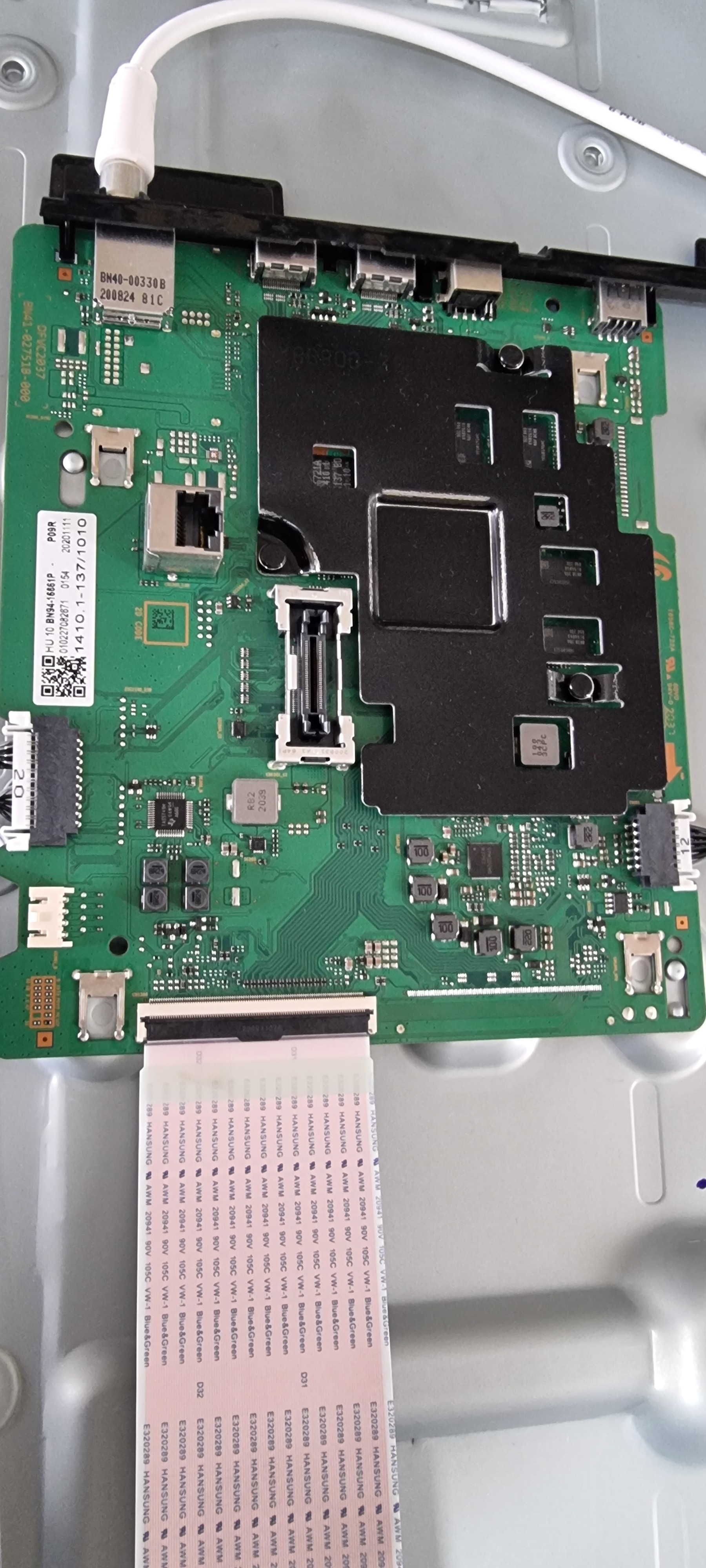

          Hi learnmore, on this forum there are many discussions about the TV series Samsung TU, Qled and others that have problems with the display.
          Take a photo of the two boards where the two ribbons are connected and post them here. I will guide you what to do after I see the two pictures.​

            Thanks, photos are here: https://www.badcaps.net/forum/troubl...on-a-bad-panel
            Like I said, got mine to work but look so learn how to block lines with precision rather than trial and error

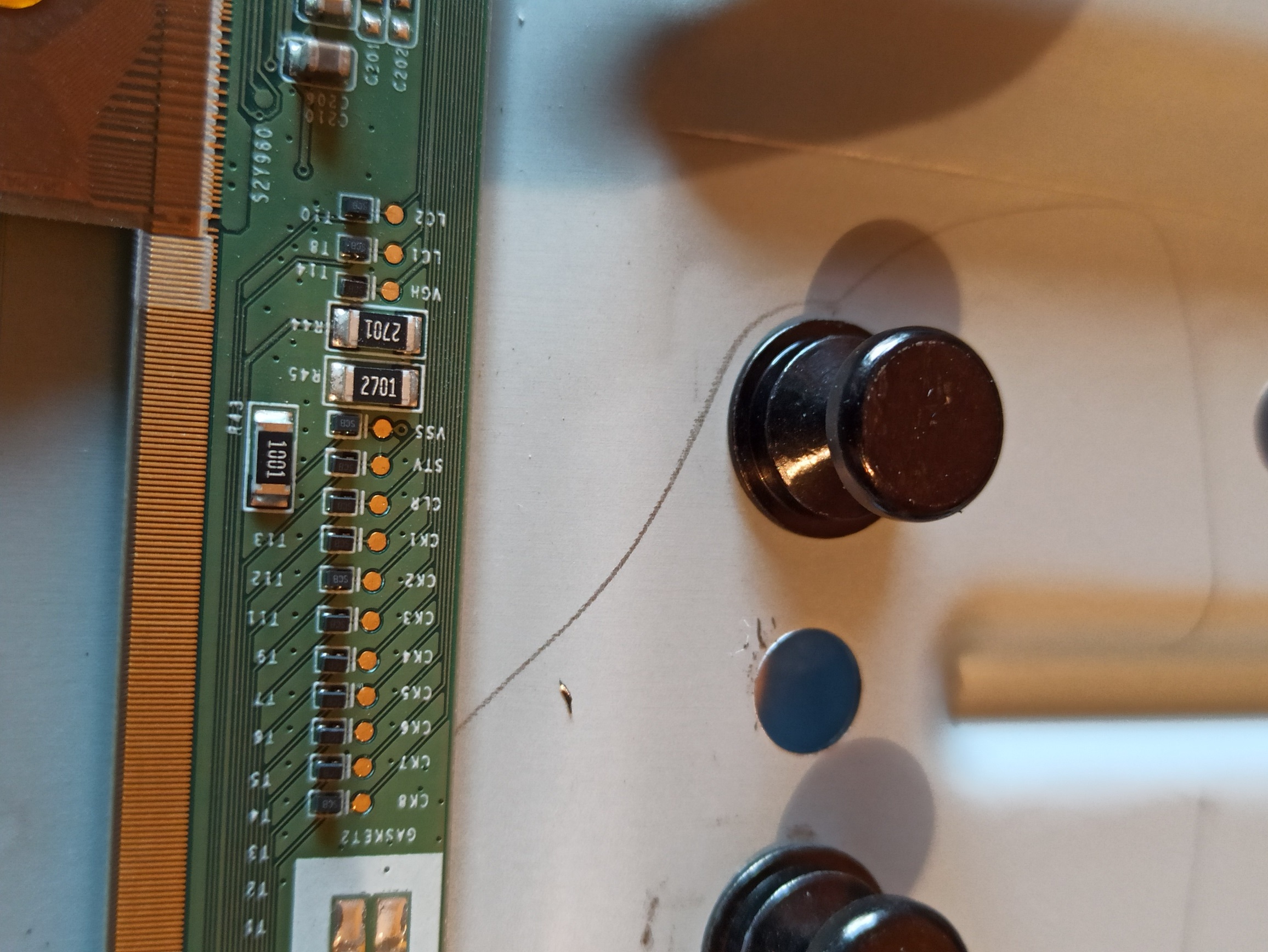

              You will find these signals on both sides of the display, if you do the jumper test at Tcon, disconnect the ribbon from each side one by one and you will have an image only on the side without a defect. Usually with this type of display as in the attached photo, I check with the measuring device on the resistance field those data and voltage lines one by one, the resistance between any line must not be less than hundreds of k ohms. The test can also be done in tension, but there are no values given by the manufacturer for this, everything depends on how much experience you have and intuition. Start by isolating the VGH voltage in the faulty part and see what reaction you get. I have also isolated some CK signals but it is not a rule which of them has problems and generally on the right side as you look from the back of the device.

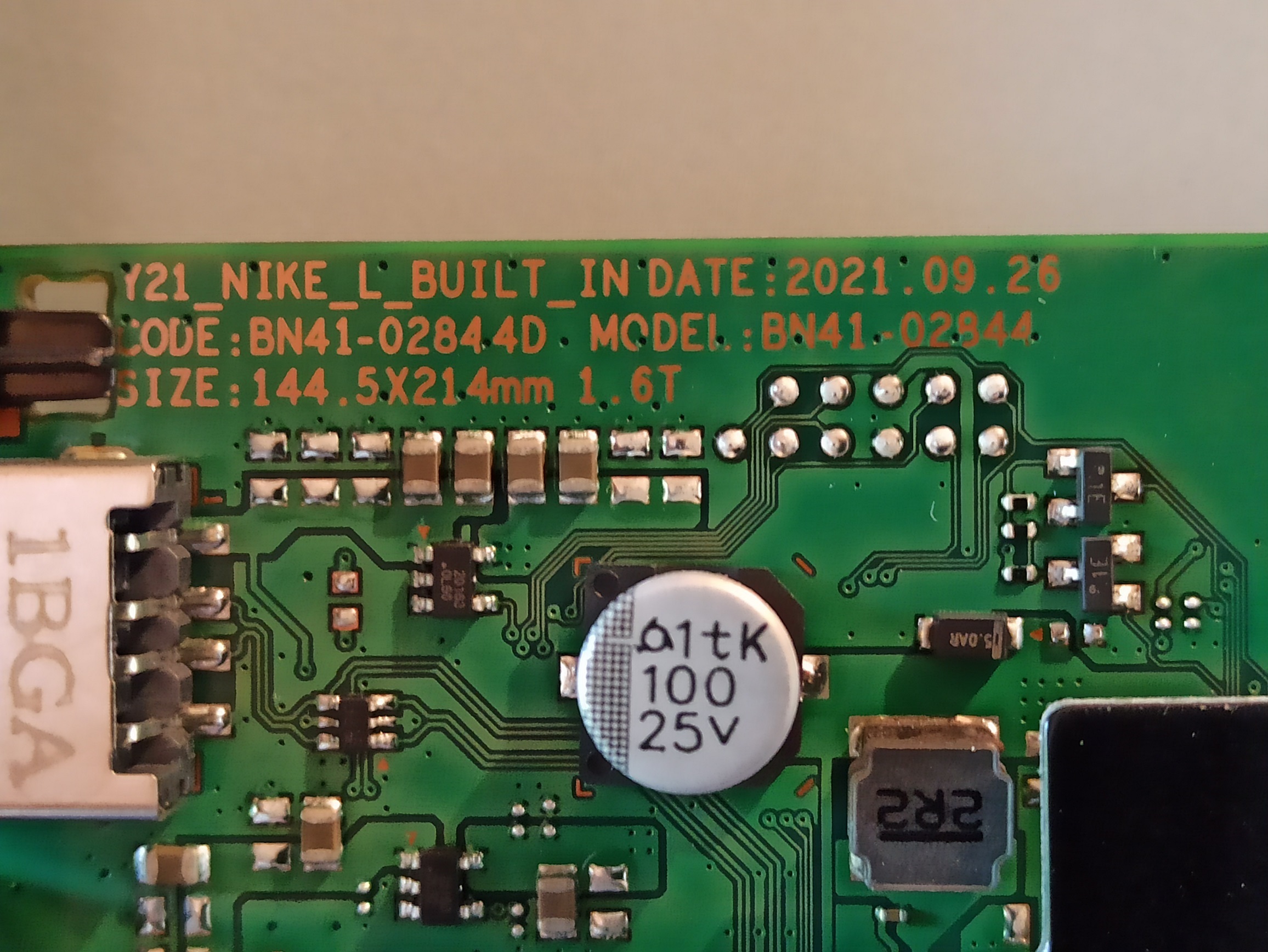

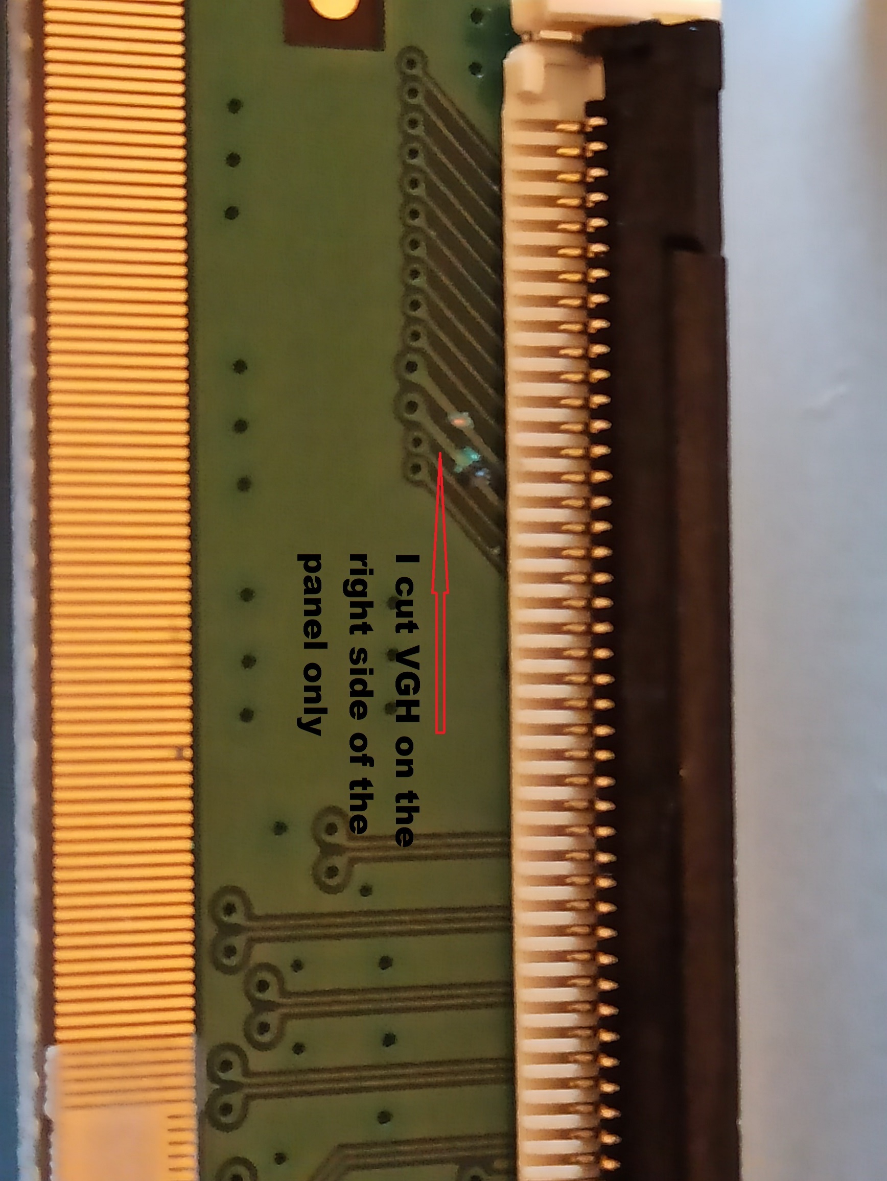

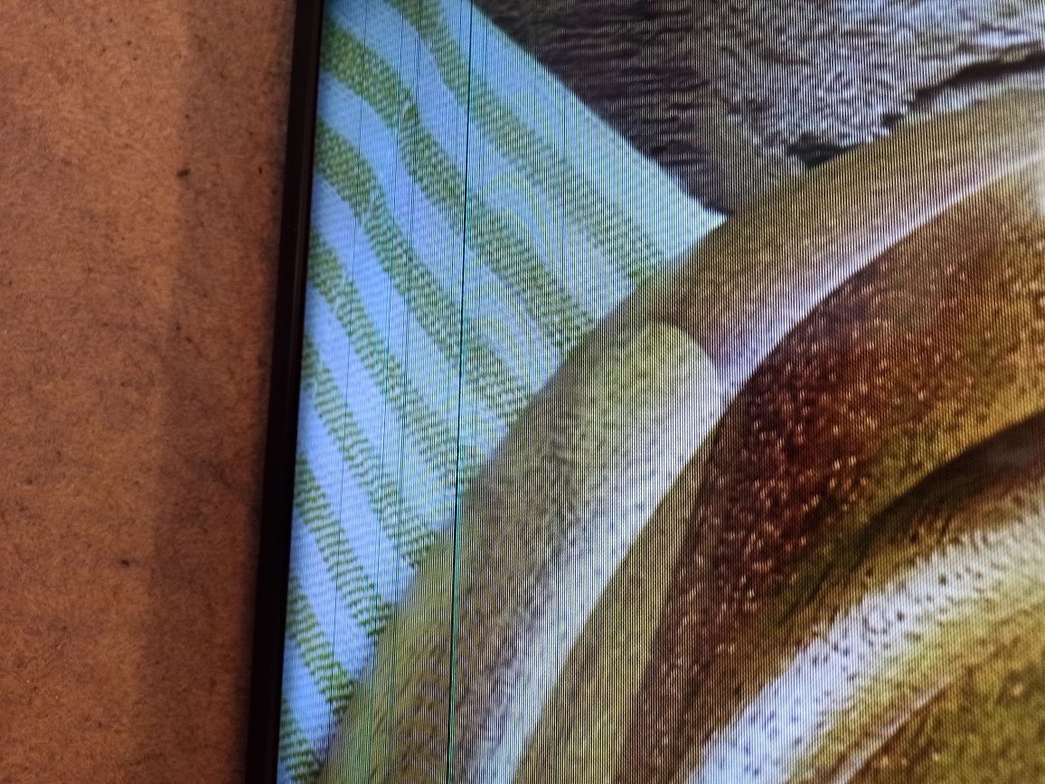

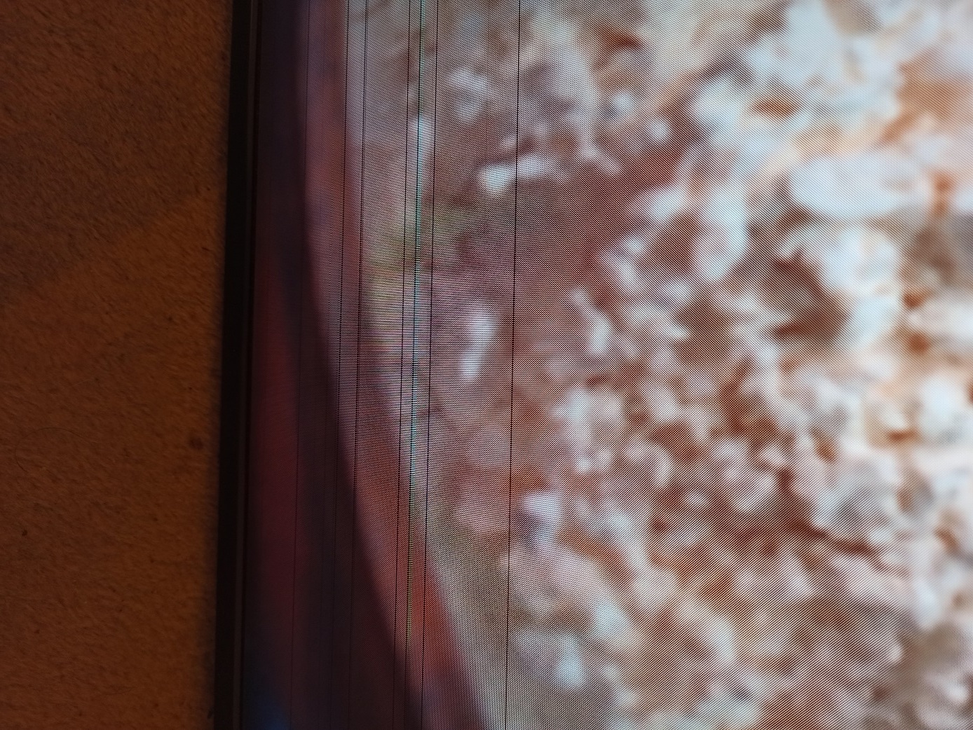

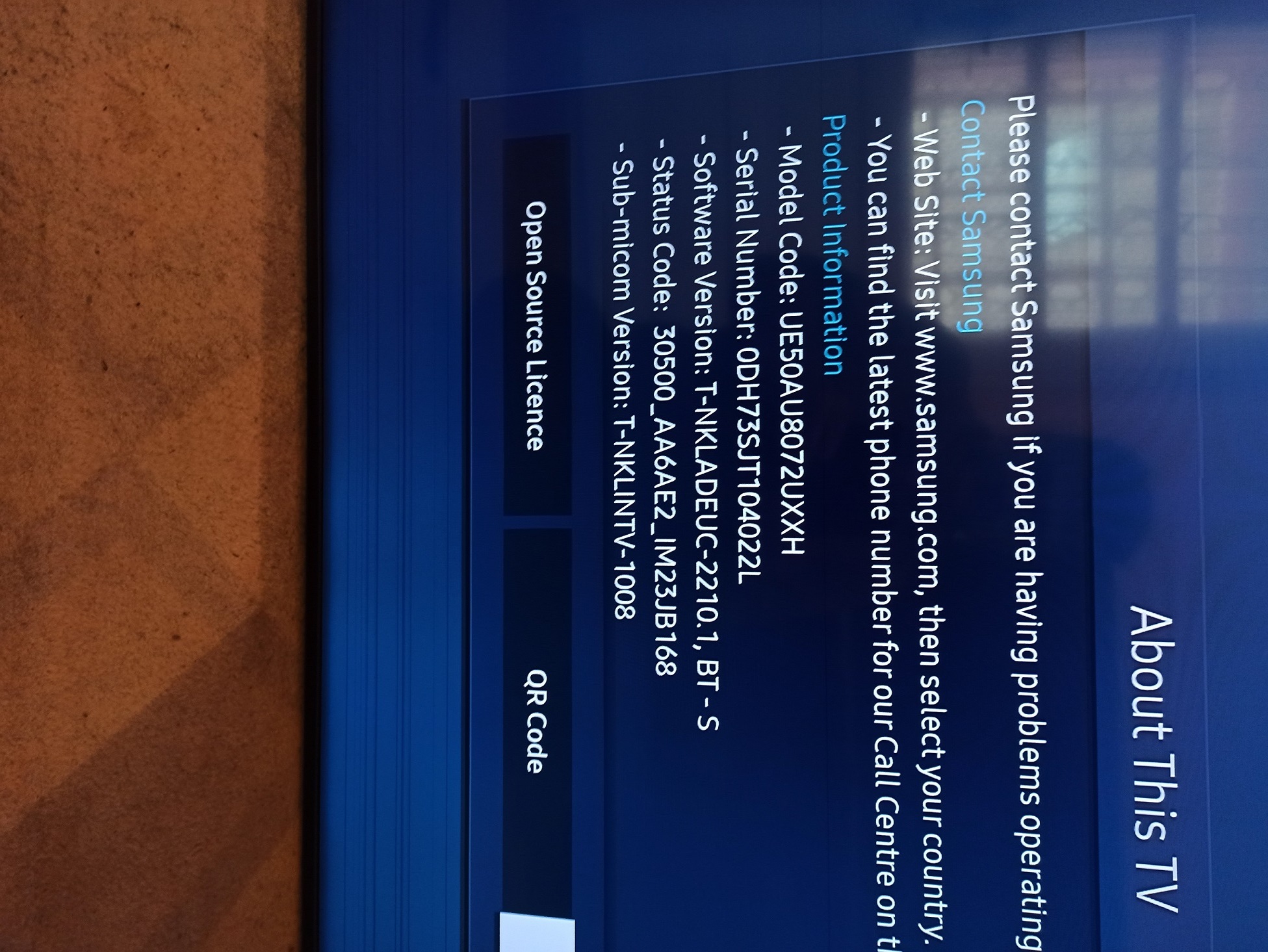

                                I am back with some information.

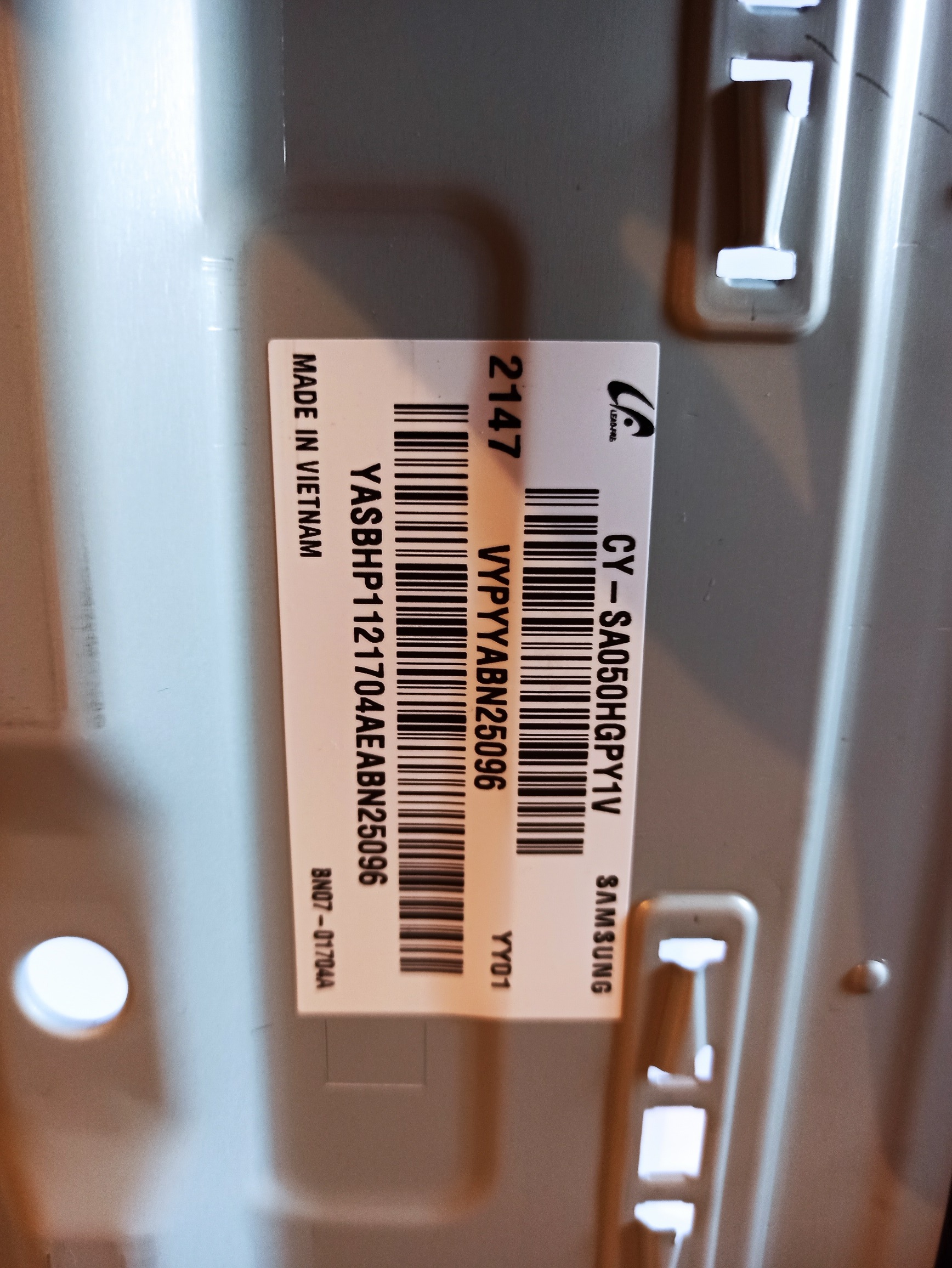

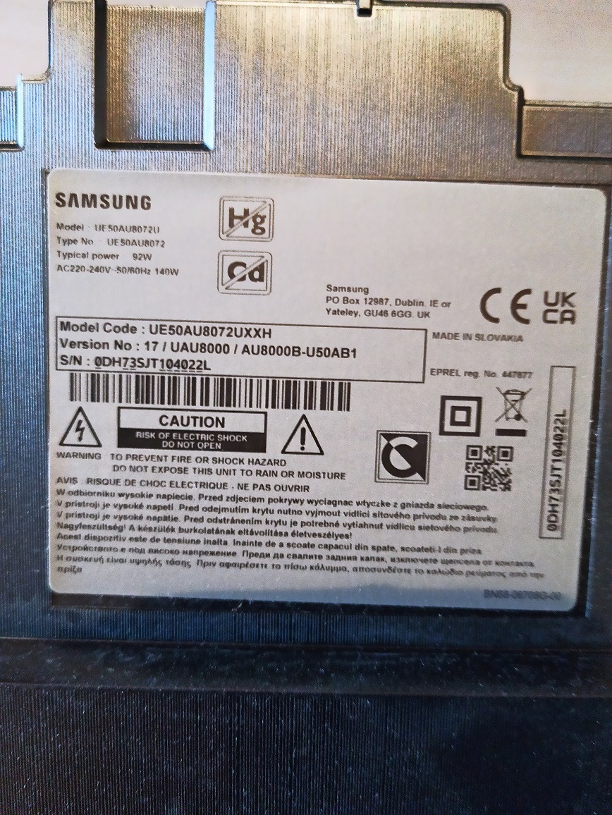

                                I received the following Samsung model for repair:
                                UE50AU8072
                                Mainboard BN41-02844D
                                Panel CY-SA050HGPY1V

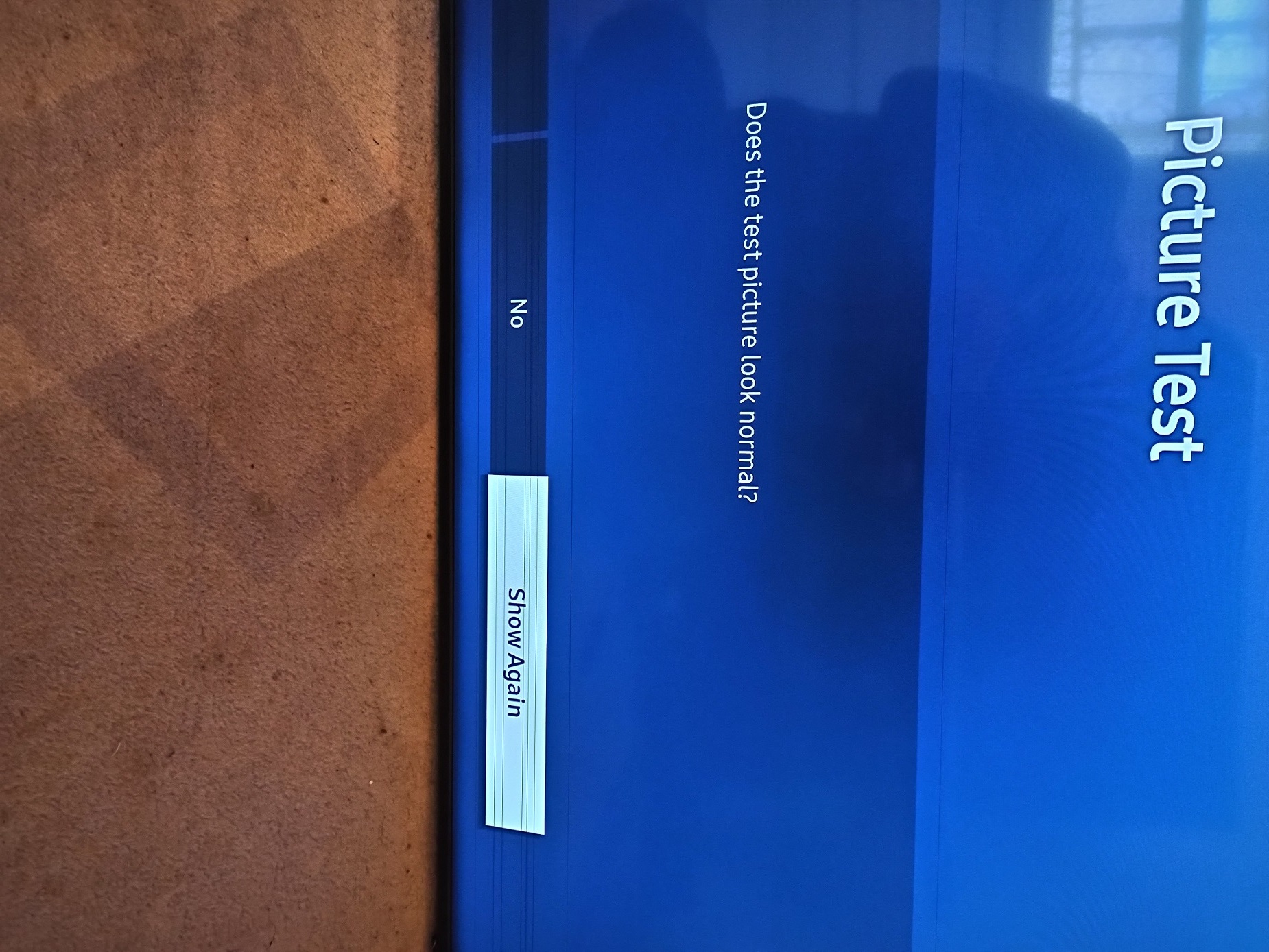

                                The device was in boot loop without Tizen logo, the motherboard only has a ribbon that connects to the panel and that bridge between the two parts of the panel.

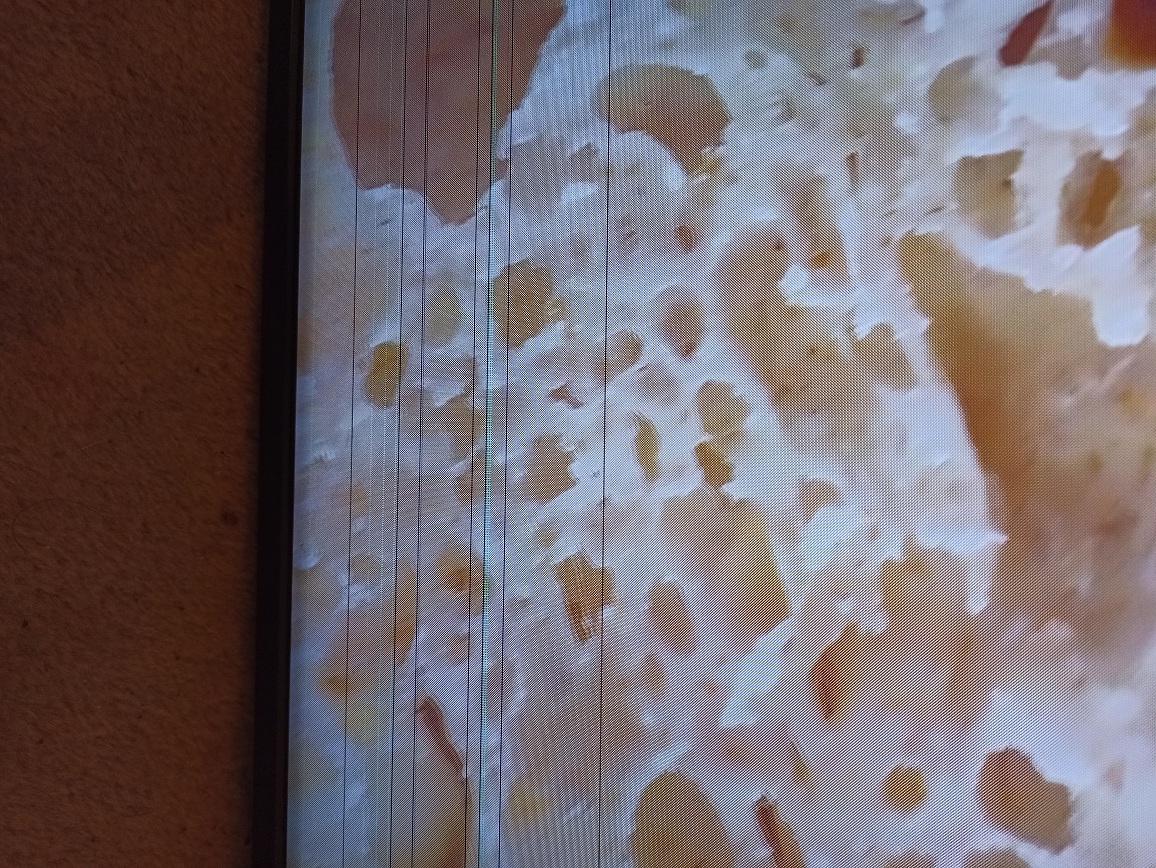

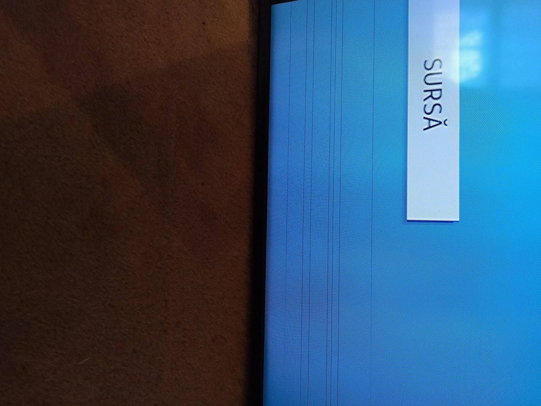

                                I did the panel test with only the left side connected and noticed those stripes on the image.
                                With the device turned off, I measured the resistance of those signal/voltage lines on both sides of the panel, so I decided to cut the VGH voltage on the right side (if the VGH is cut on the right side, you will no longer have an image)
                                and I connected that flex cable between the two sides of the screen. I turned on the device (the Tcon test is still active, that strap) and I had an image on the entire screen.
                                I removed the strap after turning off the device and left it for 2 hours in the test on an HD image and no problem appeared. I am attaching the pictures taken by me yesterday.
                                I was lucky this time too and found the defect relatively quickly.​😉
