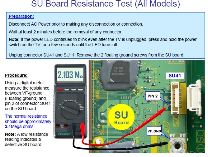

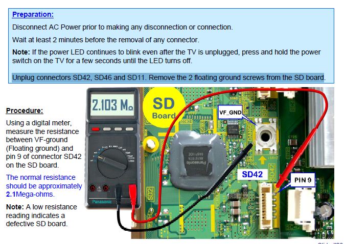

                ok you said the ss board light glow or just the power red light???on the ss board near r032 r031 is locate a small diode d253 that one should glow "green" when power up and the power led should blink 6 time(the sc board must be disconect)that indicate your ss board is ok.... also check the sd/su board resistance.you ave to unplug all conector of the board check resistance betwen vf ground and pin 2 at conector su 41 and sd 42 pin 9 reading should be near 2.4 m ohm (vf ground is where the screw link the sc to sd/su), i speak french sorry for error lol

                    Re: Panasonic TCP50S1 BLINKING TEN TIMES THEN REPEAT
                    when checking su and sd boards do I have to disconnect the ribbon connects as well and the ground screw (vf) is it the middle one where three screws are 1 half inch from each other like this ('.') thanks guys
                    • tipat
                      • Jan 2014
                      • 23
                      • canadian tire
                      i check mine with ribbon cable disconnect and the vf ground screw is the 4 screw that link sc to sd/su..
                        check this...
