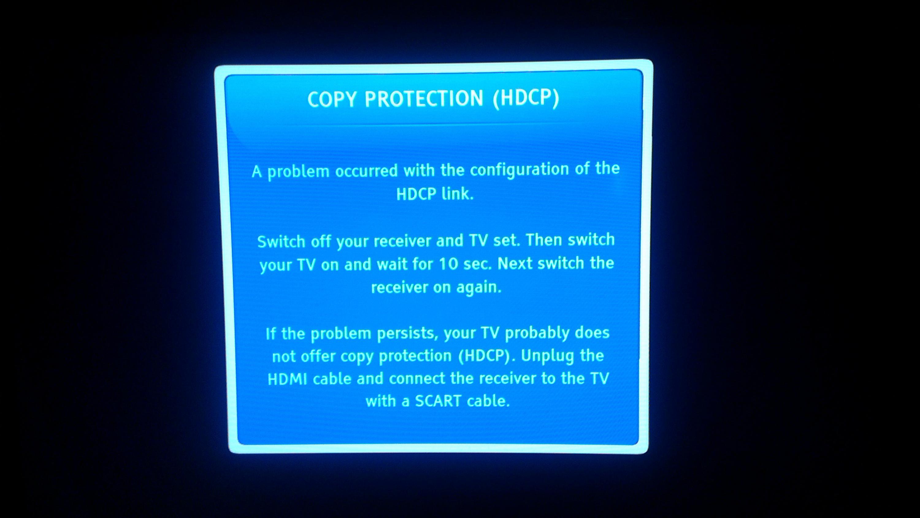

    i have a sanyo ce32ld47-b 32 inch lcd, everything works but when i plug my hd freeview box into either hdmi port it comes up copy protection hdcp, a problem occured with the configuration of the hdcp link (the message itself comes from the freeview box). the sound and menus work. i also tried it with a playstation 3, and got no picture.
    it seems a strange fault, could the tv be set to the wrong region or something?
    thanks
    Re: sanyo ce32ld47-b hdcp copy protection
    I think this is probably related to the fact that these VESTEL sets made it very easy to steal the copy protection keys and/or data. This means that they are banned from connecting to other HDMI devices released after a certain date.
    It's a f***ing back-asswards system which messes with the user instead of the people who make the copies, but that's what the movie industry insists on.
    You MIGHT be able to install a firmware update to fix this, but no guarantees what so ever.
