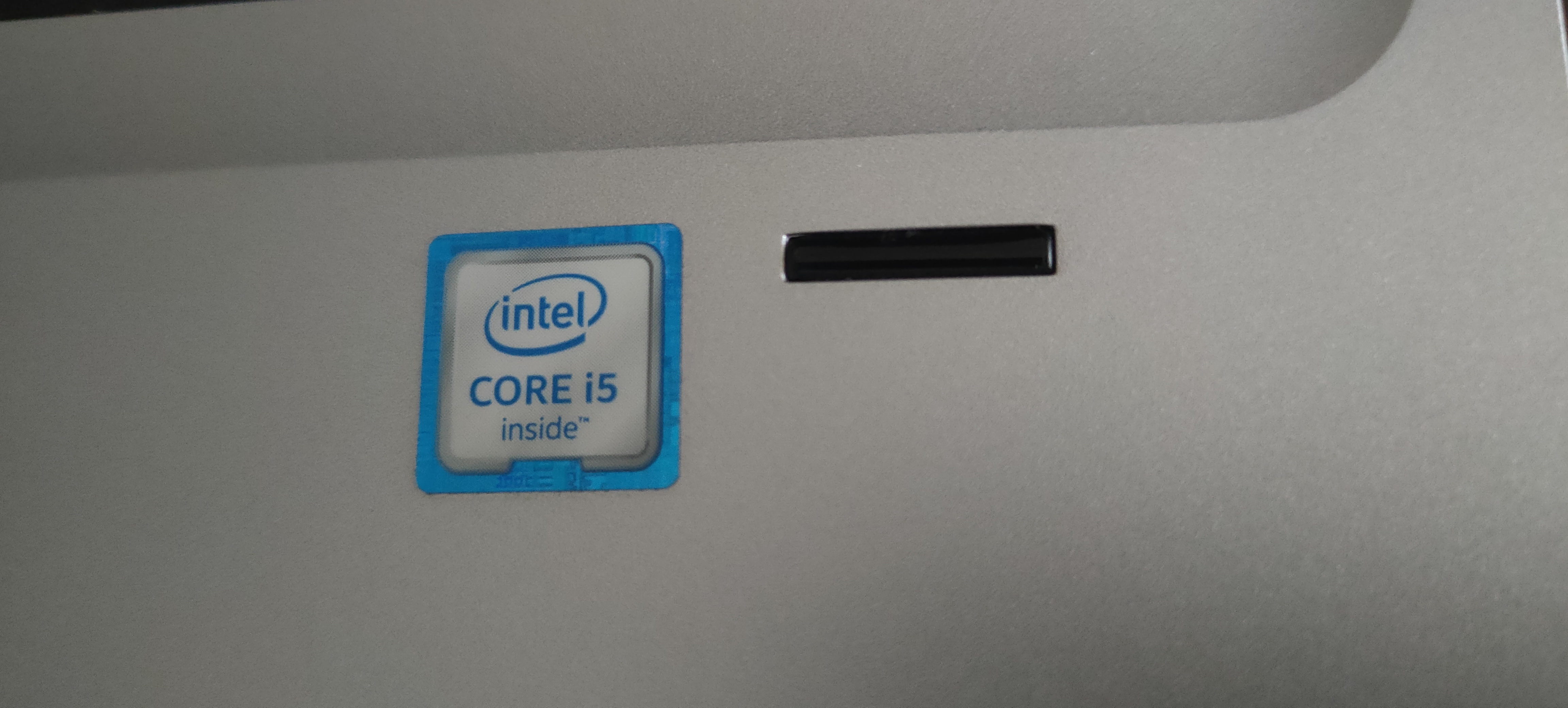

                            The way to determine whether a certain model supports the AMT function is to check the Intel CPU sticker on the palm rest...if it has...
                            If it has the word vPro, it means that the AMT function is supported and the AMT function must be enabled when defining; otherwise, it means that the AMT function is not supported and must be disabled when defining.
                            On Lenovo by example, the vPro versions have 2 BIOS chips...I don't know about HP...

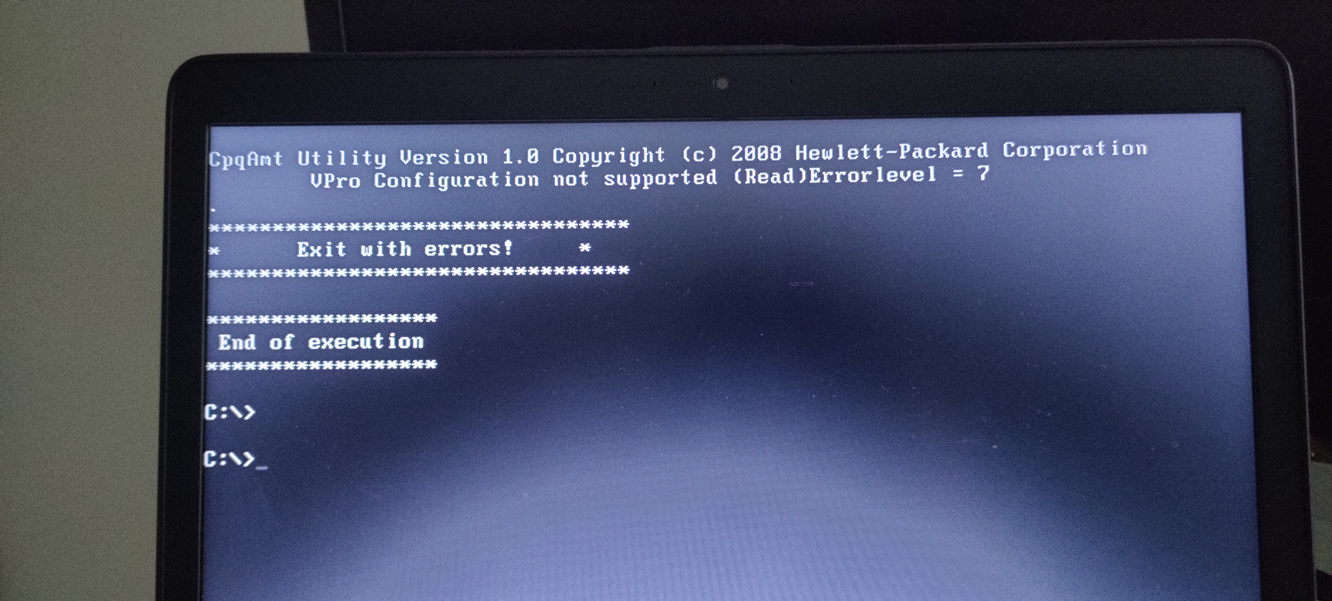

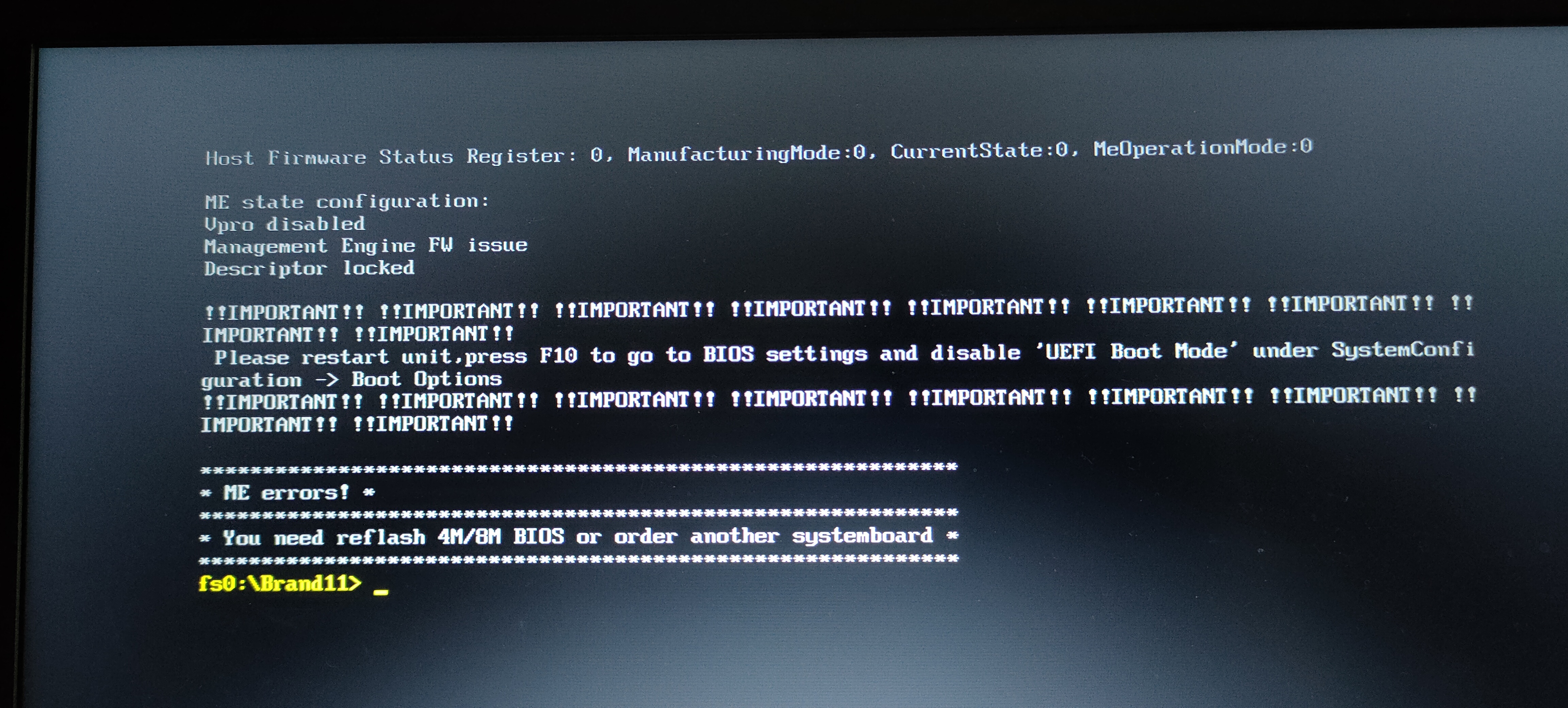

                              I found that my laptop does not have vPro by sticker and it having intel i5 6200U.
                              I have tried Brand11, 12, 13 and AMTool DOS and got these results in the attachment. There seems to be some kind of ME error

                                I don't think so...the ME Region from the dump it's a factory one, brand new...
                                More than an incompatibility for some hw components...because it's not a bios for this machine...
                                I have another images try...enter your DMI info...

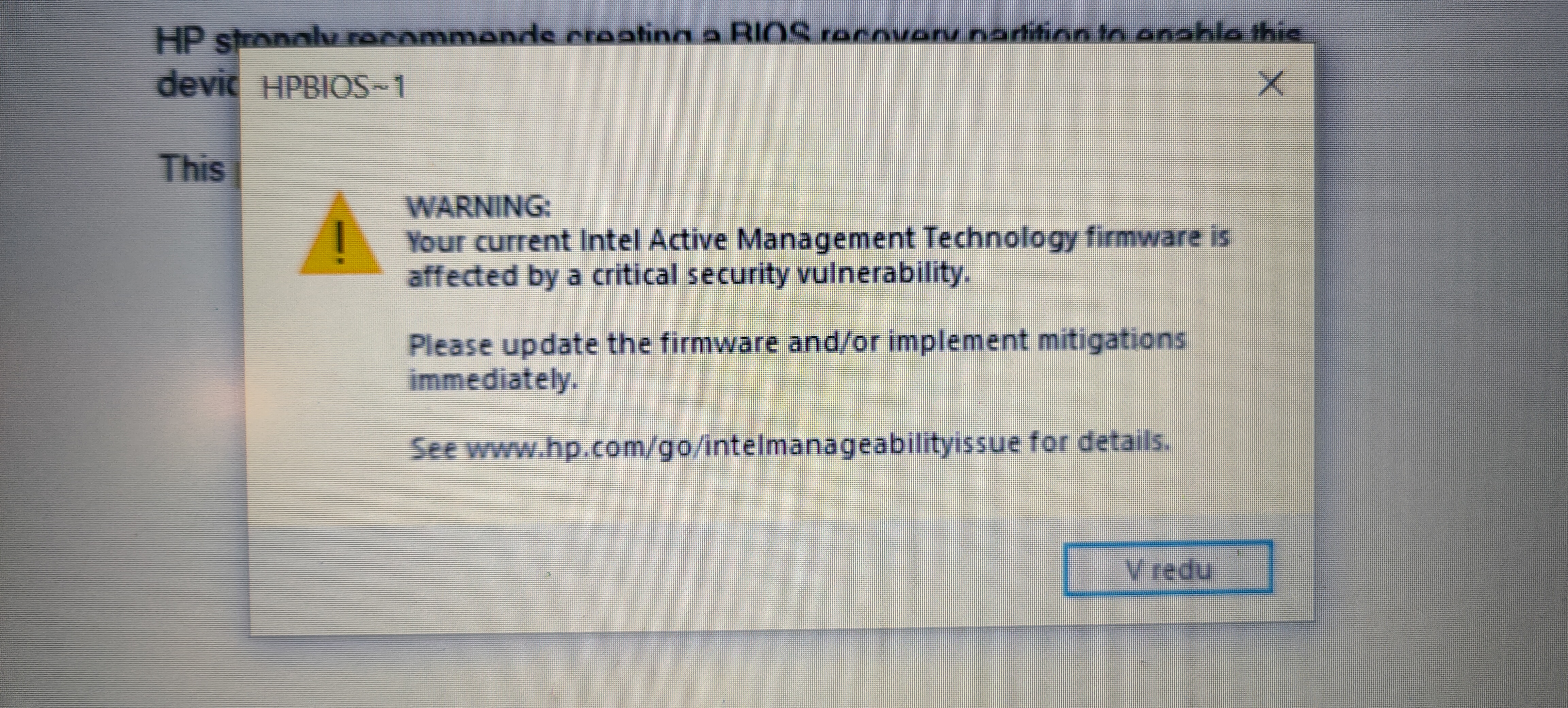

                                  I have used the v3 bios and entered all DMI info. I no longer have the "Machine not in commited state" error.
                                  When updating bios from 1.60 to 1.61 i got this warning. Should i use HP_tools to set AMT?

                                    That's exactly your problem
                                    Your machine doesn't have AMT (just vPro has)...
                                    that was the original problem source, you can configure something you don't have.
