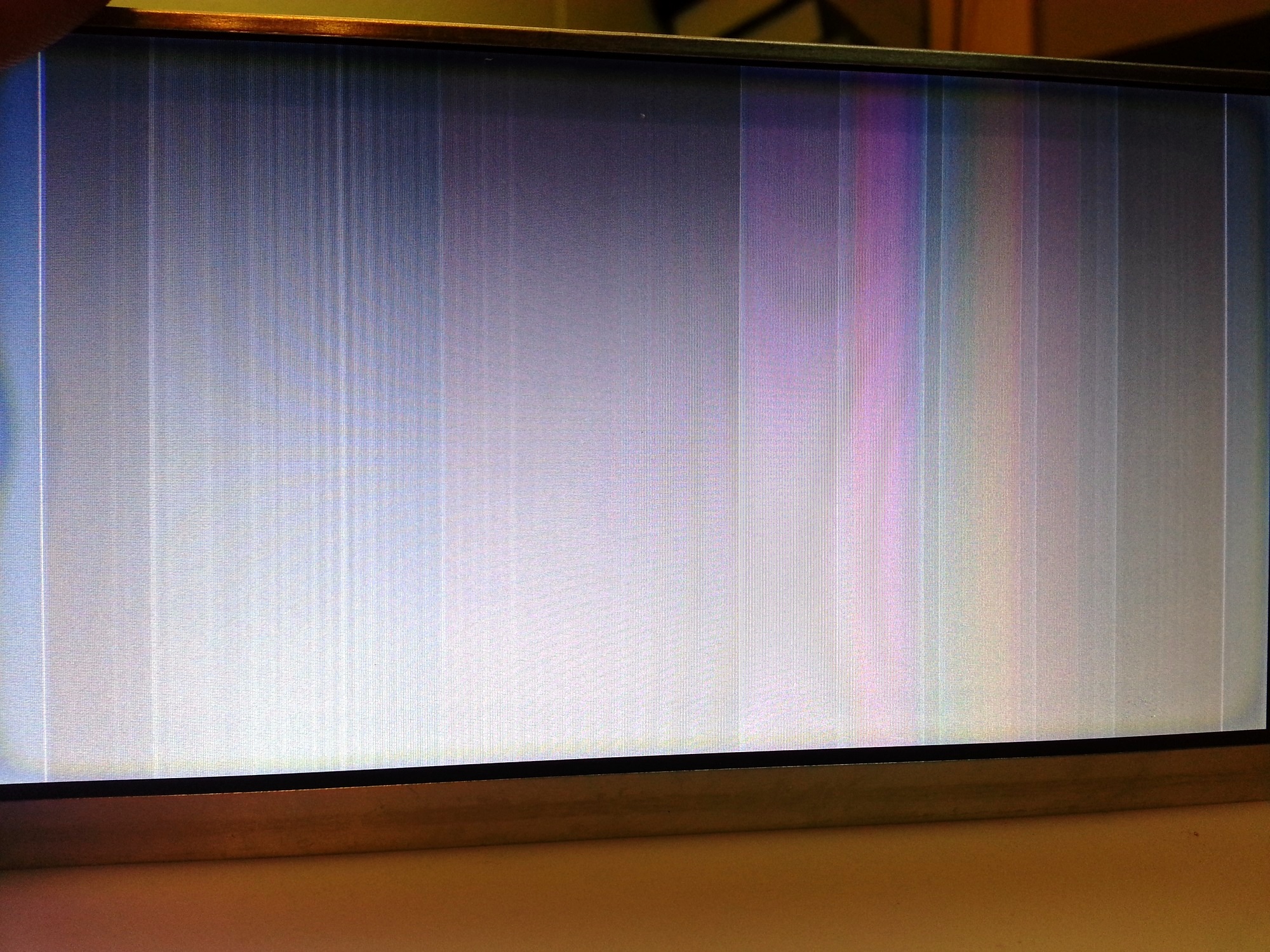

        I had previously owned an older Kenwood nav. unit, which it showed this screen a couple of times and by cleaning a connector which connected the LCD with the PCB, fixed the issue.
        I was hoping that this would be the case here too and I will make an easy money.
        You guys are thinking that it would be something on the PCB and not the LCD itself?
        I see some kind of pressure mark, by the volume button too.

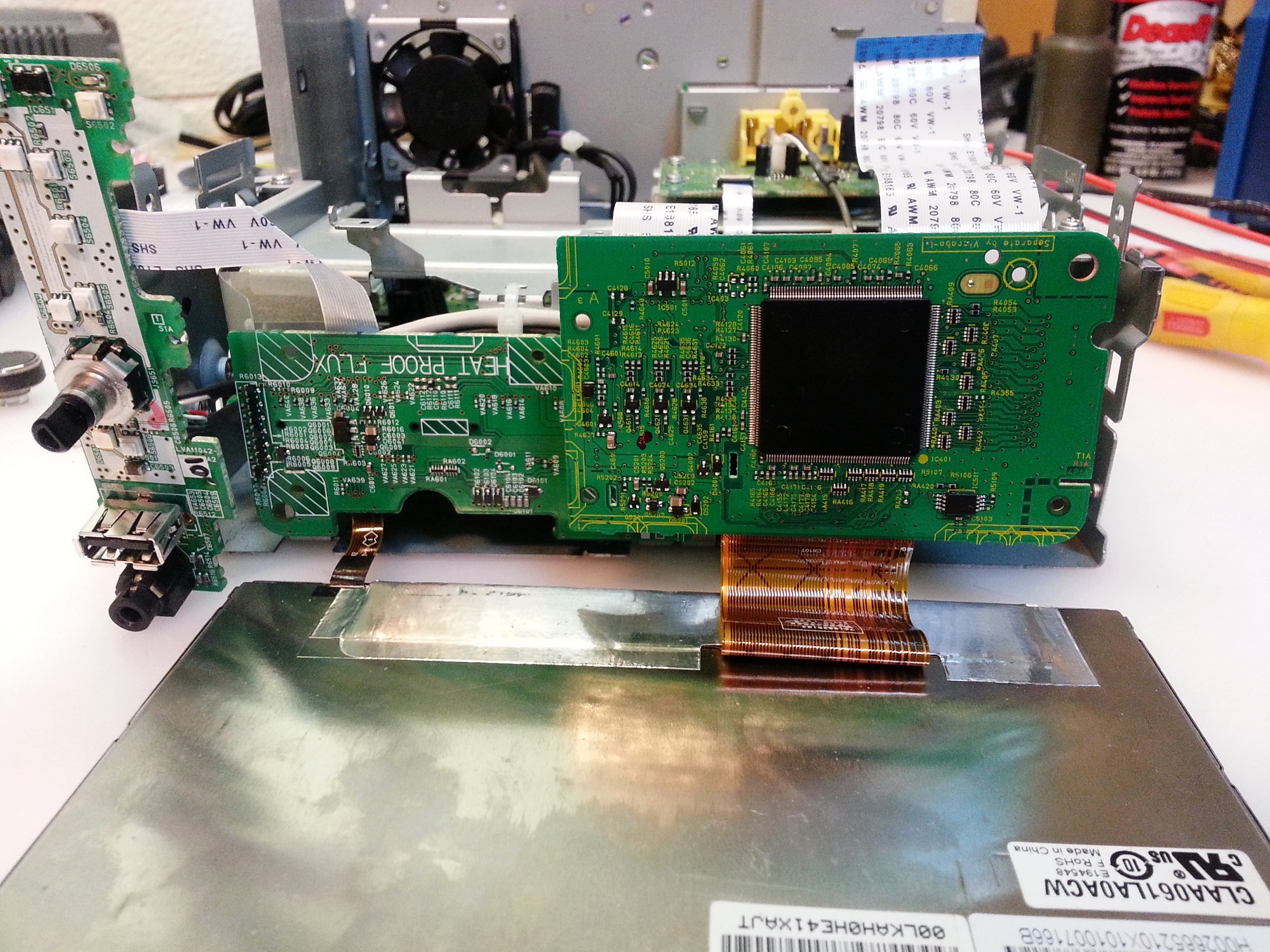

              Kenwood may sell LCD for $200, but I think you could figure out who made it and order the generic version directly, unlikely that Kenwood have specifically engineered it.

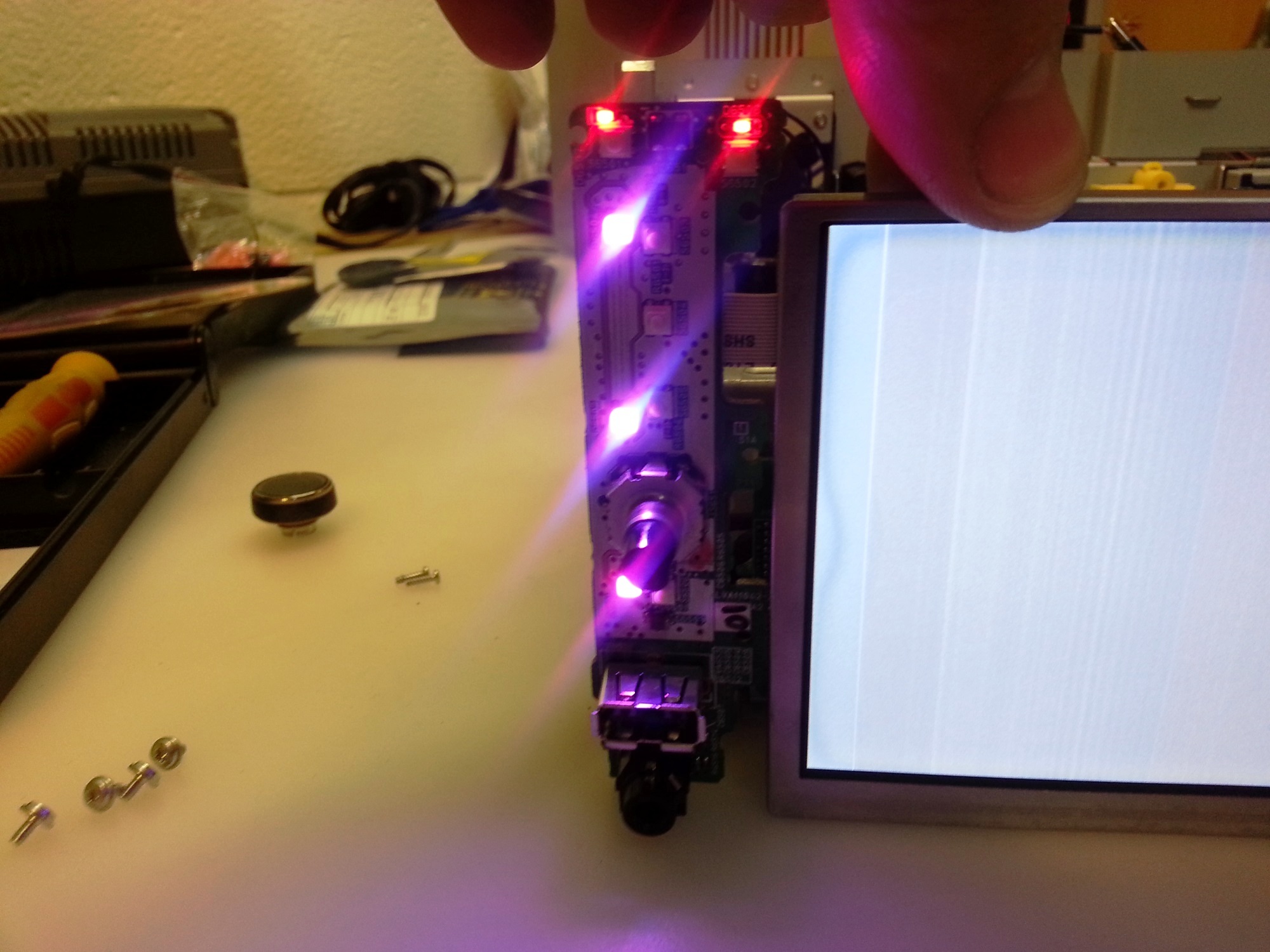

                  The unit itself, it seems like it's working, the button lights are changing colors, I have ejected a CD which it was in the unit.
                  I'm thinking of hooking up the unit to a TV using RCA outputs, to see if everything else it's working.
                  This is almost as a laptop with a graphics card issue. But very well could be a cheap Chungwa screen. It could be the screen's T-con having problem? I guess, that one is build into the top board of the LCD, which is covered with that aluminum foil, no?

                    Re: Kenwood question
                    I doubt there's a t-con in these screens, it will all be chip on glass technology. i.e. replace the screen as a module, if bad.
                    Cheap Chungwha doesn't matter for small LCD. It's bigger LCDs where pic quality and reliability become more important.

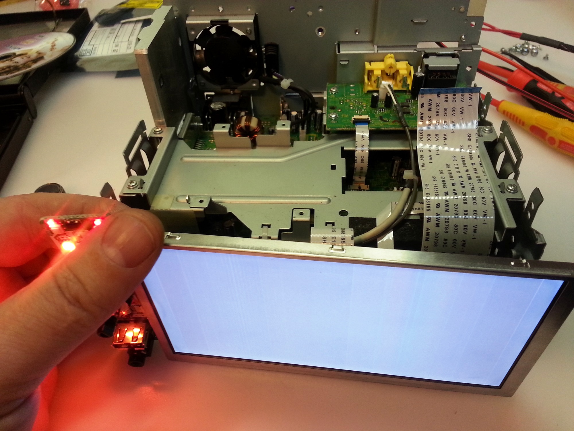

                              Nothing worked. Heating didn't change anything.
                              Video through RCA out didn't show any kind of image.
                              I'm not sure what should show on an external monitor, the menu or just the movie itself when the DVD function is selected?

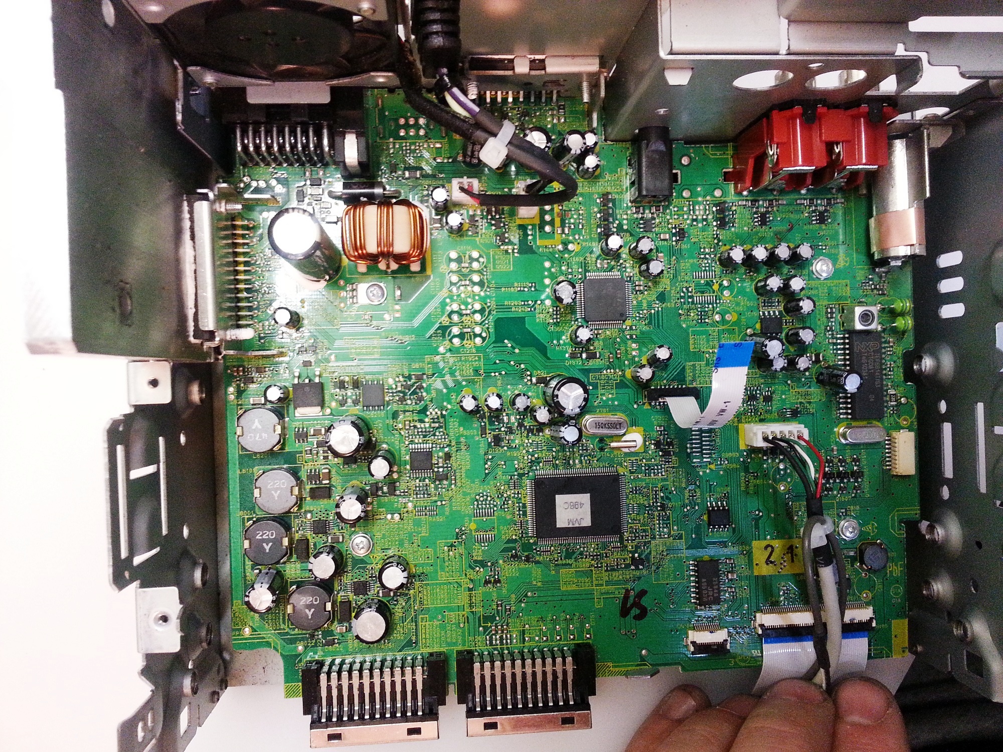

                                    A couple of pictures
                                      In pic 5 just to the right of the connector for the brown ribbon cable there
                                      are what looks like 2 flat green fuses (or they could be empty places and its just the board) perhaps check?
                                        It seems like they are only empty spots, but I will check when I get home.
                                        The symptom on the screen, what could it be? Bad video signal(mainboard) or LCD/T-con issue? In general I mean, like on LCD TVs?
