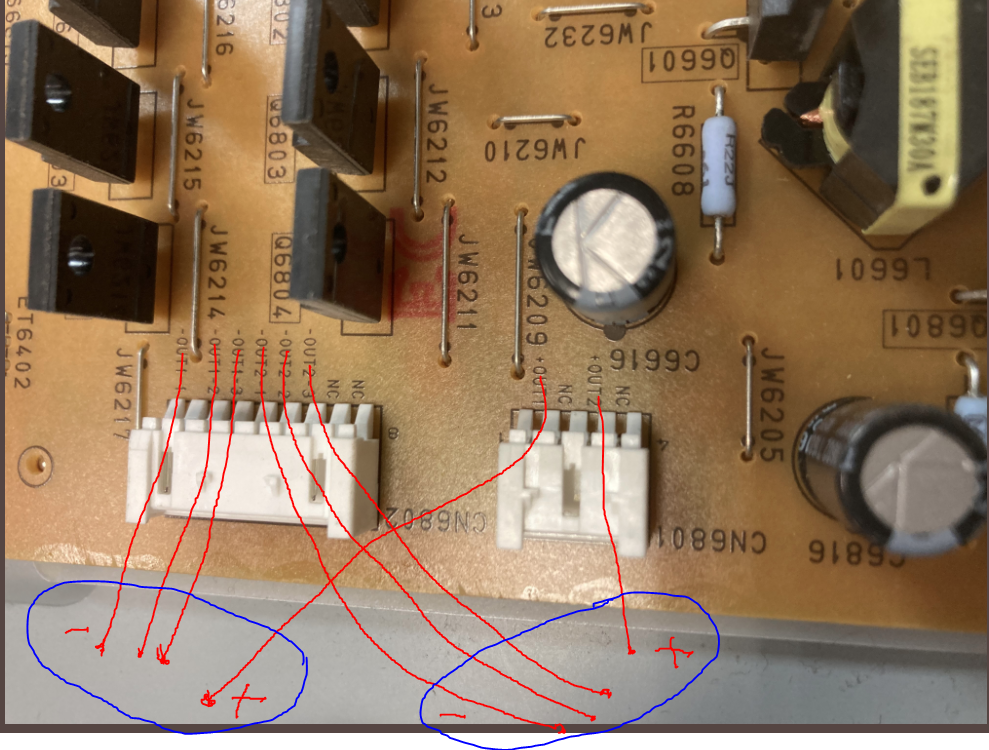

    Hi again all. Picked the above model up a couple of days ago. Information was that it just stopped working all of a sudden. Was from a nice house with no kids or pets and no reason to think it's suffered impact damage.
    Working my way through it. I get a flashing silver light on the front which indicates an attempt to start?? Then it turns off and doesn't attempt to reboot.
    Had the back panel off and with the plugs disconnected to the backlights, on the connectors I'm getting 63v DC on CN 6801 and 4.0v DC on all pins on CN 6802. All except the not connected ones I should add.
    So am I right to think the backlights have failed?
    Pictures and videos below.
    Thanks in advance.

    To add to this. With an LED tester across the CN6802plug I’m dropping 200v across the plug. I.e I have 300v on my tester then it drops down to 100v with the leads connected across the plug. Seems an awful lot of voltage to drop.
    Am I onto the correct issue do we think? Where’s my boy Diah at??

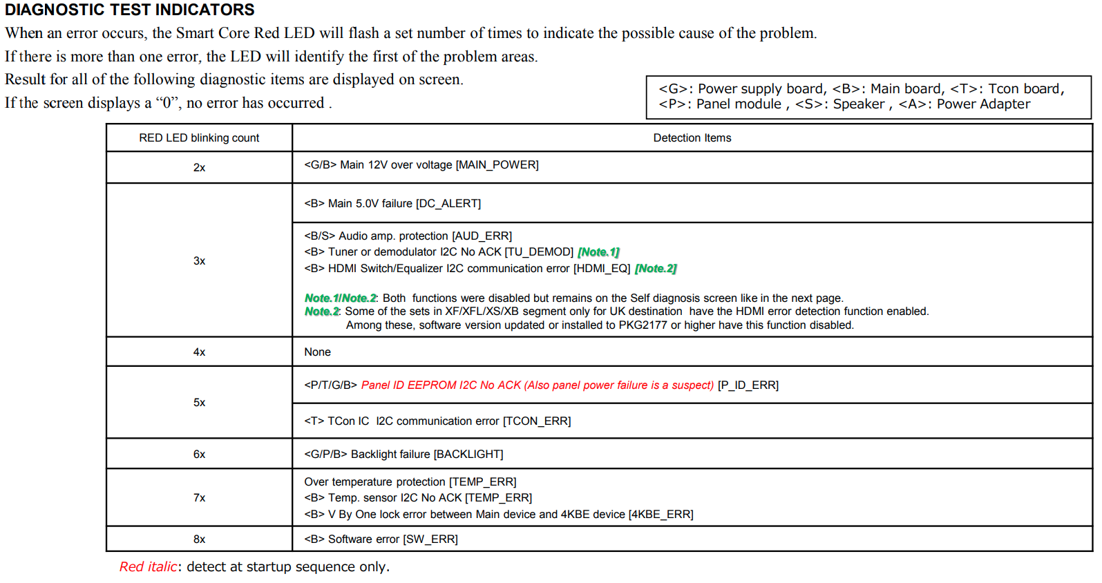

        If the problem were with the backlight, then the TV would display an error and the red LED would blink 6 times.

            Sony, with many protections, will display an error in case of any malfunction of the backlight (current, breakage...).
            Most likely the problem is in the motherboard, eMMC.
            The voltage at the backlight output must be measured between +OUT1 and -OUT1 -1,-2,-3 and between +OUT2 and -OUT2-1,-2,-3. there should be 6 readings.​

                that's true if BL issue there will be error blink..... but for some how at android Sony will be not standard... many years before this post after repair sold it to friends. years later he come to me told me there are no reaction or picture.. visit him at home and it was same this threat... look it turn on but no BL no sound... i did hard reset by press joystick and pushed it down while it plugged in wall .. release the push after the front LED change from white to green... it restarted 2 time and at end i can hear start music but no BL at all... with my mobile light i can notice the first install screen... thought no sign of any error blinking..
                yes it could be glitch at firmware on eMMC .. but the subject of error code 5 / 4 blink not standard to me.at Sony Android.

                          lotas the backlight readings you asked for all give 3v AC.
