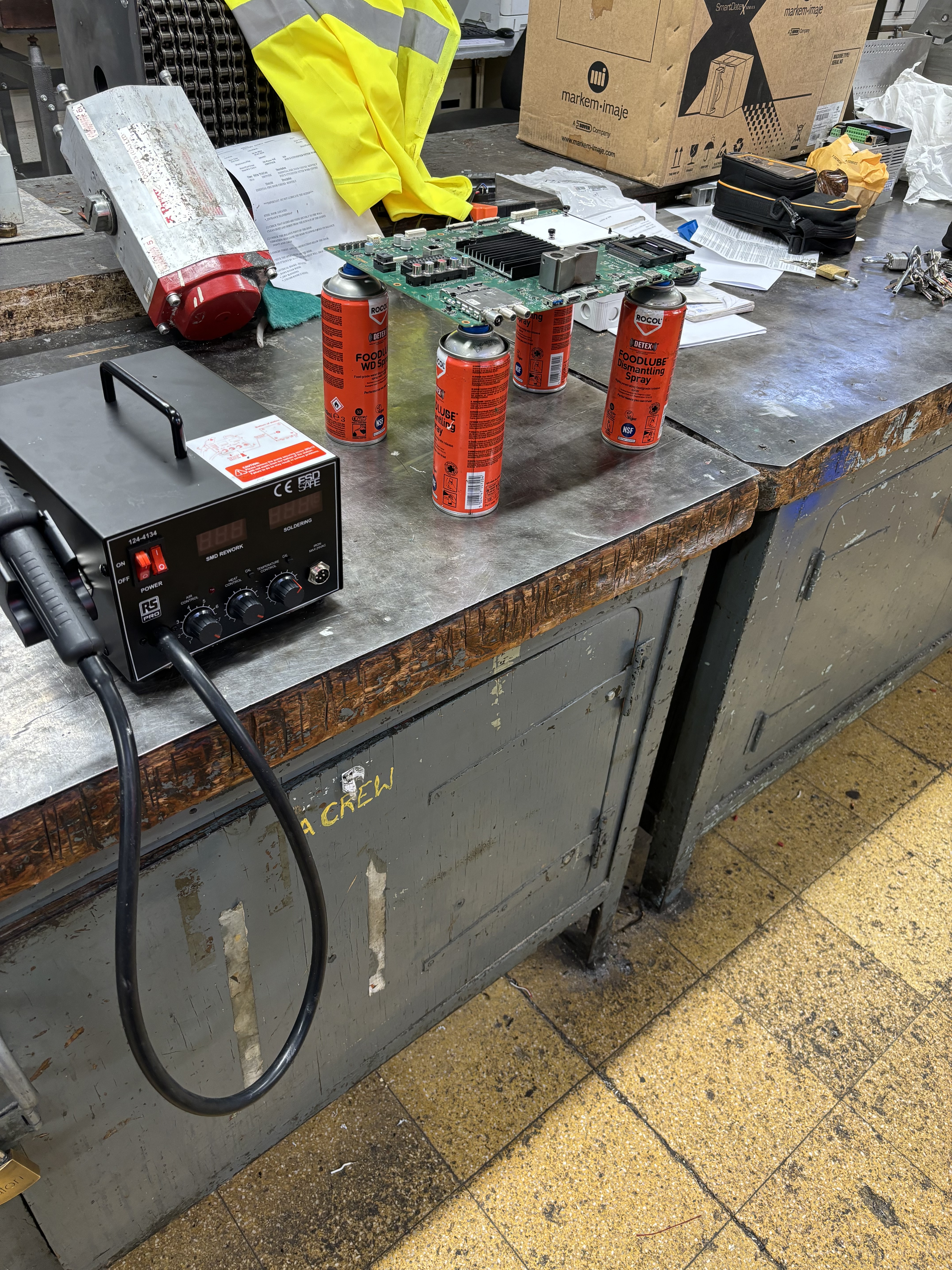

        Ok Diah. 10-15 seconds on 275 degrees from the underside of MB. Hope you appreciate my ingenuity! Pressurised cans as stands😅

          NASA SPACE Shuttle

            you need to remove the black heat sink and the metal weight put it on the top of the chip

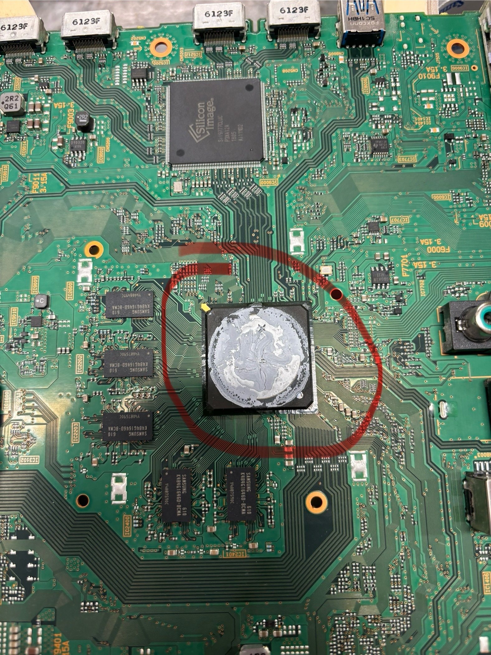

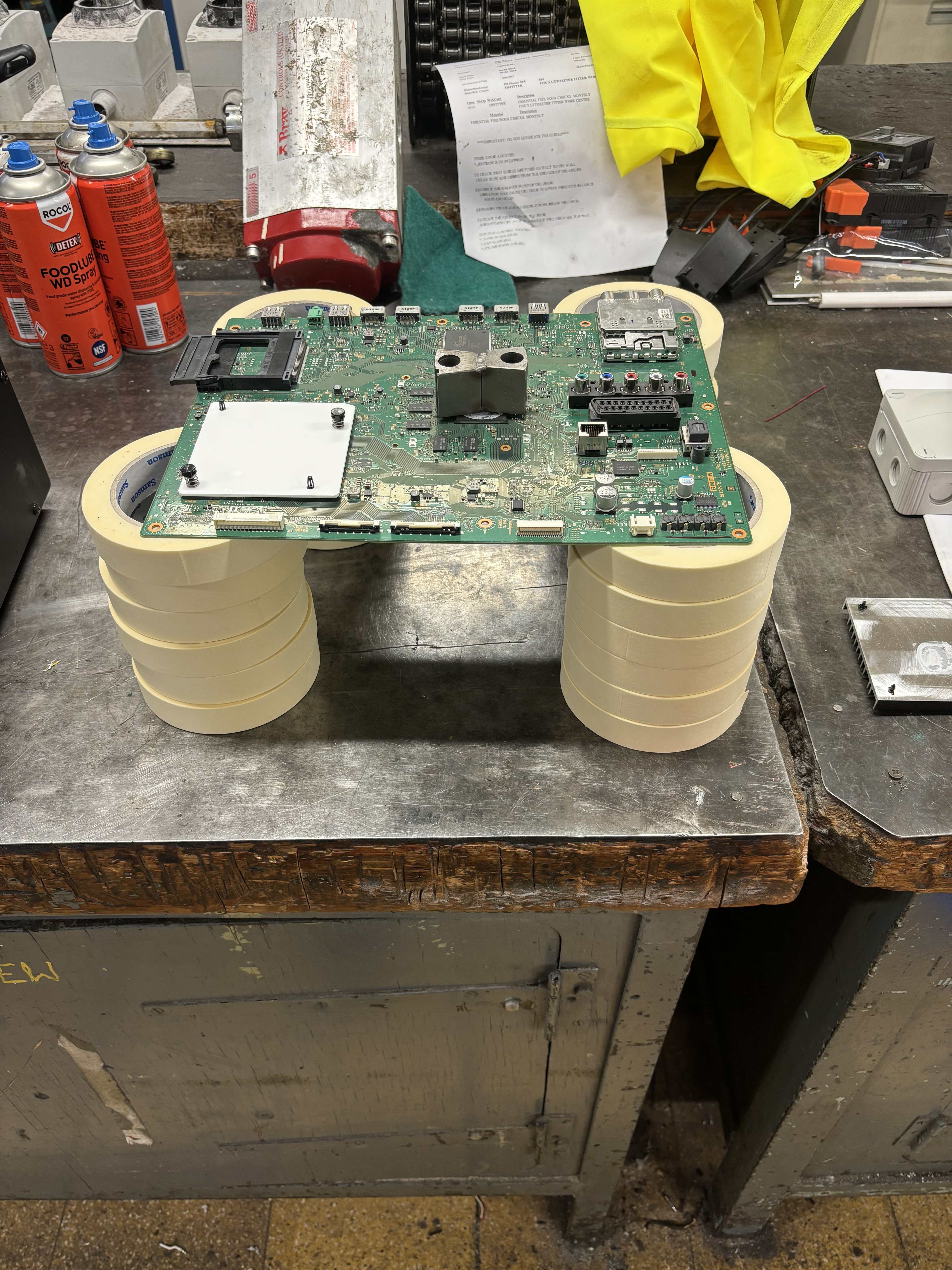

              Ahh I see Diah. You mean heat up the chip below the heat sink?
              I have also made a more sensible set of stands😅

                  Ok we seem to have gone backwards here Diah😅 all boards back together and tried to power telly up, not even getting the white standby light. Attempted hard reset and nothing at all appears to happen.
                  Under further examination I also don’t seem to have the 12v DC on CN6401 anymore. That’s tested to chassis with the MB plug in and out!

                            then yours heating process didn't went well... still there or new BGA point happened under the Soc you may bring it back to life..... nothings now you will loss ..however i never recommend thi methods to any one... but at your case only give try for it.
                            remove the 2 heat sinks black and white , use kitchen Aluminum paper make hut to cover all plastic sockets on the main boards, don't let the Aluminum paper touch the plastic sockets..
                            find weight to put it on the top of the Soc.. heat your oven to maximum... don't use air flew, just use the up and down to heat it... when it reach the high temperature put the boards on the oven plate and the weight on the Soc... leave it cooking for 20 minute, after that just turn off the oven and open the door carefully... leave the boards inside until it cool down and try.

                              There was a very large load on the chip, in the center, and the board stood on four supports in the corners, and when heated, the board begins to bend downwards under the weight of the heavy load, turning it into the shape of a plate...

                                this is unlikely.. the boards was sitting over 4 standing cover about all boards except the soc area the soc are solid part.. .. but heating always 30% success... reballing only.the professional work.... but he is house user... so we use simple way.. because MB cost >100$

                                        The weight was no more than 200 grams. I possibly should have weighed it first to get exact weight and asked is this was suitable but it didn’t cause the board to sink during the process. Certainly nothing noticeable to the eye anyway.
                                        If you would like to share what else I could of done in this situation to attempt repair please tell me.
