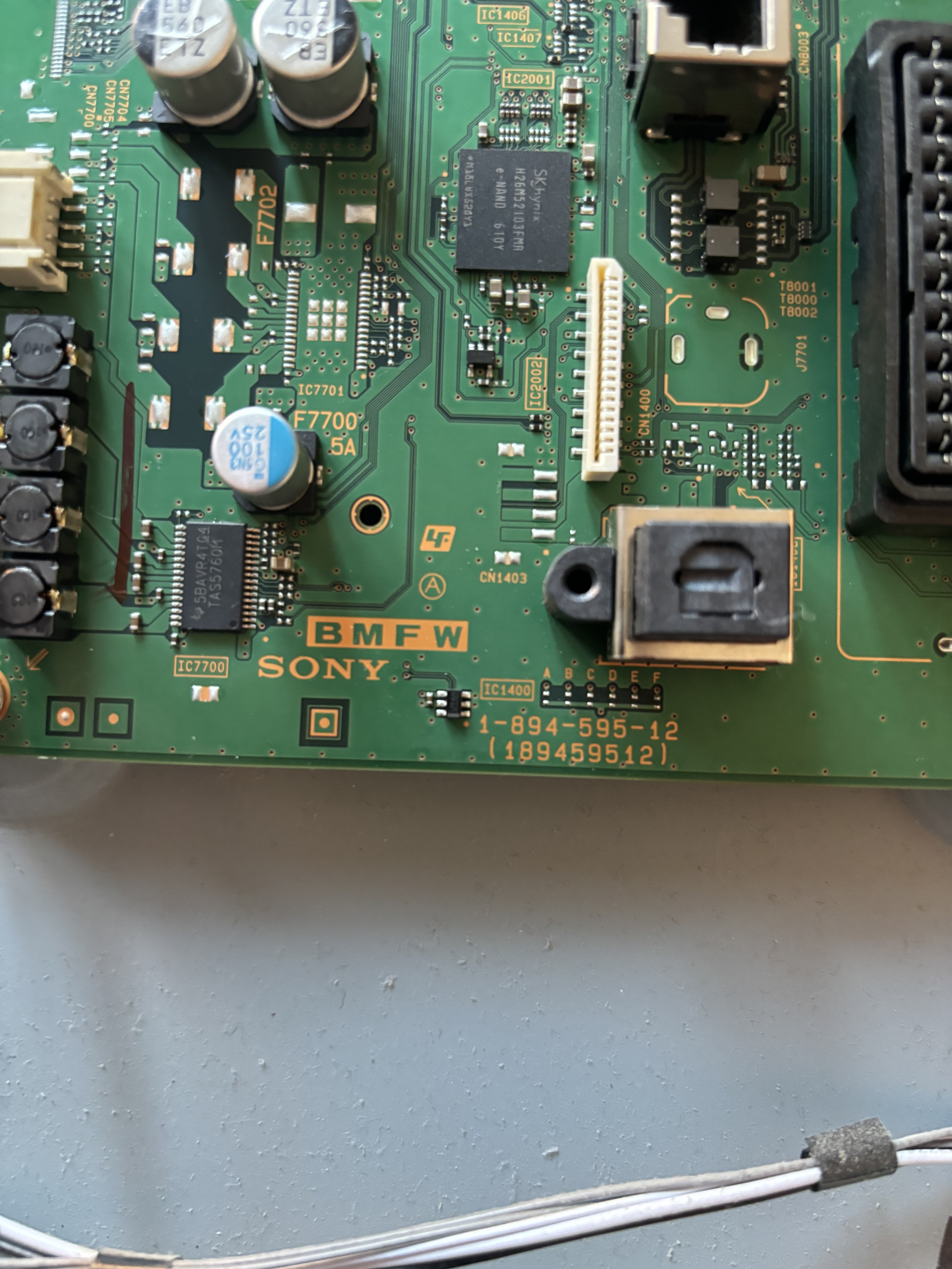

      This is board in my Tv mate.

        PSU - TCON- Panel no match

          What are these Lotas? Boards that are suitable for my Tv?

            No that is the part number of MB Diah. Do you want me to give part numbers of PSU & TCON?

              No, this is your panel number, and this is your motherboard, look for this number - MAIN: 1-894-595-12 (Y210B300C)

                Yea these are the boards I have searched for and all are out of stock. I have notifications set for when they come back available.

                  you need to remove the black heat sink and the metal weight put it on the top of the chip
                  I am interesting for origin of this method with weight on top... while watching a lots of video, never seen this technique for bga chip?

                    Diah I have found a repair service for the main board on eBay. He is charging £89 for this. Do you think this is worthwhile and are you confident that a repaired main board is going to give me a working telly? If I spend this money and Tv still doesn’t work I’ll be very very sad.

                      If the board is deformed from heating under a load, then it is unlikely that it can be restored, since the chip will not be able to lie flat on the seat (some bga balls will not come into contact with the board), this must first be discussed with the service...

                        Ok lotas. So if I message the guy to say I will pay for the repair but if it comes back as not successful can I have a reimbursement??

                          Explain the entire history of this motherboard (the initial malfunction and what you did with it later), if they agree to repair, discuss everything in advance.

                            Yep. I’ve explained that the PSU had all expected voltages and that I’ve previously attempted a home repair which has resulted in me losing 12v REG & 12v T-con
                            Ive also told him it was you that told me to take a heat gun to it for 10 minutes! You’re name is now very low in TV repair circles 😛

                              Yes, I should have said that he also recommended baking it in the oven, but you didn’t do it!

                                  users with limited mind would find its strange.. but to normal user at home with out professional tools, we can say "Necessity is the mother of invention"
                                  did you programmed in your life head robot for mounting CPU / SOC ? what did the suck of the head do while Infrared starting packing.??? nut all of you includse Lotas just believe on on what you have tools under hand.. no one of you put his self in shoes the normal user.., what the different of manufacture oven and the process at home... ???? some things sound funny but its effective, so stop laughing on yours self and appreciated any offer to help with less cost.
                                  at the end all of you never worked on MB,,
                                  don't send yours boards to any ... find replacement.... no one can repair it with out its panel and T-CON.. this is just fraud, other wise i asked you to send it to me and i reball it for free... still i cant test it unless on the complete set.. so its just waste of time and offered.

                                    The repair service on eBay does say that it is necessary to send MB and T-con! So it sounds like he may be legitimate? Maybe he has spare Sony Tv to help enable repair? You still think is no point?
                                    The problem is Diah that it is not possible to find replacement board on google search now! Every company has advertised board as not in stock. So I don’t think I will be able to find one.
                                    I think tomorrow I will put TV back together and store in the loft. If in the next few months a new MB becomes available then I can start again. But for now this TV is not repairable.

                                      Diah, do you have any idea what will happen to the motherboard if you turn on the oven to maximum (up and down) and keep the motherboard in it for 20 minutes?
                                      • Diah
