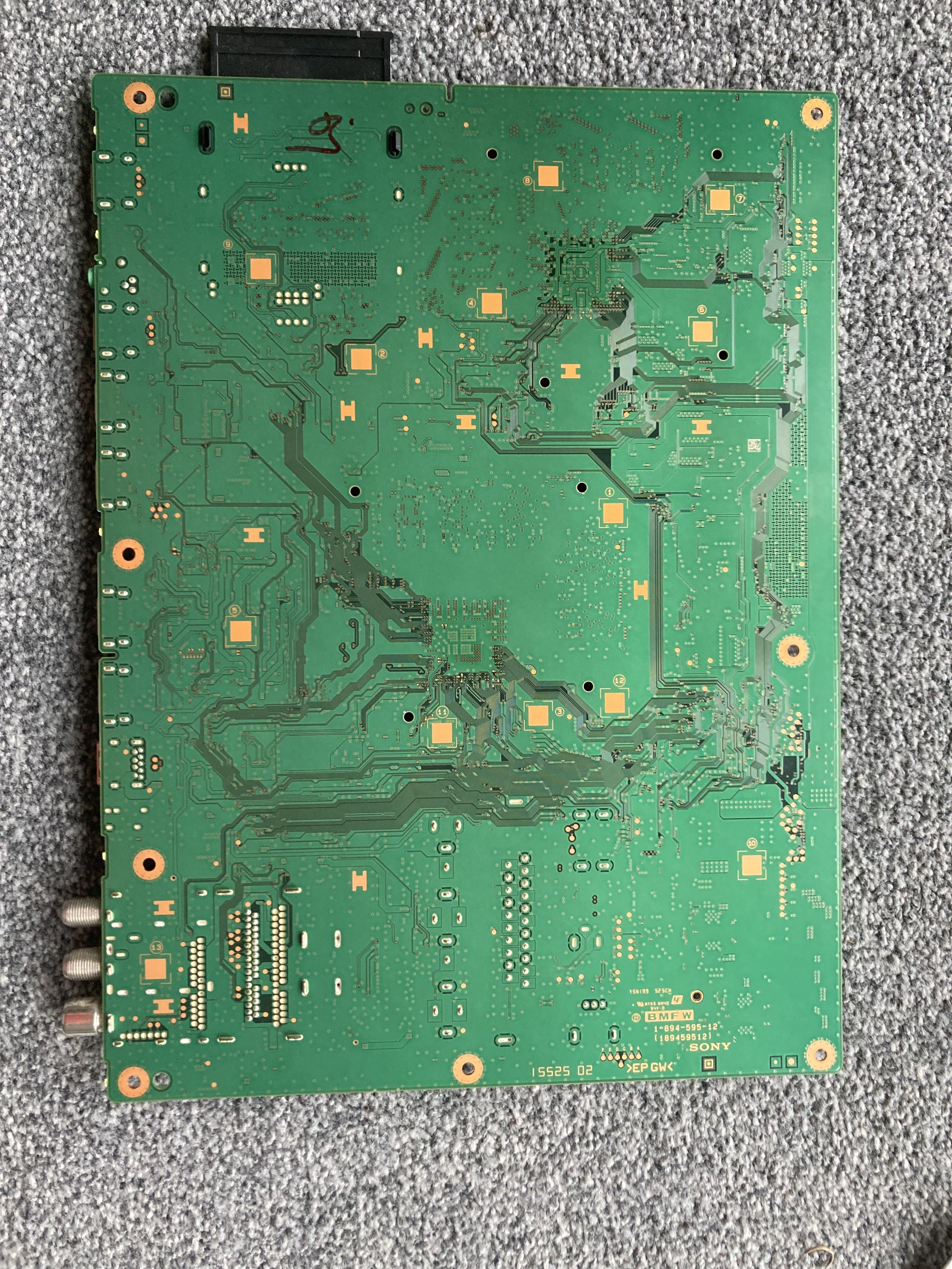

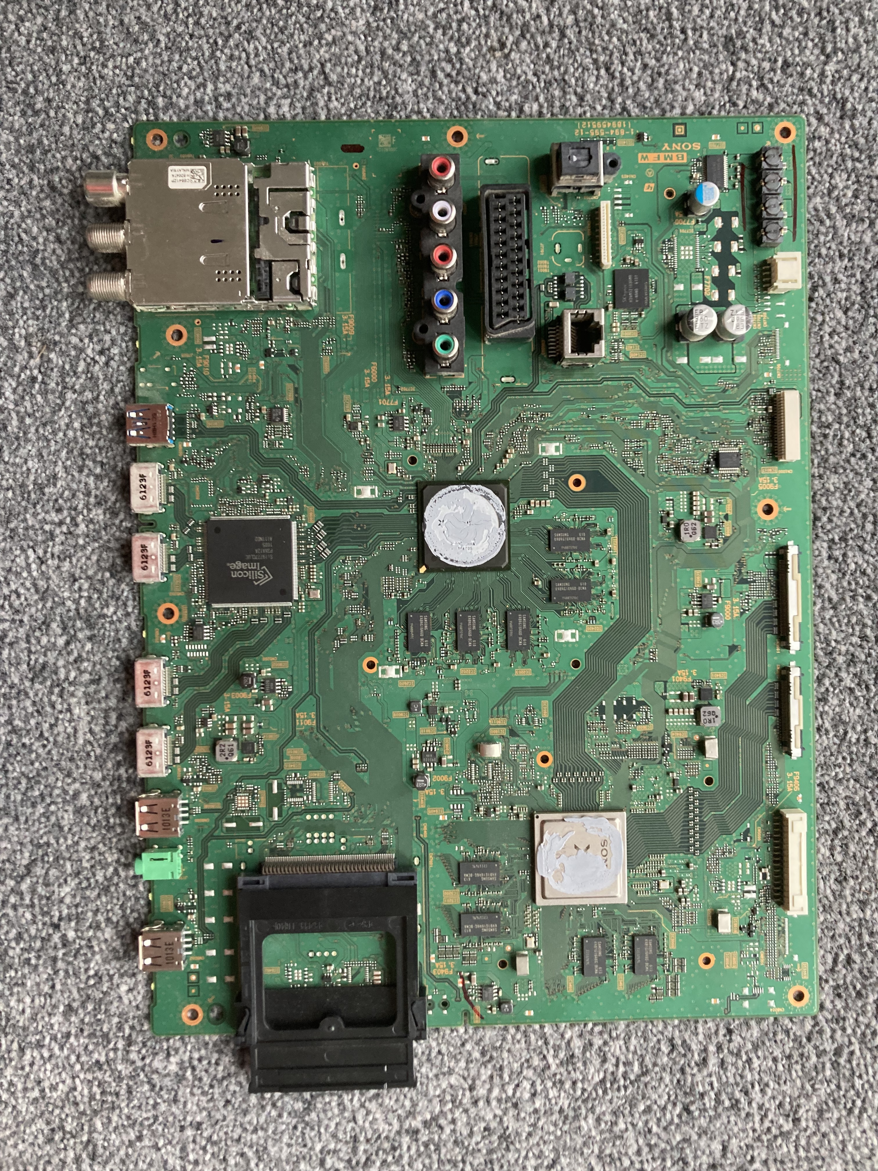

                    #89
                    Ok Diah here are photos as you requested.

                      #90
                      Okay.. read carefully please this time. yours Mainboards easy boards nothing complected at it this why.
                      1- the main firmware of this boards was Android 5.1.1 .. which the google service stopped working at it as well all apps include YouTube.
                      2- Sony didn't push.ed any upgrade from Android 5.1 to higher because this procedure of upgrade need internal file, not via air / internet.
                      3- Sony published on their web portal upgrade file in years 2021 to have this model and other similar to Android 7.1, which the user on his own risk did the upgrade and it take time more than 30 minutes.. if user plug the TV out from Wall , the Tv will stop working as i think yours now.
                      then what we will do ??
                      1- at yours POST 15 when you attempt Hard reset , the front LED Indicator changed from white to green.... this is good sign that the bootloader still in place and didn't eared during the upgrade.
                      2- download the zip file from Sony for yours Model... unzip it and copy the file ( never rename it ) just copy it on root of USB stick formated FAT32 not bigger than 4Gb..
                      2-A : if you formatted the stick with Windows 10/11 try to do it as standard, and labelof the stick write SONY
                      3- white the TV unplugged from the wall insert the USB stick at USB V.2 ( on the side ) not at USB Port V 3 ( blue one)
                      attempt the hard reset procedure and just release after it change to green... give time for it..... and you may repeat this several time... until the parts of boot and system written again.
                      at any point didn't plug it out from the wall,,,, only if you want to repeat the hard reset procedure.

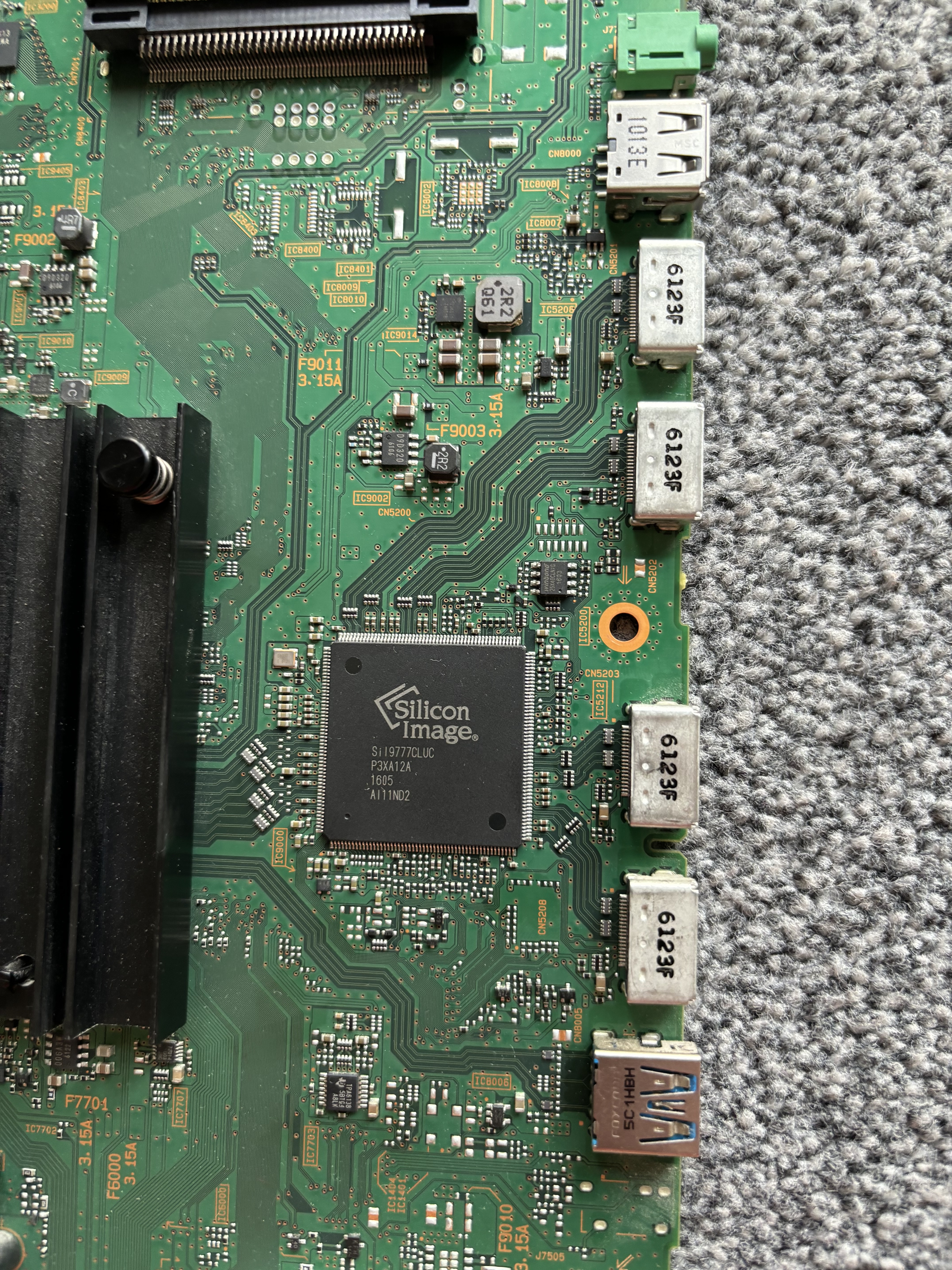

                                      #98
                                      What is 4 stand Diah?? I can take board to work tonight and use my rework station air gun to heat the chip up there. But I wouldn’t be able to try it immediately after.
                                      I have looked online for MB and one site that sells them has them for £49.99 but currently out of stock. I have a notification set for a reminder when they are back in stock.
                                      To be clear though, is this picture below of the chip I need to heat up?
                                      Should I remove both heat sinks first?
                                      Thanks as always for your help.

                                          #100
                                          Originally posted by Donny2derby
                                          Out of interest Diah, what would happen if I used an external source to put 12v DC directly onto T-CON fuse F1?
                                          heat sink should removed to apply heat from the Top, but i do recommend the heat to be from downside..and we add heavy load on the top of the Soc.
                                          standing... mean legs or any others ells the main boards wil sitting on it and you have access to the downside of the boards to start heating under the soc. .
                                          for yours other question, its dummy things when user use external source to do any test, because the set PSU are the best source, and you do it by using 3.3V standby to switch on VCC REG12 and T-CON 12. so this step are over.. now we need to make the set switch this both include BL on his own. and the mainboards who are responsible for this action.
