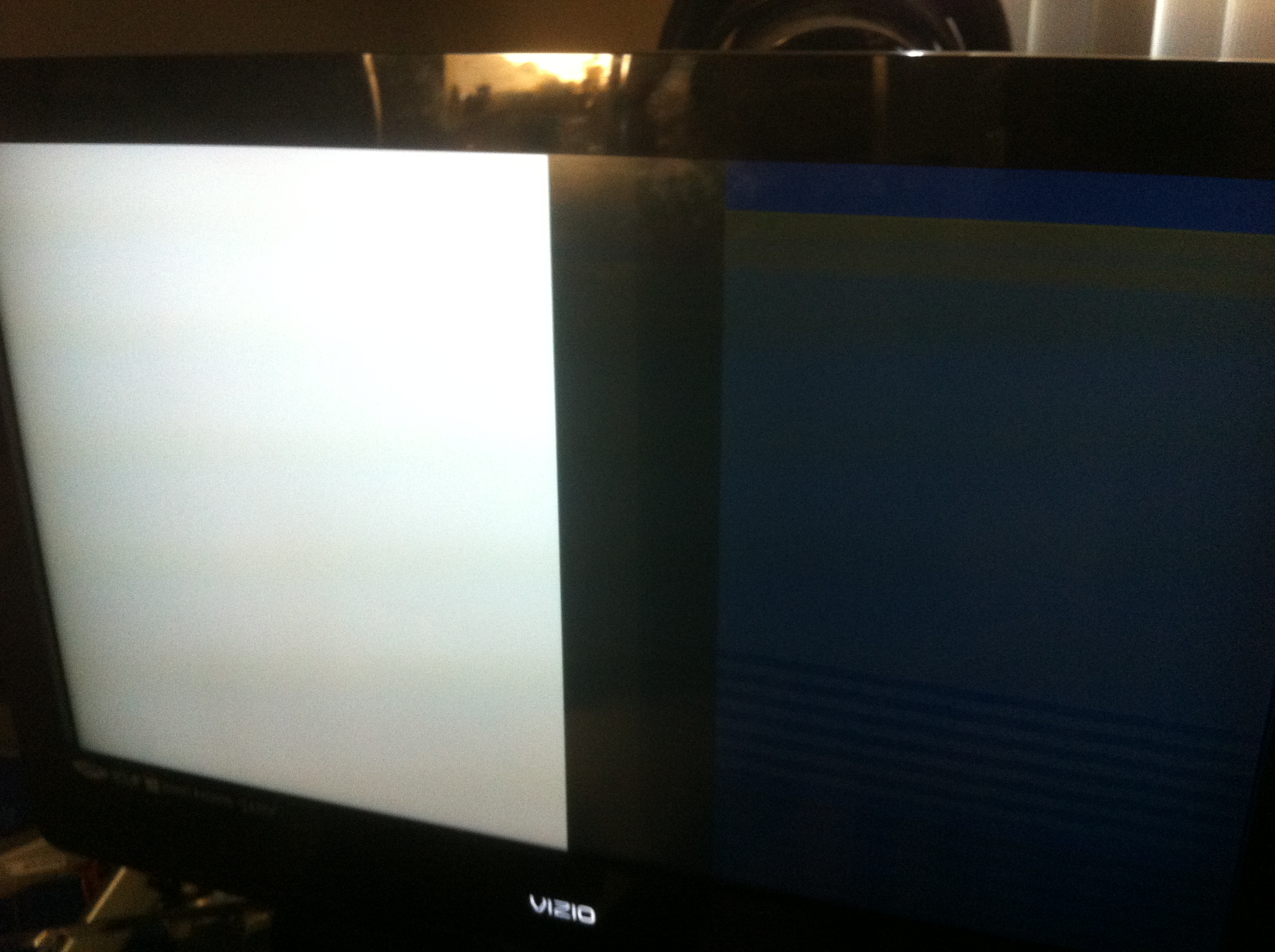

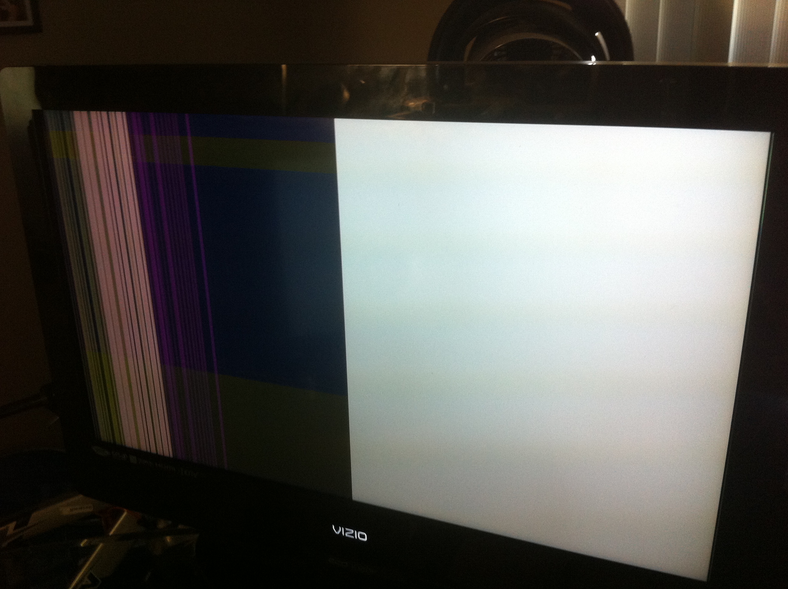

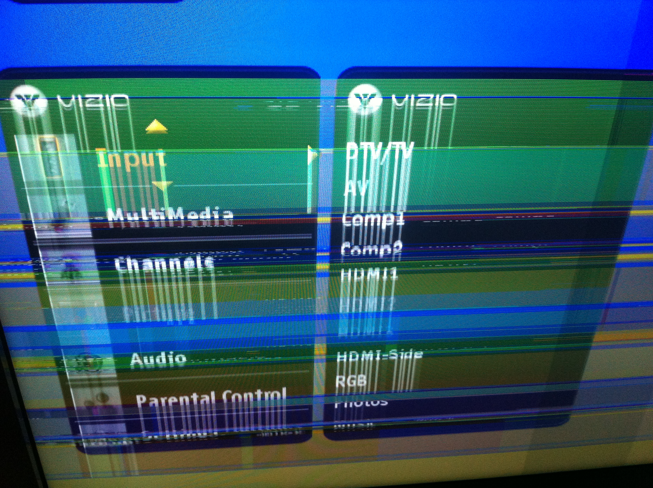

    Hello every one, fist thanks for having me here, i have very limited knowledge on electronics, still learning how to use a DMM. i bought this vizio for $30 off craiglist, so far i had check caps and volts on the power supply all good, bought an used tcon board from ebay that didn't fix anything, here are some pics of my tv

    im going to say panel fail,can you twist the frame,does anything change?

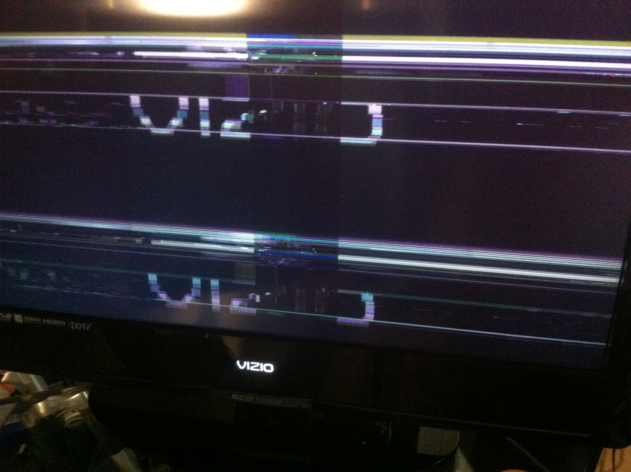

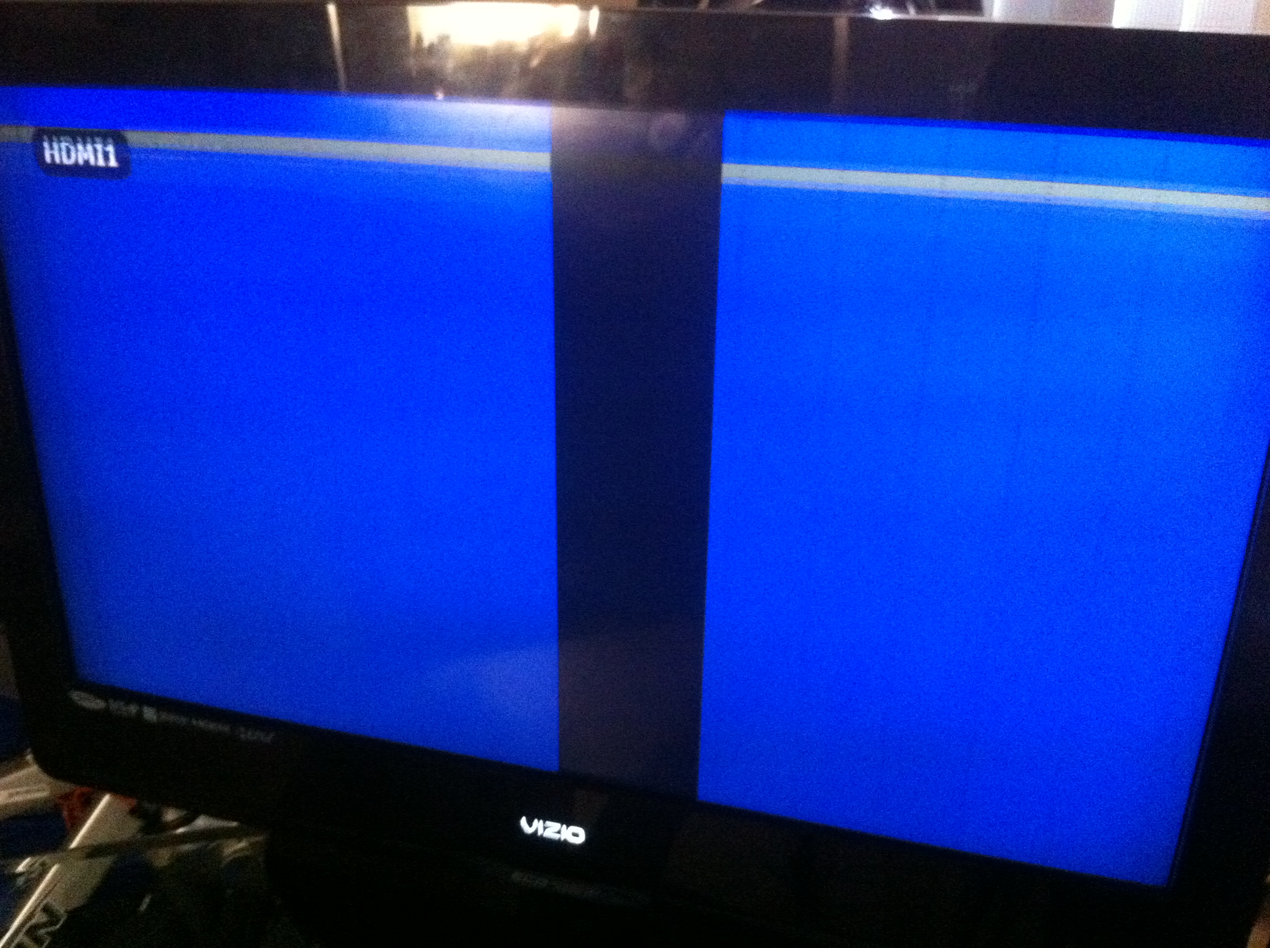

      thanks for the reply, i took the frame off, i twisted i pressed the edge and still the same, when i take the t-cons ribbons off the panel this is what i get

        try cleaning the ribbon contacts with iso,alc,and reinstall
        it still could be tcon,panel,or mainboard issue

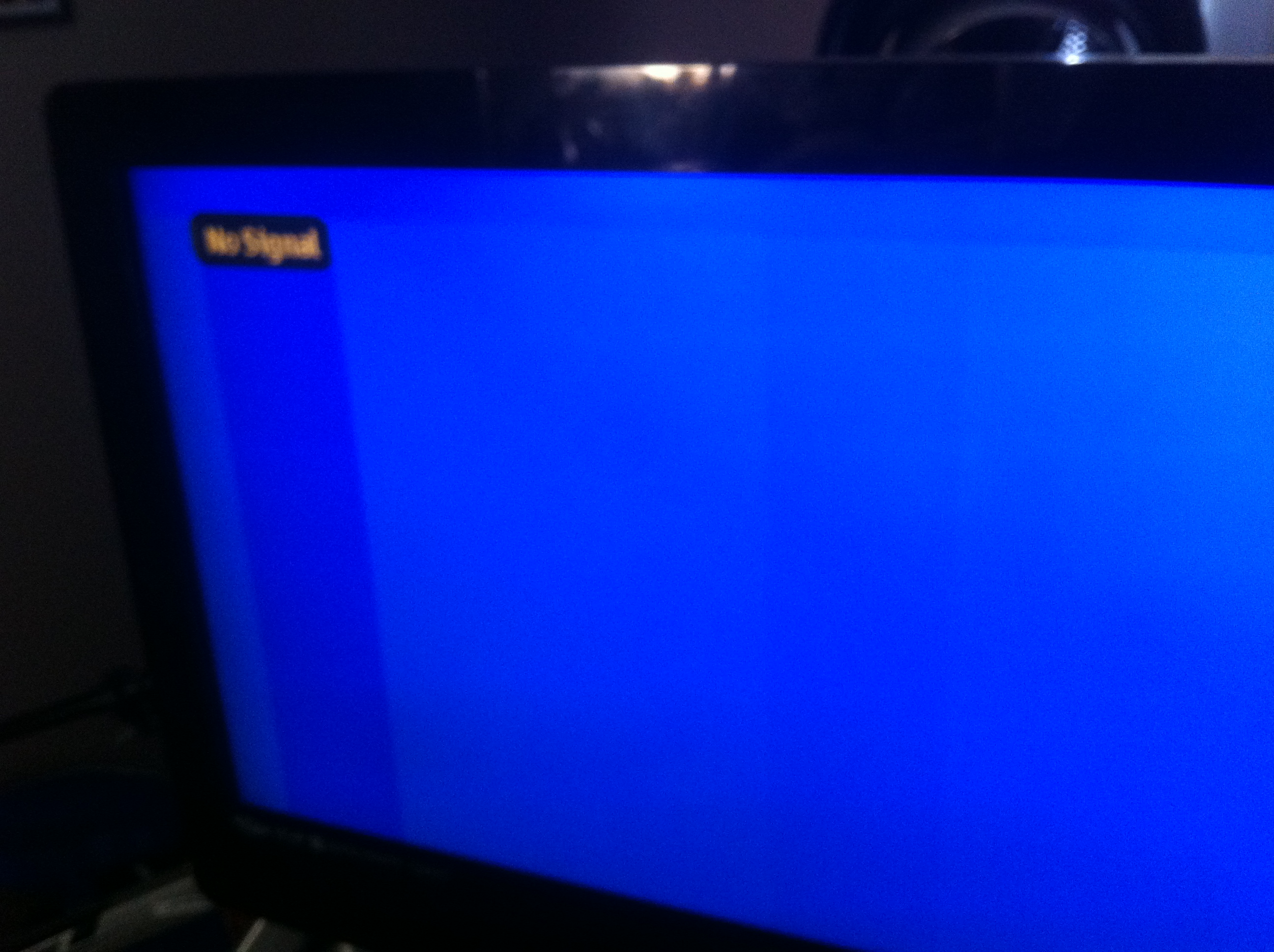

          I clean the ribbons, and still the same. i think it is the panel, btw i have good audio on all inputs
