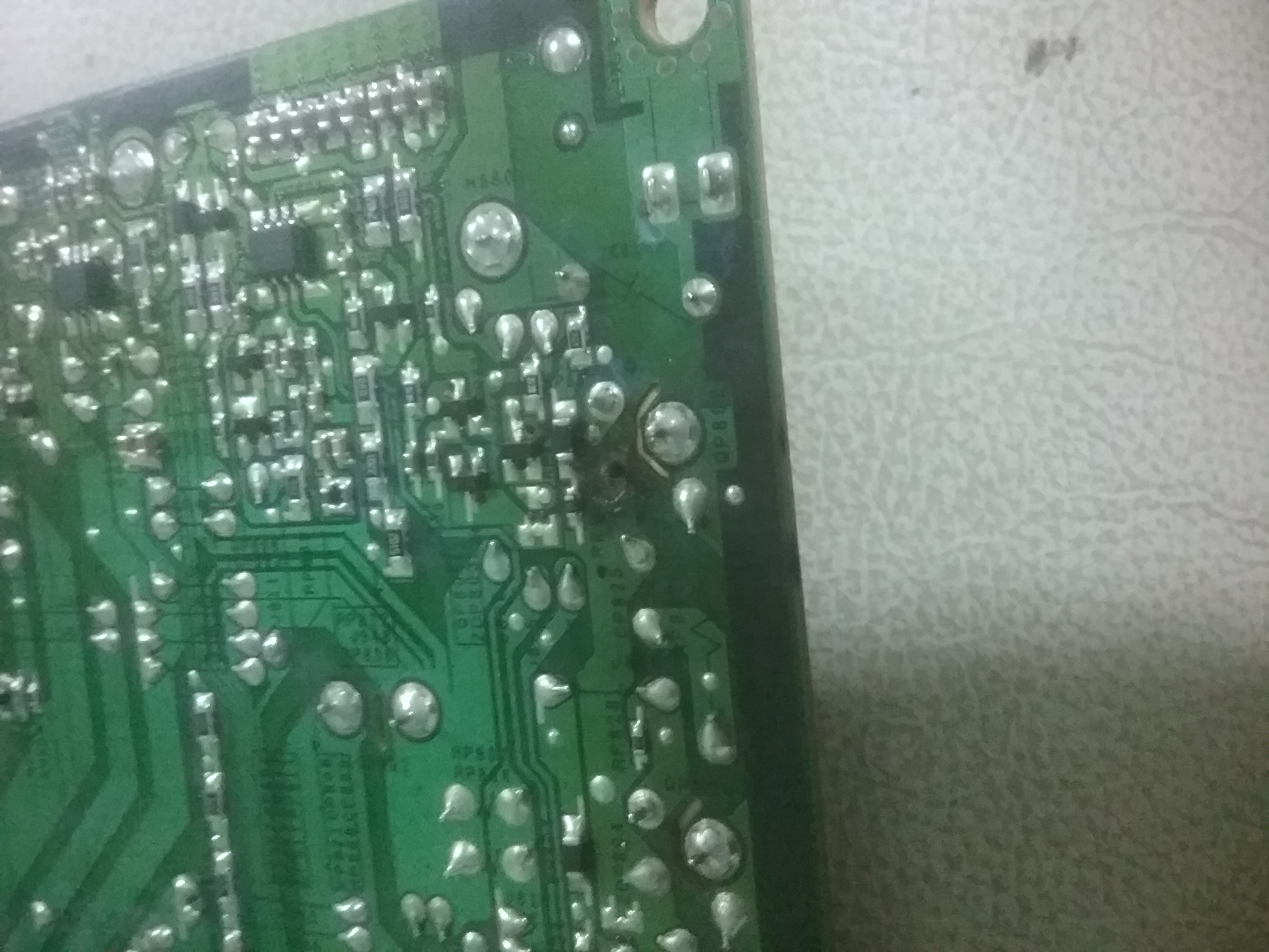

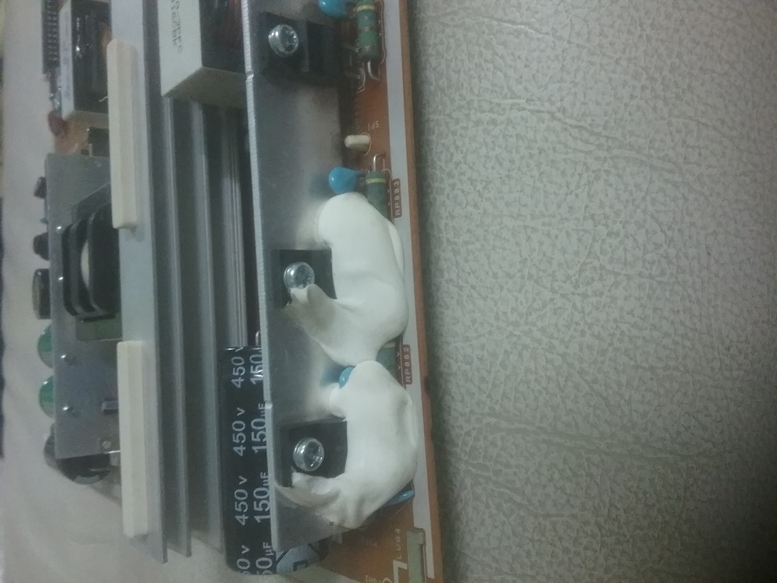

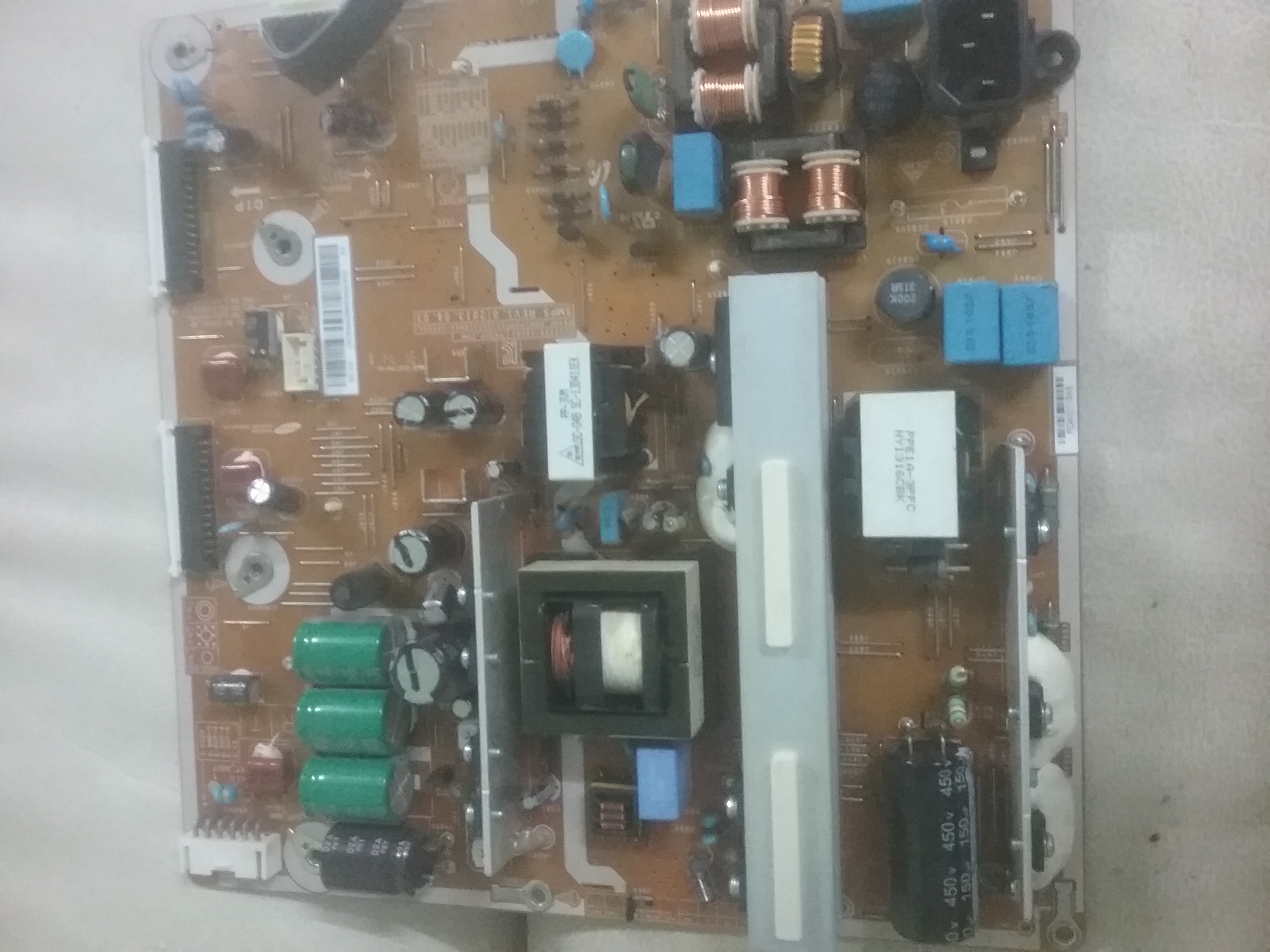

    Hi all
    Tv when plugged in does nothing

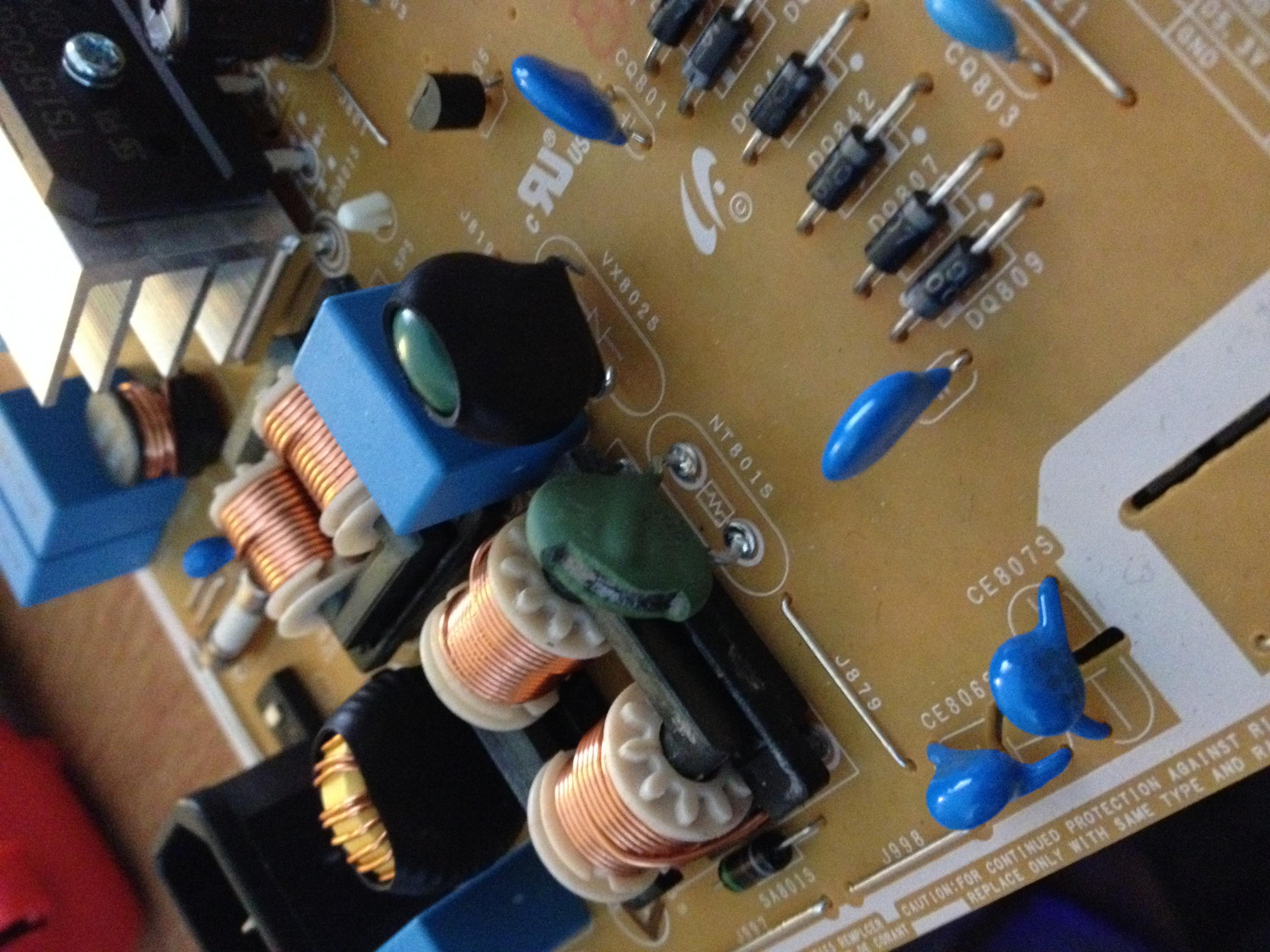

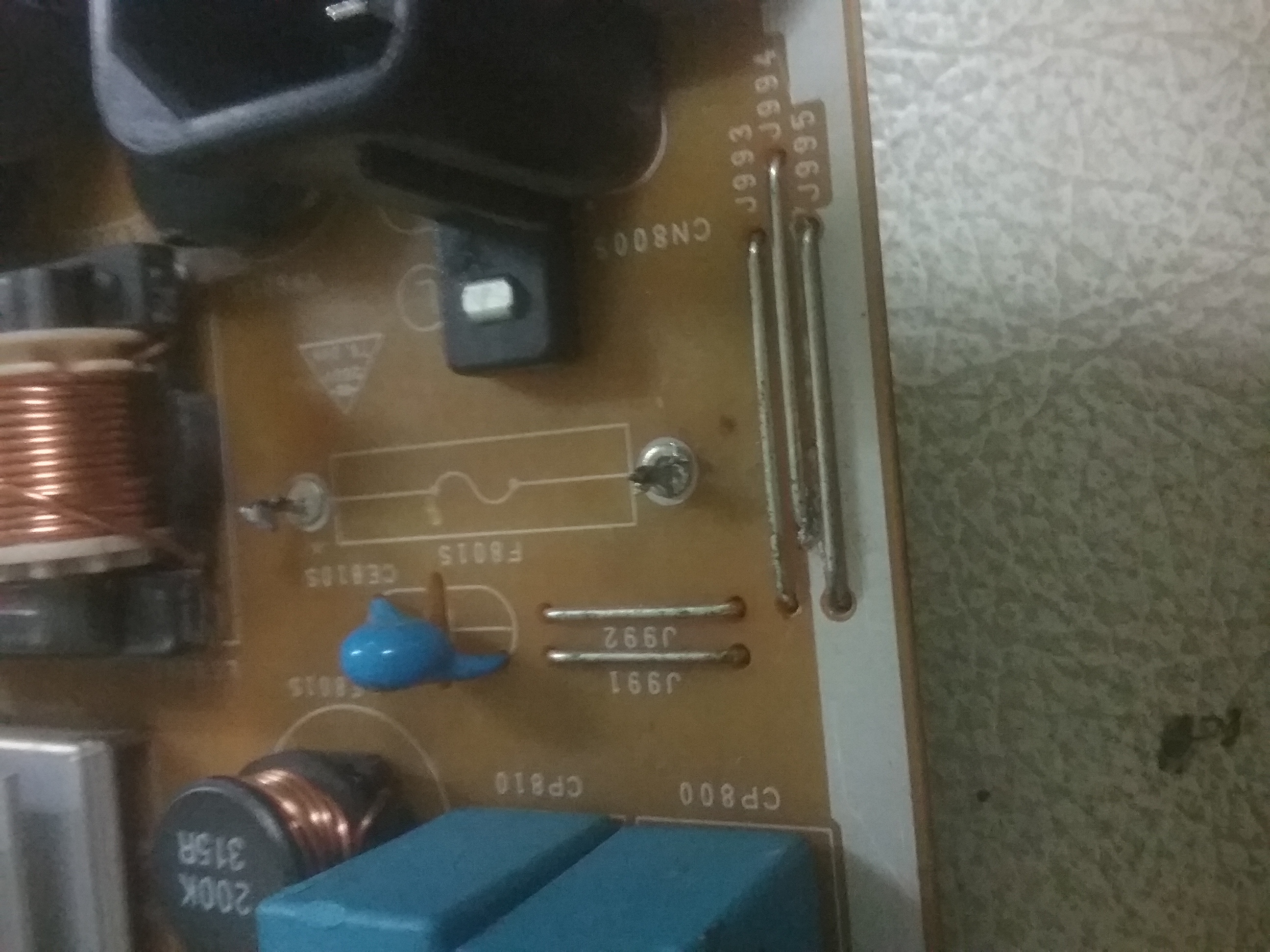

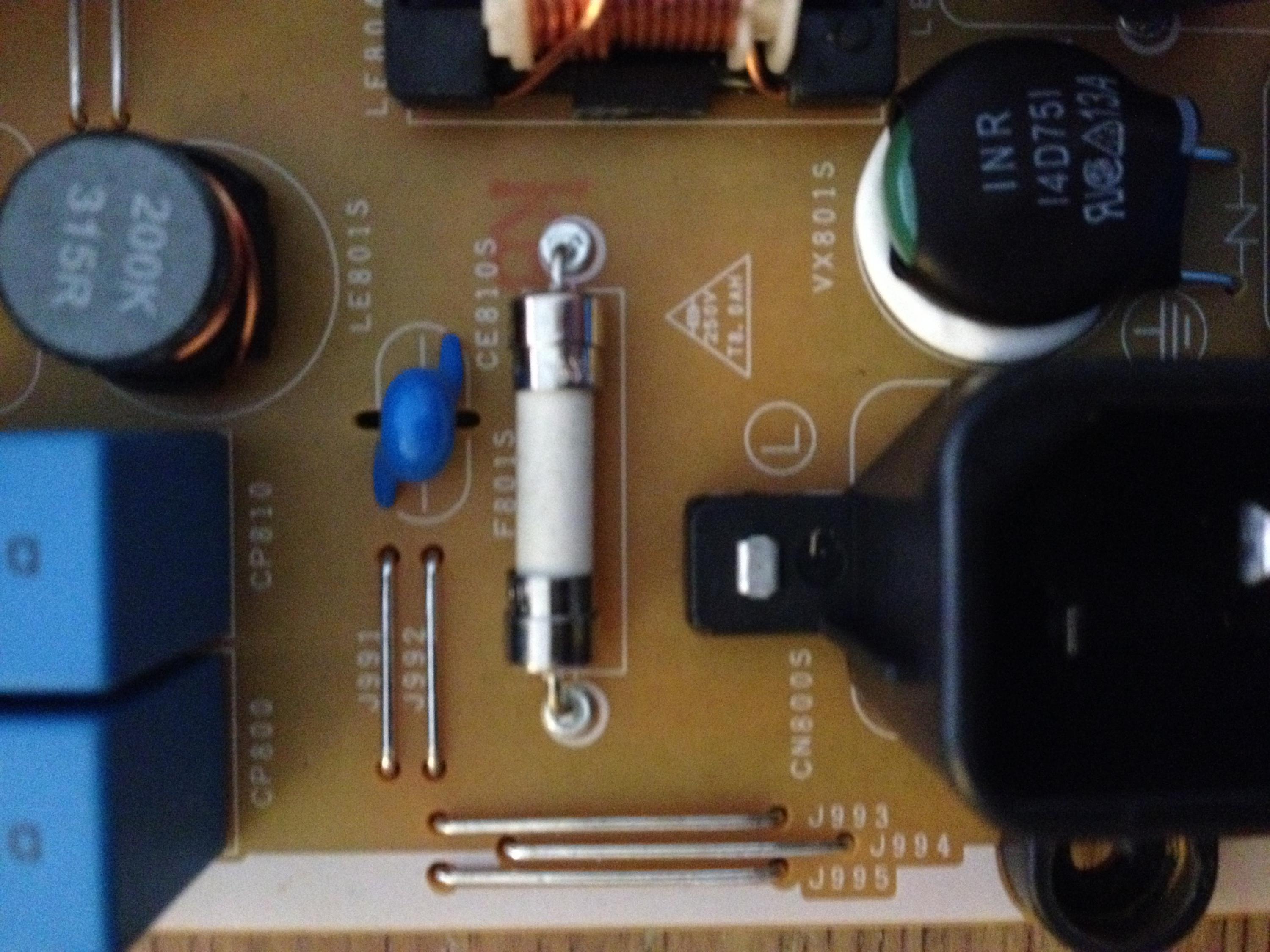

    When i opened up i found that the main fuse on the power board has blown also another type ceramic disc also looks blown
    can anyone identify these for me please also how do you remove the white fuse have i got to de solder one of the legs ?

    You will need to unsolder both ends of the fuse. Perhaps replace it with a fuse and holder - easier if it blows again.
    Remove the green disc and advise if any numbers on it. Looks like a Thermistor.
    Unfortunately there may be more damaged components
    Test the bridge rectifier if it has one or diode bridge id not.
    Good clear pictures of your boards will help us help you

      thats a thermistor,just check your fuse for open,caused by a transient surge,wont harm to check your bridge rectifier,and smoothing cap for a bulge while your at it.
      for testing replace it with a 5ohm metal oxide resistor,if all good and works ,replace the thermistor,and fuse,you could replace this with a pico fuse,if you cant get the right one.
      but power up the tv with series lightbulb across the fuse holder,without a fuse in it ,if it goes bright and dims down,your good to go

                    An NTC like that doesn't fail from such an event. The power supply probably has had a short at or after the bridge rectifier to cause that.

                        hi all quick update - engineer came and tried replacing the PS
                        Now all it does is blinks
                        So he has taken away to repair at workshop
                        The PS failing has taken something else out the engineer suspects the mainboard
                        He asked if its ok to take as i will be a couple of days, i didnt mind just wanted it working again *cough*

                              Just an update
                              TV returned - in the end they replaced the Y-Main, speakers and PS
                              also got a new stand off them for £33 as i didnt get it with one so all in all a great find
