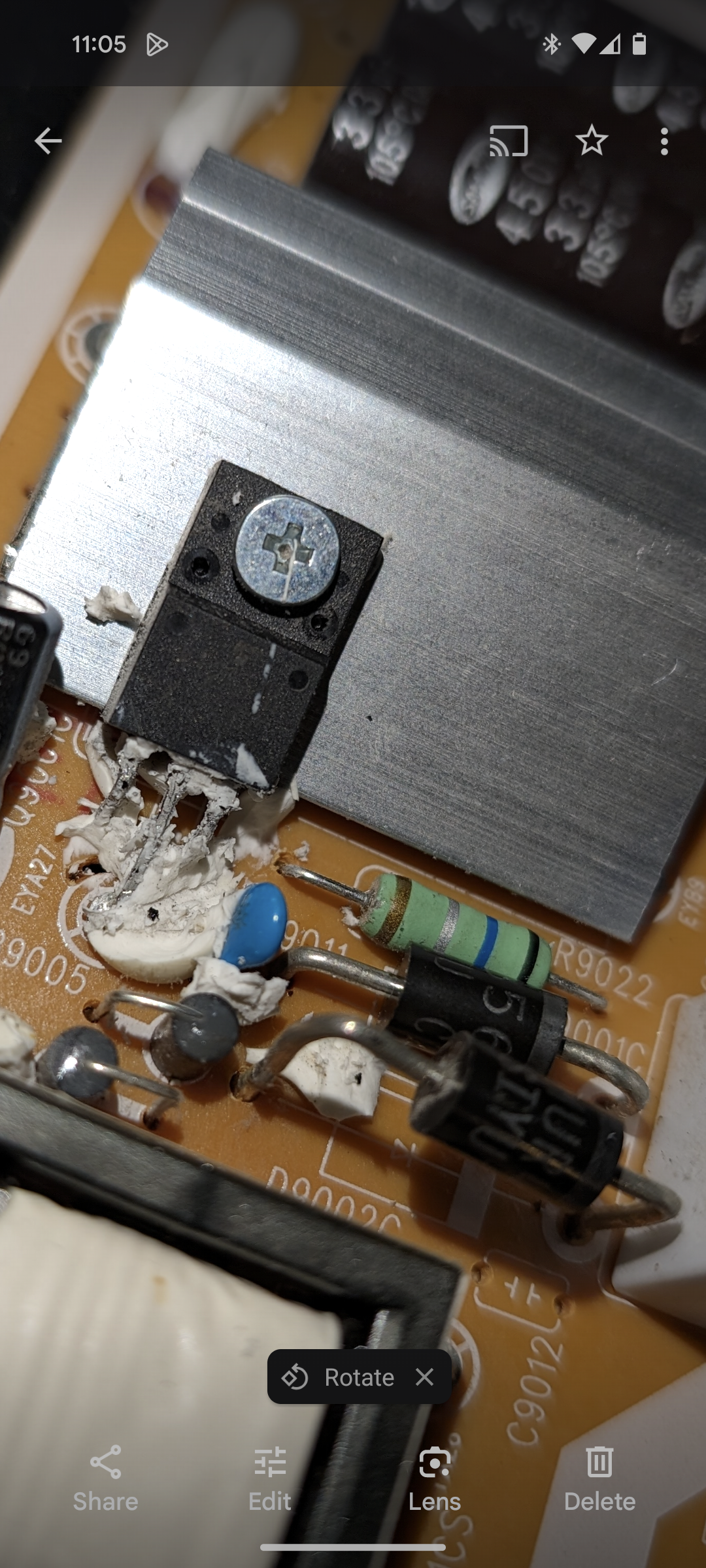

    Well lets make sure on that resistor, is it visible on here, if not what are the colors on it?
      Attached is a photo of it. I don't really understand how to interpret the readings from either of my meters as far as resistance goes. I don't get a clear "600 M ohm" or even .600. I get whole numbers with decimals and they'll move around between 20 and 200 ranges

                  Is it black-blue-silver-gold, I get .06 ohms, if those colors are correct, then even 1.2 ohms is way out of specs, then as usual when a reading seems off in circuit lift a leg and check ooc.
                    black, blue, silver, gold is correct. When I looked it up I got 600 M ohms. Maybe I did something wrong
                    I checked other resistors on the board and got similar oddball readings. I think the resistor ok. That one diode on the bottom has been mentioned on these forums several times as causing these symptoms. It's surface mount, so if I take it off to test I'd be replacing it as well.
                              Double check the resistor value using one of the many available websites.
                                using the tool on DigiKey I get either 600M ohms or .06 ohm depending on the color is the third band, which I'm not positive if it's grey or silver. Can you tell what color it is?
                                Also, my reading of 0.00 ohms means my resistor is bad, right?
                                Edit: it has to be silver because that's .06 Ohms. Grey would be 600 MegaOhms. I can't however find a .06 Ohms resistor online.

                                  It looks like it can't be either of those. 600 M ohms would be a huge resistor, and from what I'm finding .06 ohm doesn't even exist.
                                  I can't find a schematic for this board either
                                  Edit: wow this is frustrating. I can't find a schematic, therefore I can't see on paper what the value is supposed to be. Likewise, searching for the board number and "R9022" turns up absolutely nothing. And to top it off I'm finding this exact same model board with a completely different 5 band resistor instead of the 4 band I have.

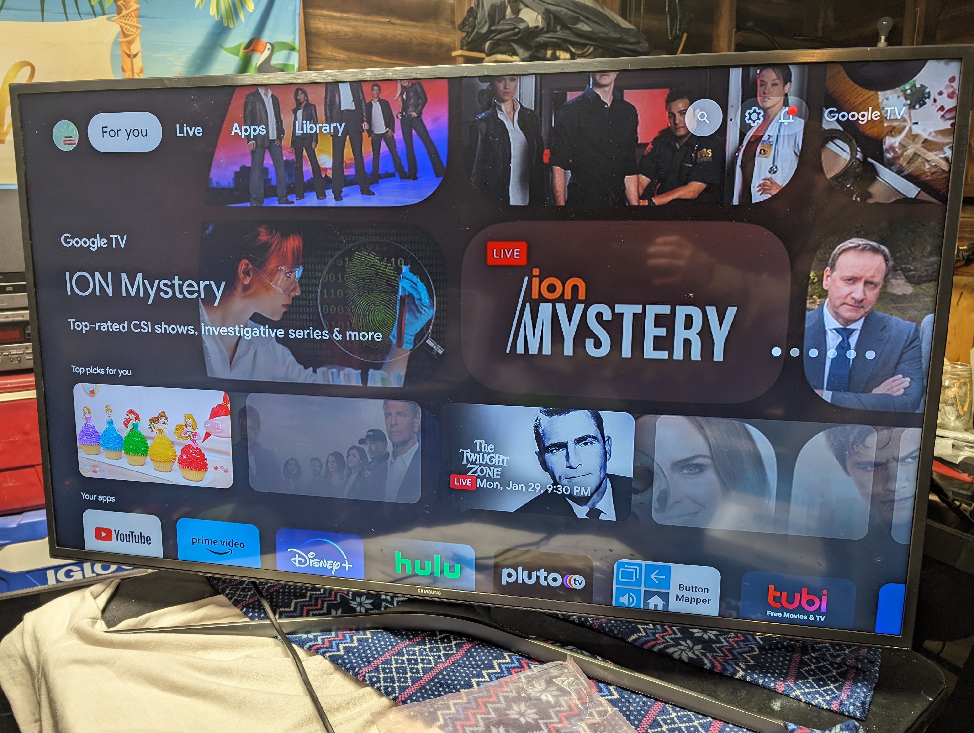

                                    I gave up on diagnosing the original board and just ordered one from eBay. I put it in last night and the tv is working great.
                                    My advice to anyone else with this model power supply is to just get a replacement. There's too many things that fail on it and getting it working may only buy a little bit of time before another component fails.
