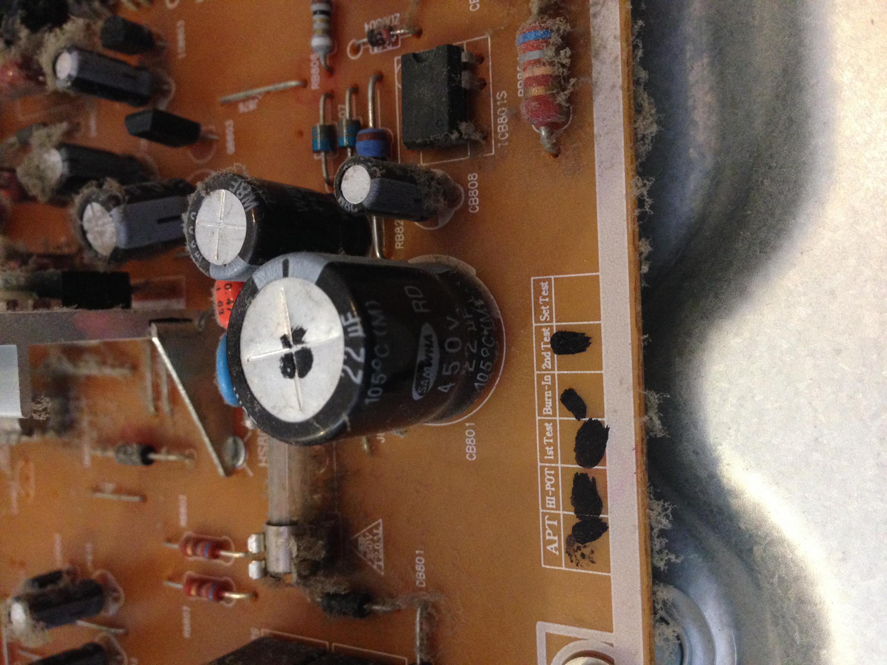

    I've got a problem with a Samsung PS42A457 plasma which is permanenently stuck in standby. The light is on and it receives the IR commands from the remote, but it wont come out of standby.
    I've read that this is likely to be a problem with the caps, so off the back came, expecting to see some blown/bubbled/leaking capacitors.
    Sadly none found. Well. I think none found. Plenty of dust and fluff though.
    Theres one black capacitor which looks a bit suspicious on the power board. Its got a small black dot on the top, but it still looks sealed. The dot looks like marker pen though, to the untrained eye (mine).
    I've attached a photo. Can anyone give me an opinion please before I start taking the board off and removing/replacing anything?
    The caps are all made by SAMWHA and none of them seem blown, unevenly seated or leaking, apart from this one. Ive read here that "generally" theyre quite reliable - compared to some.
    Oddly, theres the burn-in test records close to this cap, and they're marked on the circuitboard with what looks like the same "pen"....helpful, not. Just makes me a bit sceptical of what I'm looking for.

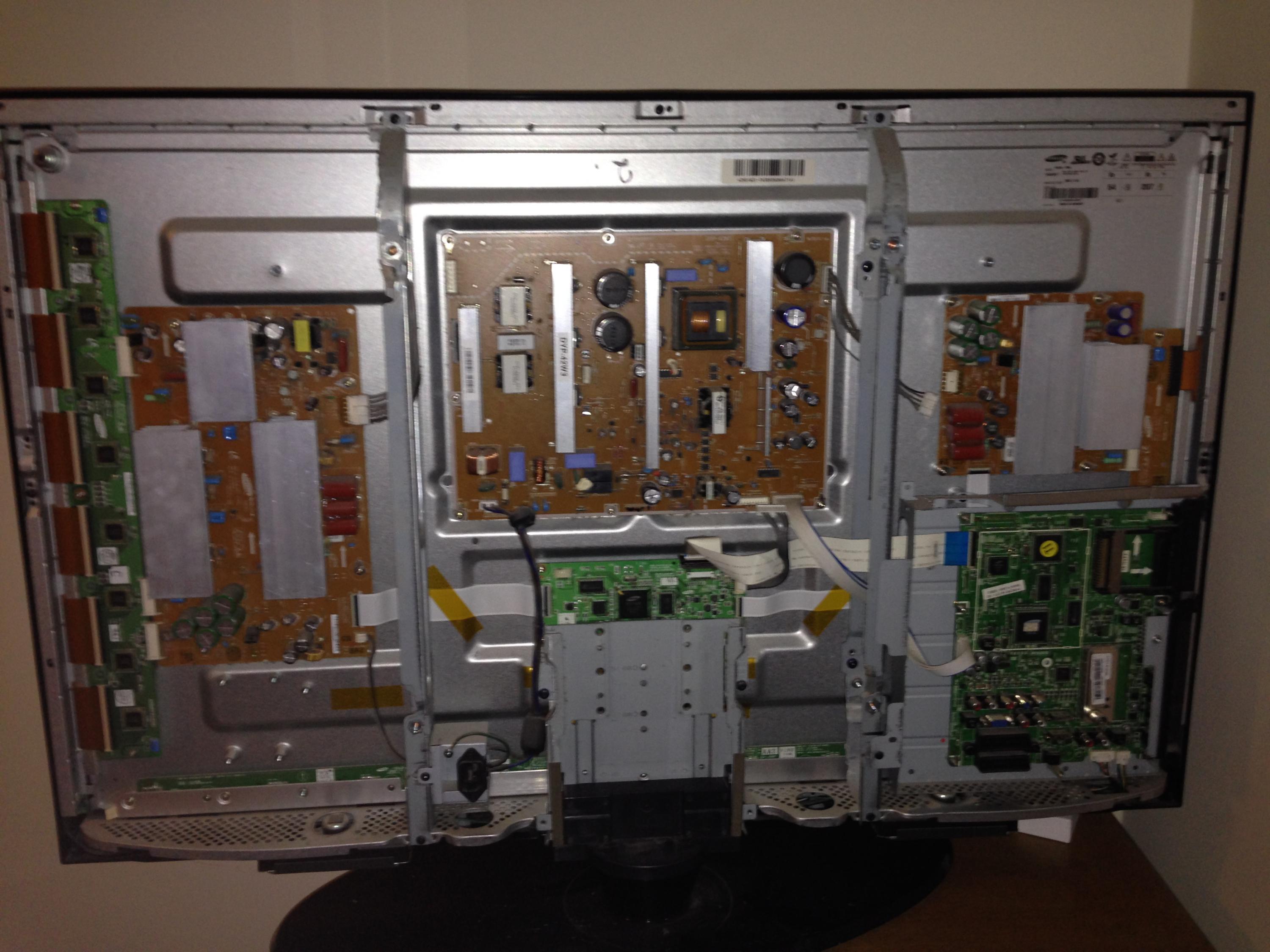

    will you upload a picture of the whole back side, i believe there is a test mode for samy plasmas procedures i think are in the stickys posted my tom66

      That mark on the top of the capacitor is there from the factory. FWIW it doesn't look bloated to me however caps can look ok and fail an ESR test.
      Need more pics, one of the whole back of the set and pics of each board separately.

        That 22uF cap is the supply start-up cap for the Stdby 5V supply. (small DIL-7pin chip by its side....
        Guessing its working--as its in Standby with the red-led showing....
        Does header on PSU --'PS-On' have a voltage on it?
        Does 'Vs-On' have any voltage on it?
        Normal running--the Ps-on will be '0' V and Vs-on will be around 3V
        Ps-on will be 3.4V in Standby.

          I've got a photo of the rear of the set, all boards attached.

          *EDIT - picture taken with X and Y boards disconnected - there are loose ribbon cables just hanging, I know this*

                        Just come across this thread and noticed that the last question remained not answered. Just thought i would end this thread with information that might aid future reference to stuck in standby with this power supply. Had a number like this with standby led showing but with no response. If looking carefully at standby illumination it can be seen to be slightly pulsing and is invariably caused by complete degradation of CB801 (22uf 450volt). Had a number of these lately that have degraded so badly that lost their capacitance completely.

                              Indeed CB801 22μF/450V was the problem. Replaced it and all fine. Also replaced the 50V caps around the STDBY area just in case. TV repaired!!
