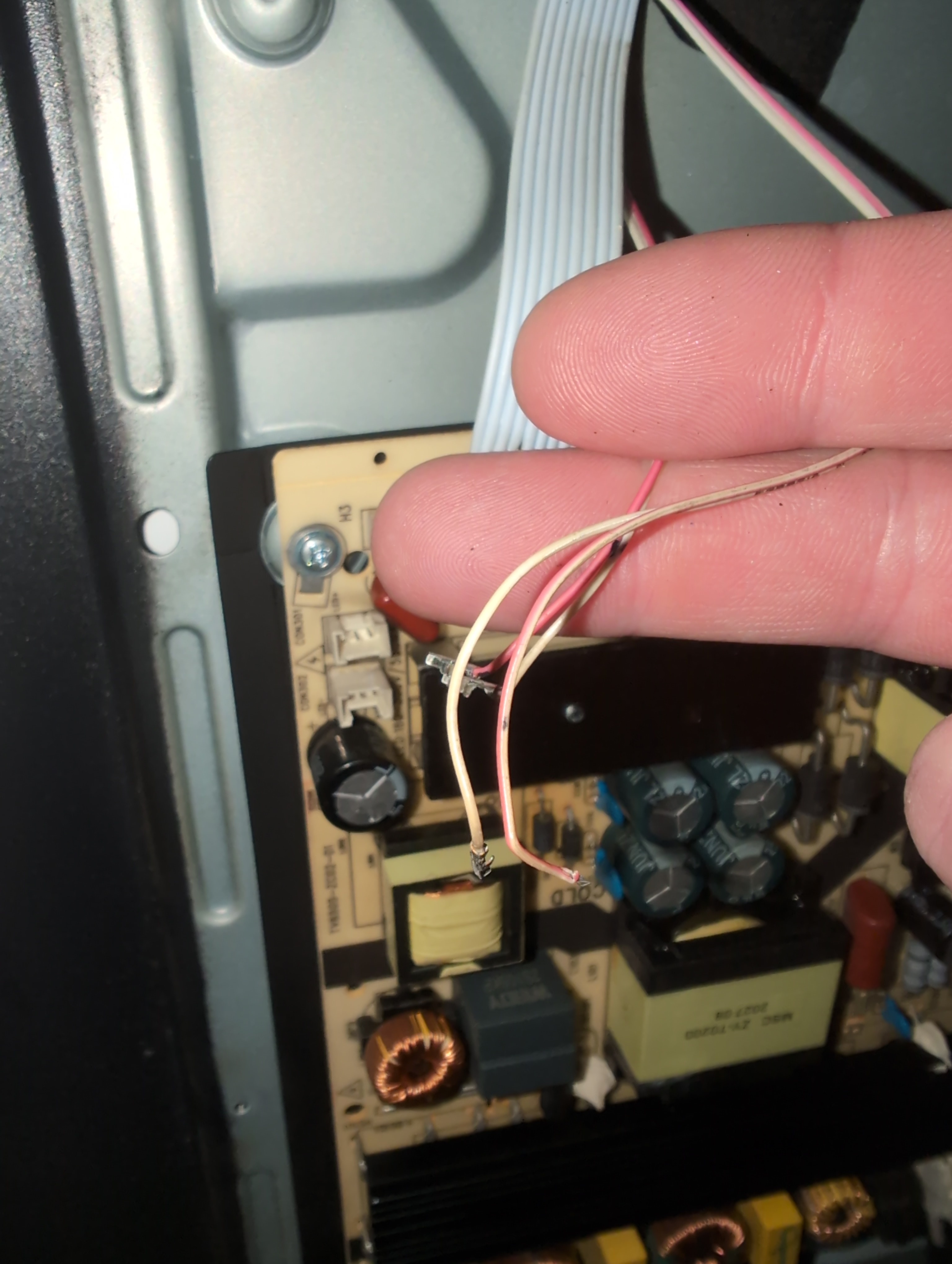

    Onn 100012587
    I just got a 65" Onn 100012587 and the guy thought the backlights were bad. He took it apart 😔 I looked in it and see he removed the connectors on both LED strings, so I can't really plug them back in. I looked for an image on the screen but noticed possible vertical lines. I'm thinking of putting 9v batteries in series and connecting each LED string to see if it'll light up and show me what the screen looks like. I've done this before and it worked, but that was with individual pairs of strips. If I do say 5 batteries (45v), would that at least dimly light a while string enough to see the screen?
  • x_orange90_x
    • May 2015
    • 765
    I looked at replacement strips and each LED is 3v and there are 28 in each of the two strings. That comes out to 84v. If I use 6 batteries that would be 54v, at 1.92v/LED. That should be enough to light them up, correct?

                Well I tried with 6 and then 7 batteries. Didn't get so much as a blink on either string. At 64v I don't understand why they didn't light up even a little.

                      I got a tester and tried it last night. No lights at all. Tried on an old strip I had laying around and it lit up. I'm thinking the guy ripped the connectors off so he could *gulp* attach the leds to an external power source.. And subsequently fried every one.

                            I discovered that the screen is cracked and that's why there are all of the colored lines, which I suspected would be the case. Backlights are fried and the screen is cracked, so I'm just pulling the boards out and tossing the rest.
