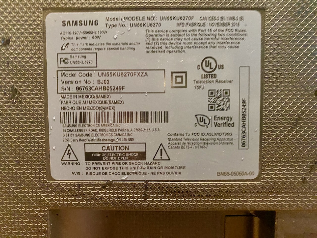

UN55KU6270FXZA Backlight Flashing Briefly on Power On

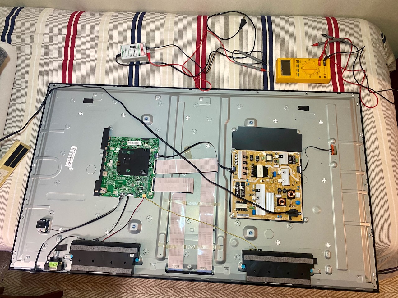

    Probably LED string issue but wanted to check any more easy testing before ordering the LED strips.
    Inspection/Probing

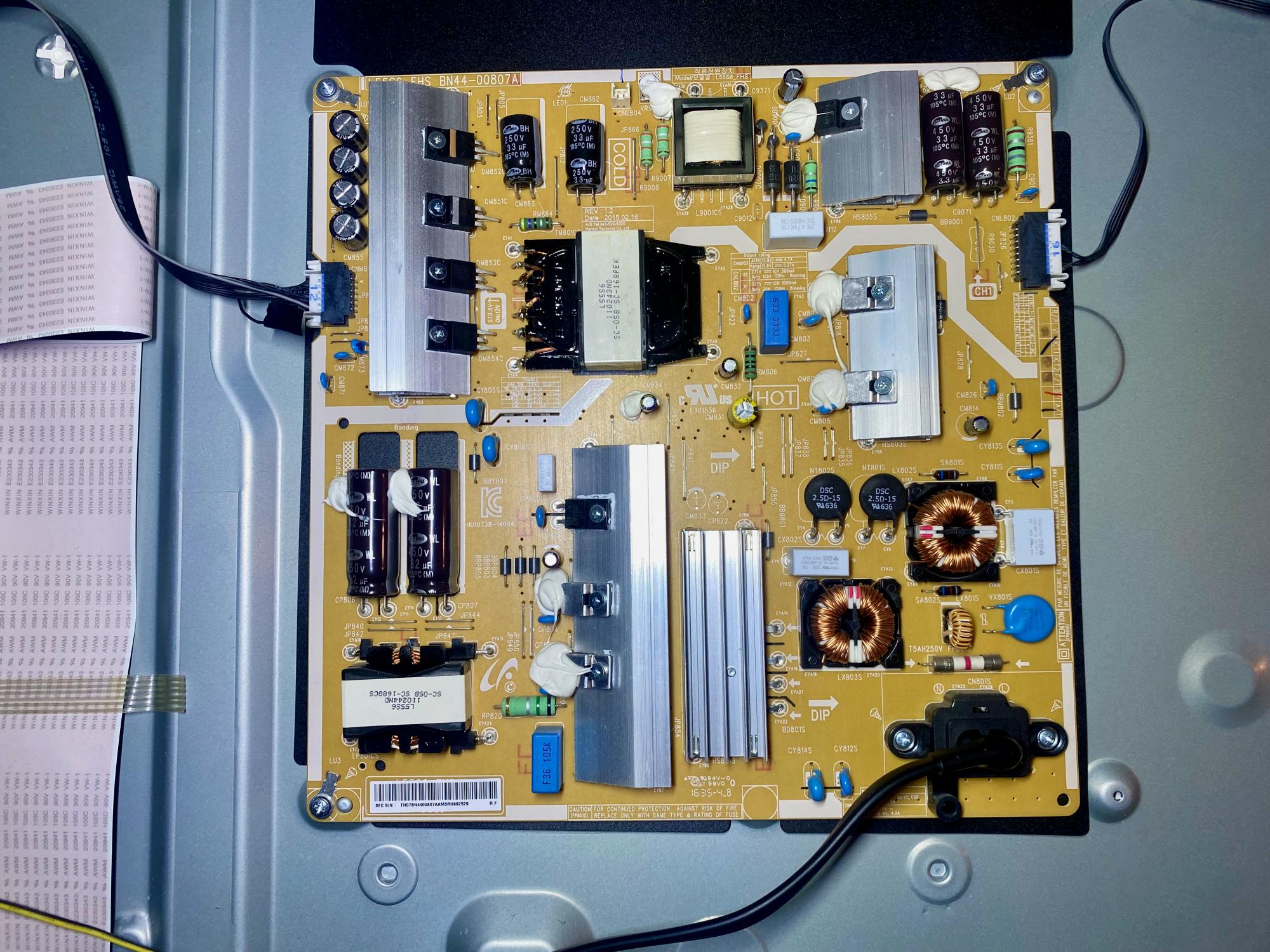

    • No shorts around caps on main
    • No bulging caps on PSU, no evidence of any damage
    Disconnected PWM_BLU between main and PSU
    • Backlight powers on when PSU gets power. Doesn't wait for main board power on.

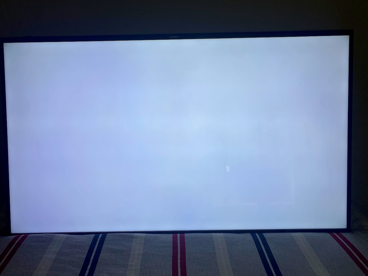

    • Remote turn on TV, display is perfect. White screen test shows no dark spots
    • Remote turn off TV, backlight stays on until PSU power pulled
    • Both LED strings reads 124+V. 14x 3v LED / strip x 3 strips for each string
    • PWM_BLU line on PSU reads 3.1v
    LED Tester
    • LED strings disconnected from PSU. Tester only drive up to 109v. One string ramps up to 109 a little slower when powered off for awhile.
    Anything else to check before ordering LED strips?
    All pics shown are with PWM_BLU disconnected

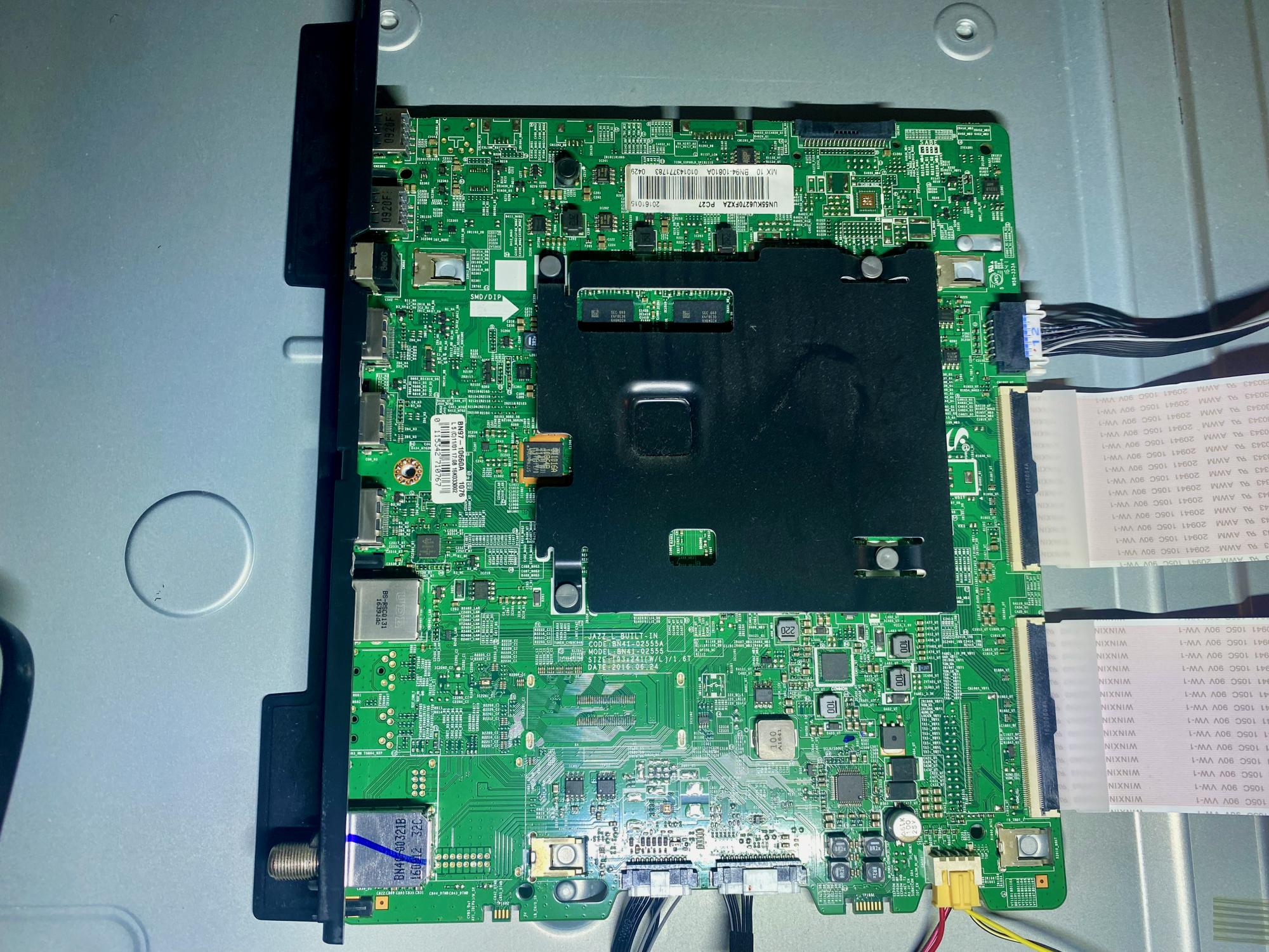

    PWM_BLU reading on main/tcon side with line disconnected to PSU (only line disconnected on the 12pin connector between main/tcon and PSU)
    • ~0.3v and doesn't change as I change backlight menu between 0-20
    Perhaps this suggest main/tcon board. Probed around and found the PWM_BLU connector solder joint just flaked off. Touched up the solder joint and no change. Perhaps a short has weakened the solder joint.
    Reconnected PWM_BLU between main/PSU. Power on the TV and PWM_BLU is shorted the ground. So pretty definitive issue is main board. TV owner also mentioned game machine on HDMI sometime causes TV to reset. Perhaps first step is a toaster oven reflow before ordering a salvage replacement

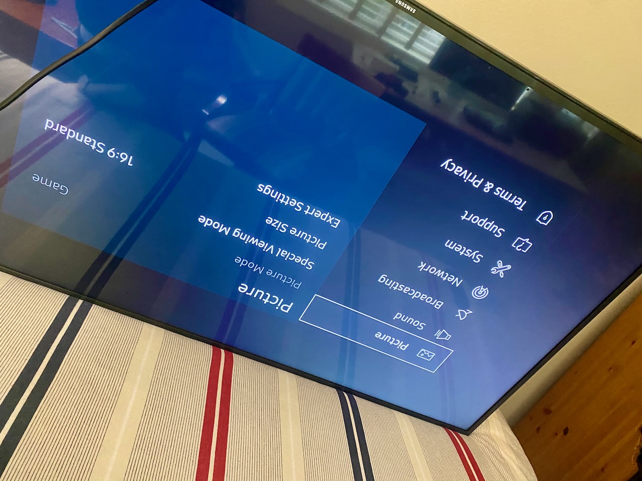

      • ANA_DIM - This is direct backlight control. When changing backlight setting between 0-20 on the TV menu, backlight string voltage will change. From ~121 to ~128 per string on this TV with 42 3v LEDs per string.

      Perhaps replacing the main board (or find whatever is failing on the board for this brightness processing) is the proper solution. For this particular TV, salvage main (BN94-10810A) Version BJ02 is pretty rare and expensive. Unsure if other boards of the same design will work. Panel number on this TV seems to be unique to this model # (CY-GK055HGEV6H)

      Got into service menu and set PWM _INI_2D, PWM_MOVIE_INI, PWM_Mid, PWD_Min all to 100. Seems to have no effect. Here is the directions on that
      https://youtu.be/ov9niiau5x4?t=138

          I noticed you had a backlight tester at your disposal (pictured on the bed).
          Was the problematic LED strip the one that ramped up to max voltage slower than the other?
          • howardc64
            • Jun 2017
            • 636
            Re: UN55KU6270FXZA Backlight Flashing Briefly on Power On
            My notes said 2 dead LED post LED bar extraction testing with LED tester. Unfortunately forgot to correlate if on the string that ramped up slower.
            Kind of a PITA problem to diagnose as backlight doesn't clearly show error while installed which is why so many people use the PWM_BLU disconnect trick. But this trick probably also runs the backlight brighter.
