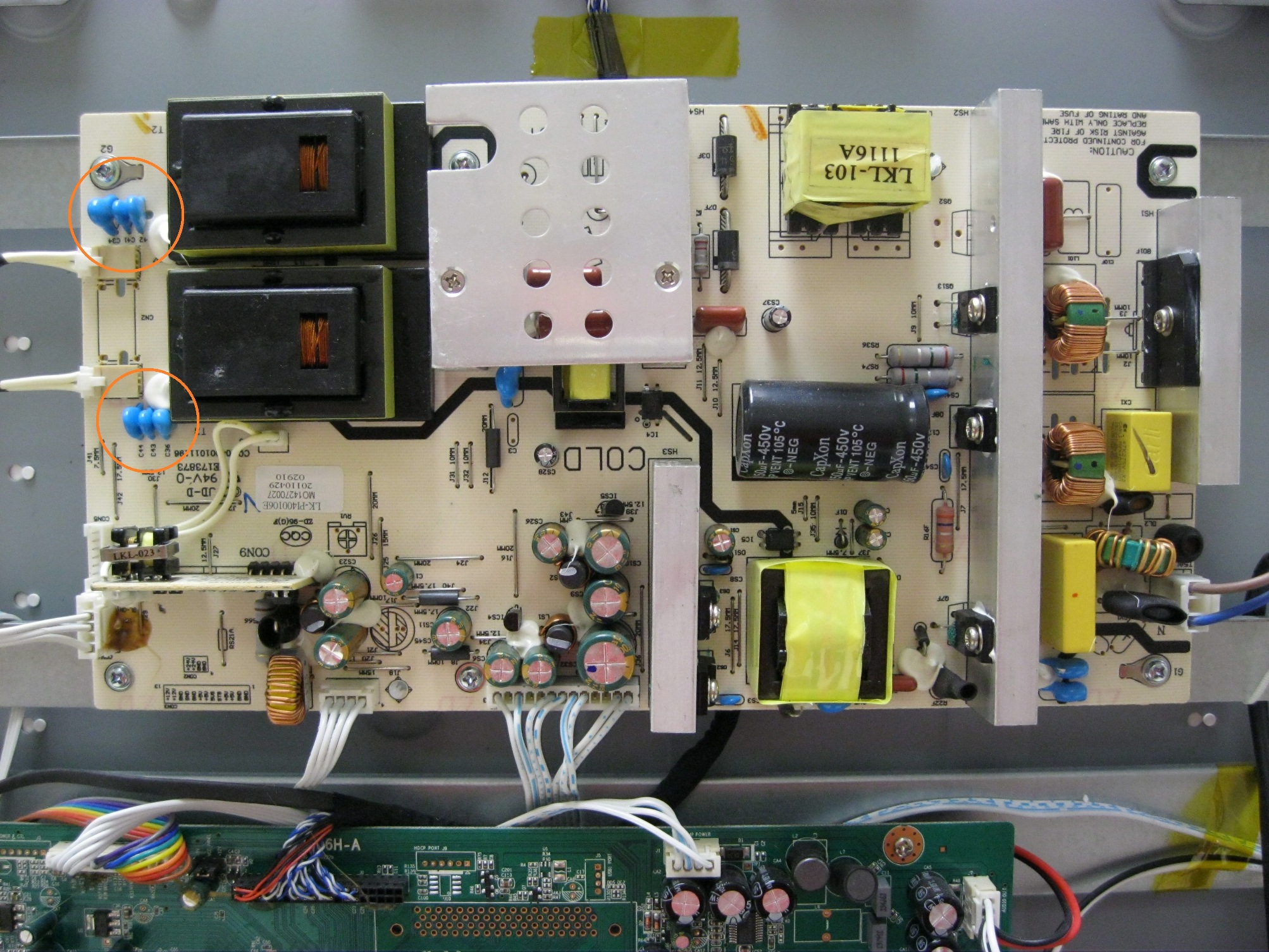

    Removed power board and identified caps C34, 36, 41, 42, 43, 44 (see orange circle) had been replaced . . messy soldering. Everything else looks clean, no signs of any damage, burning, electrolytic bulge or discolouration of other caps.

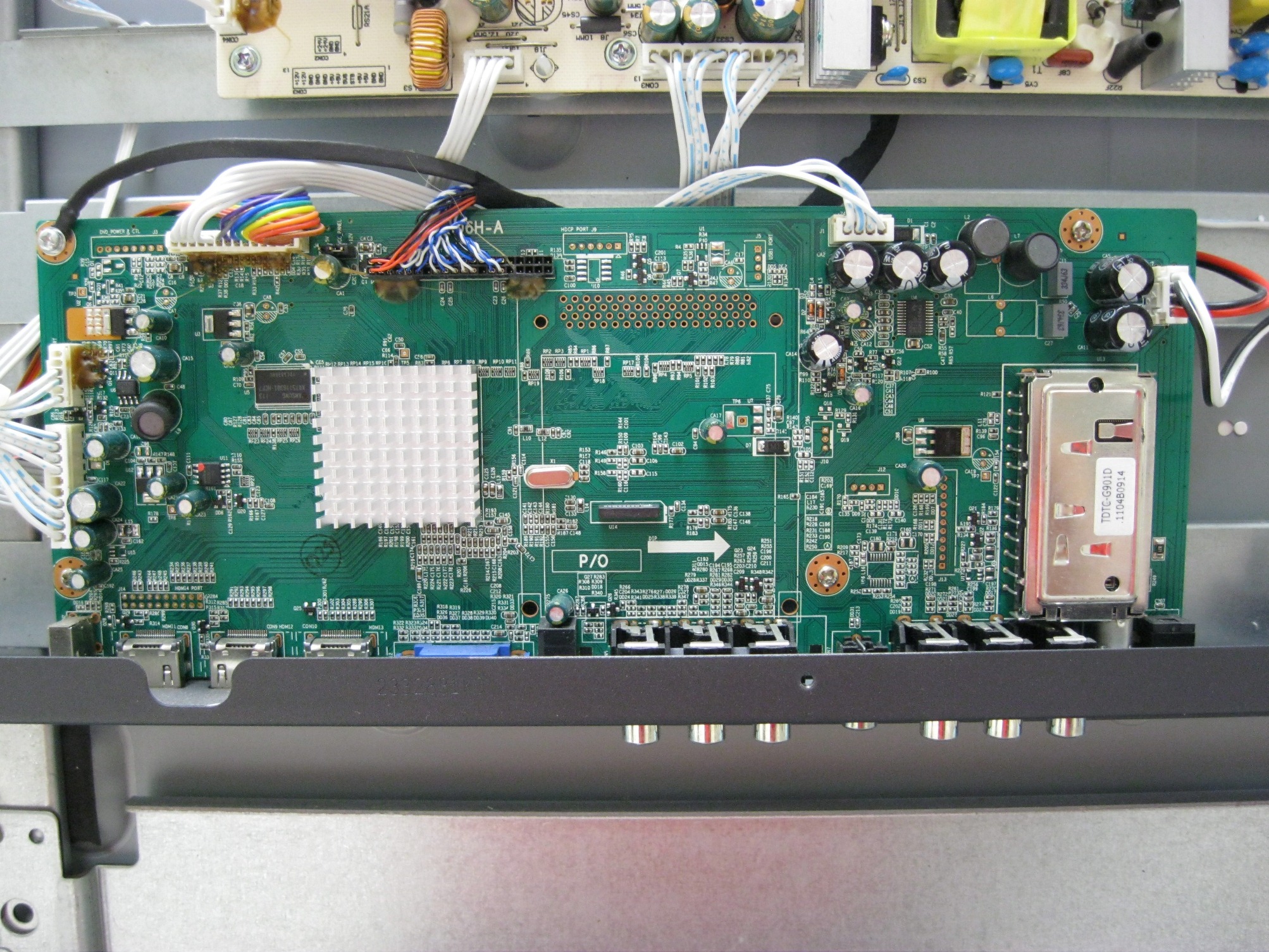

    Images of power and video processing boards attached. I can post images of whole rear assembly and solder side of power board if necessary.

    hi although the other capacitors look good they may still be faulty this is where a esr meter comes handy a tip try heating the whole power supply board with a hair dryer for about 4 minutes and then see if the screen lights up as normal i have a psu im working on at the minute and when heated its working great so i have just ordered every capacitor for the board it worth a try at least.
      Re: VIVO 40" LCD (LTV40FHD) No Picture
      Finally had a chance to get back to this one. On closer inspection, It looked as though the caps may have only had their solder joints attempted to be reflowed. The work was pretty shoddy; dry joints and flux residue. I removed the caps, cleaned up the board pads and resoldered the components. Worked a treat.
      Hope this helps someone else with a similar problem.
