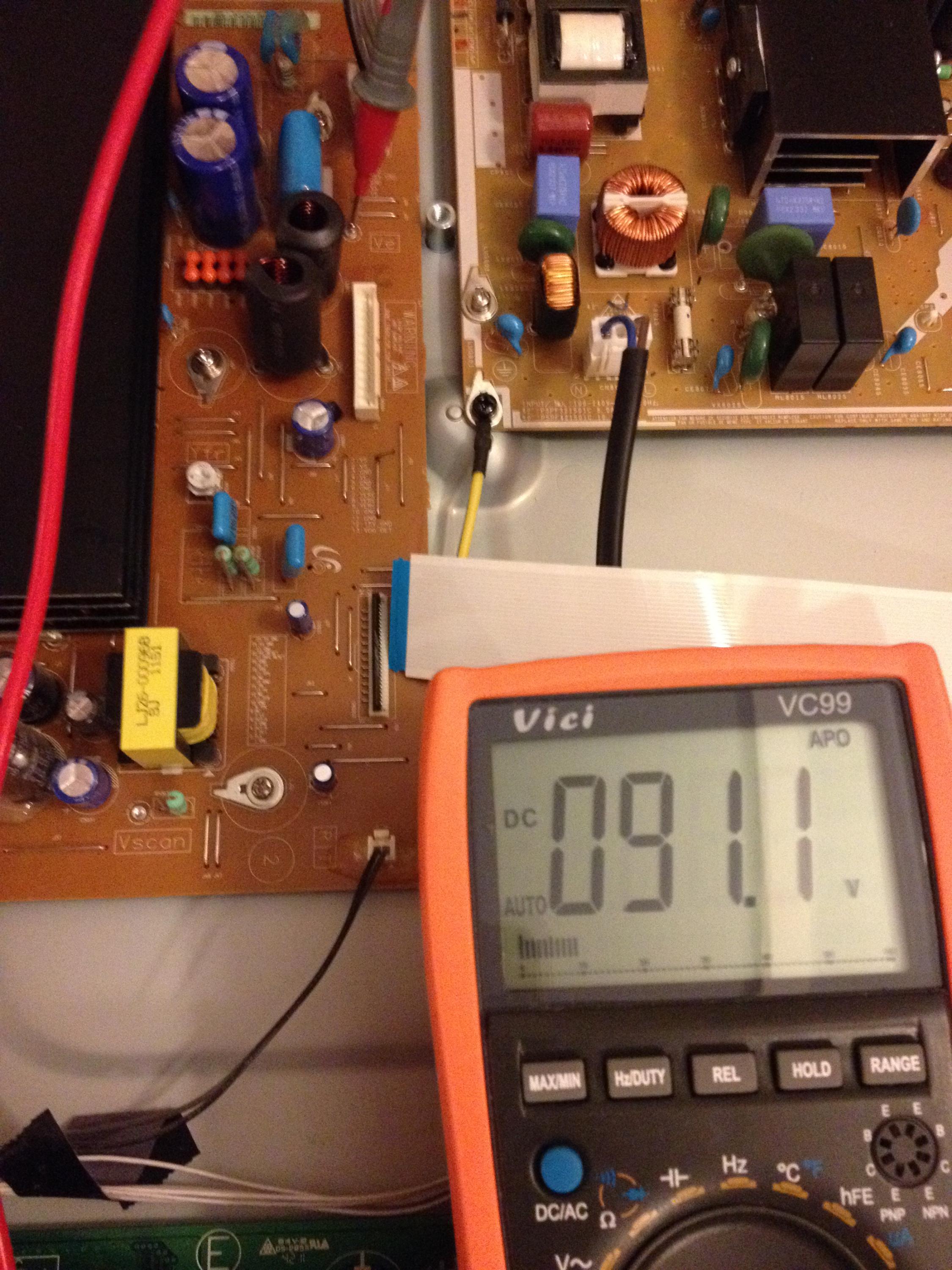

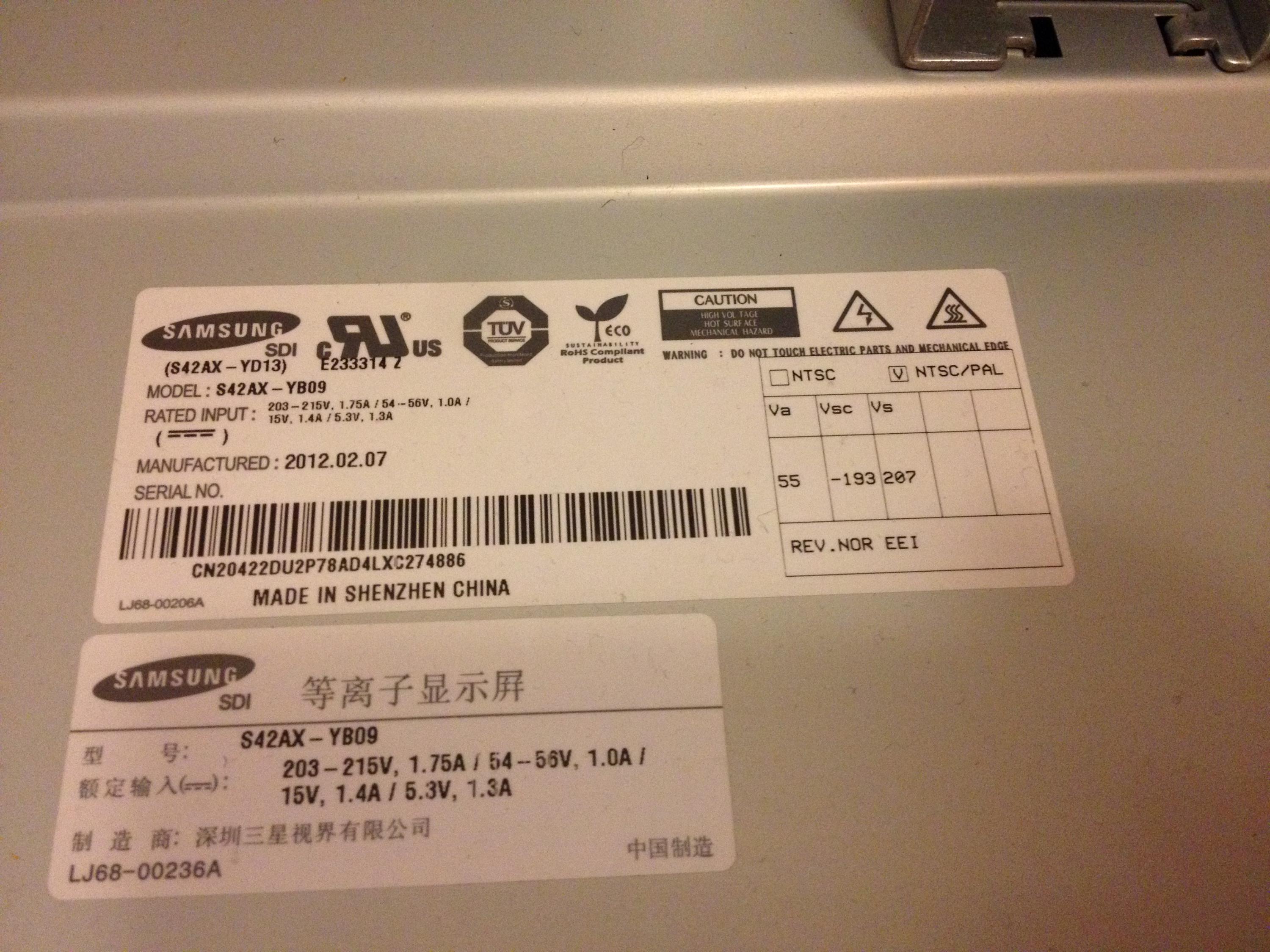

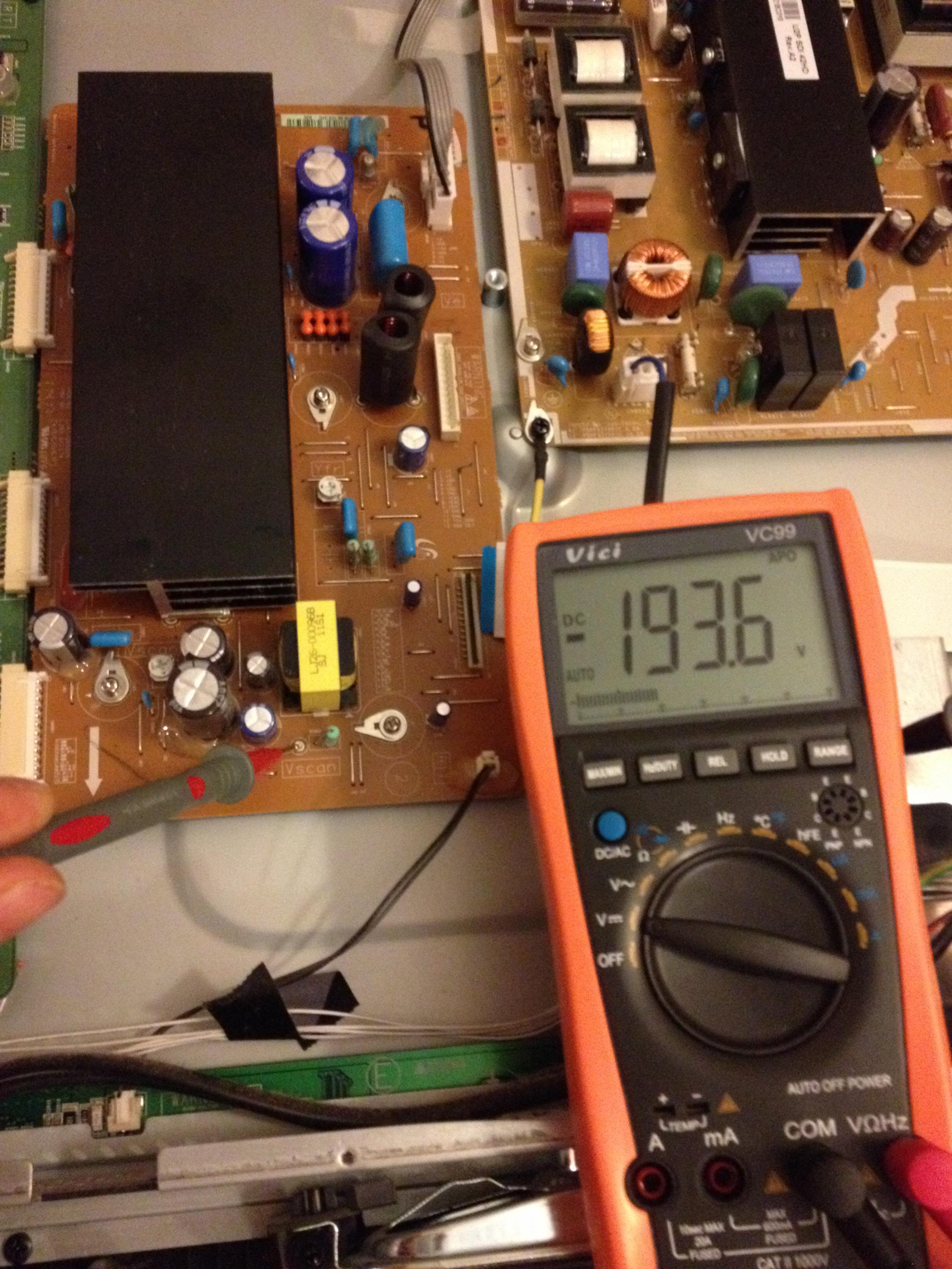

                Re: Bush BPDP42HD3
                Hello,I have all good reading from the psu with y-sus and x-main disconnected
                Vs-207.6v
                Va-55.2v
                If I connect back both the psu starts cliking and the voltages drops .
                If I connect just the Y-sus with the ribbon from the T-con disconnected and the X-main disconnected I have constant reading from Vscan -193.6v and Ve-91.1v
                If I connect the ribbon from T-con to the Y-sus with the X-main disconnected the voltages drops.
                This mean the X-main is faulty or the T-con board ?
                  Re: Bush BPDP42HD3
                  You will need to replace at least X-main & Y-main, maybe even Y-buffer

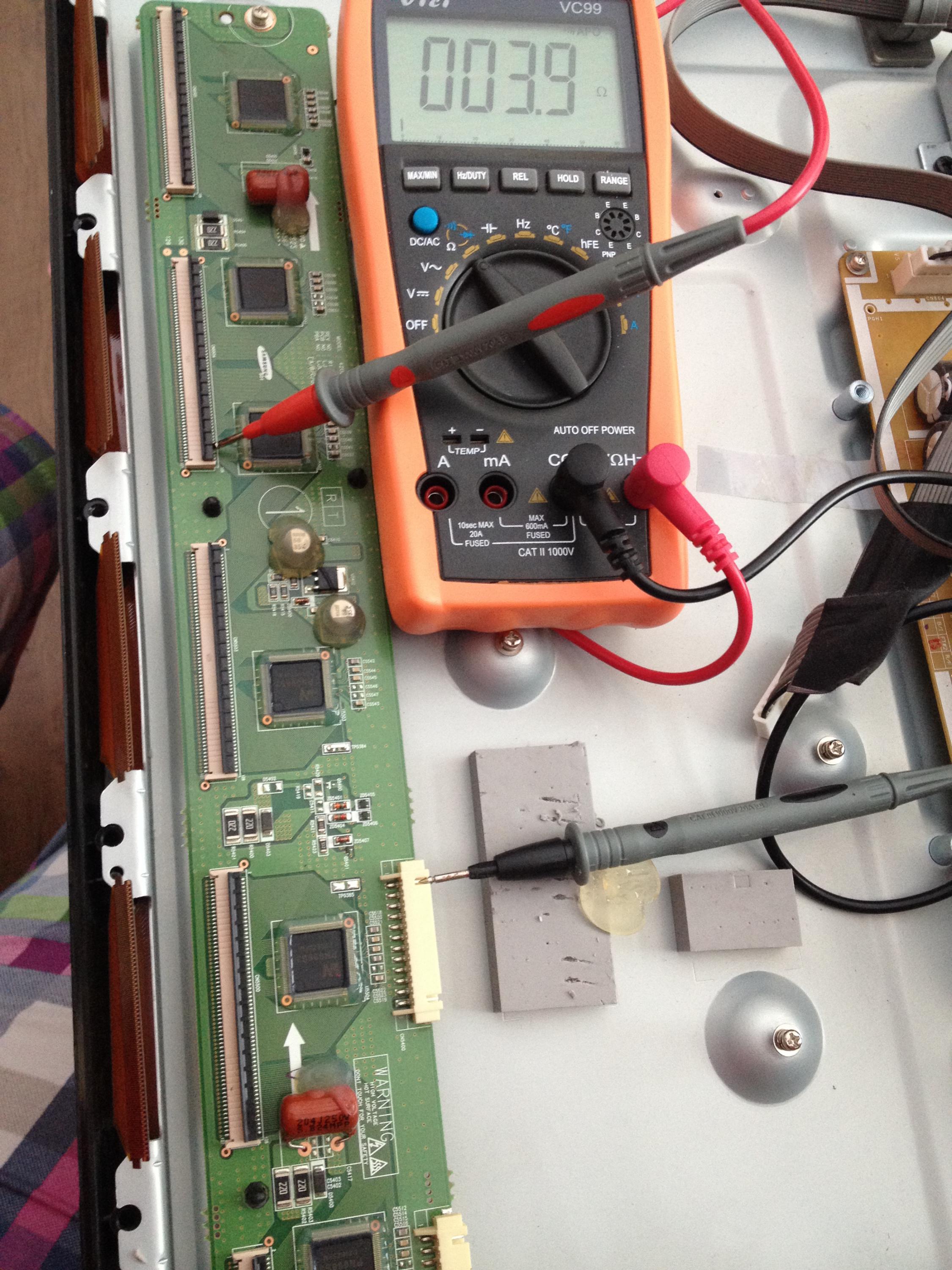

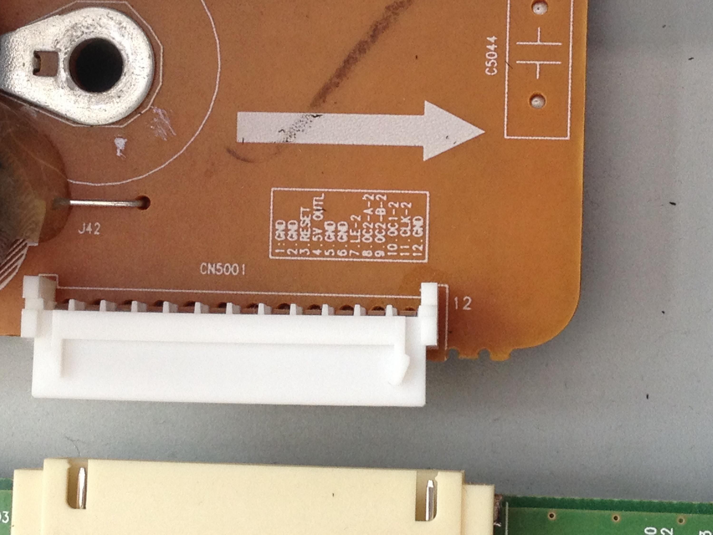

                      Re: Bush BPDP42HD3
                      From the picture wich pin to use to check the buffer board please.
                      1.GND
                      2.GND
                      3.Reset
                      4. 5v OUTL
                      5. GND
                      6. GND
                      7. LE-2
                      8. OC2-A-2
                      9. OC2-B-2
                      10. OC1-2
                      11. CLK-2
                      12. GND
                      I think one is any GND ???

                        Re: Bush BPDP42HD3
                        Check out You Tube Tom has a how to test plasma Y buffers, that will show you what you need to know, have you found anything on the X or Y ?

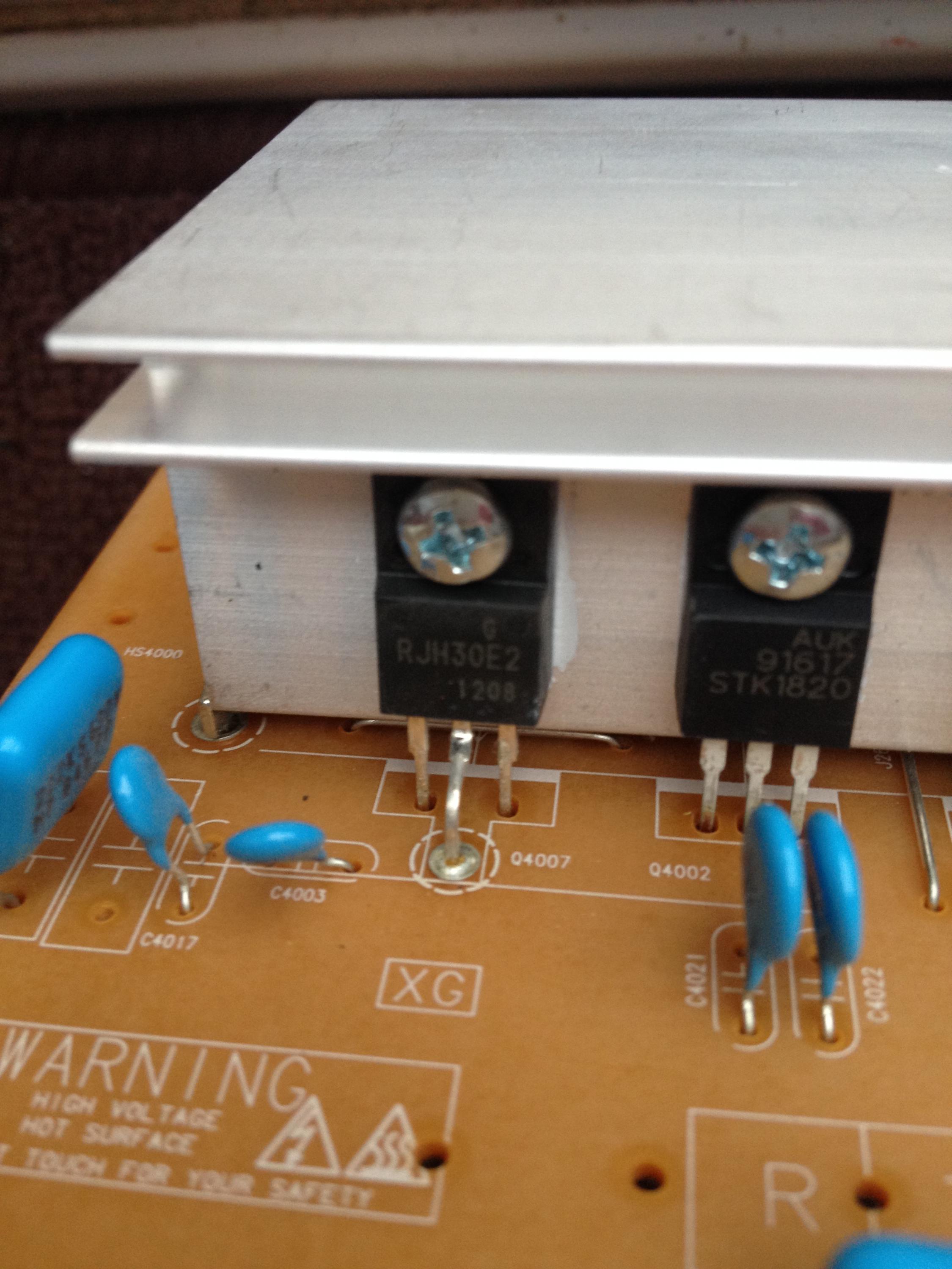

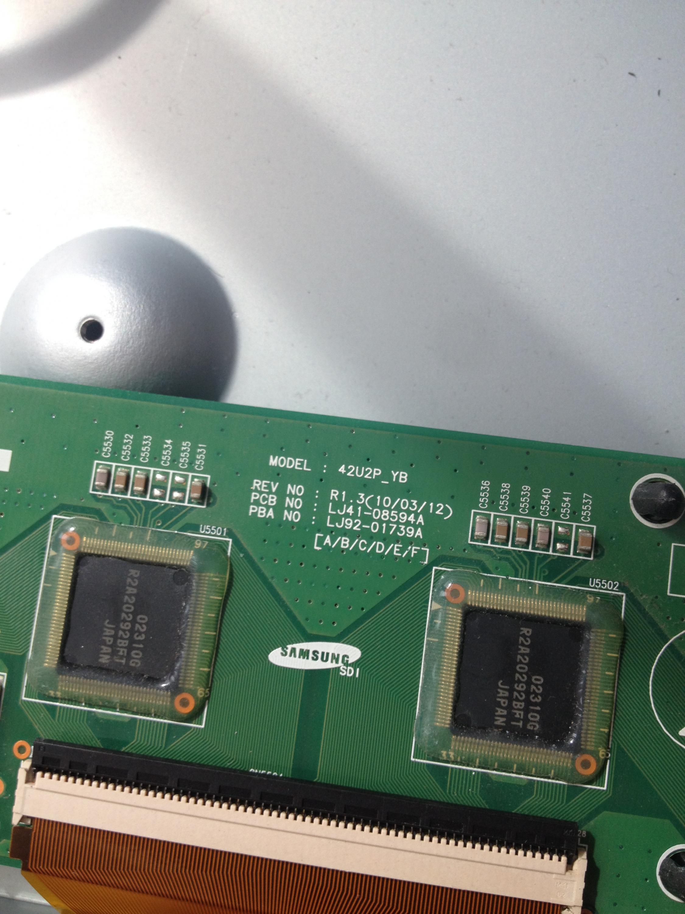

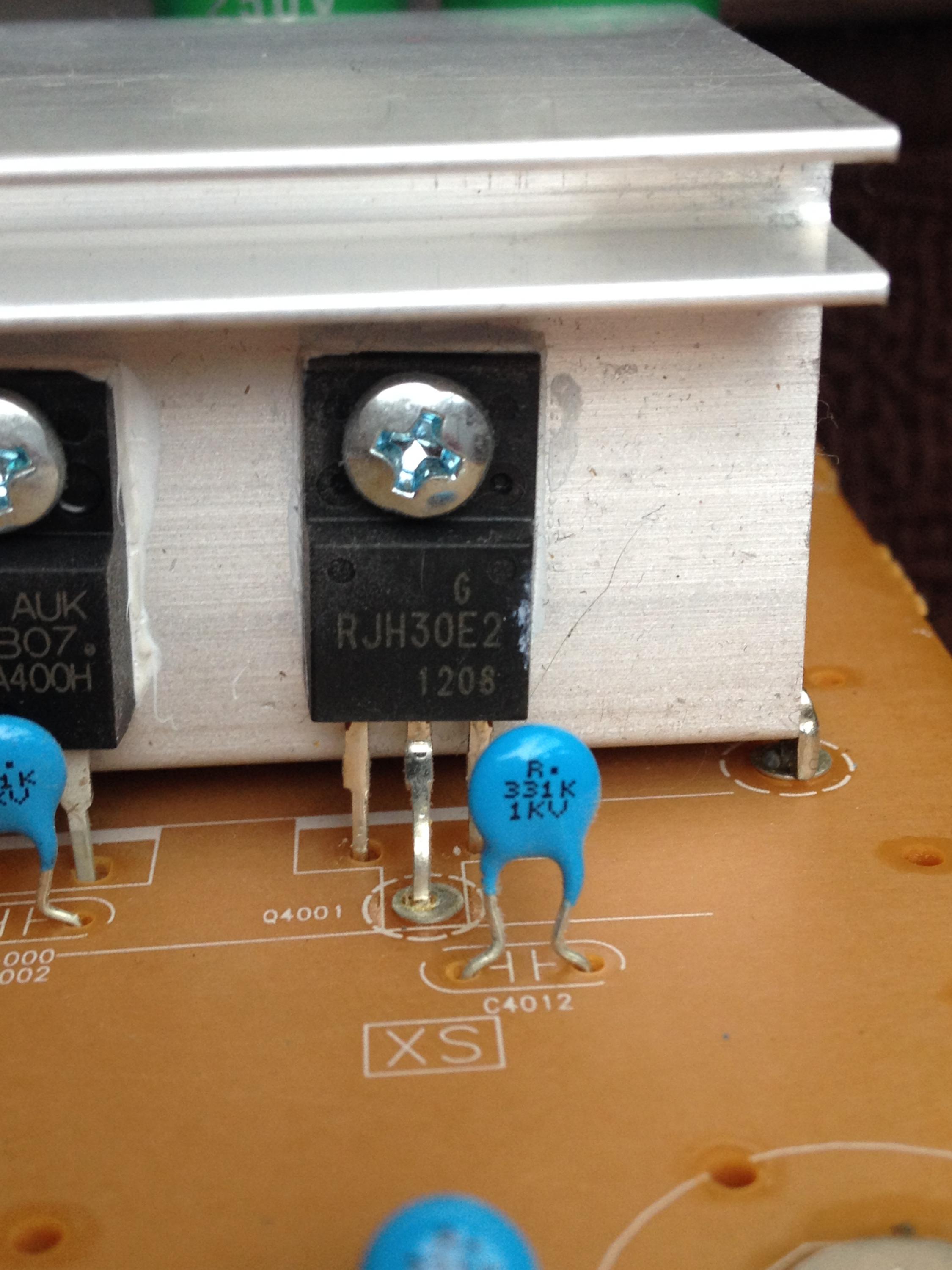

                          Re: Bush BPDP42HD3
                          I found x-main shorted at Q4007 and Q4001 both have RJH30E2 on them ,I ordered 2 pcs from ebay for £2.75
                          I checked the Buffer board and I have found shorted IC .
                          GND used pin 1 and found on the second connector from the top off the Buffer board and I think IC number 3 is shorted to GND because a couple of pins have continuous connectivity.

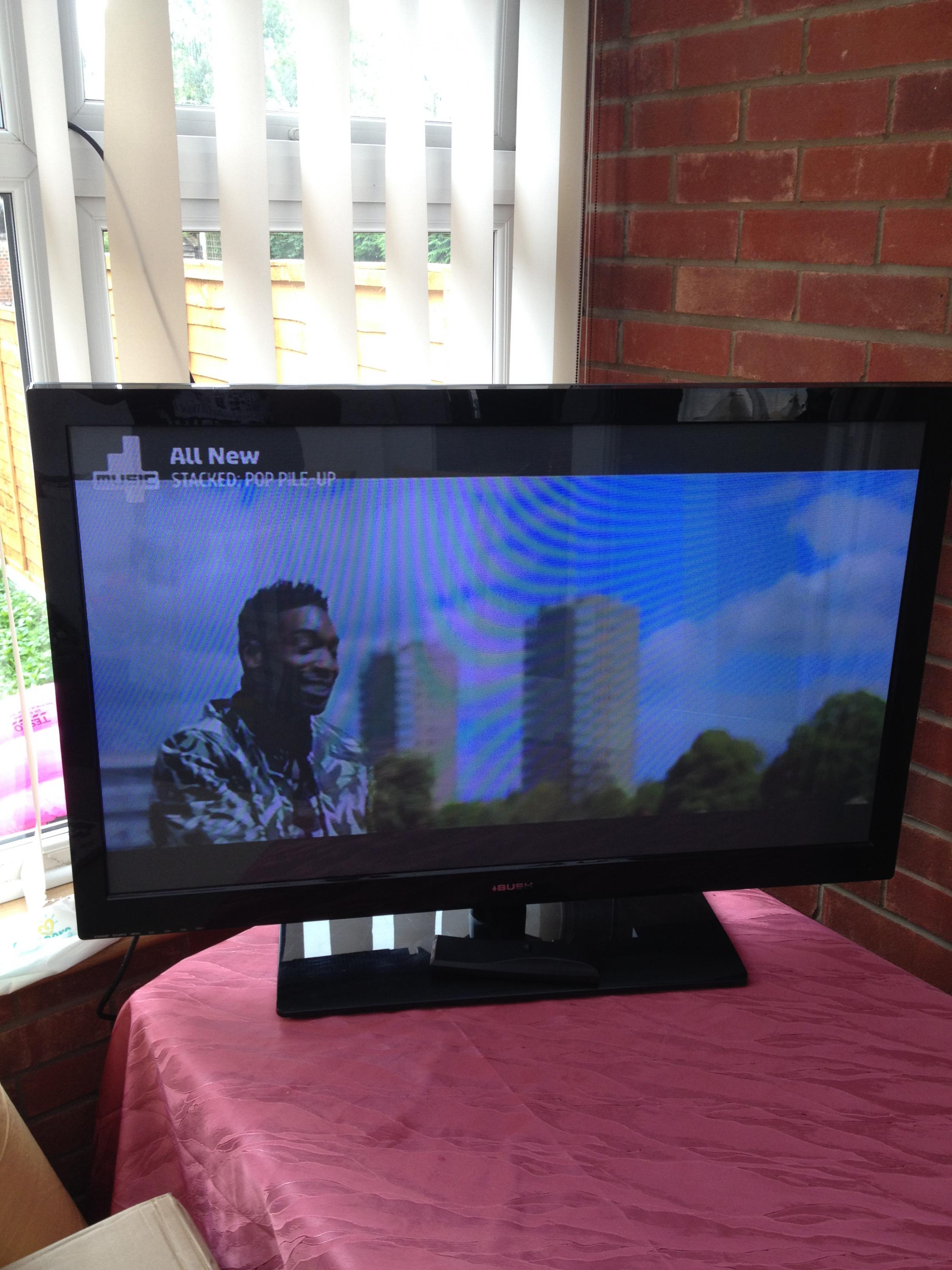

                              Re: Bush BPDP42HD3
                              I changed the 2 shorted RJH30E2 on X-main ,I got another Y-main but mine was fine as-well.
                              I order another buffer board from ebay -£15 with different PCB NO but working with bush and samsung . PCB no :LJ41-08594A
                              Checked and was ok-no shorts on.
                              Before to connect the buffer board I checked all board and had good readings .
                              Connected the buffer and TV WORKING for the last days on.
                              Thank you flocko ,TOM66

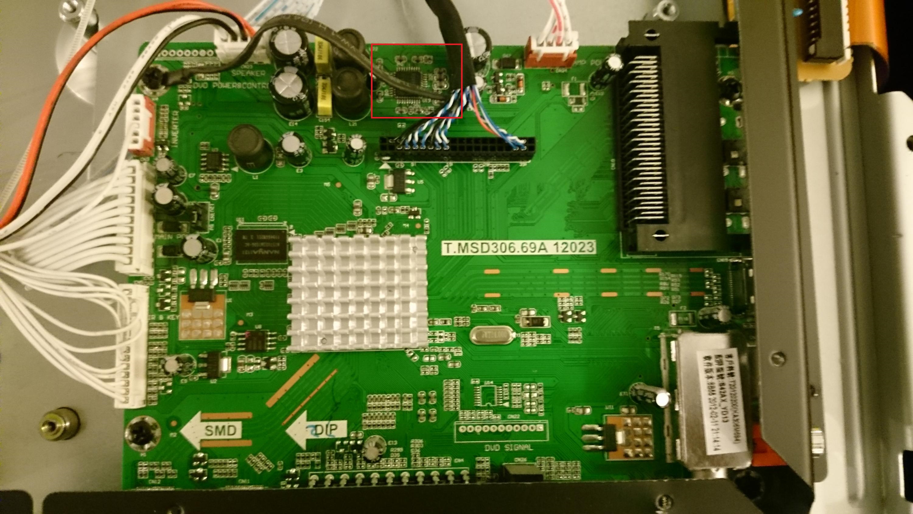

                                  Hello again, I had the tv for some time and now I have another problem with the sound
                                  I have no sound, tv working fine with no sound
                                  Any idea where to start?
                                  Thx
                                  • ReeceyBurger123
                                    Never Give Up !
                                    • May 2014
                                    • 7325
                                    • Britain
                                    #37
                                    Re: Bush BPDP42HD3
                                    Thx
                                    Image of the mainboard ?
                                    • matyka
                                      • Jan 2015
                                      • 179
                                      • Uk
                                      #38
                                      Re: Bush BPDP42HD3
                                      Hello yes I upload one now
                                      • ReeceyBurger123
                                        Never Give Up !
                                        • May 2014
                                        • 7325
                                        • Britain
                                        #39
                                        Re: Bush BPDP42HD3
                                        Ok, do you get sound out of the ear phone jack ?
                                        • dick_barton
                                          • Aug 2015
                                          • 6642
                                          • Wales
                                          #40
                                          Re: Bush BPDP42HD3
                                          What is the IC number?
