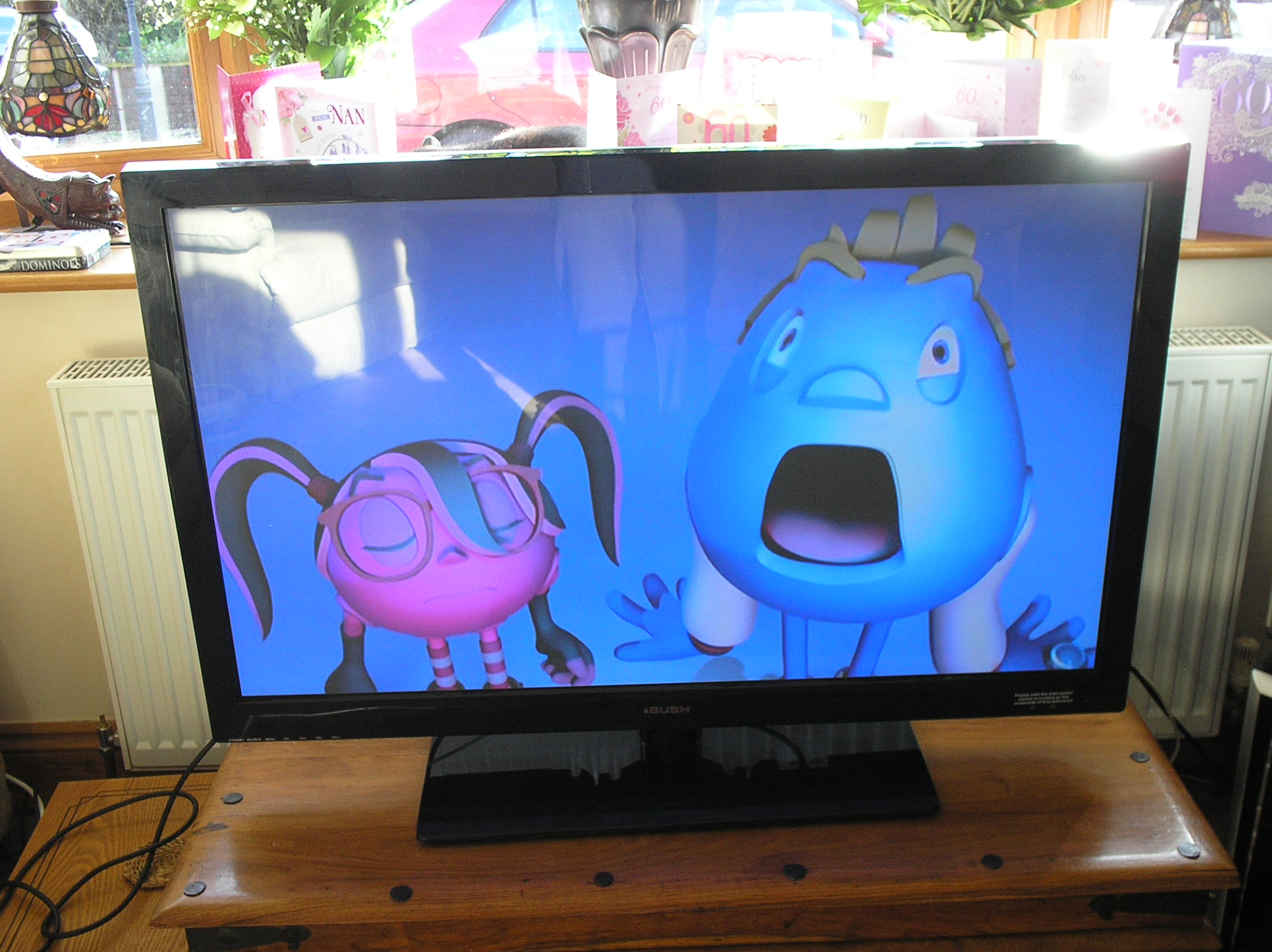

                                    Just an update after sending back two X Sus boards from two different sellers and one Y Sus all showing shorts on arrival,i was able to buy a Samsung PS42C450 with a broken screen and use it as a board donor now have working set and a few spare boards as well

                                      Nice, so it seems that most of the boards on ebay are bad...
