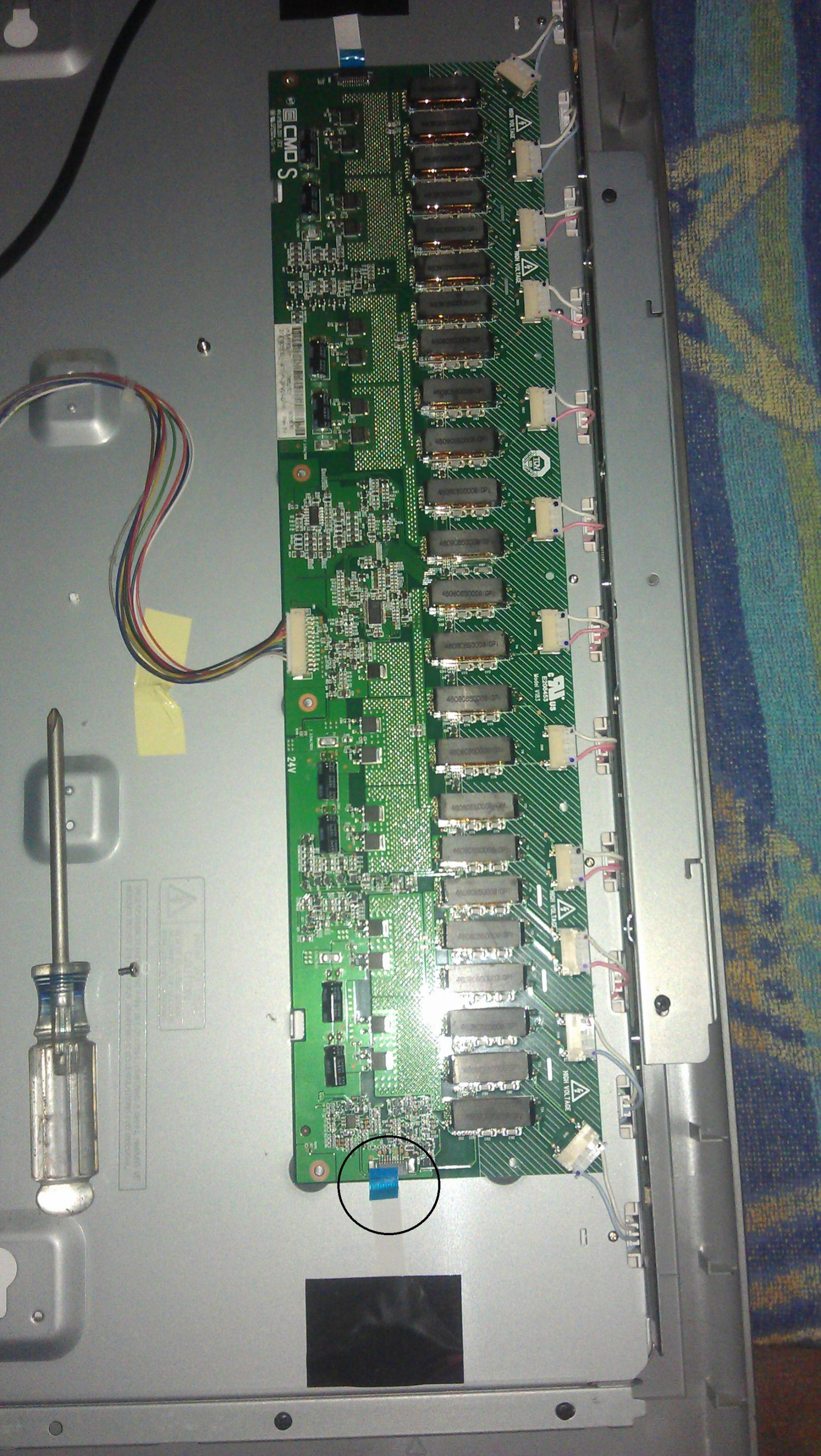

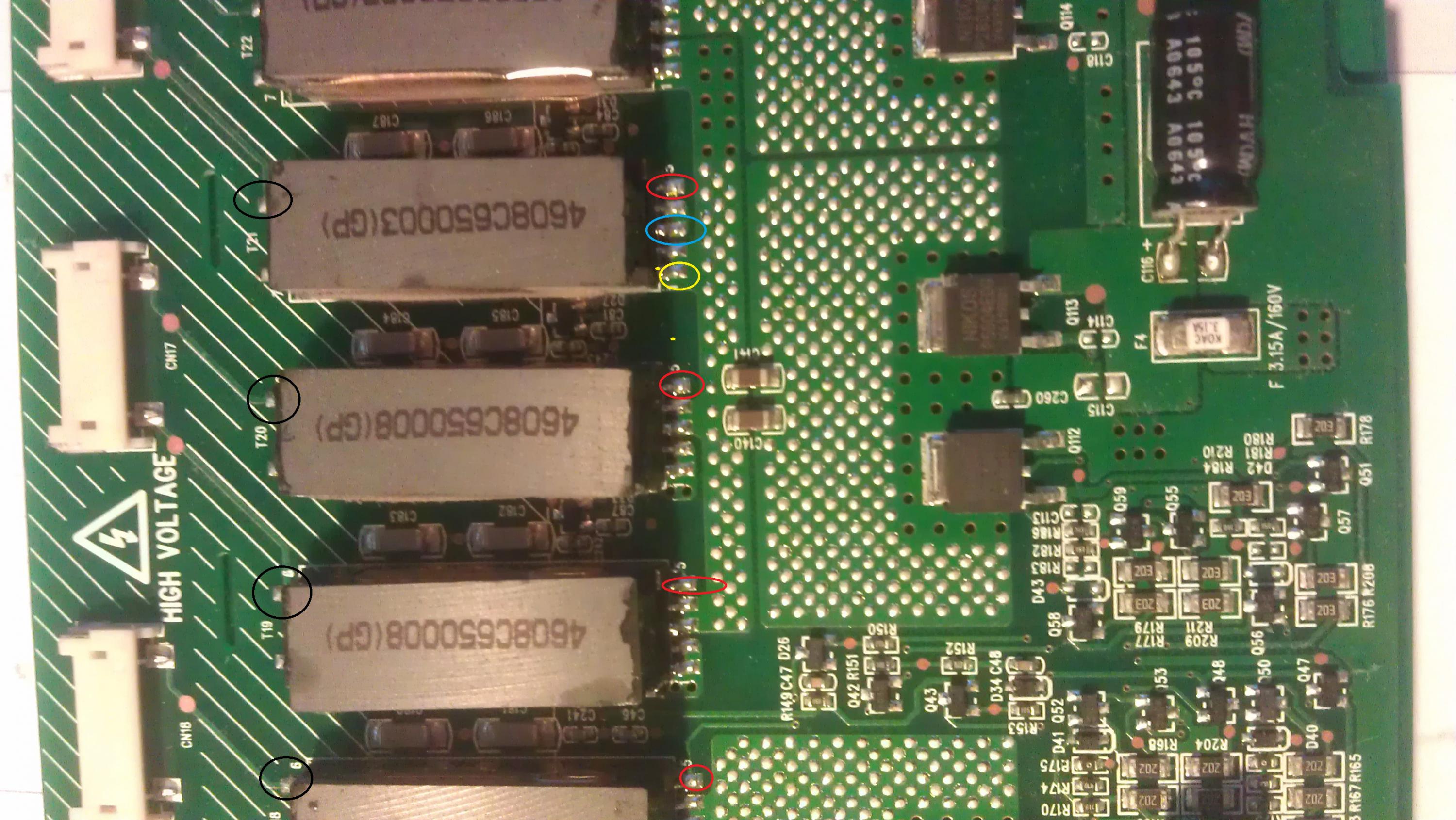

    it stays lit probably about 3-5 seconds, im 90% sure its this cap that is buzzing (almost sounds like a cricket) right after the lights go out, when i disconnect the inverters from the power board and power on it doesnt make that noise, so with my logic either the boards are causing it to make the noise or the noise is causing the boards to turn off
    on that capacitor you have highlighted on the solder side,either the light is weird,or those are ring cracks around those pins,can you check and reflow those if they are,it could be the arcing sound your hearing
    fixed so far...376 lg lcd tv's,24 onn tv;s,24 panasonic lcd,16 jvc lcd,12 marshall jcm800 amps,refurb of various disco equipment lighting,old style disco decks ,and a flymo!
    please let us know if everything works ok if your tv gets fixed, as it will be and aid for anyone else having the same problem and wishing to fix it.it would save people clogging up this site with topics that are duplicated,and can be found easily using the search function.,and taking up valuable space.enjoy your fixed tv!,hopefully!

      Re: westinghouse LVM-47w1
      Originally posted by multimeter
      there could be a a boarder line resistance short happening ,can you do a resistance test to ground on the +rails on the inverters?,you should see lots of of kohms,if there is a few ohms,that could indicate a short somewhere,and will have to check the transformer drivers for shorts,passives etc
      a short would filter back through the feedback circuits ,and cause some reverse voltage,and that may be the sound your hearing from that capacitor under more load,and the mainboard shuts the psu down and so on
      you lost me on this one, where are the +rails? if it is the black circles then with the meter set on 20M they all are about .32 except a few were 3.89 on 200M they all are about 1.1-1.3
      i think it is the picture but will reflow anyway
        no not those,i mean the on the inverter,you have all the connectors from the psu/mainboard bringing in the voltages to the inverter yes?,
        well those would be your +rails to check for low ohms to ground,in other words there maybe a low ohm short there that is shutting of the psu etc.
        if the inverter isnt happy it will send back a signal through the feedback circuits,and that will tell the psu to shutdown.

                  have you re-solderd the inverter transformers,and what looked like cold joints on that capacitor in earlier post?

                    i didnt resolder the transformers, but i did do the cap
                    • multimeter
                      • Jan 2011
                      • 739
                      • united kingdom
                      #30
                      do the transformers,they can suffer with cold joints too
                            when i was talking the board off i thought i would try powering it on with the bulbs disconnected interesting result
                            on the slave side when any of the bottom 4 bulbs are connected the cap makes that noise with everything else is connected and those 4 are unplugged no noise, the backlight still shuts off in any situation
