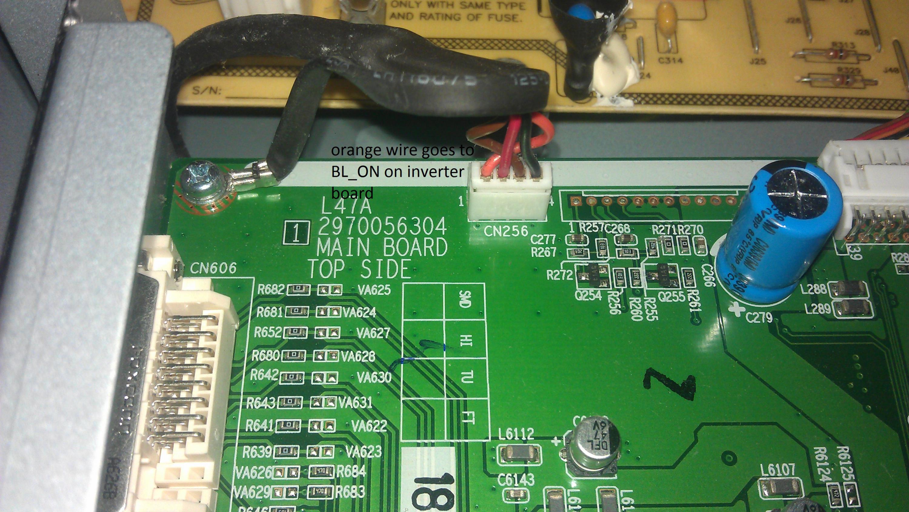

    the only thing i have found so far (on justanswer) is a wire, from the main board to the inverter board, labeled BL_ON should show 24V at power up and hold, it only shows 3.3V
    say i jump a pin to supply 24v to the BL_ON from the pin next to it, to test the above statement, would that be safe ?
    so now i can decide what is causing what, are the inverter board shorting out ? is the main board bad for not showing 24V? or is the 11.8 V coming out of the PS board not enough ? is that buzzing noise a bad component onthe PS board ?

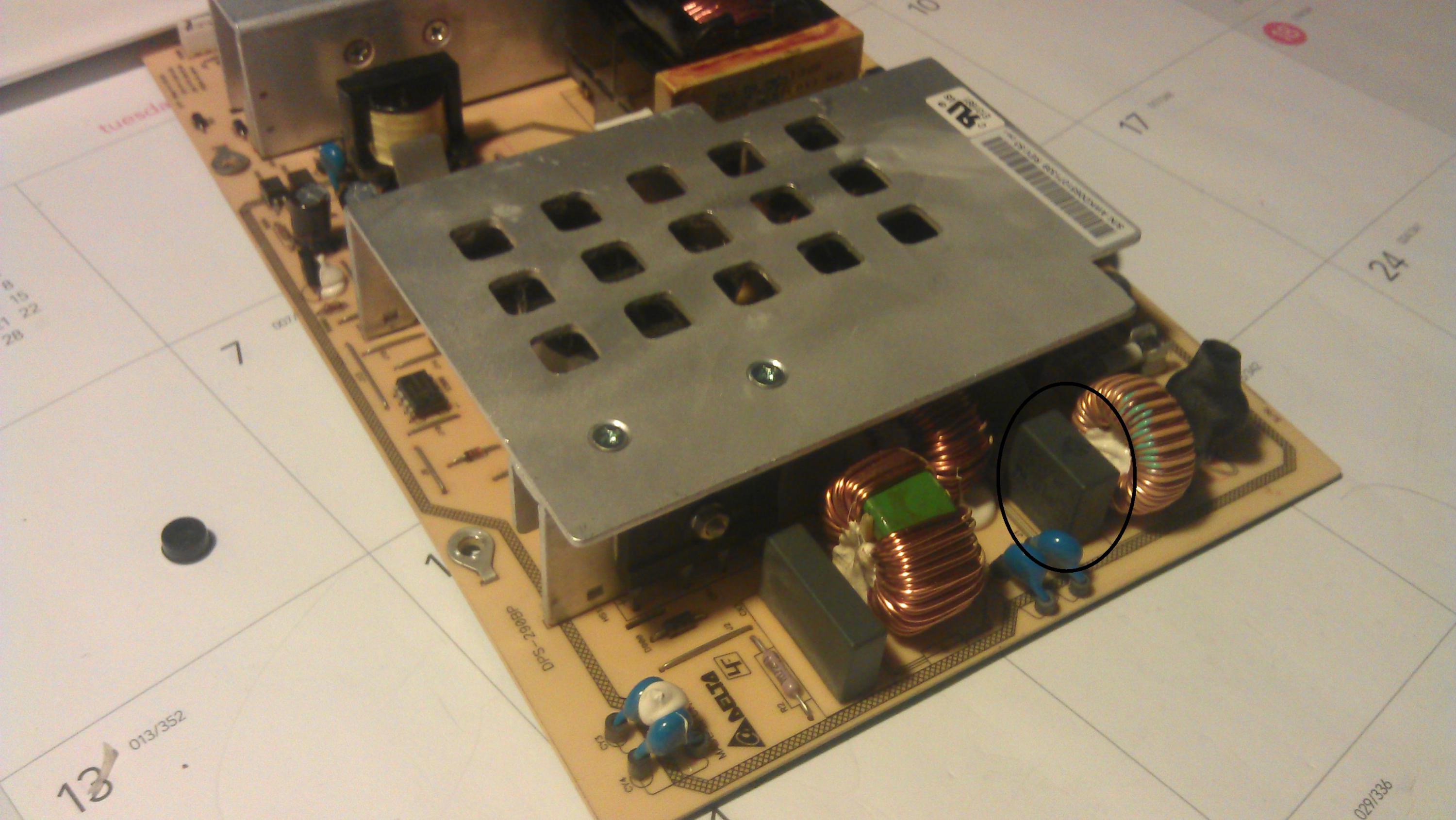

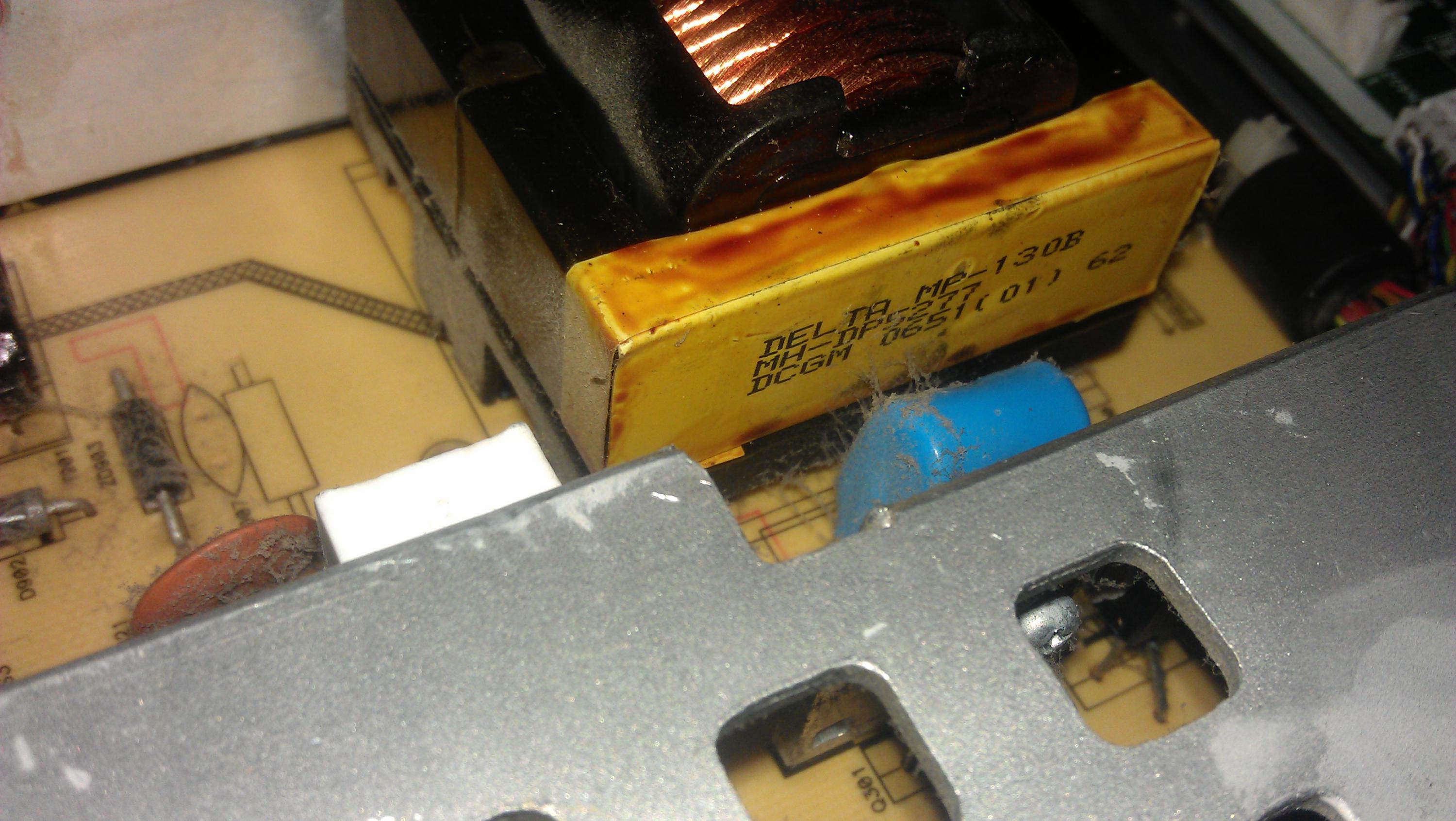

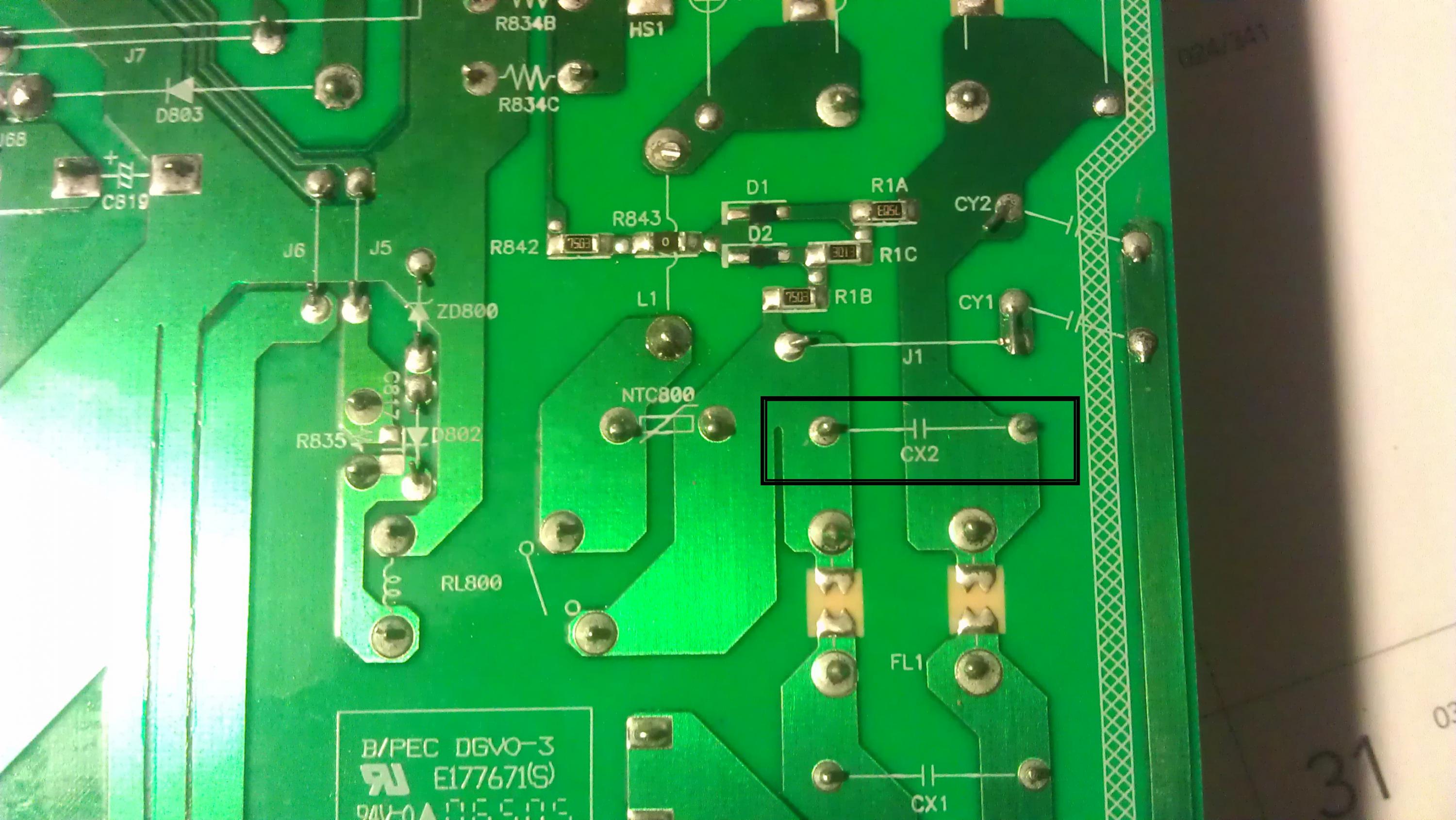

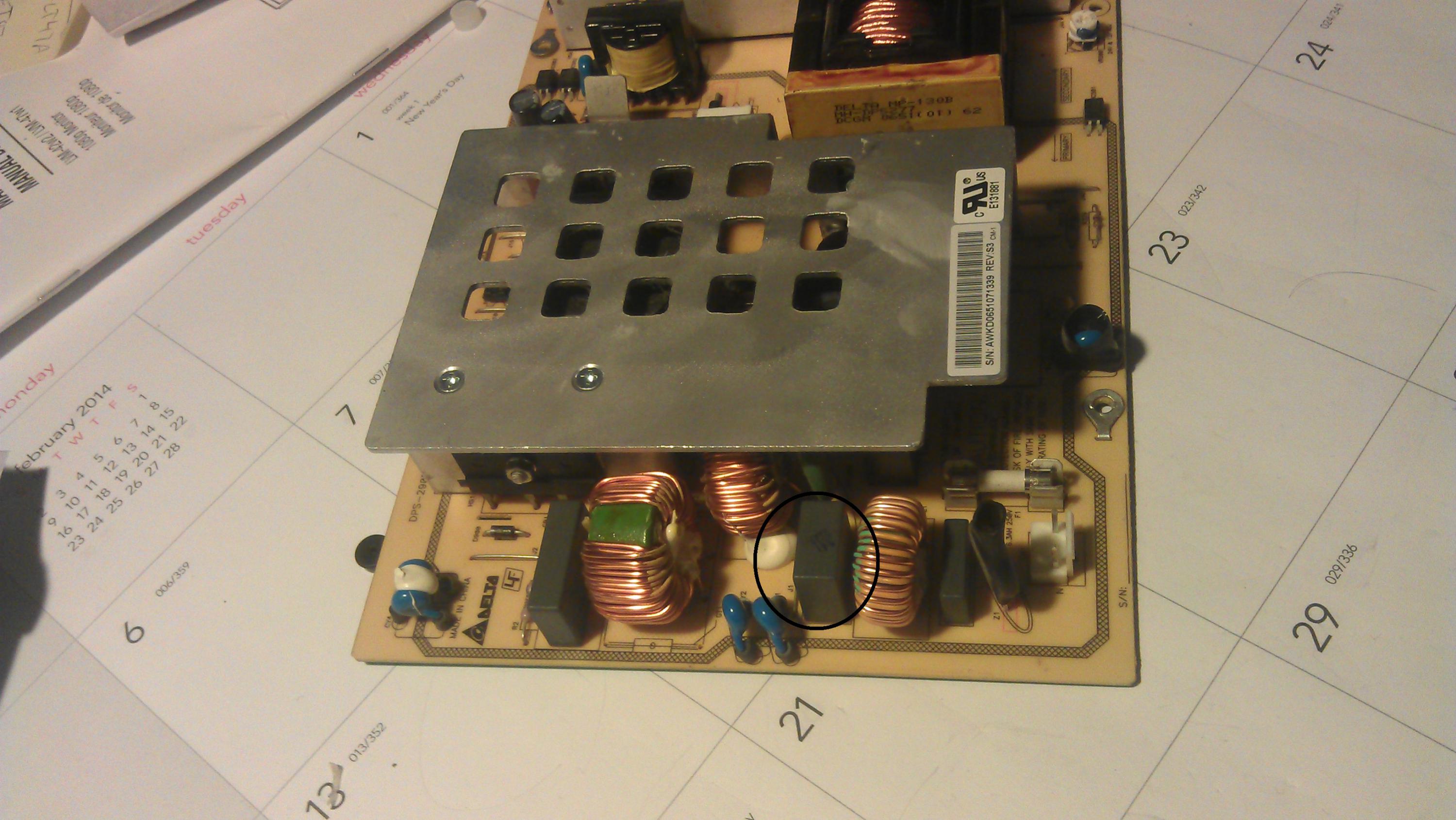

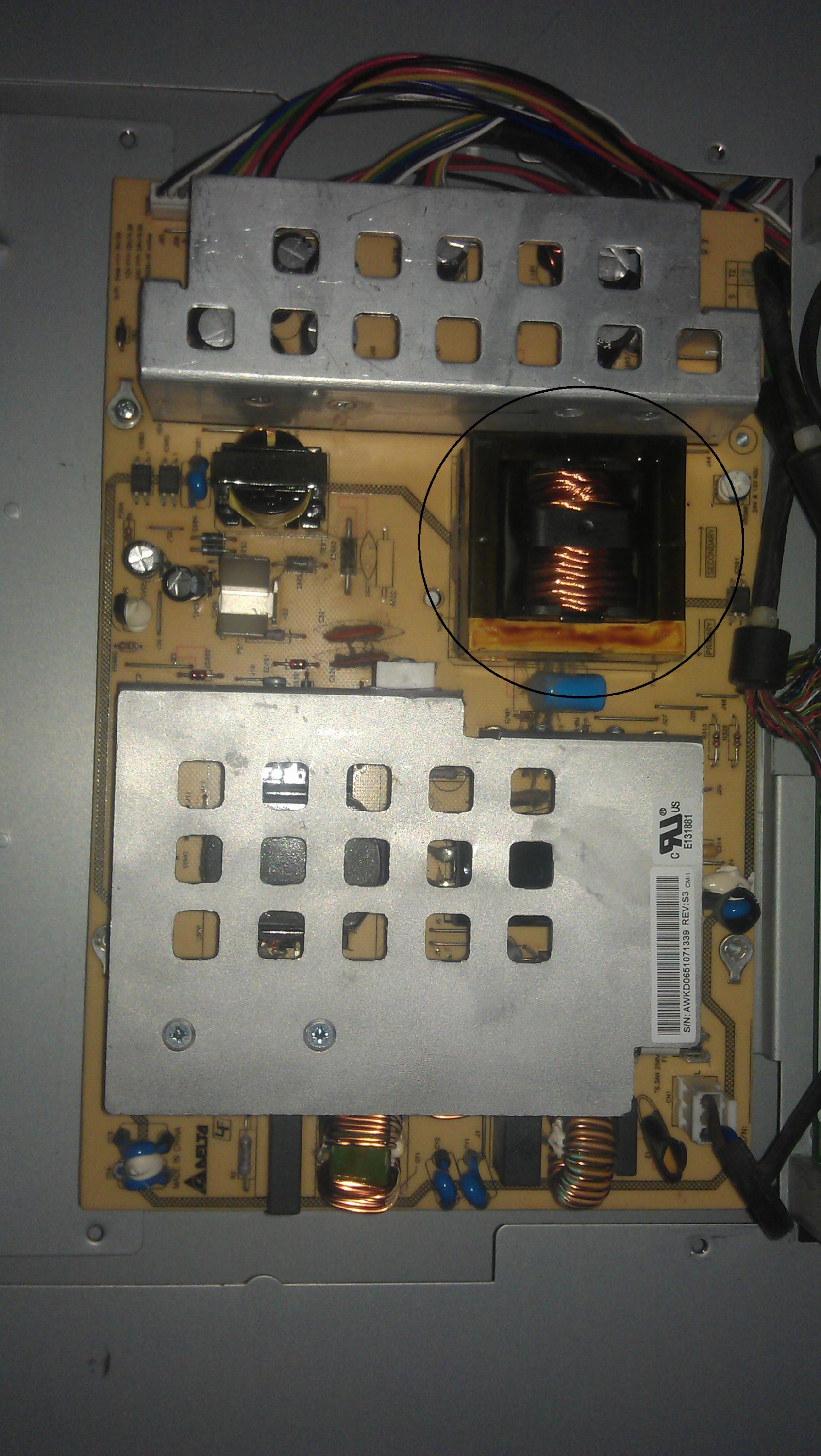

    okay i added pics of the PSB

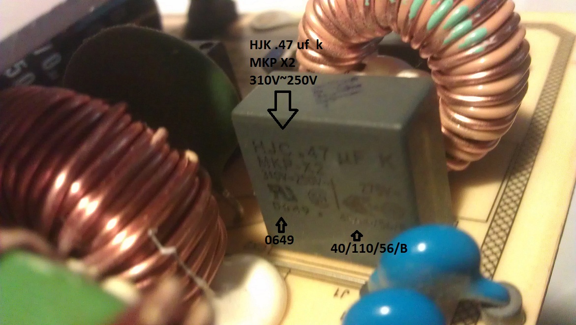

    when the TV is off the large thing in the middle makes a whiny noise when the tv is powered on it stops
    when the backlight powers off the small grey box (circled) makes a scratching noise or its in that area
    any idea on what these parts are? and if that is the cause of my problems or the reaction from the problem

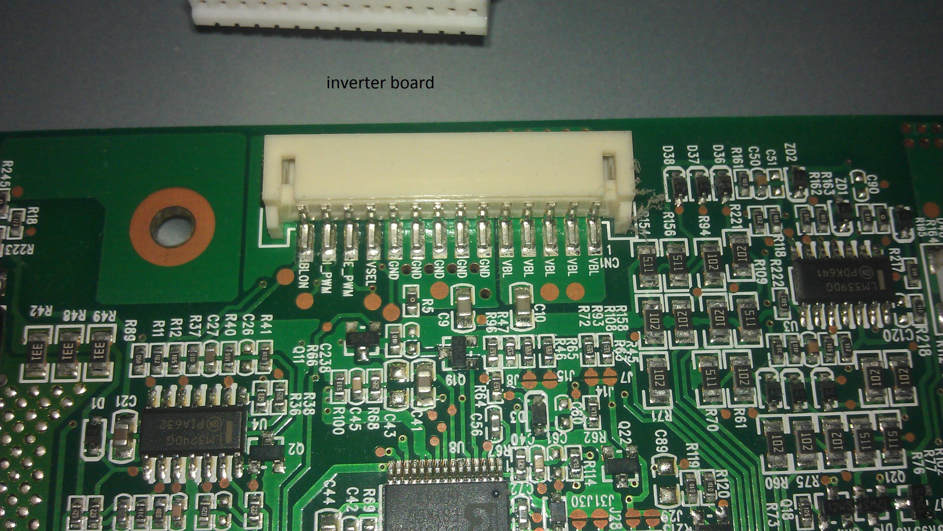

      Re: westinghouse LVM-47w1
      that 3.3v sounds like standby power,to turn the inverter on...

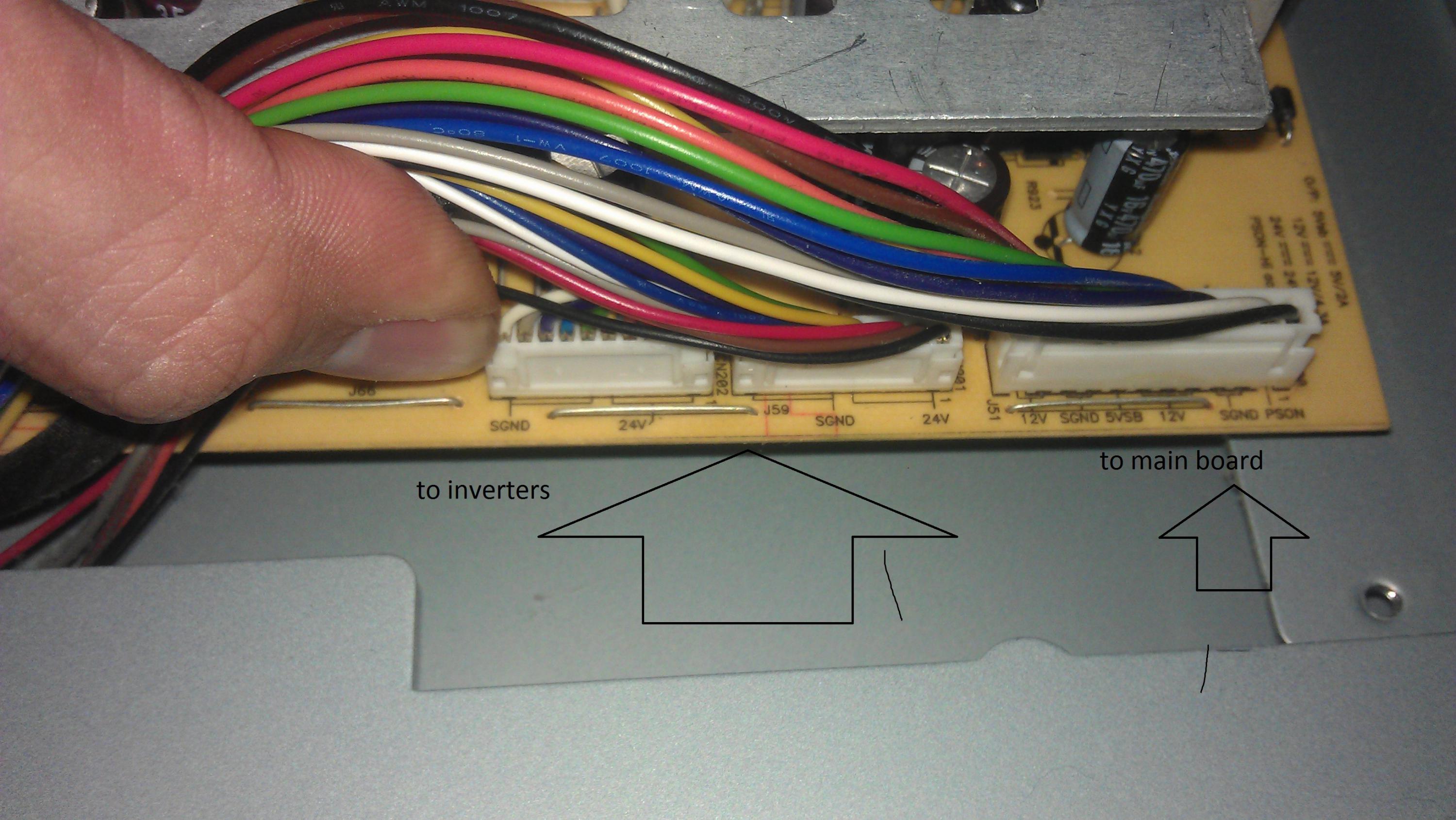

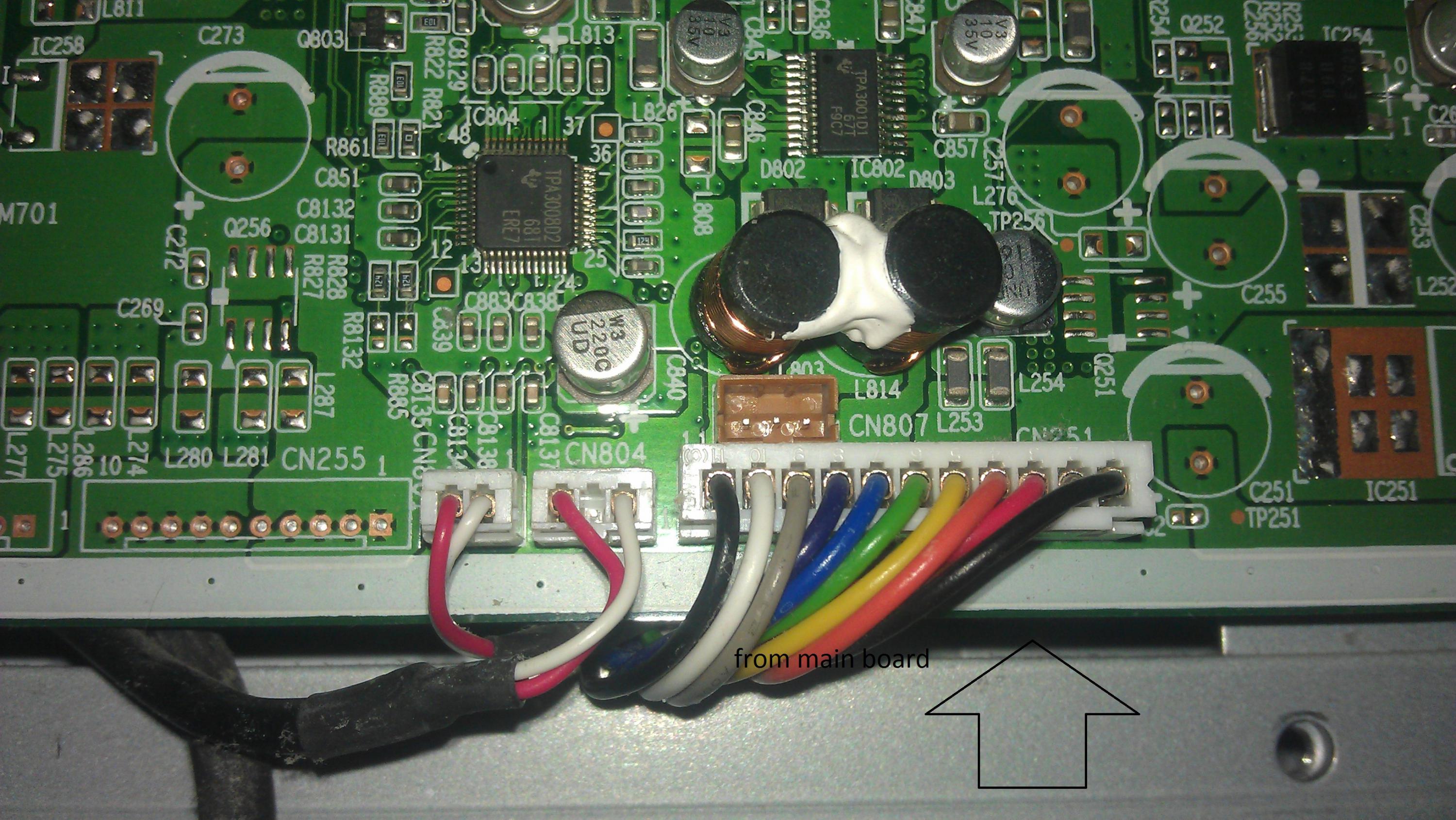

      post up a pic of the power supply connectors and mainboard ones,showing the legends next to there connector
      will need to be good quality pic and close,

        to clarify a bit BL_ON show 0 volts when off, then shows 3.3v when the power button is pressed and stays 3.3volts even after the backlight turns off
        the 24volts i think its suppose to show at power on (information from justanswer) could be for a different mainboard inverter board combo
        i have had no luck sourcing a service manual, i talked to westinghouse and they say there is no service manual for the boards but they think the inverter boards are bad
          main board is working then,bl_on will show 0v when in standby,power on,the bl_on will go high at 3.3v,so thats all good.your 12v will be for mainboard,the 24v for the inverter.

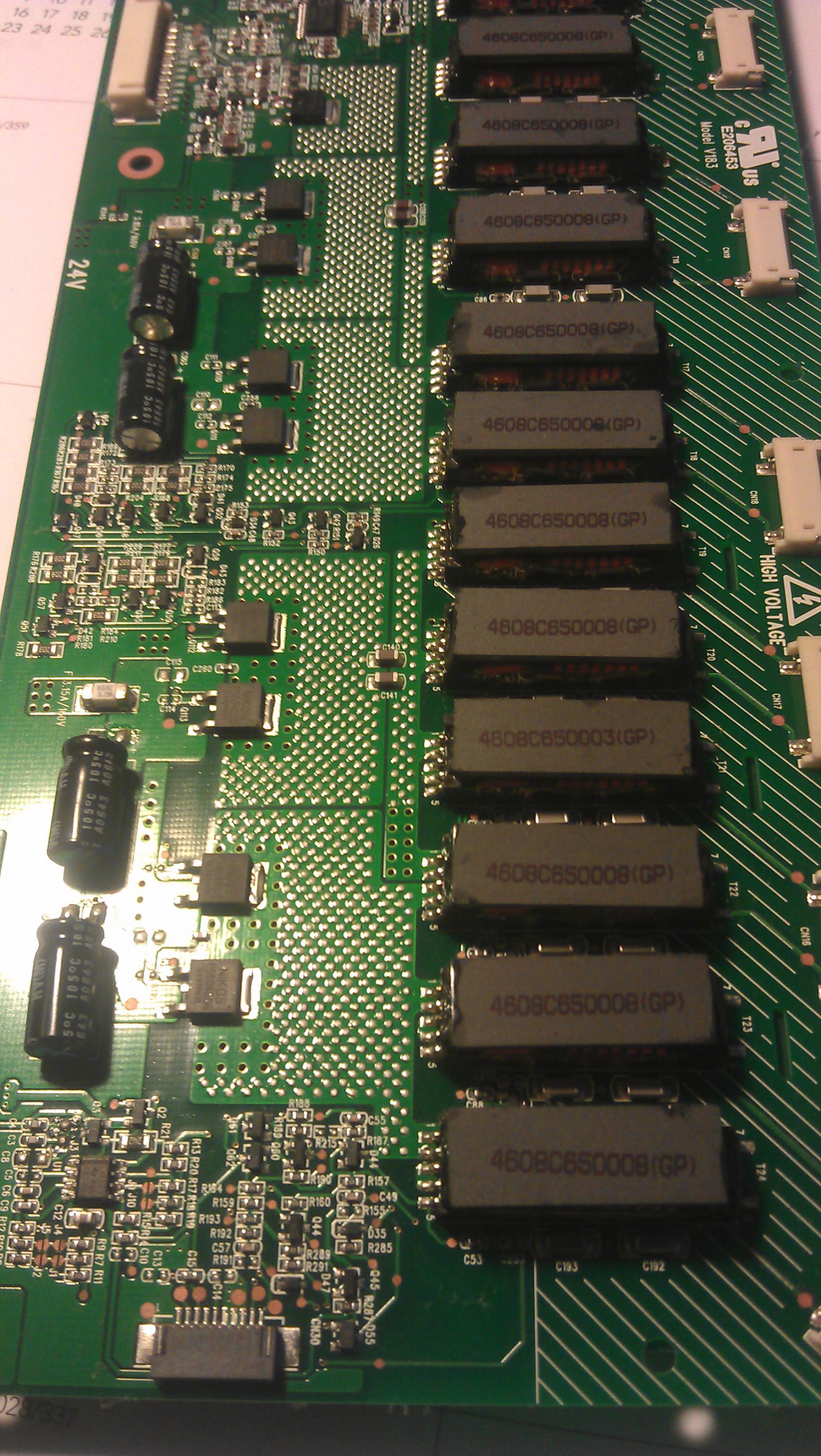

          can you put some good pics up of the inverter?,those last pics were excellent.and can go from there then.
          when the inverter shuts down ,do you see a faint image when you shine a strong flashlight at the screen,bringing up the menu will make it easier to see.

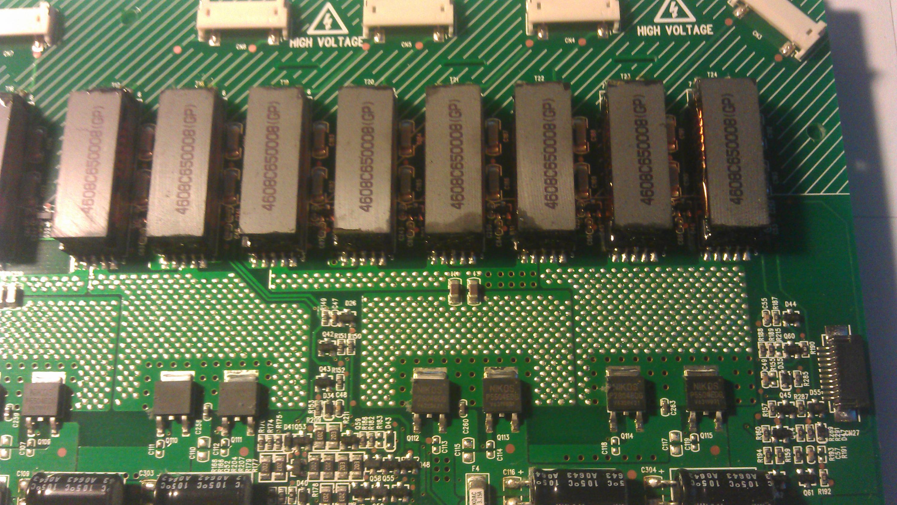

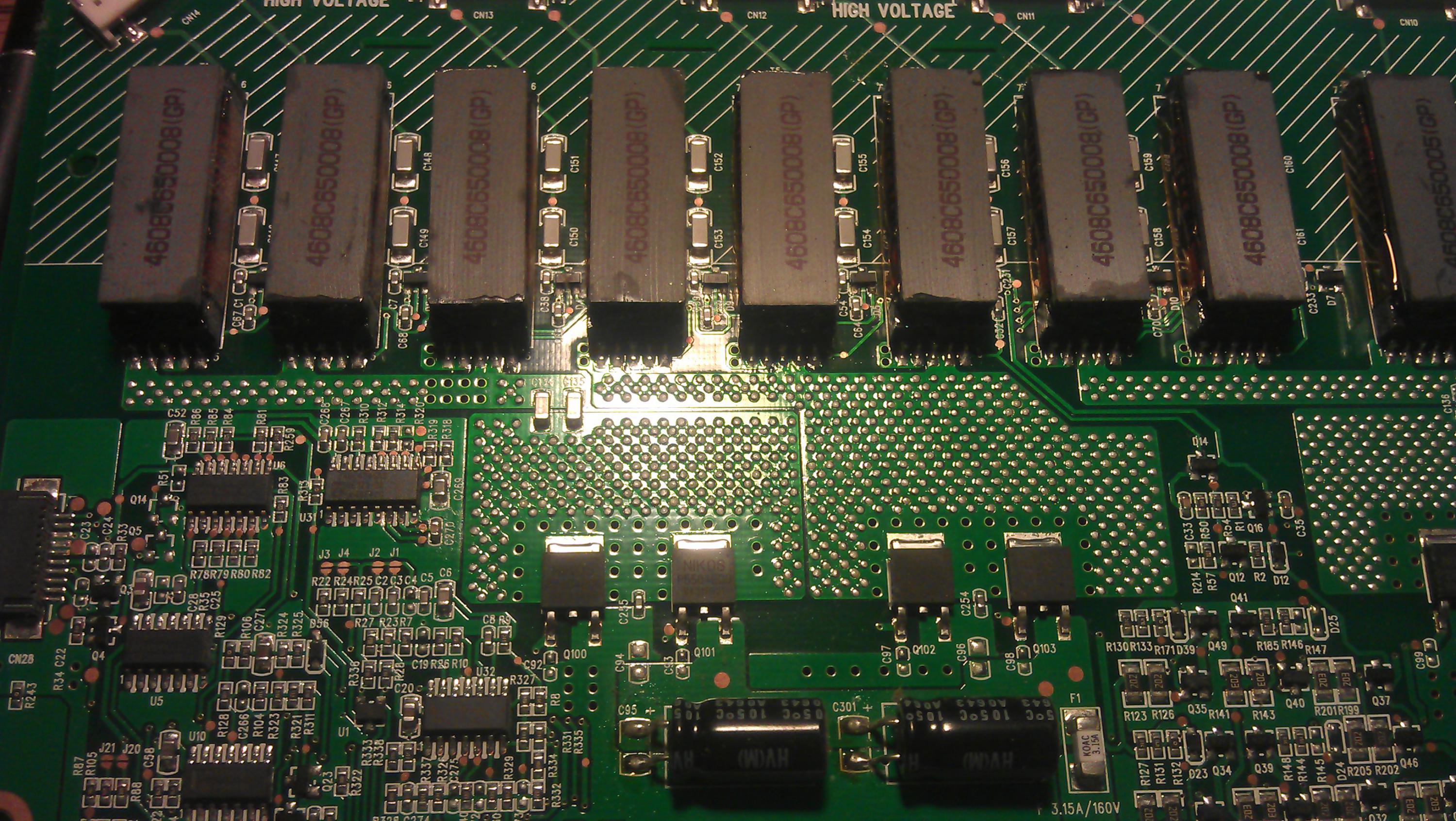

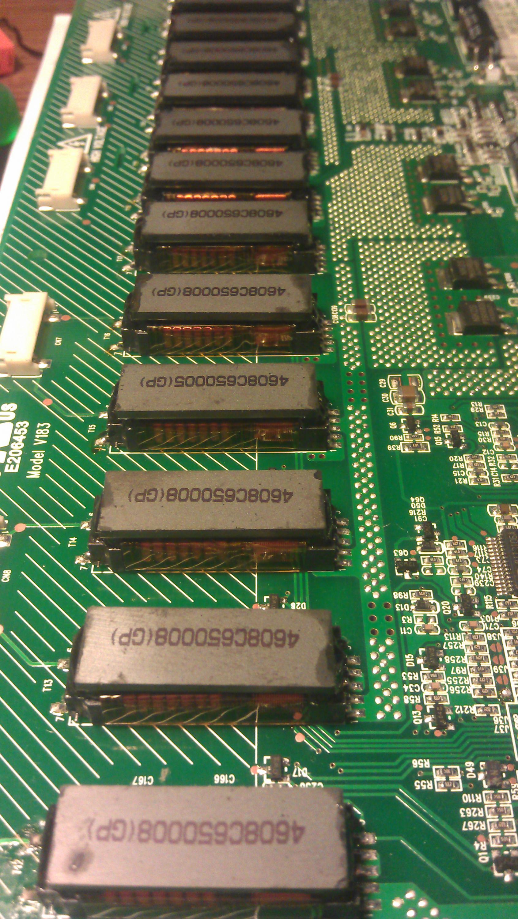

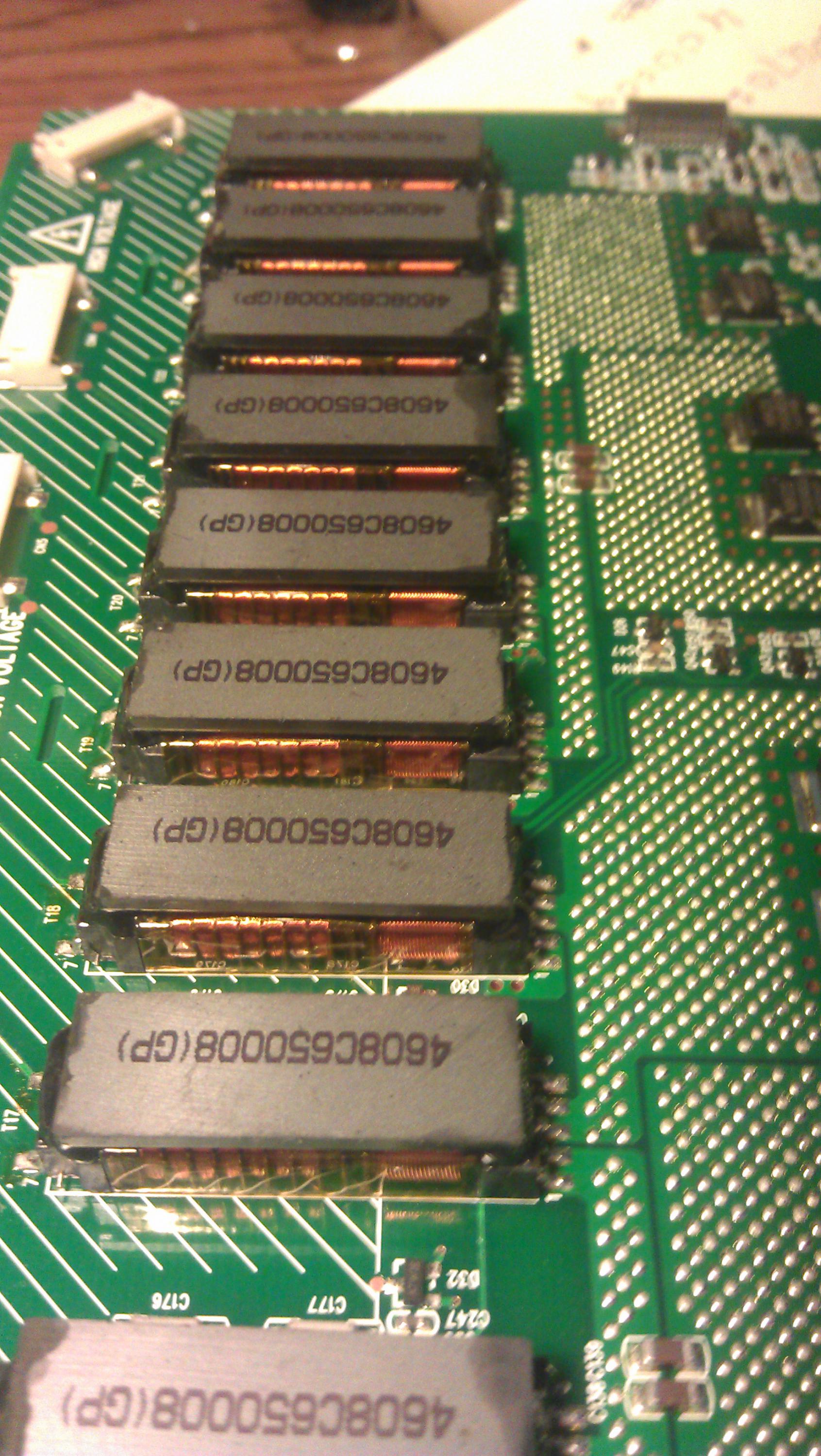

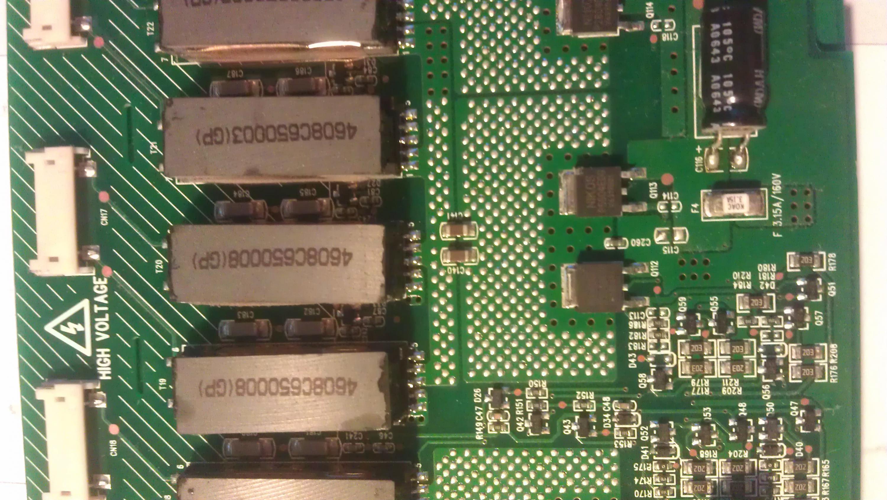

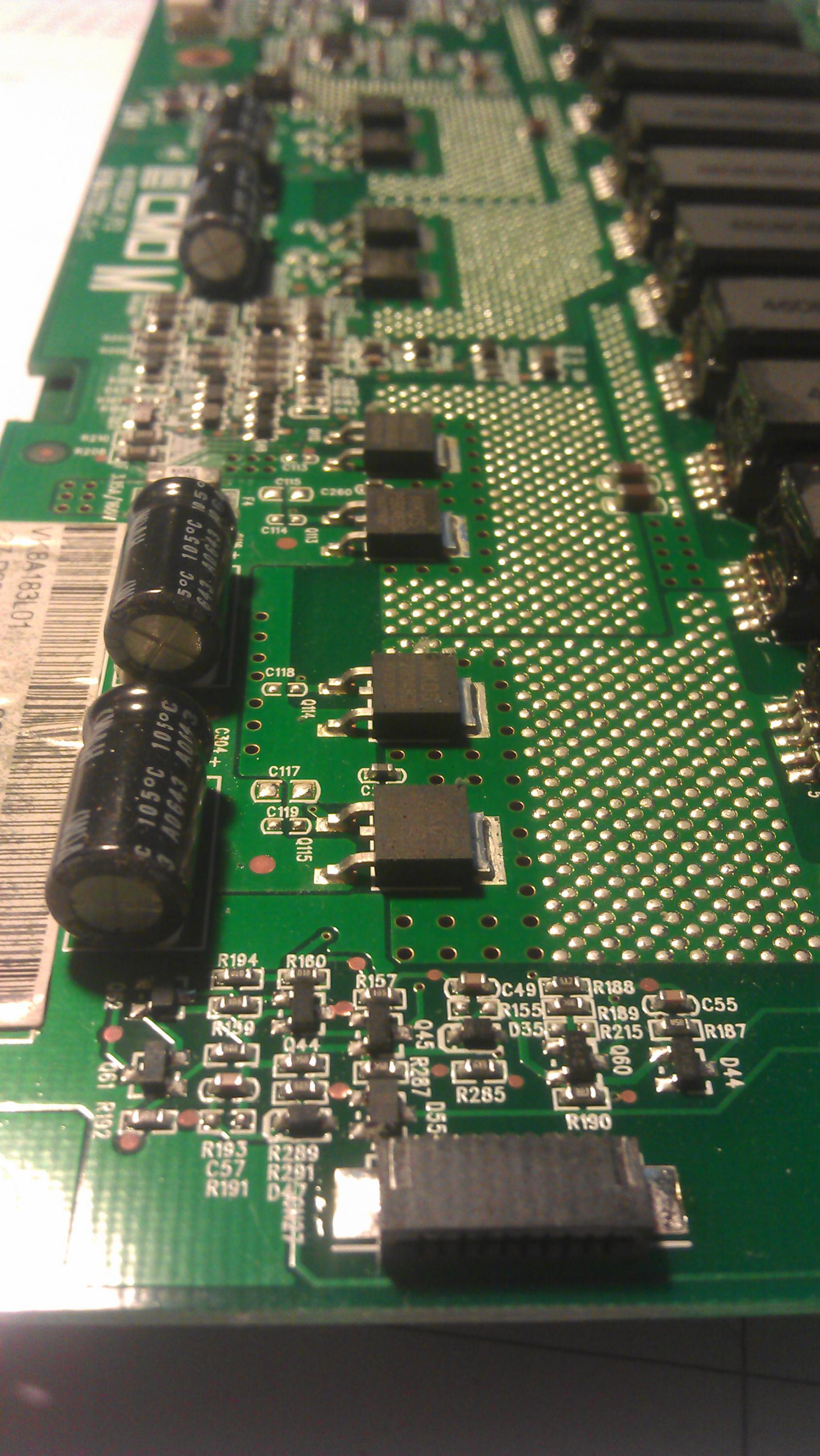

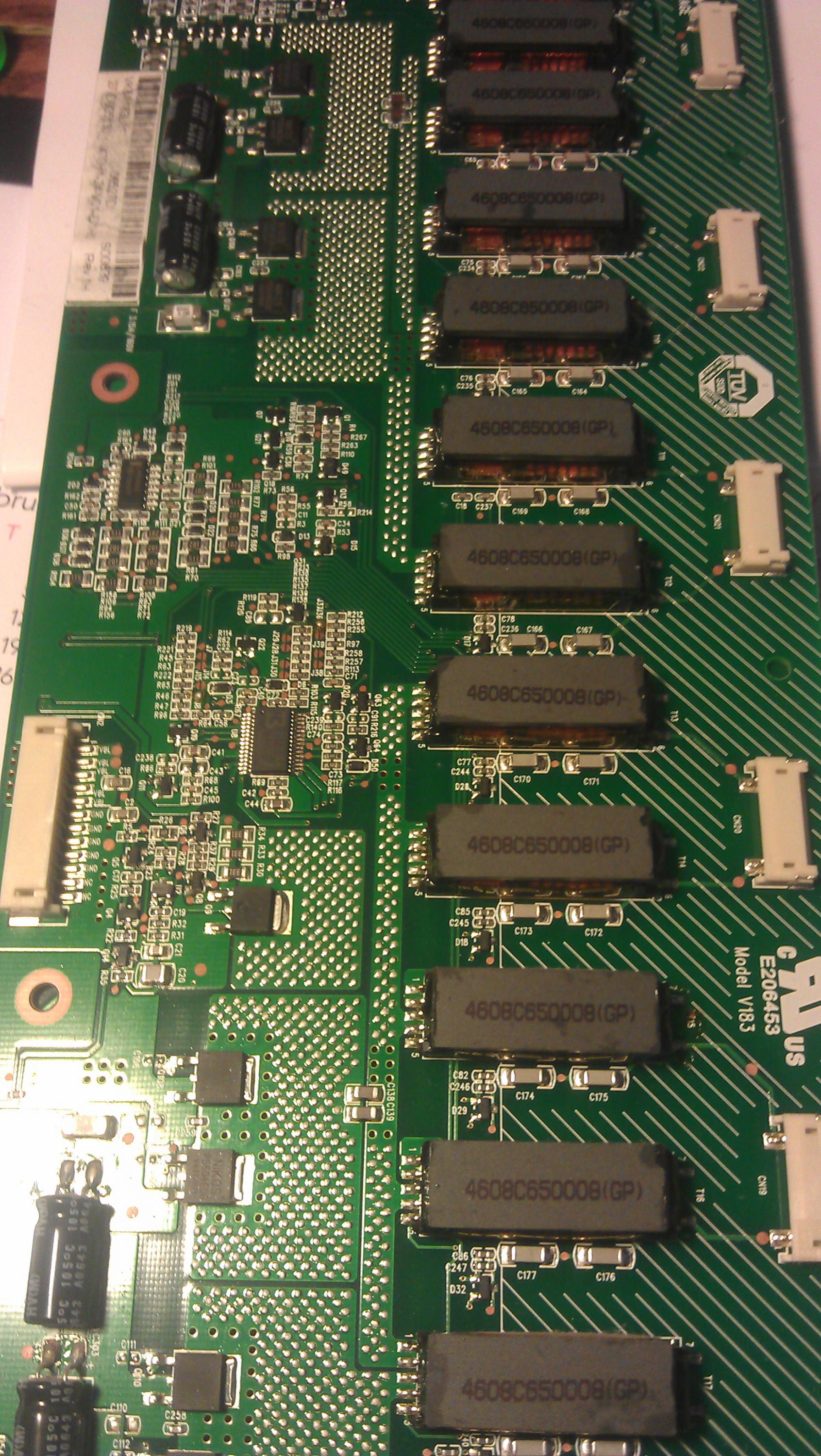

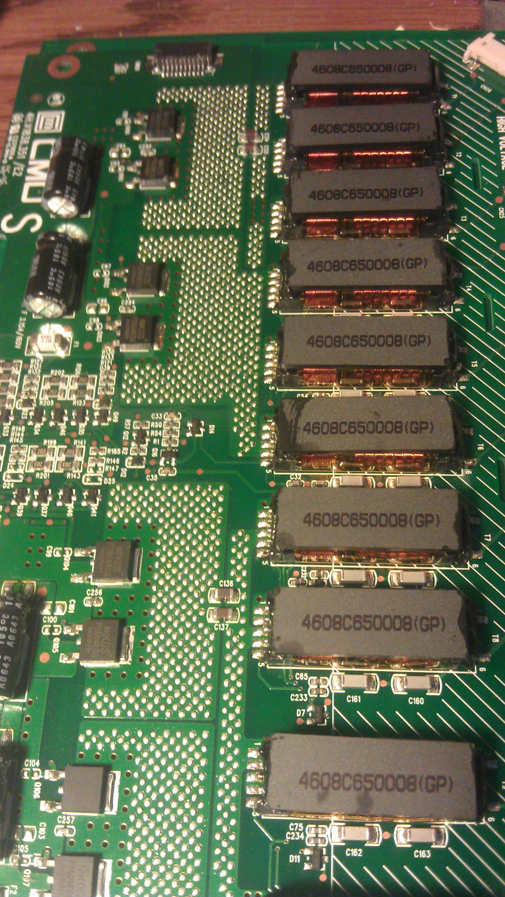

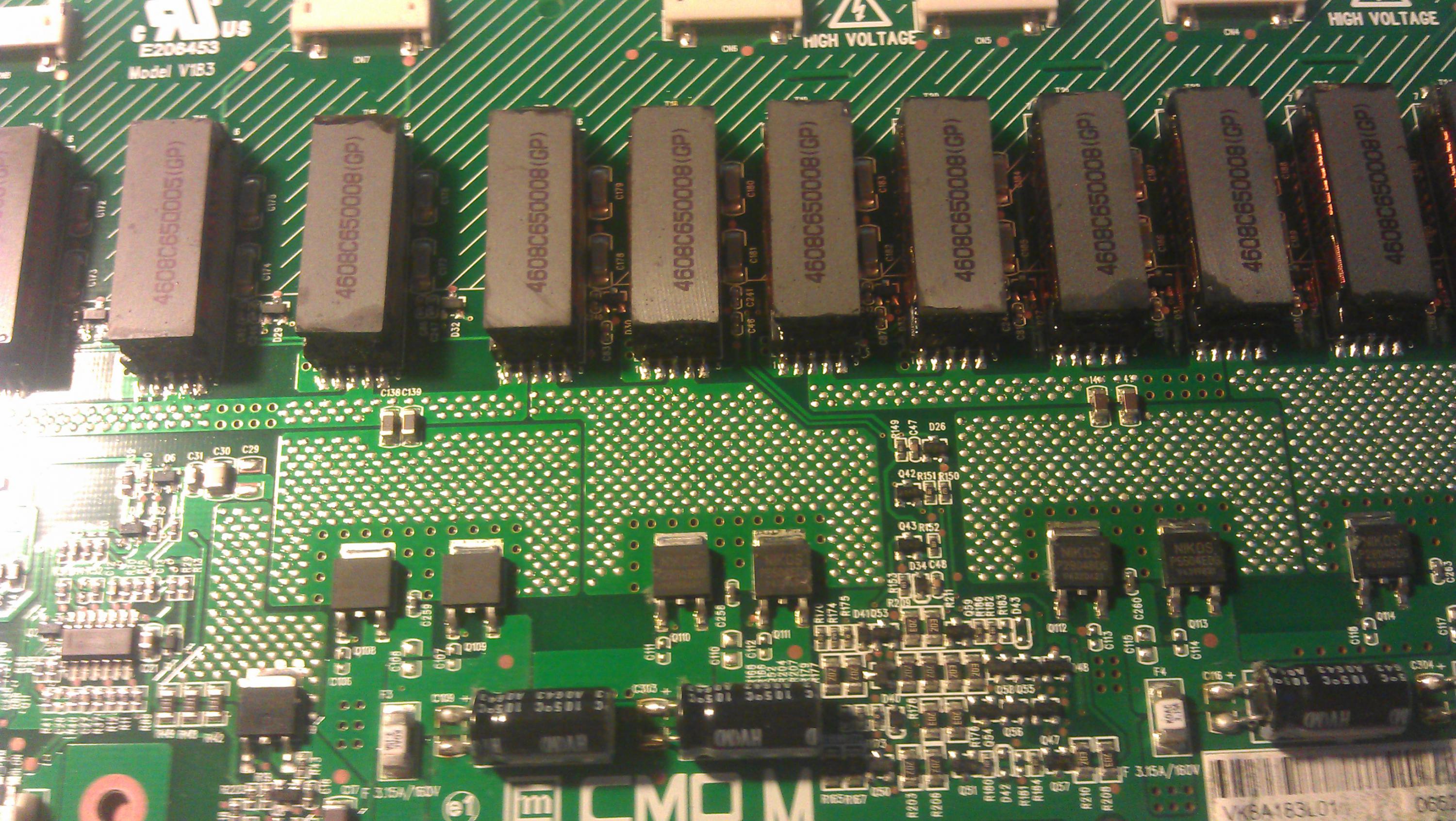

            i have all the boards off at the moment but i do believe there was audio, here are some pics not quite as good ill try and get better ones
            • smai
              • Dec 2013
              • 69

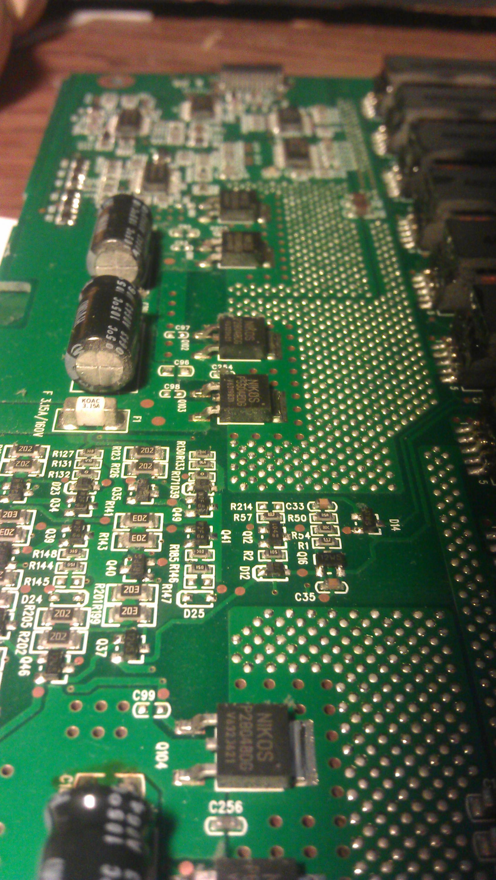

              2nd try at uploading
              • multimeter
                • Jan 2011
                • 739
                • united kingdom
                need to check,primarys and secondrys on all those transformers
                multimeter set to kohm or autorange if it has it
                the secondarys are opposite the ccfl tube sockets,there are little round copper pads next to the sockets,measure from these
                primarys opposite end
                when you return results here,write it something like this
                transformer#1 secondry 1500kohm - primary 0.5 ohm
                transformer#2 blah blah and so on

                • smai
                  • Dec 2013
                  • 69

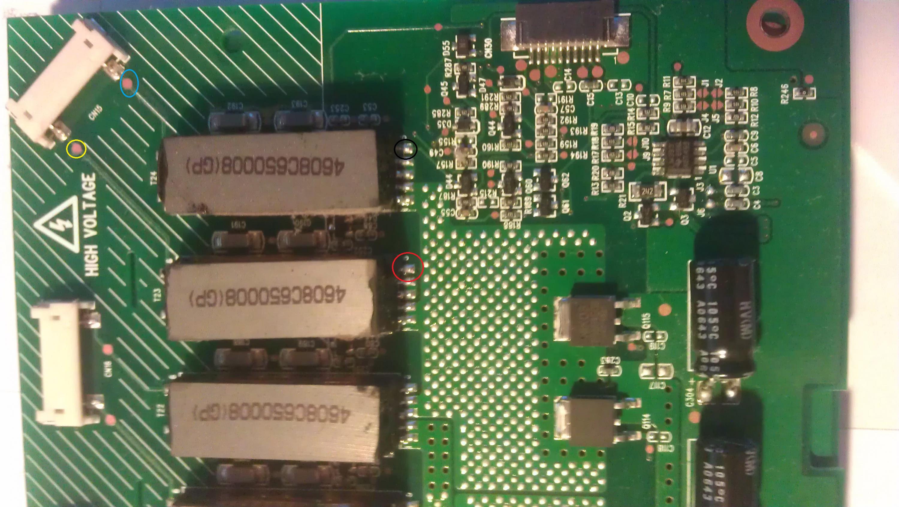

                  so in this picture blue to black is primary and red to yellow is secondary ?
                    Not sure about primary, but secondary is correct. Secondary is most important for now.
                    • multimeter
                      • Jan 2011
                      • 739
                      • united kingdom
                      red and black,on the same transformer is primary
                      blue and yellow,on the same transformer is secondary
                      the primary side rarely fails

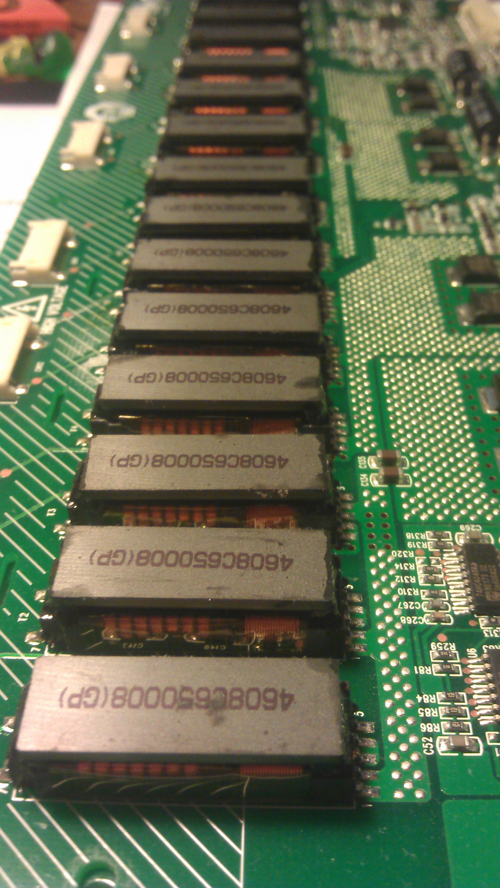

                        okay so far yellow to blue secondary with my ohm meter set to 200K
                        master board
                        1 3.7
                        2 3.6
                        3 168.2
                        4 3.6
                        5 3.7
                        6 164.6
                        7 3.6
                        8 3.6
                        9 168.7
                        10 3.7
                        11 3.7
                        12 165.8
                        slave board
                        1 3.7
                        2 3.6
                        3 166.5
                        4 3.7
                        5 3.7
                        6 162.4
                        7 3.7
                        8 3.7
                        9 163.5
                        10 3.7
                        11 3.7
                        12 163.1
                        tom66 yellow to red all read 1.8
                          Yellow to blue? Or yellow to red?
                          • multimeter
                            • Jan 2011
                            • 739
                            • united kingdom
                            hmmm,how many sockets for ccfl's are there and how many transformers?,ive noticed it looks like there are 2 transformers to one ccfl socket,didnt spot that!
                            24 transformers and 12 ccfl sockets?

                            • smai
                              • Dec 2013
                              • 69
                              two different opinions so i checked both, so i did yellow to red they all read 1.8
                              yes 24 transformers and 12 sockets per board
                                Yellow-red might be secondary, they look good if so. Not certain though.

                                  • multimeter
                                    • Jan 2011
                                    • 739
                                    • united kingdom

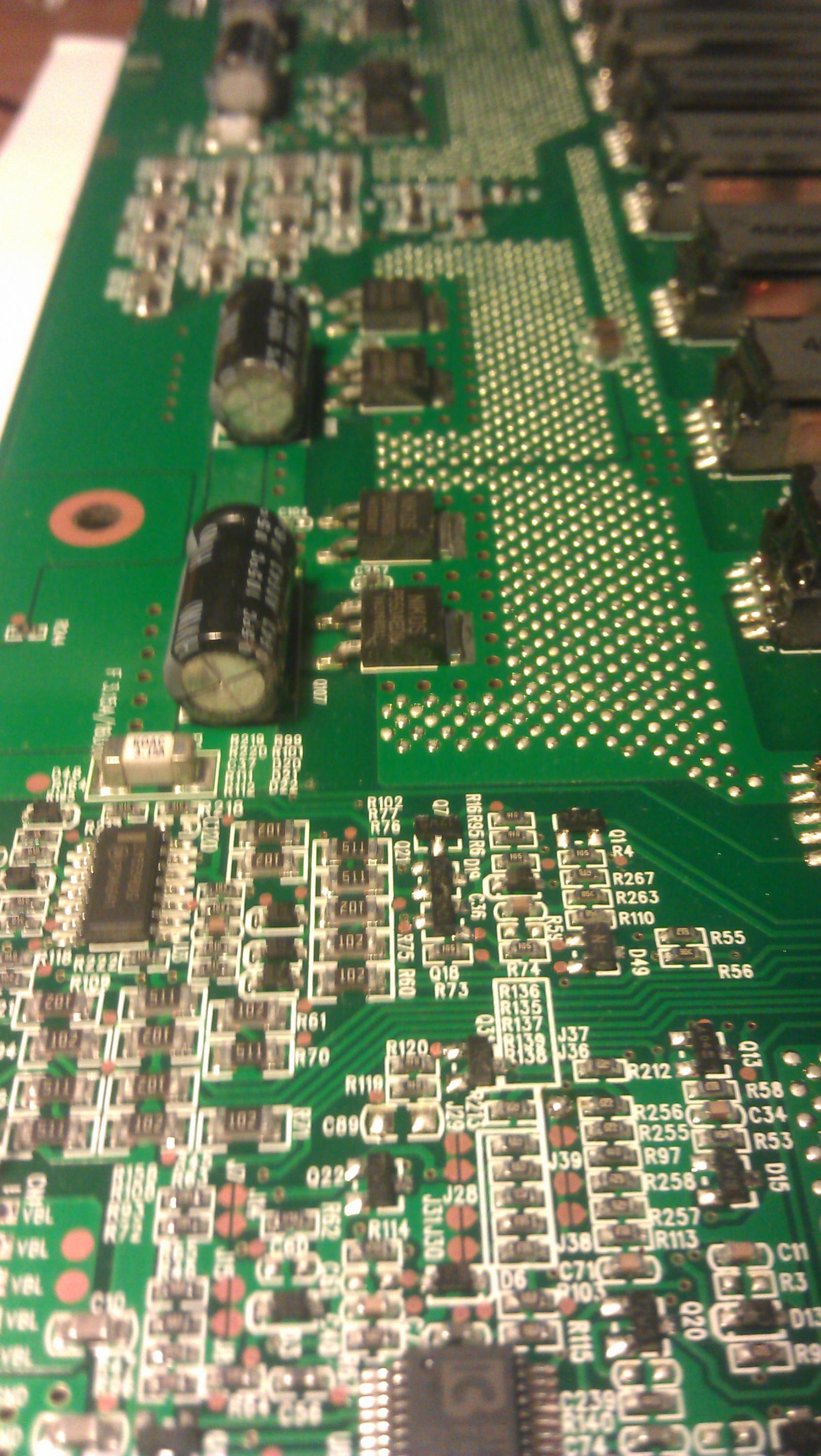

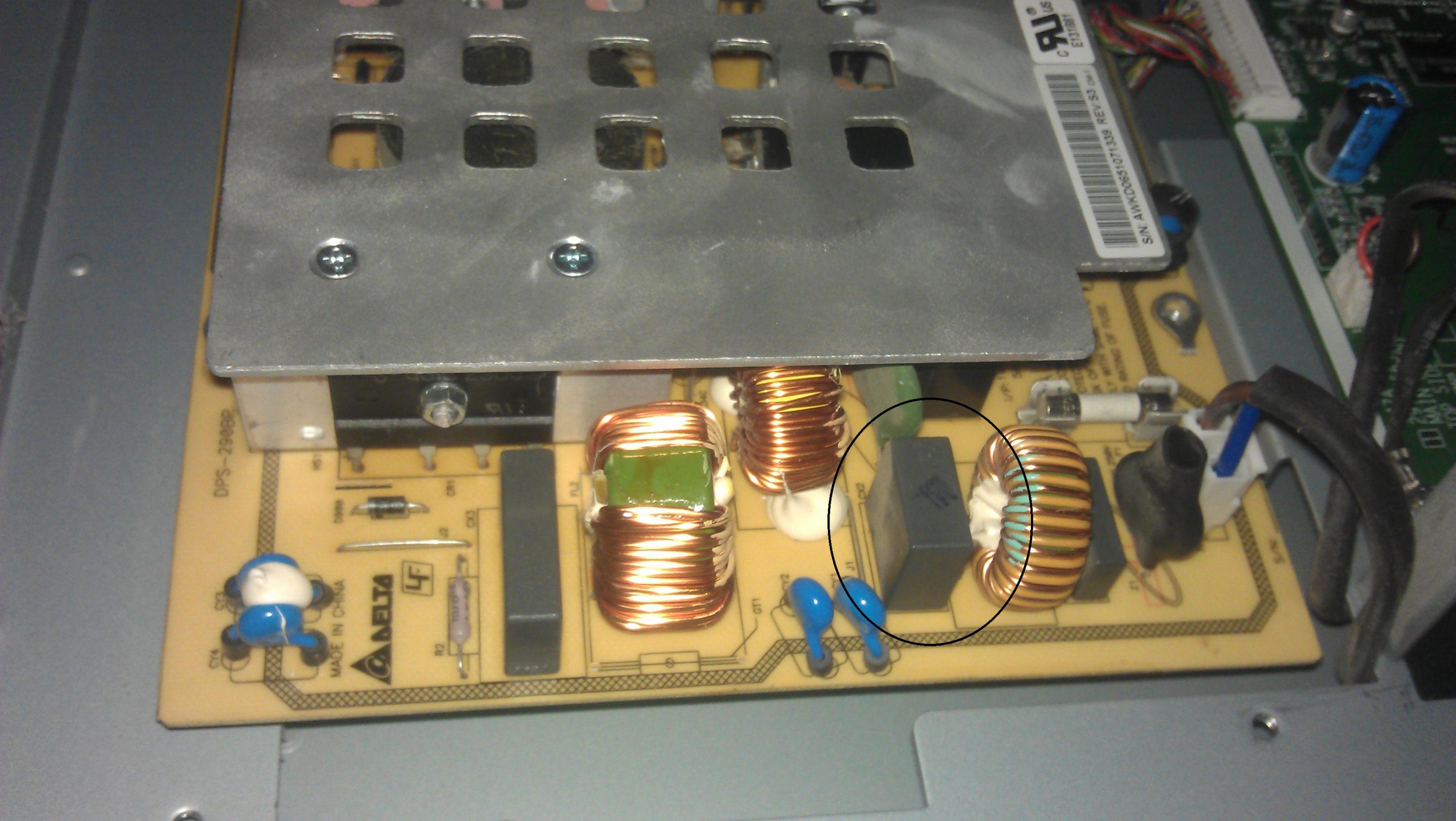

                                    can you pop up a pic of this cap? and the part number printed on it,ive never known them to fizz like that before,also can you pop up a pic of the solder side where this cap is?and circle/highlight where its solder points are,im really hoping this isnt a ccfl tube failiure,how long does the screen light up for before it shuts down?those ohm readings from the test results you did,seem quite uniform,and some do come out at around 1.8kohm,i was tired last night
                                      it stays lit probably about 3-5 seconds, im 90% sure its this cap that is buzzing (almost sounds like a cricket) right after the lights go out, when i disconnect the inverters from the power board and power on it doesnt make that noise, so with my logic either the boards are causing it to make the noise or the noise is causing the boards to turn off
                                        there could be a a boarder line resistance short happening ,can you do a resistance test to ground on the +rails on the inverters?,you should see lots of of kohms,if there is a few ohms,that could indicate a short somewhere,and will have to check the transformer drivers for shorts,passives etc
                                        a short would filter back through the feedback circuits ,and cause some reverse voltage,and that may be the sound your hearing from that capacitor under more load,and the mainboard shuts the psu down and so on
