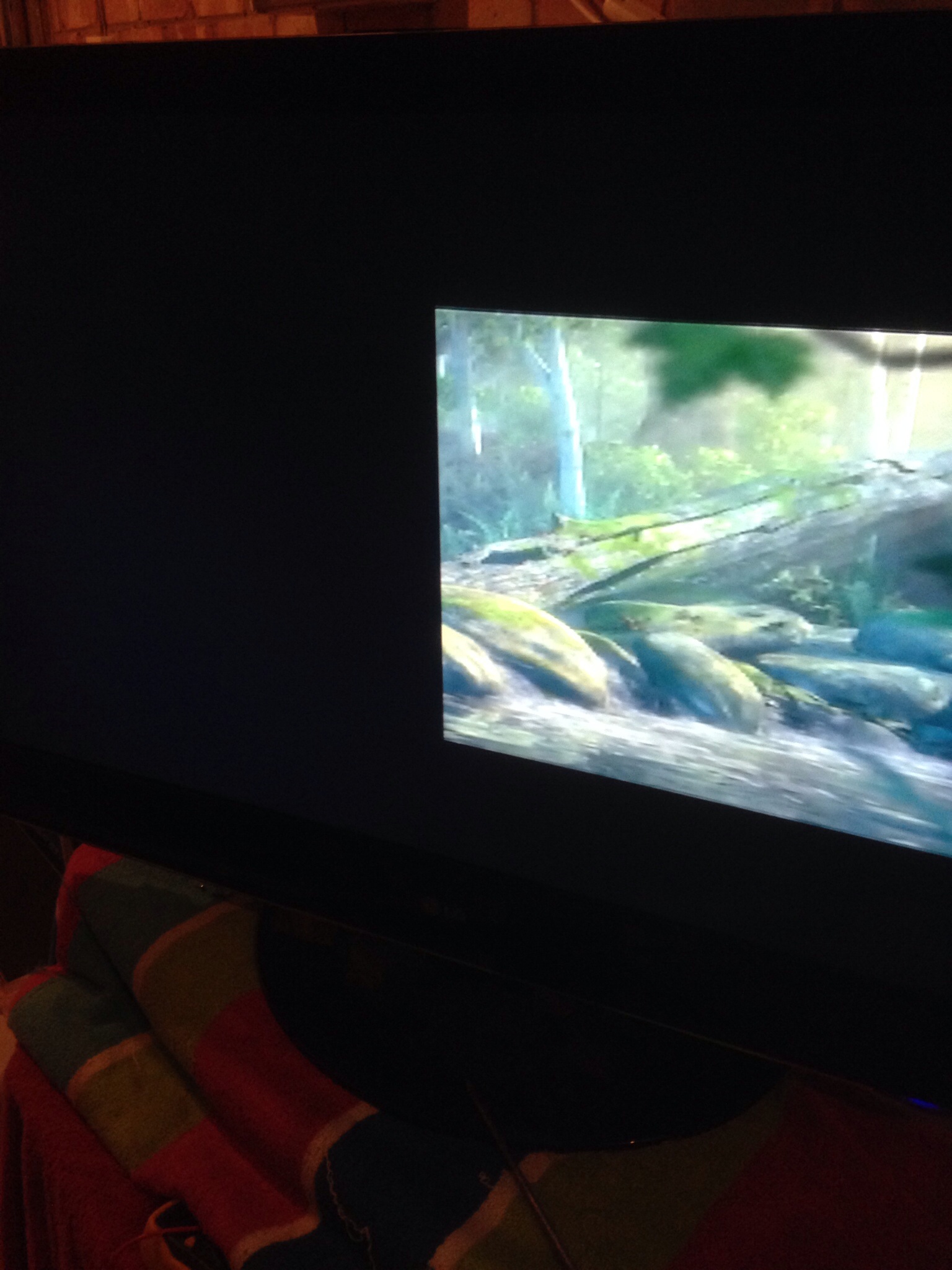

    Lg 42 lh3000
    First I had a vertical band left side
    Now half screen blank
    Any ideas plz

    Re: Lg 42 lh3000
    Ok I have found it to be far left tab bond
    How can I fix this plz

      Re: Lg 42 lh3000
      Not easy and may not be permanent - search for Tab bond using the search facility above = there will be a few threads suggesting how to pack it against the frame.
