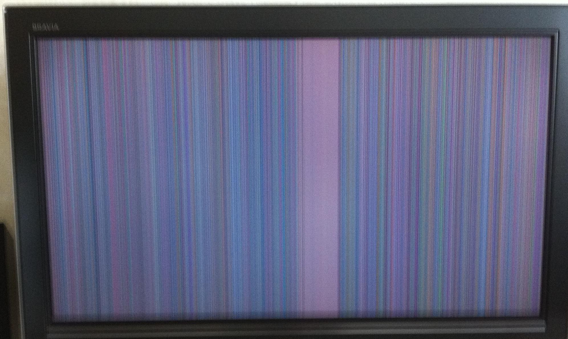

    Hi all just posting this incase it is of use to anyone with the same fault.i recently bought a sony bravia KDL32D300 manufacture date 2007.the fault was vertical lines all across screen as in picture,this is a very common fault with these.
    After googling for a while i found the problem that causes this is a smd resistor on the tcon board.which should be 9.1 Kohm it is marked as rt 36, when i put my multimeter on it was reading 3.5 meg. so i Soldered a 10K resistor across RT36 and the picture is fine again.
    hope this is of use to someone.
