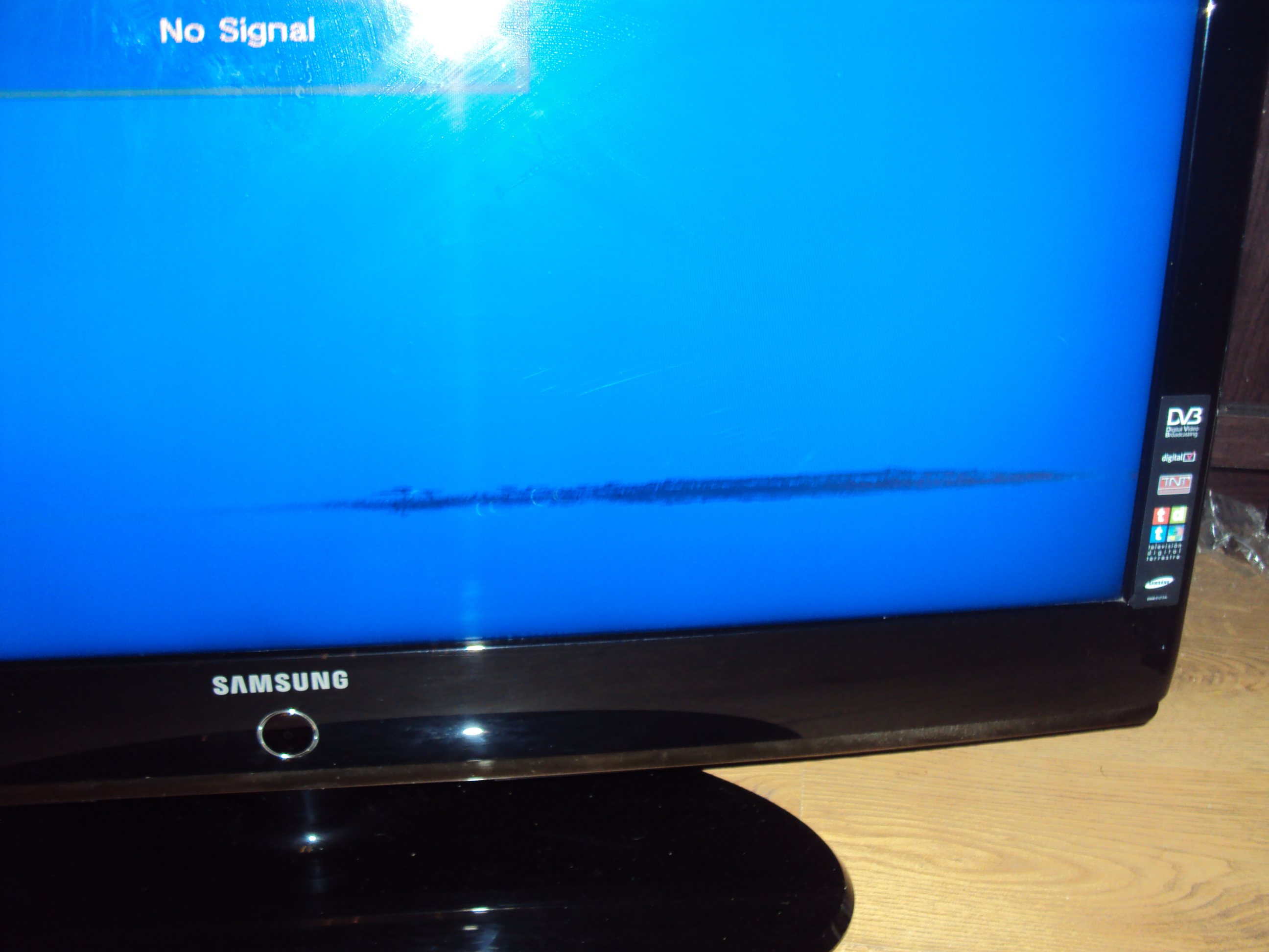

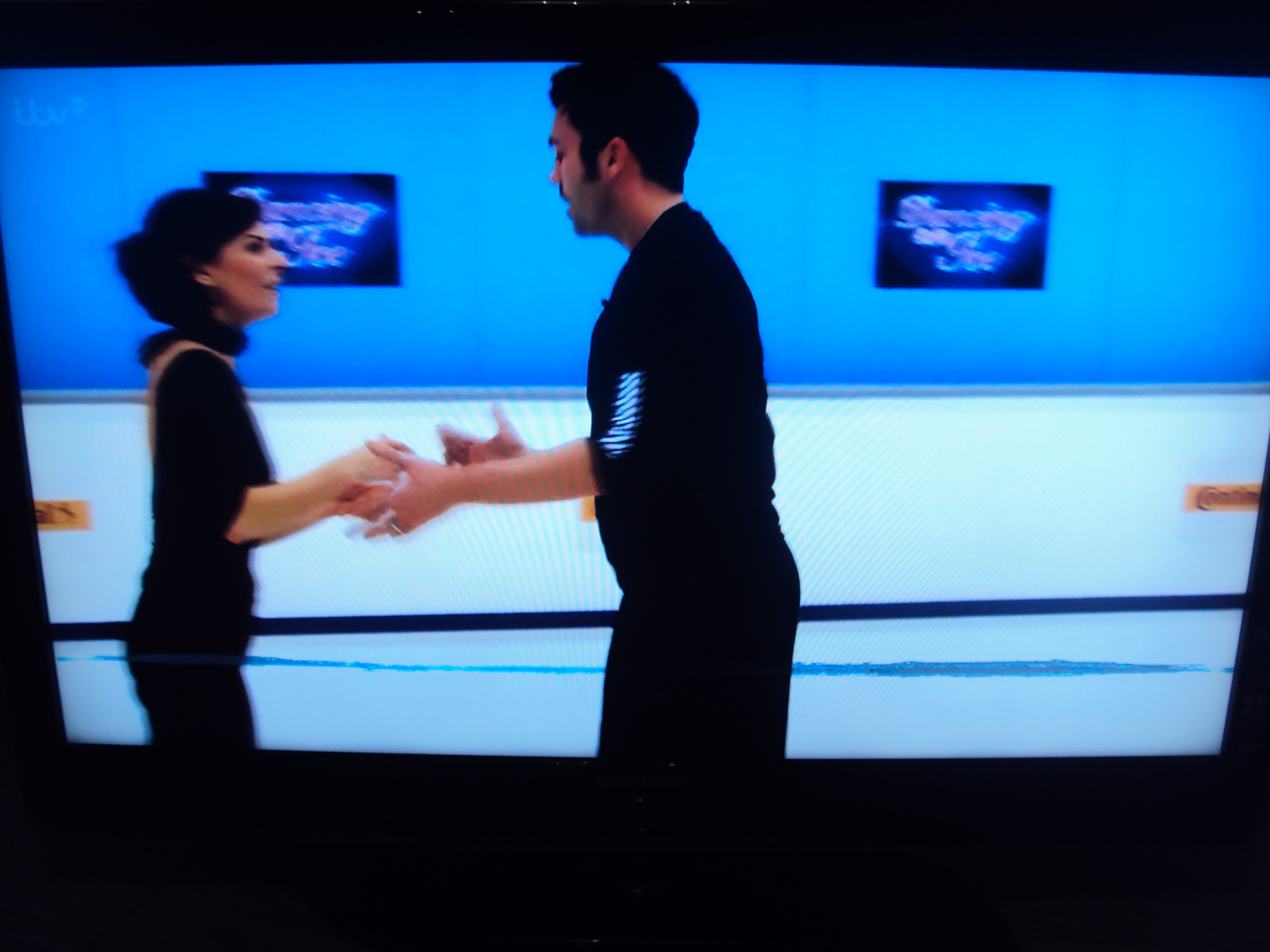

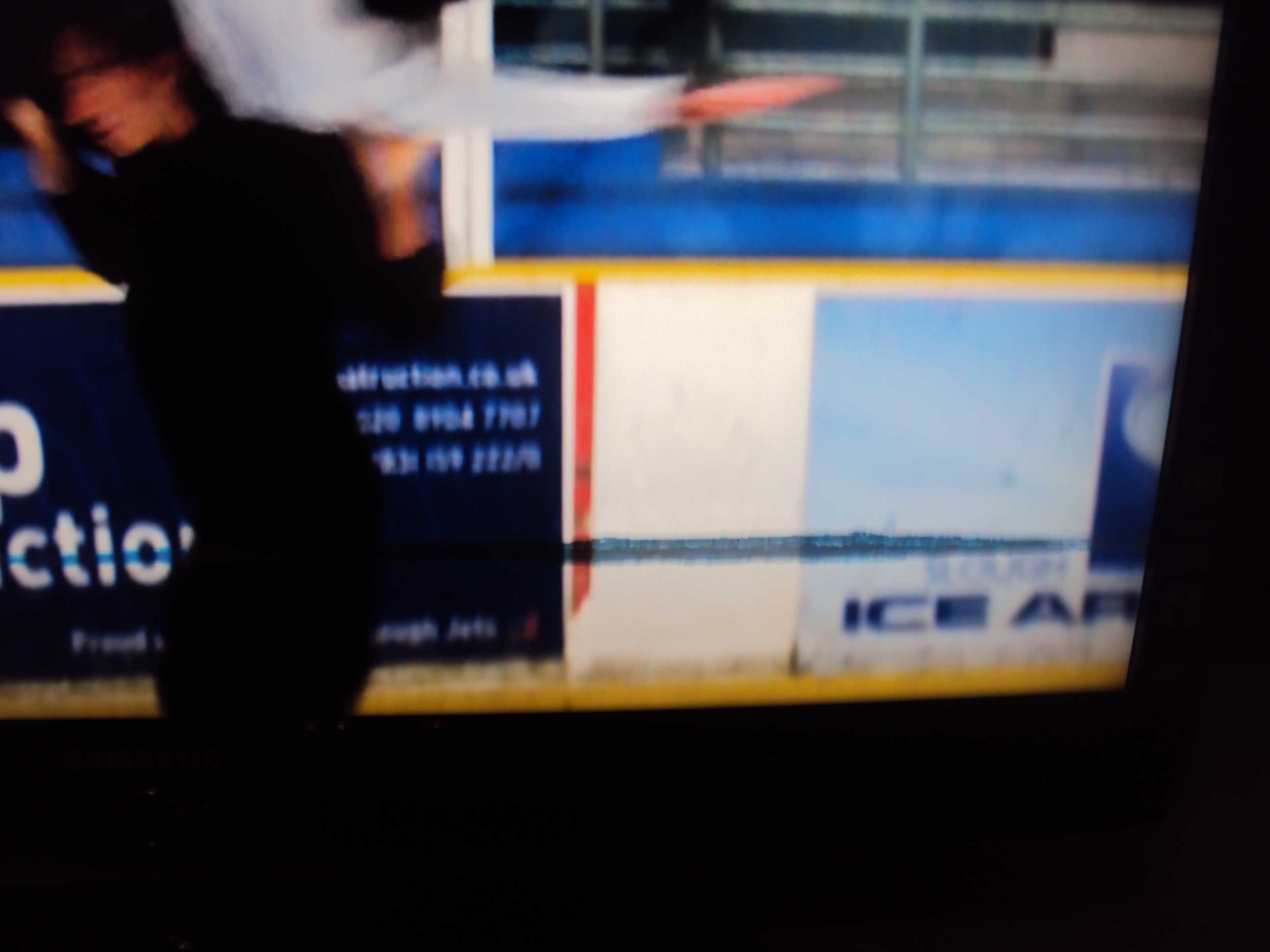

    Not sure if this is screen bleeding or what but in certain parts the picture can be seen through it
    have tried a hair dryer from the outside just in case it was condensation or the likes but makes no difference neither does touching the effected area
    any ideas? or just a bad panel with damage?
    also there appears to be no impact damage anywhere, lady i got it off said the usual "it just went like that"

    This is a common issue with this model and is unrepairable.

        I think it's related to a defect in the bonding between the layers of the LCD but TBH I've never had one myself, just see it now and then on this forum and on ebay.
