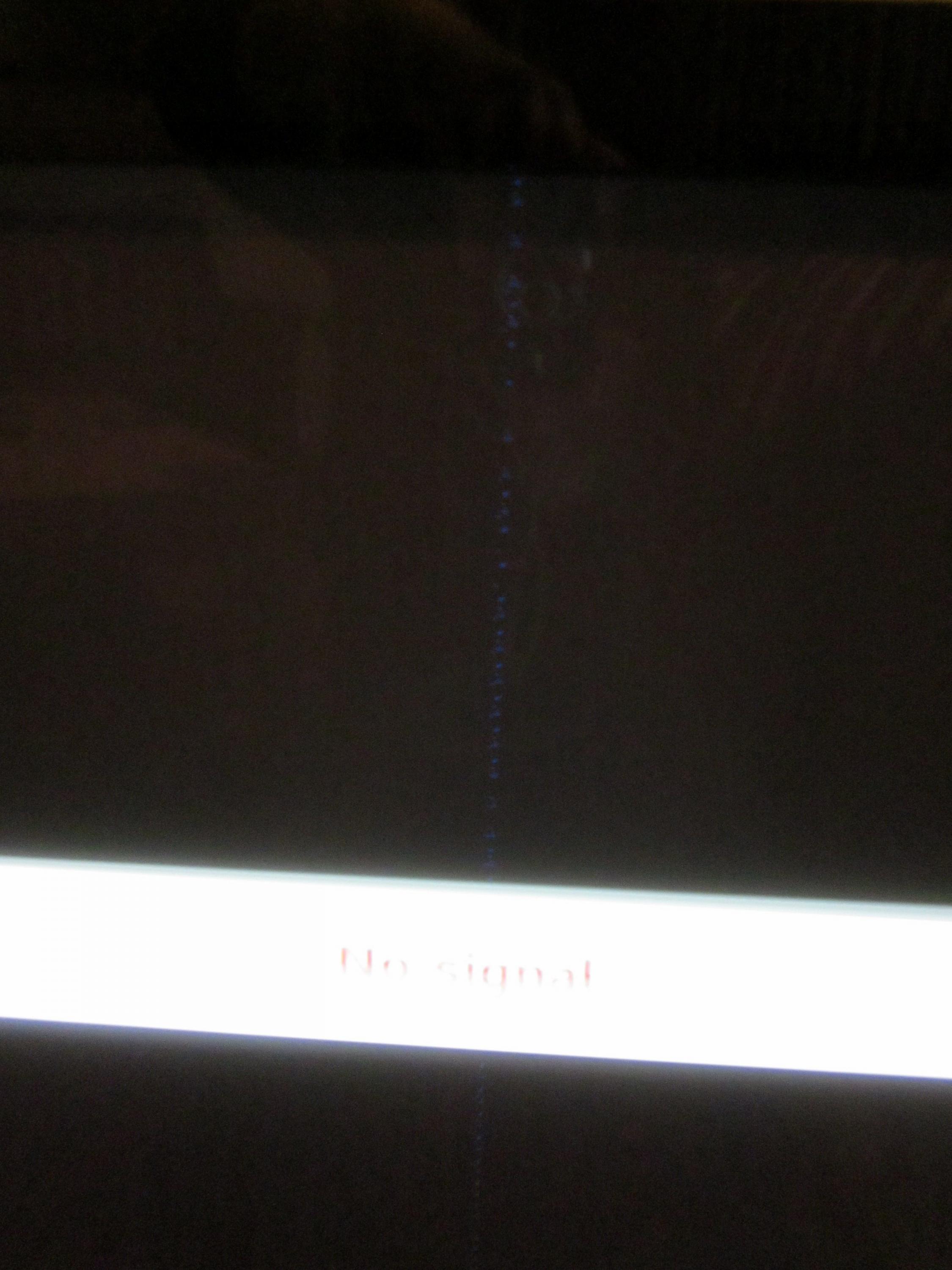

    a little up date once in say 20 times it powers on OK picture has a blue very faint dotted line dead center top to bottom only really visible on black scenes any ideas and is behind the osd box.

    Blue dotted line looks like panel fault to me, unfortunately. 10 blinks is an easy fix and well documented. http://www.youtube.com/watch?v=LjpGKaBt8hg

      its weird tom the dots are behind the osd box not in front only visible really black scenes.
        Re: panasonic TH42P285B
        Blue dots don't appear over white. If you try grey you'll probably see some.
        If you can live with that minor fault you've got a VERY nice TV, I personally have 46PZ80 and 42PZ80 and love both.

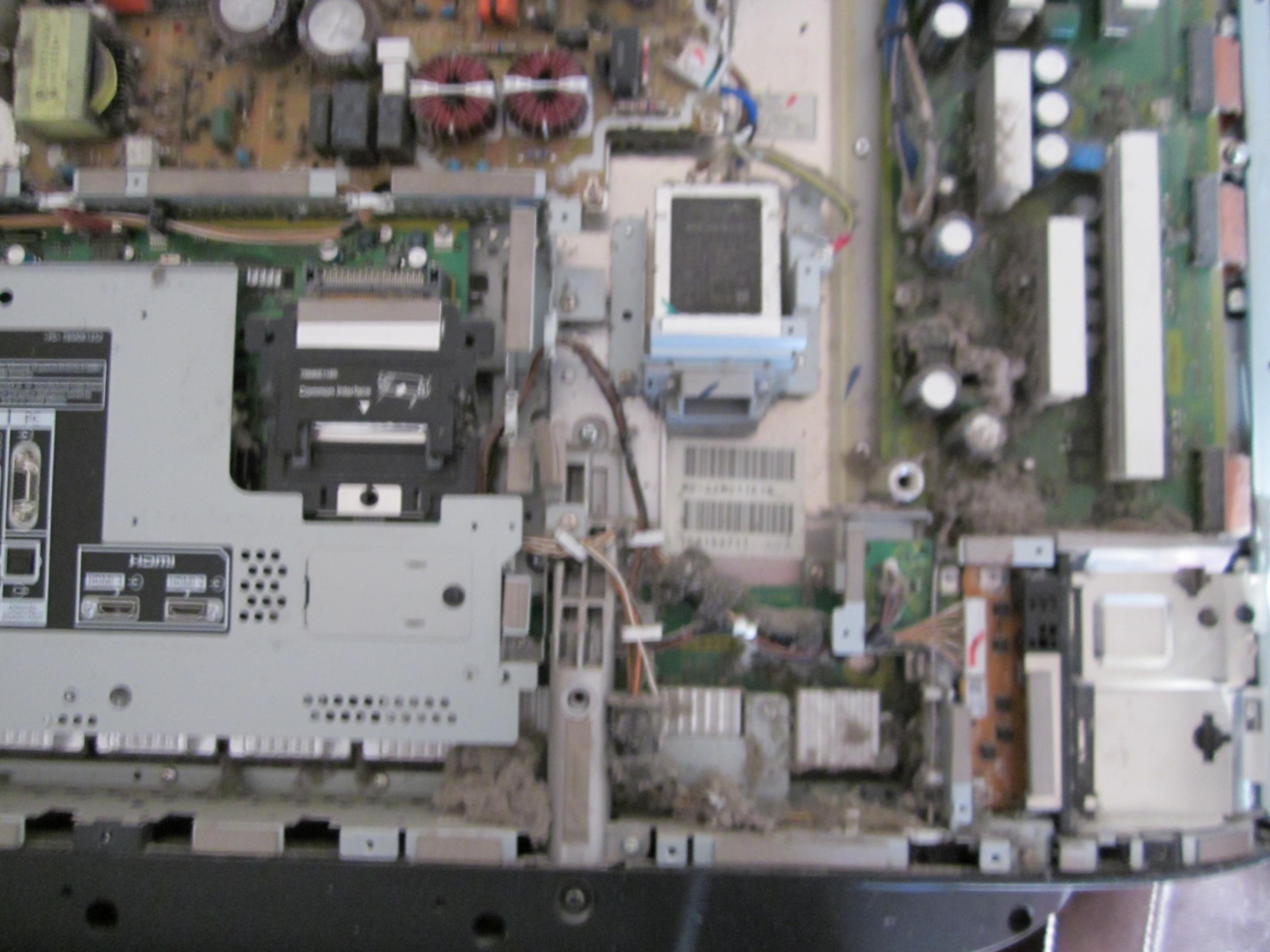

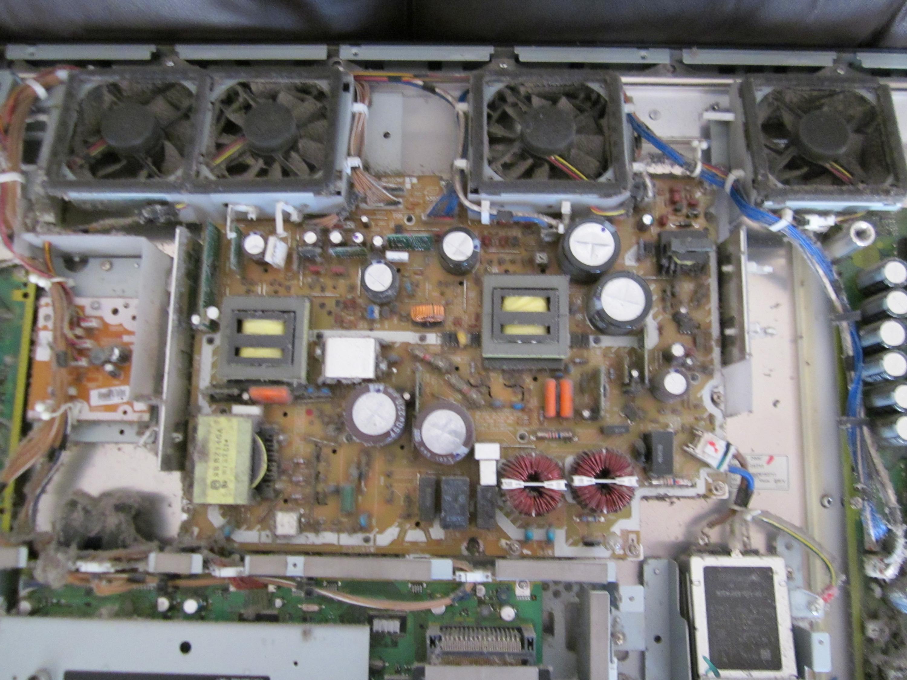

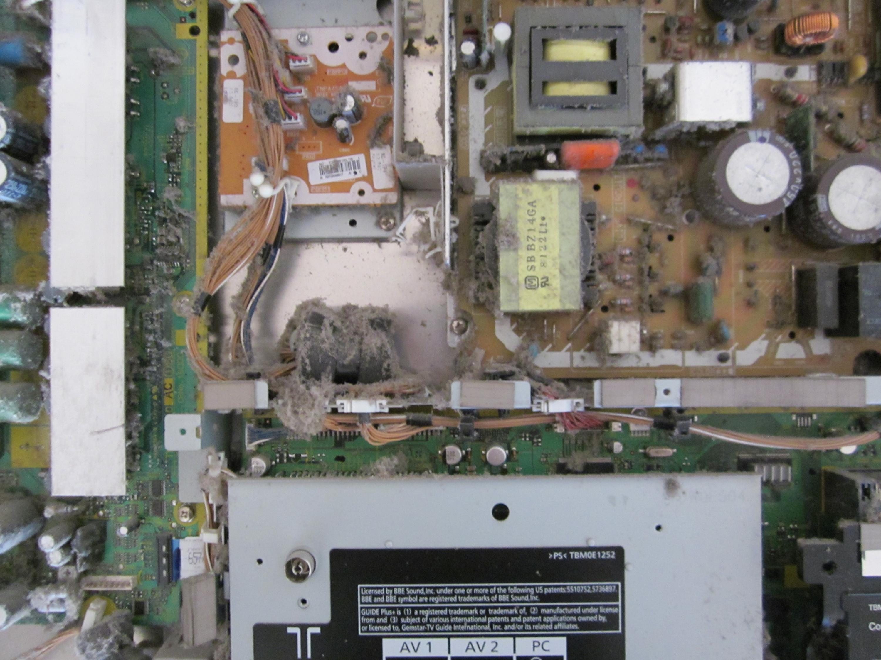

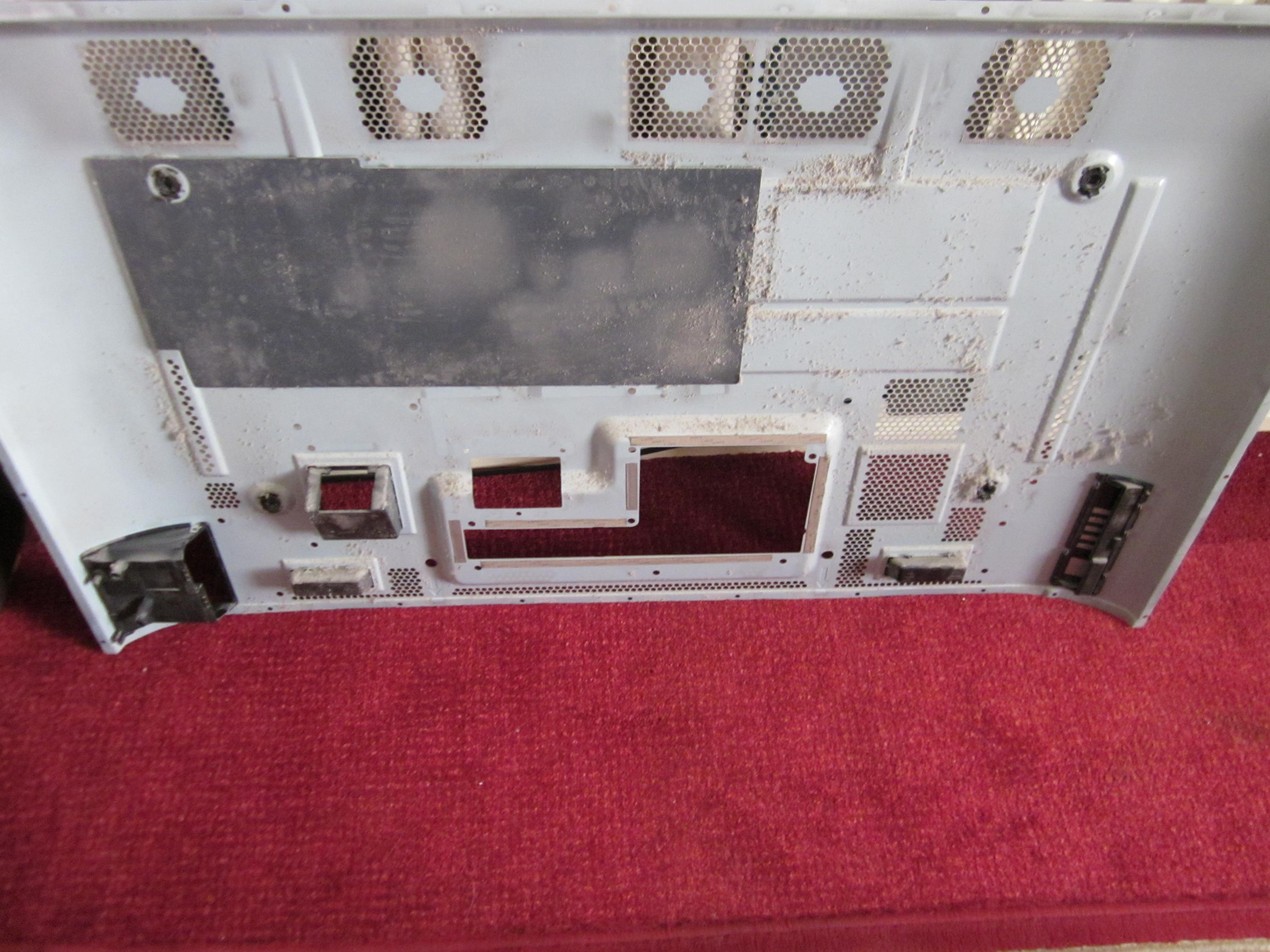

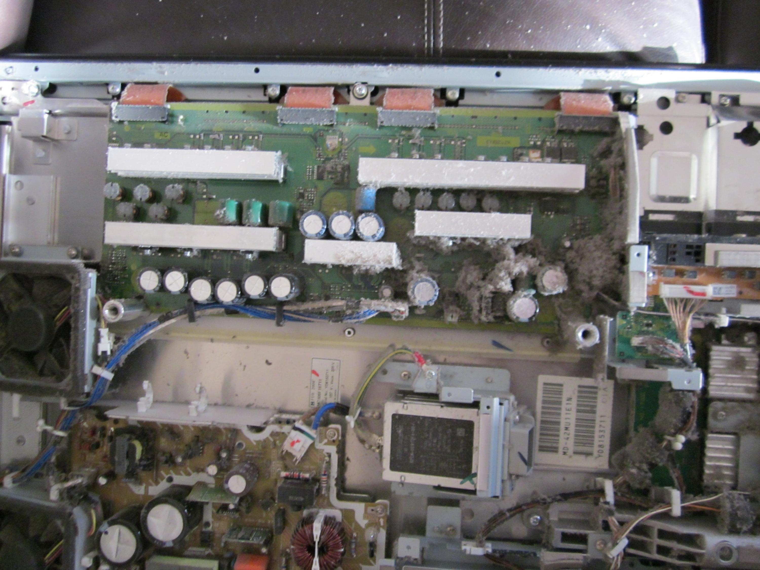

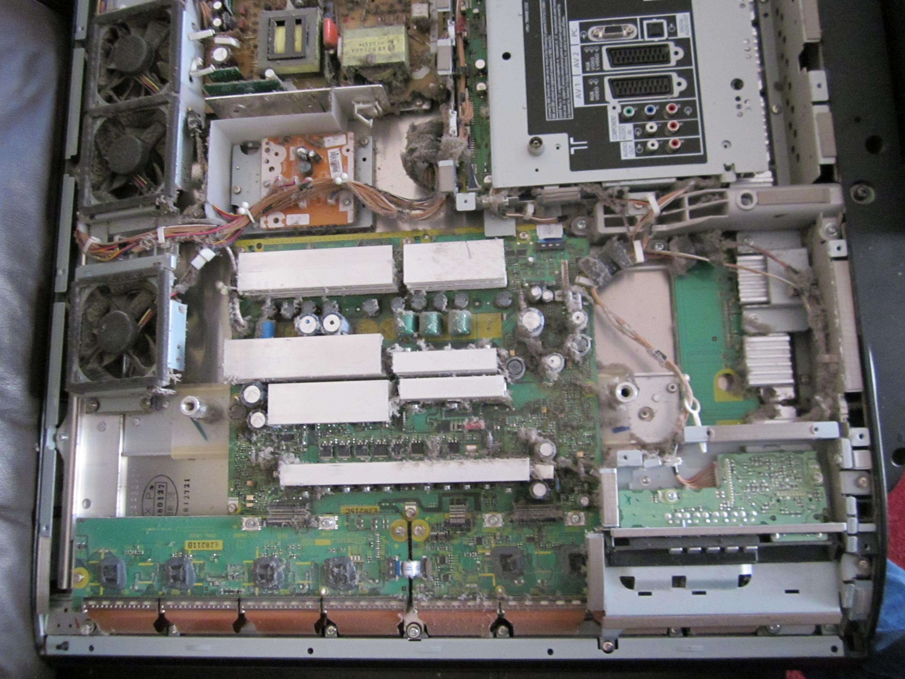

                        some pics of how bad the dust was inside ive never had on this bad
                          Oh dear wow, that is by far the worst right there. Never seen it that bad before.

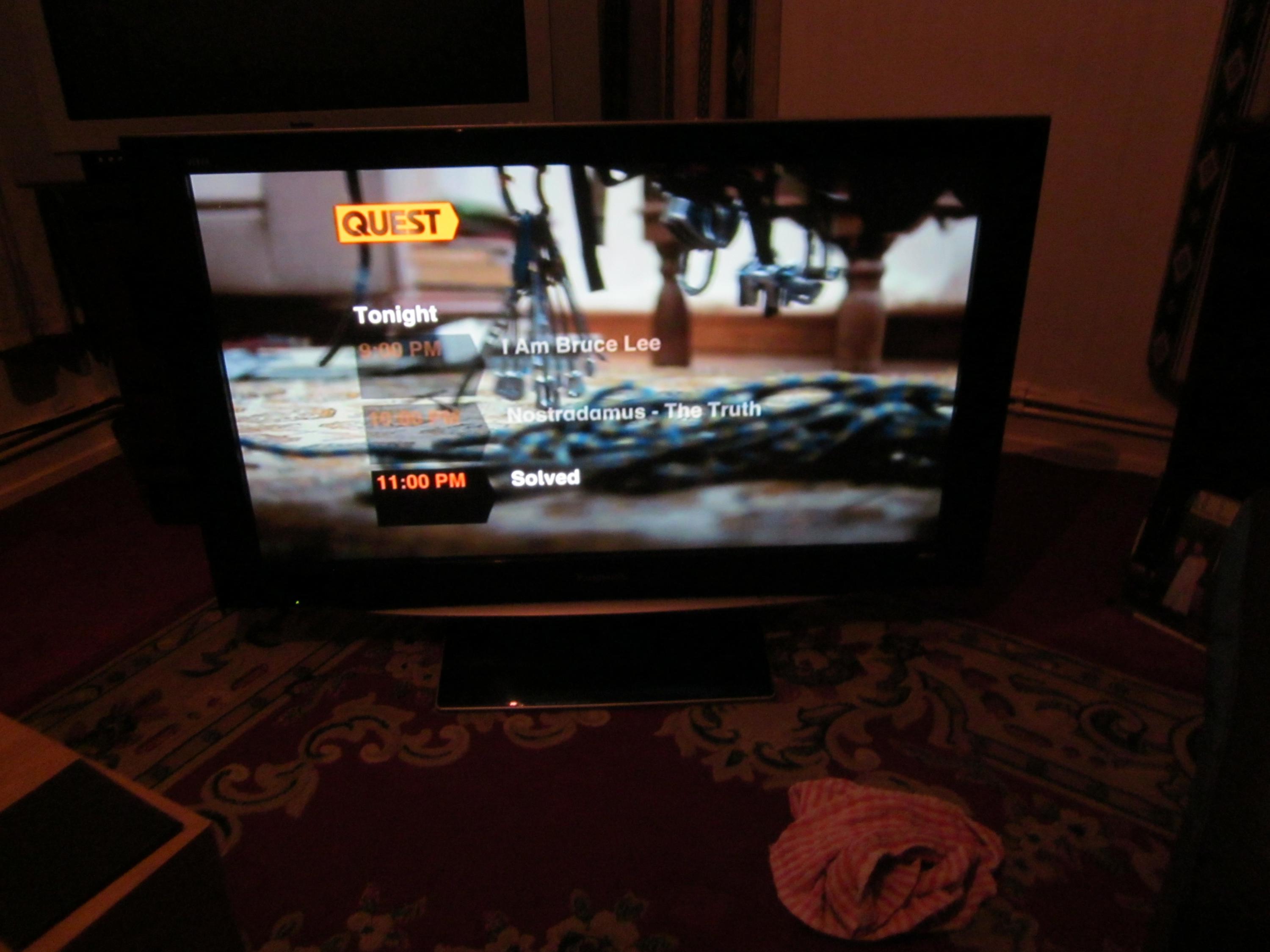

                                  hi guys just to update this thread the job was a bit tricky some disassembly required to remove the whole psu and then the 2 boards to replace the two small capacitors i used ordinary leaded ones glued onto the ics and im glad to say the sets working great and the line in the center of the screen now seems to of gone for now. i cant see it all all so now i have a great looking 42in plasma in my lounge for the cost of two capacitors and my time as the set was free cheers tom for your advice as usual.

                                      no this plasma was totally free even delivered to me they had forgotten the power lead and the remote but i collected them from the people its a great picture on these sets imo the black colors even look nice will keep this set myself not going anywhere haha.i have just placed another wanted add on my freecycle for any faulty electronics has to be done need to keep busy haha.
                                        It's plausible that blue dotted line is a loose LVDS cable, I'd keep it only together with 4 screws for a few days to make sure it doesn't come back.
                                        Yeah now you have me jealous, 42" PZ85 is top of the line model, does it have Freesat HD? Can't remember - my friend has PZ81 and that does.
