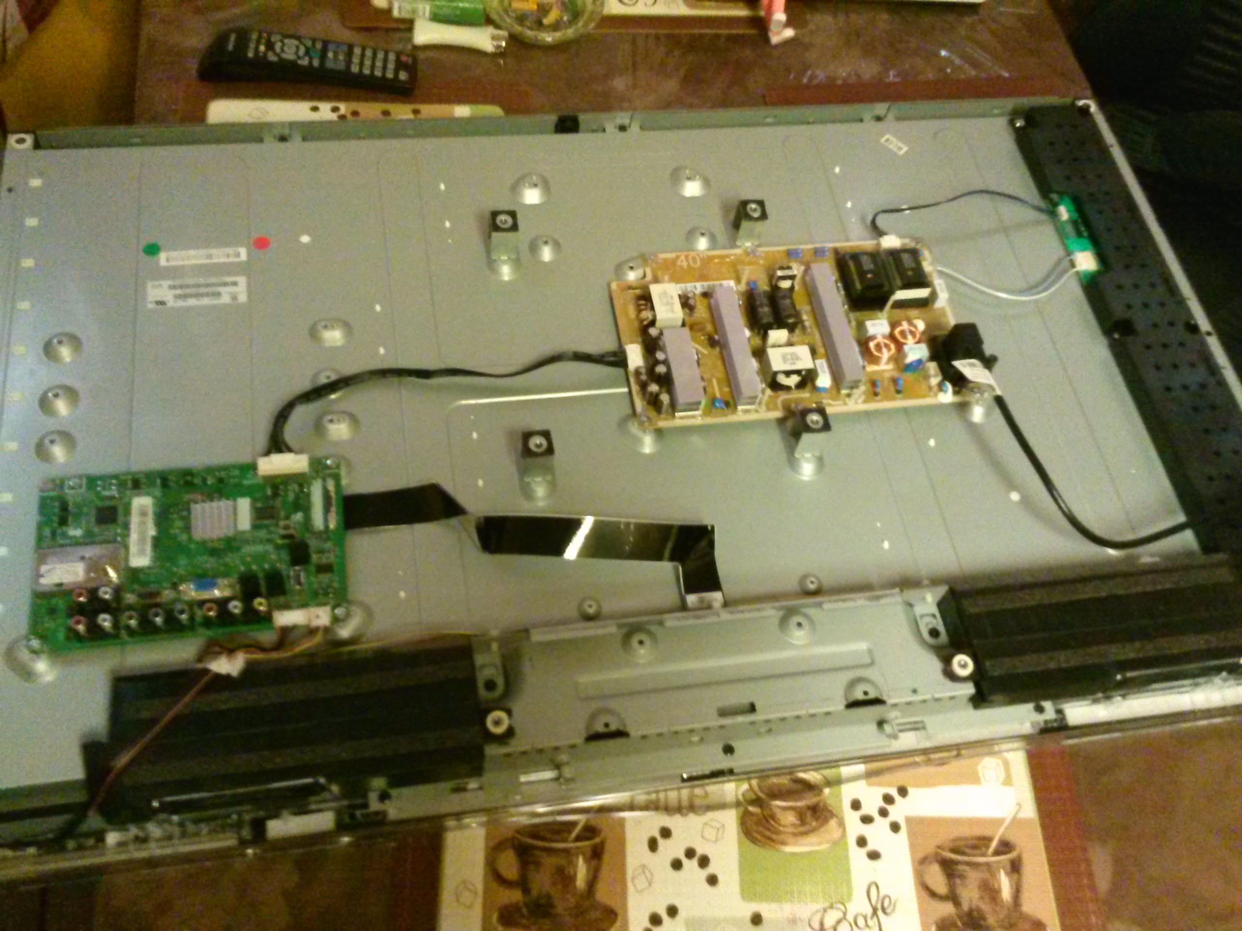

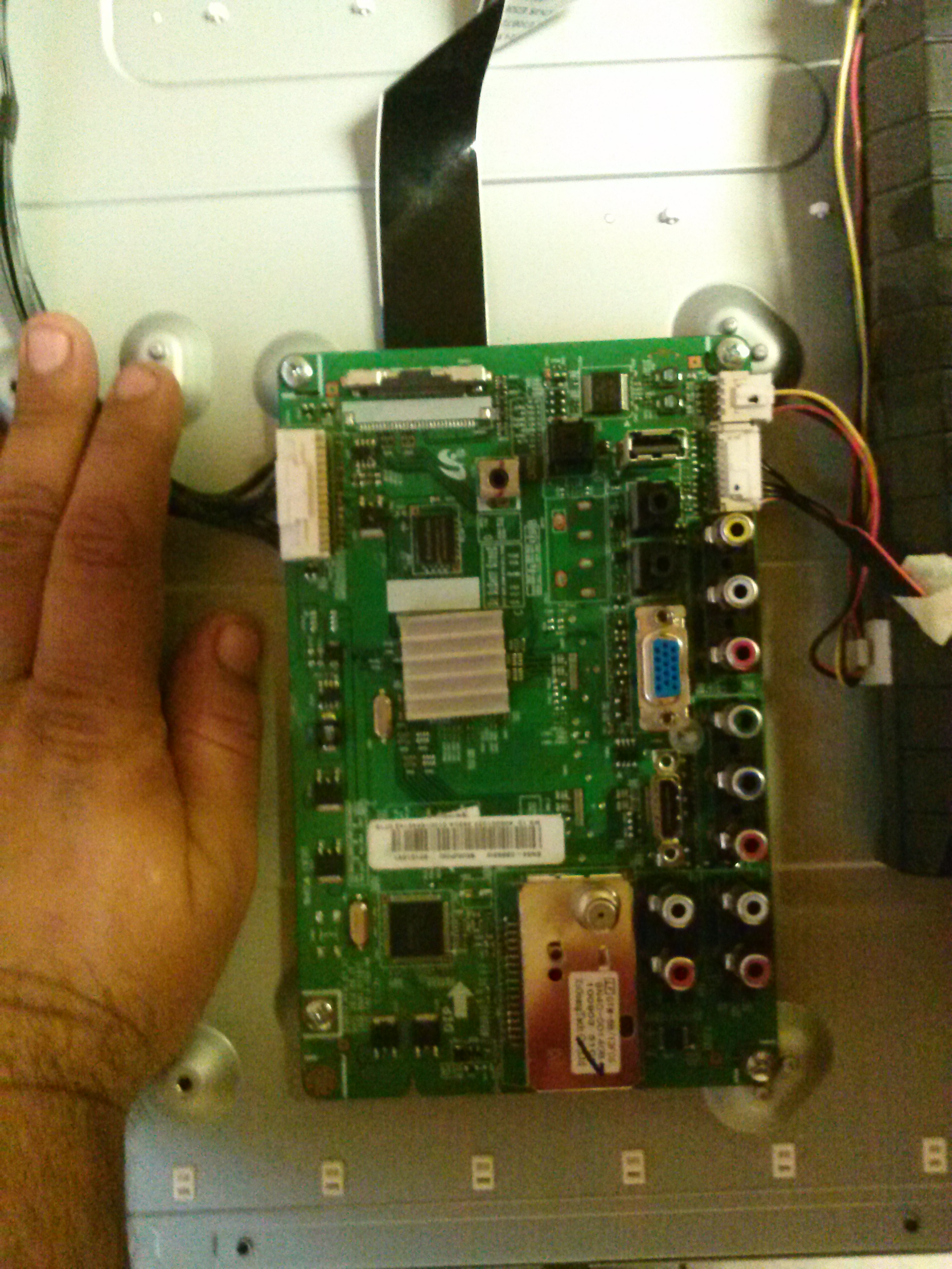

    Picked up this 40" Samsung on Cl was told red light is on but TV will not come on he said he was told main board.. I opened it up Caps look Good i plug it in red light is on but will not power on as he stated.Once i unplug the main board the back lights light up and the screen is blue.Plug in main board and it wont power up.. it would seem pretty cut & dry its a main board issue but i know with TV's anything is possible so i ask the input of More knowledgeable Men
    here are some pics

    Any reaction on Power LED from pressing buttons? How does it behave with T-con disconnected?
    • whatusername
      • Dec 2013
      • 456
      Re: Samsung LN40C500F3FXZA Power on issue
      The wierd thing Tom is i do not see any buttons on this TV unless its has a Touch Sensor. but i tried to press on the front where the butons should be and nothing happens i will remove t-con now. BRB
      T con unplugged and it is still the same
        It does have touch buttons, built into frame. Confusing but they are there.
        • whatusername
          • Dec 2013
          • 456
          ok well tcon is not connected and it is still the same
            Pretty much confirms main board is at fault. I don't yet know if anyone has been successful at repairing these main boards.

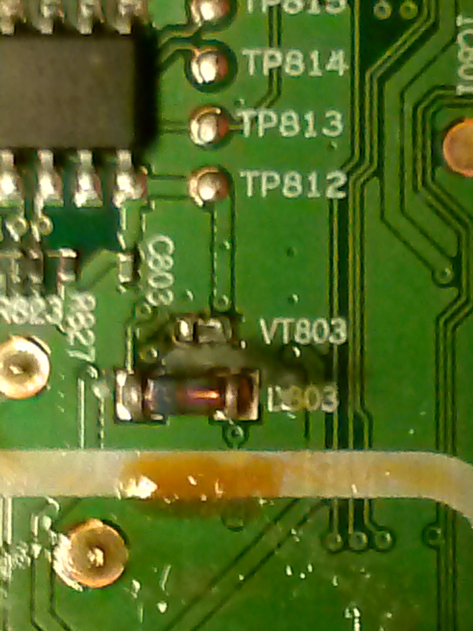

                  ok i will read through that but Tom i took off the main board and looked it over with a magnifying glass and i saw this... what do u make of it? VT-803
                    Hmm, yeah, that looks bad. Does that component test as open?
                    • whatusername
                      • Dec 2013
                      • 456
                      i will check now... what am i looking for ohm or continuity?
                        Ohm -- report reading.
                        Continuity just says if value is below a certain figure.
                        • whatusername
                          • Dec 2013
                          • 456
                          ok well on ohm VT803 shows 0.00
                          D803 which i believe is a diode shows 122 but if i reverse the leads it shows 139

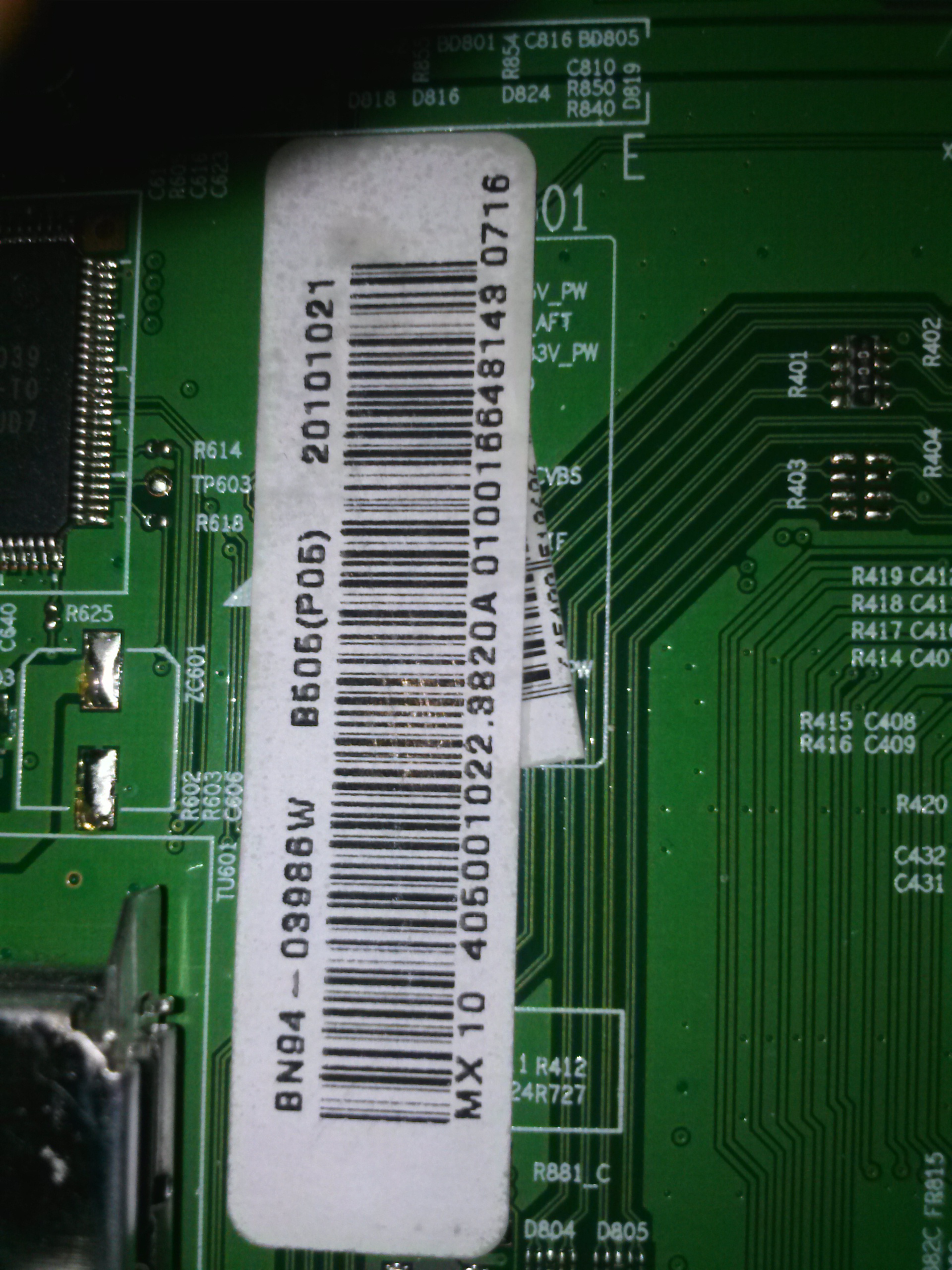

                            Any "BN##-######" number printed on PCB (not on label?)
                            • whatusername
                              • Dec 2013
                              • 456
                              Bn41-01181c
                                Can't find any schematic unfortunately. Trying to find parts list, found one for 40" LED Cxxxx series but unfortunately it is a different main board.
