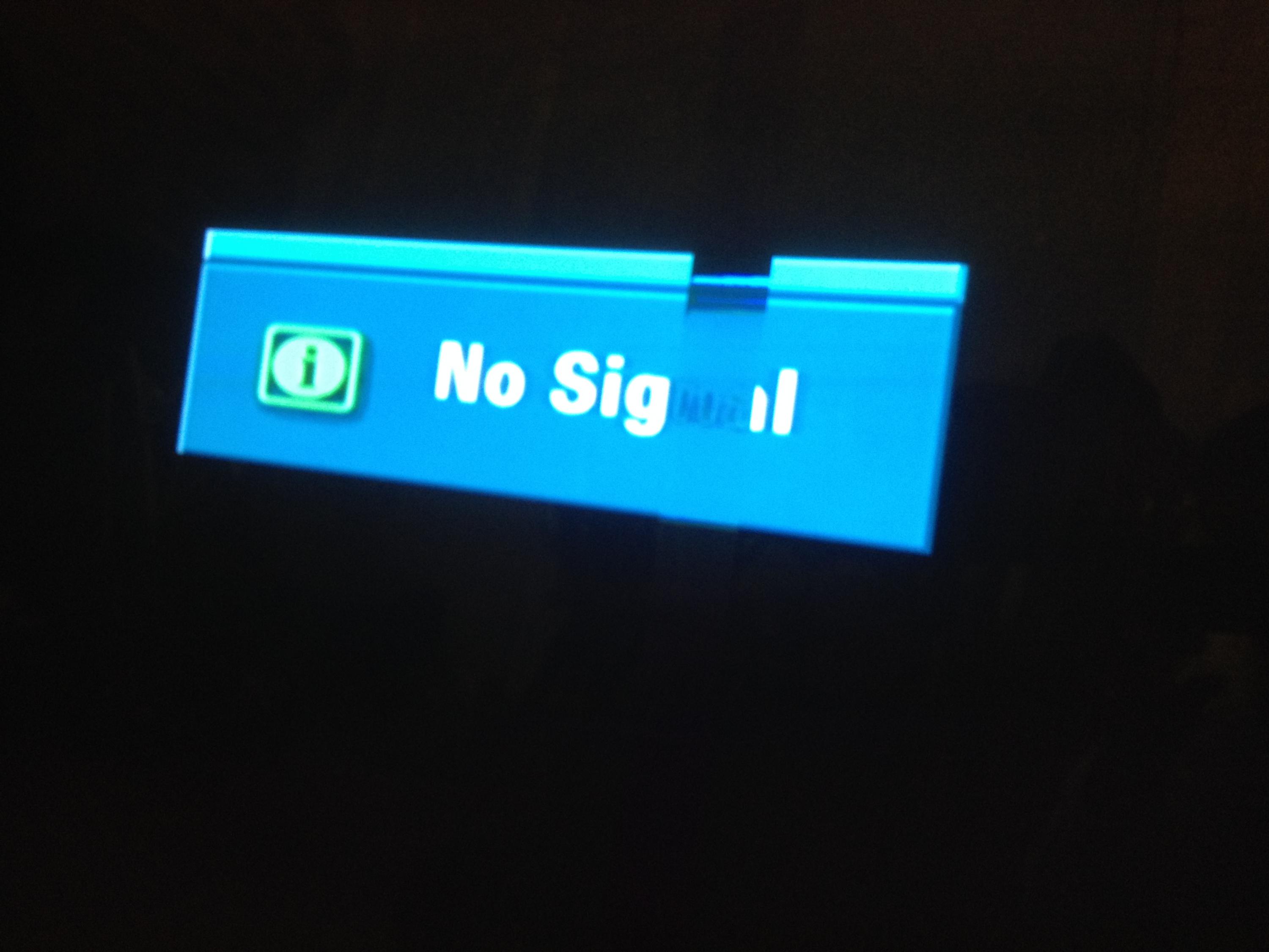

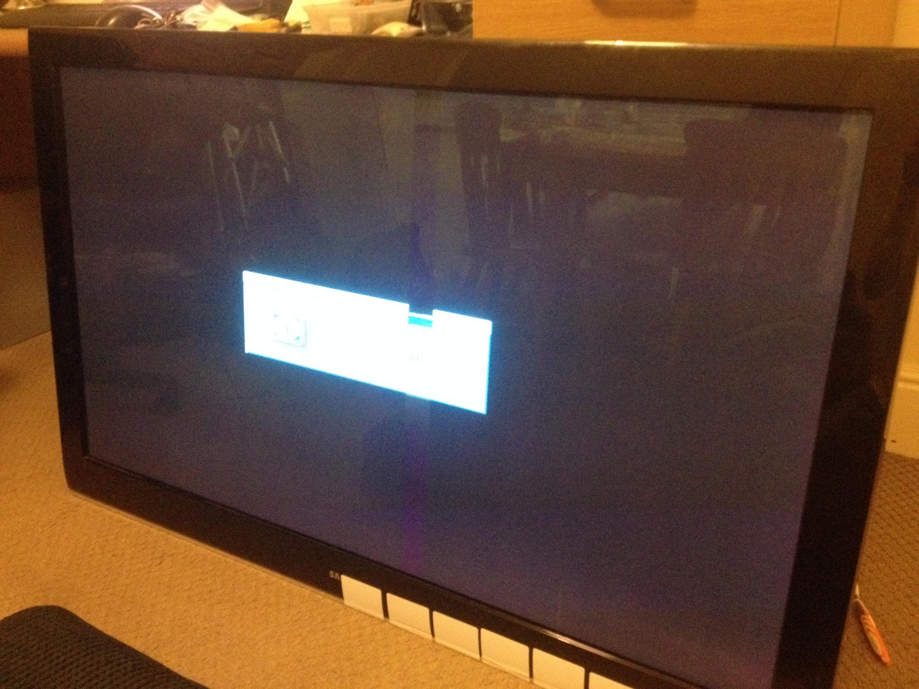

    Re: Samsung PS50A557S3F - vertical lines on right hand side
    any particular board i need to look at as i double checked they were all ok befor powering back on
      C-board -- one that runs along the bottom of plasma panel.

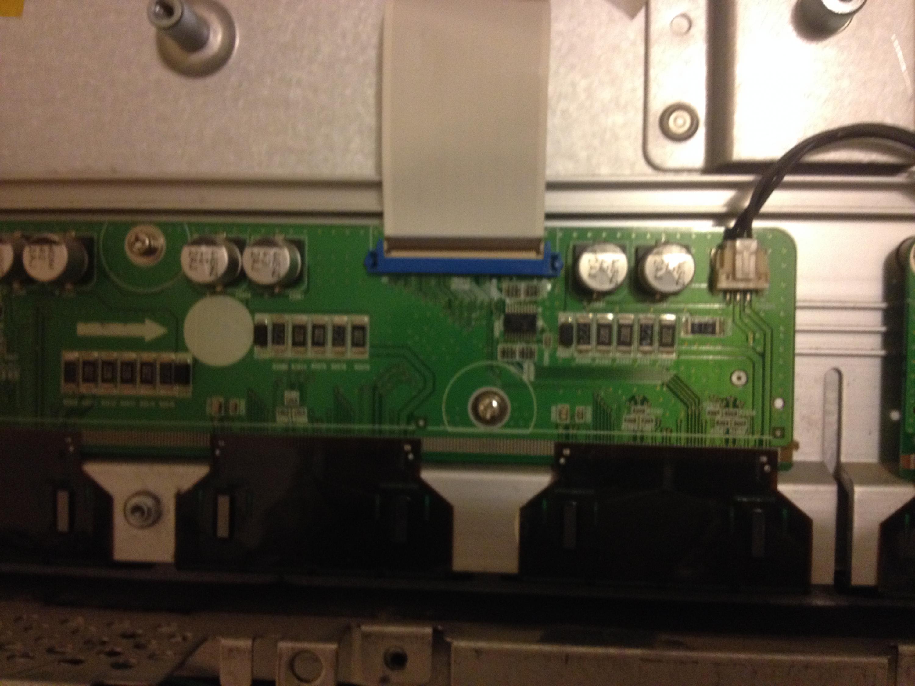

                    i presume c buffers are the bottom ones - no
                      #30

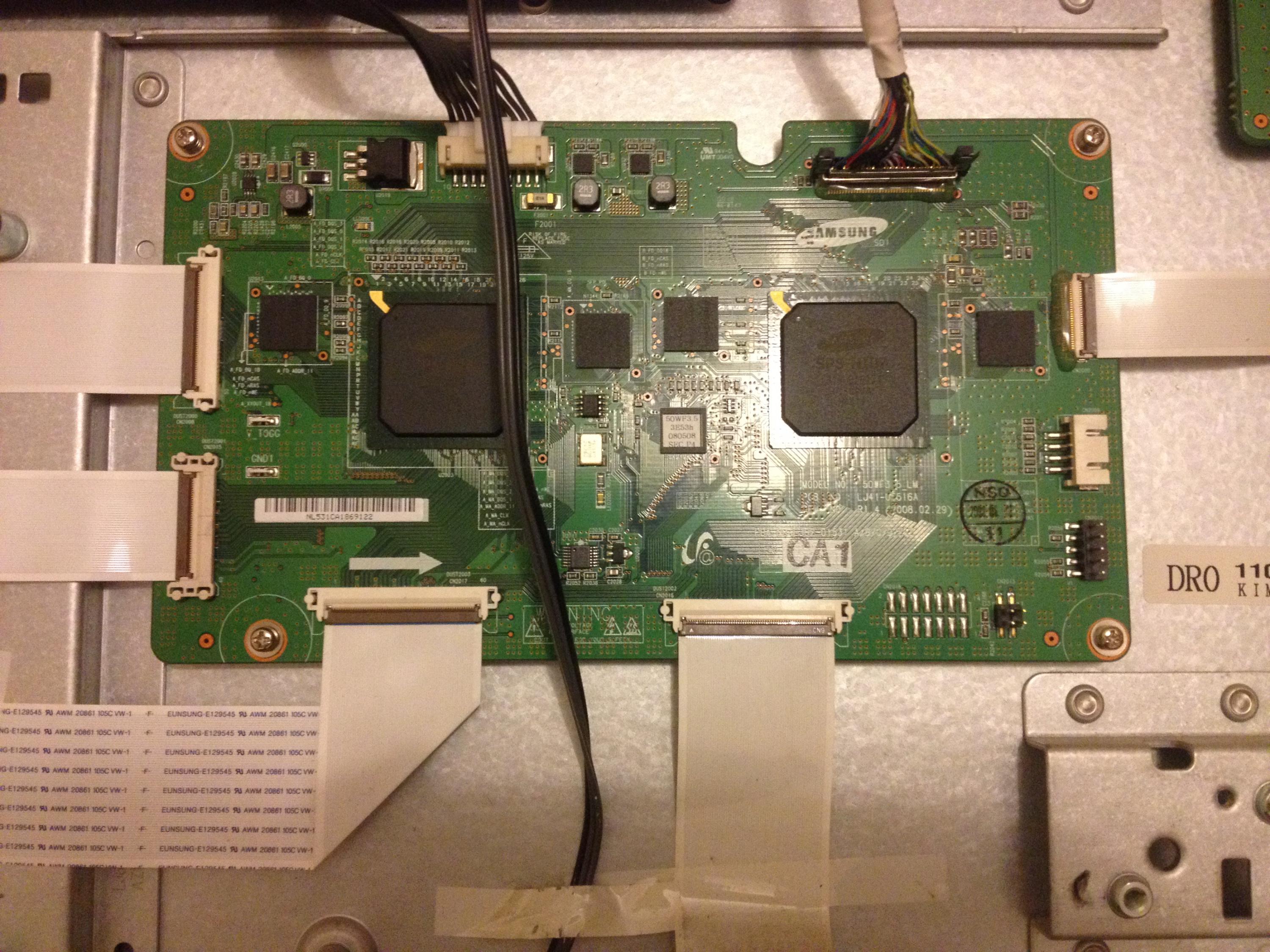

                      Reseated the connector for that driver chip? Pictures of the C board and the connector can be highlighted, if you are having trouble.
                      • noledud
                        • Dec 2013
                        • 413
                        • united kingdom
                        #31
                        can you please so i know where you mean ?
                          #32
                          I need a picture first...?

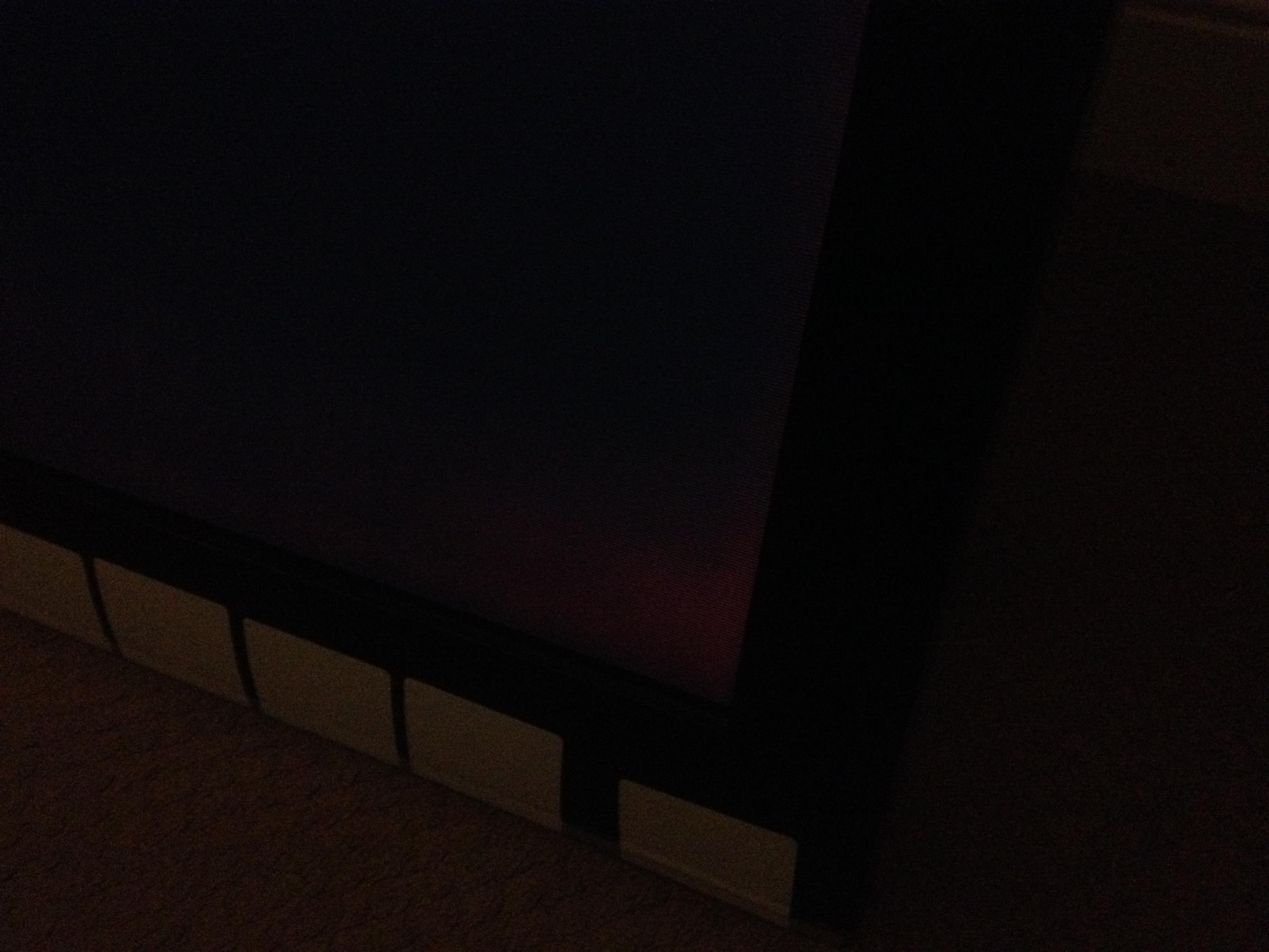

                            #33

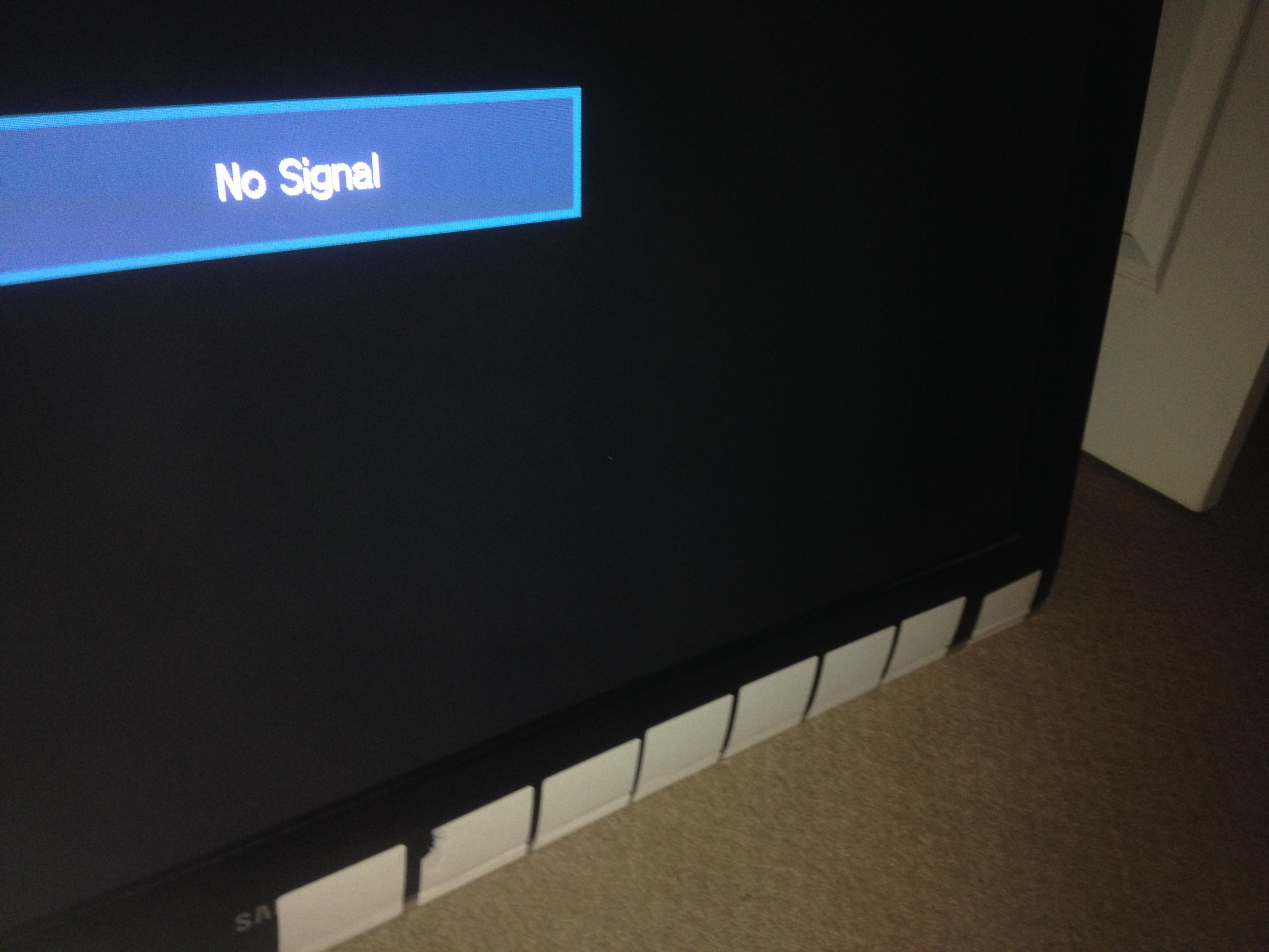

                            sorry was getting it
                            the last pic is where the prob is on the screen each brown connector has 2 ics so its one of the middle 2
                            but i did re seat all the connectors to the y buffer also not sure if that changed it
                              #34
                              Those connectors are bonded to the plasma panel. I thought they were on connectors. Didn't know Samsung did that for A-series 1080p.
                              https://www.badcaps.net/forum/attach...4&d=1388863300
                              Try the blue connector, if not I would have suggested C board replacement but that's a no go as it's bonded like an LCD.

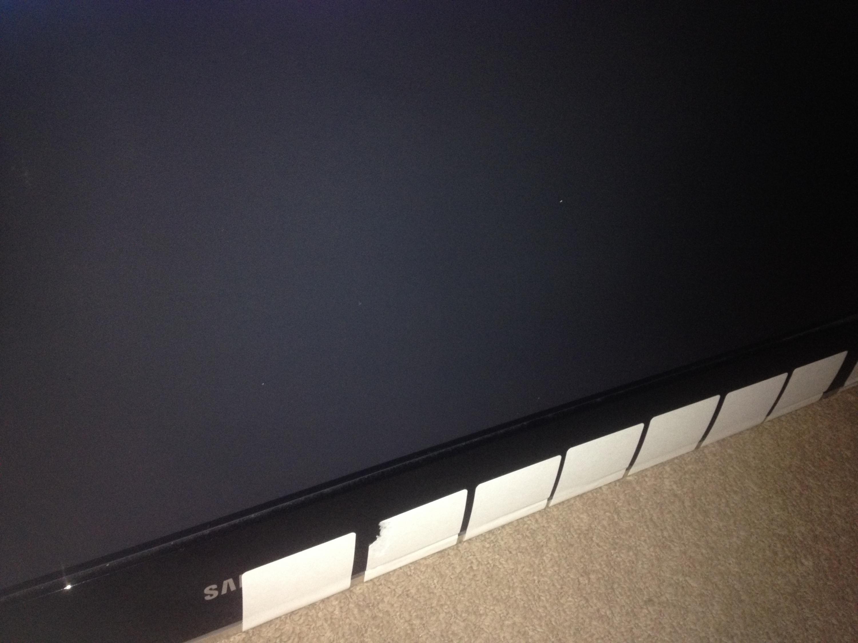

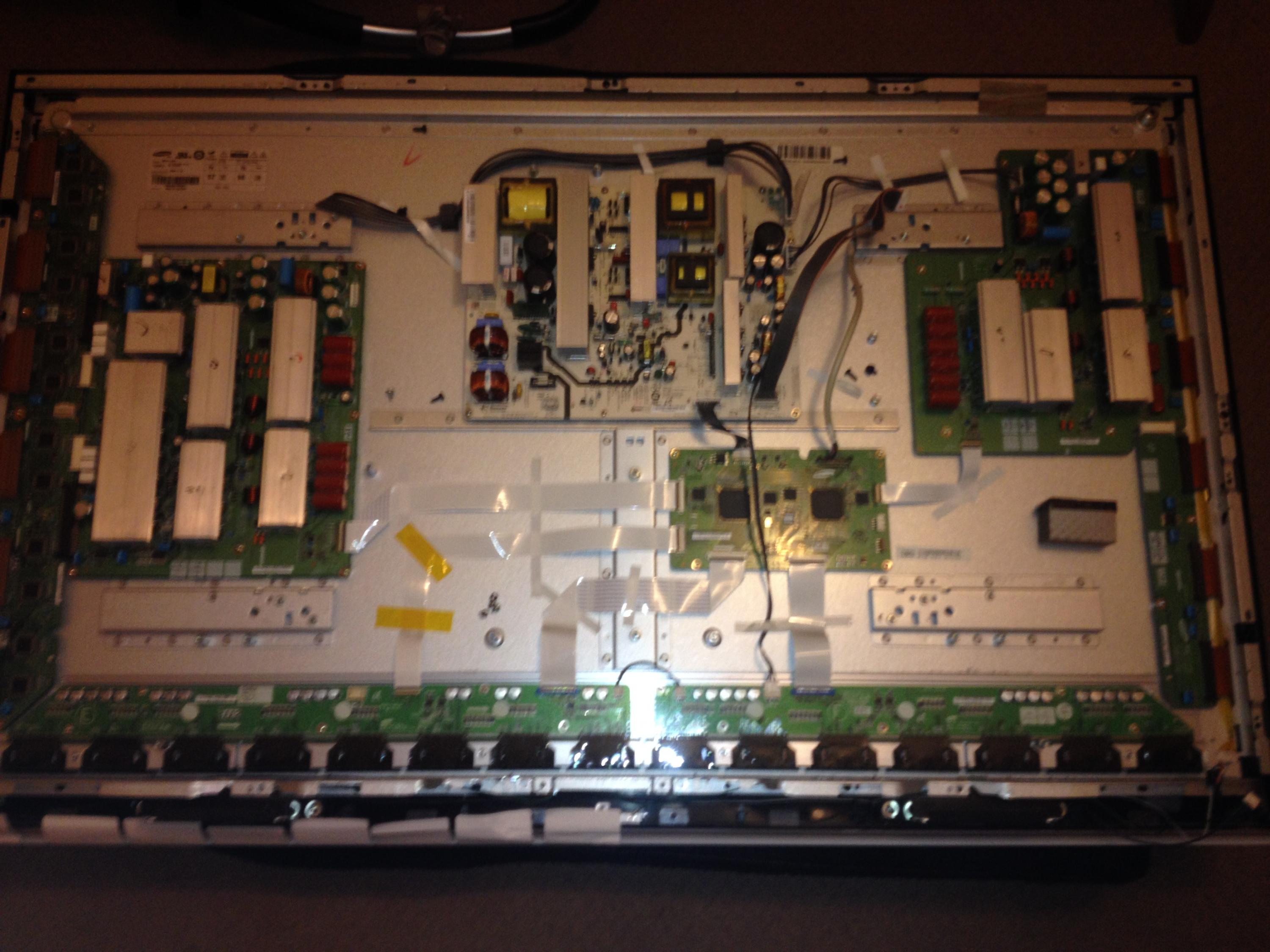

                                  cleaned all again still no change
                                  do you think trying replacing the cable or the control board
                                  attached latest pics

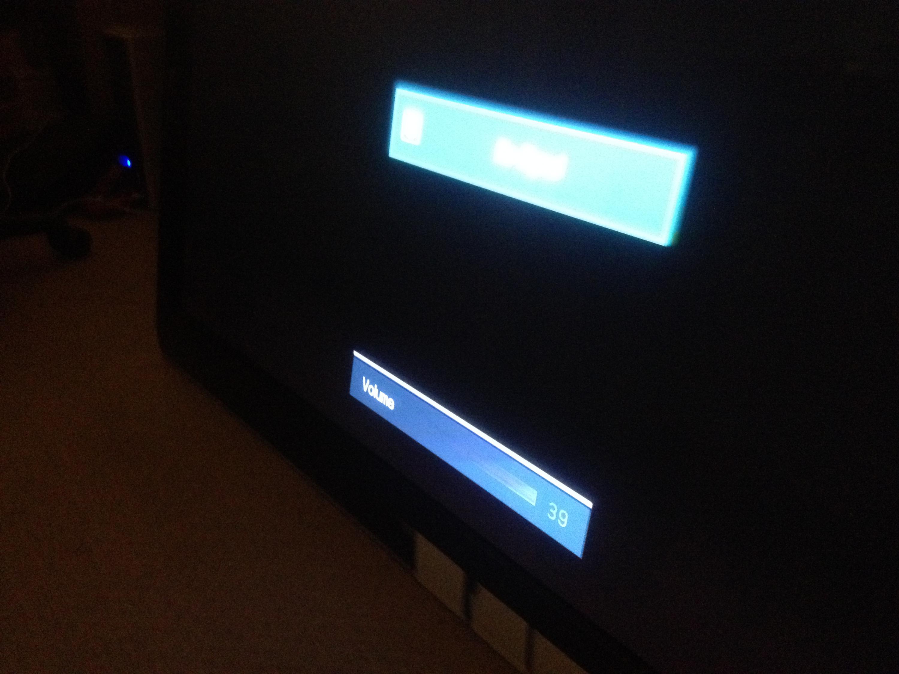

                                        #39

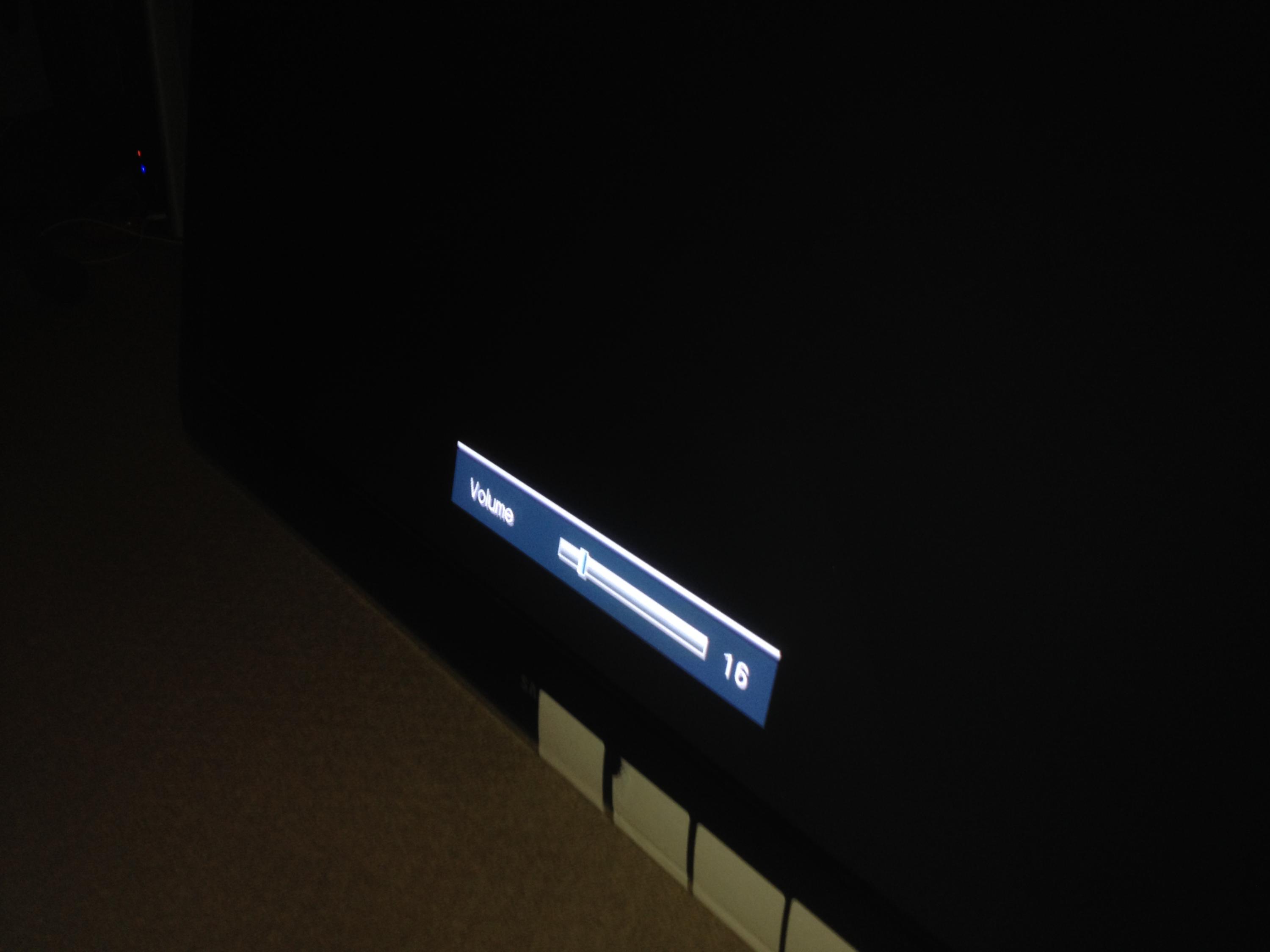

                                        hi All
                                        SUCCESS !!
                                        Git rid of the lines after taking apart many times and cleaning
                                        however it now seems to burn the screen very quickly
                                        Ie if i turn the volume up and the boxes comes up for like 30's when you then change the screen you can still see the box
                                        also has a redish tint around the edges
                                        it does fade (the box not red tingh) but it seems as if the screen isnt wiping clear as quick as it should
                                        now i want ask is this age but i cant say i have seen this before ?
                                        its going to be very hard to get a picture of it, i hope someone knows what i mean and have seen this before
                                        Has it got anything to do with the fact its a 2nd hand PS ?
                                        • noledud
                                          • Dec 2013
                                          • 413
                                          • united kingdom
                                          #40
                                          here are the pics
