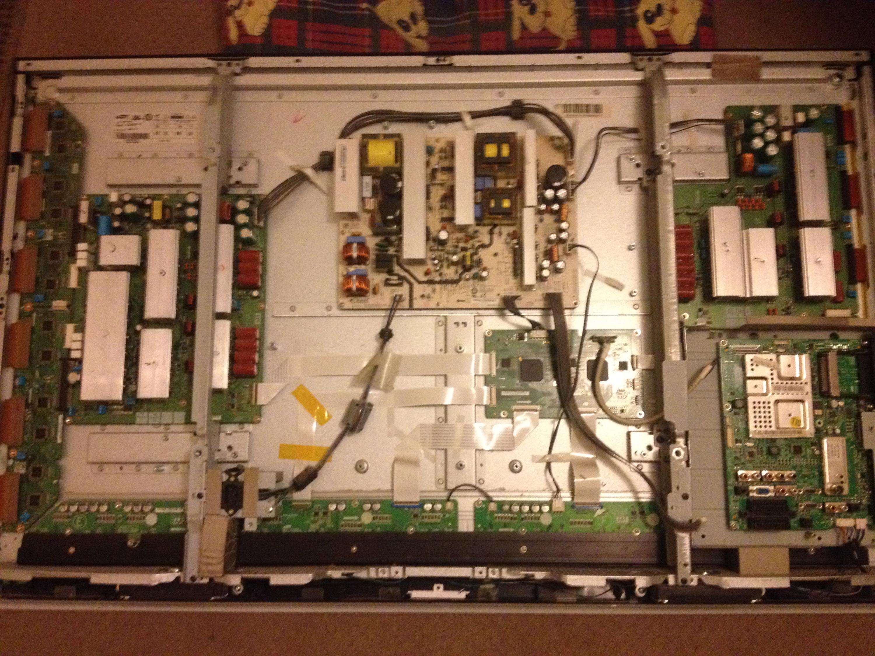

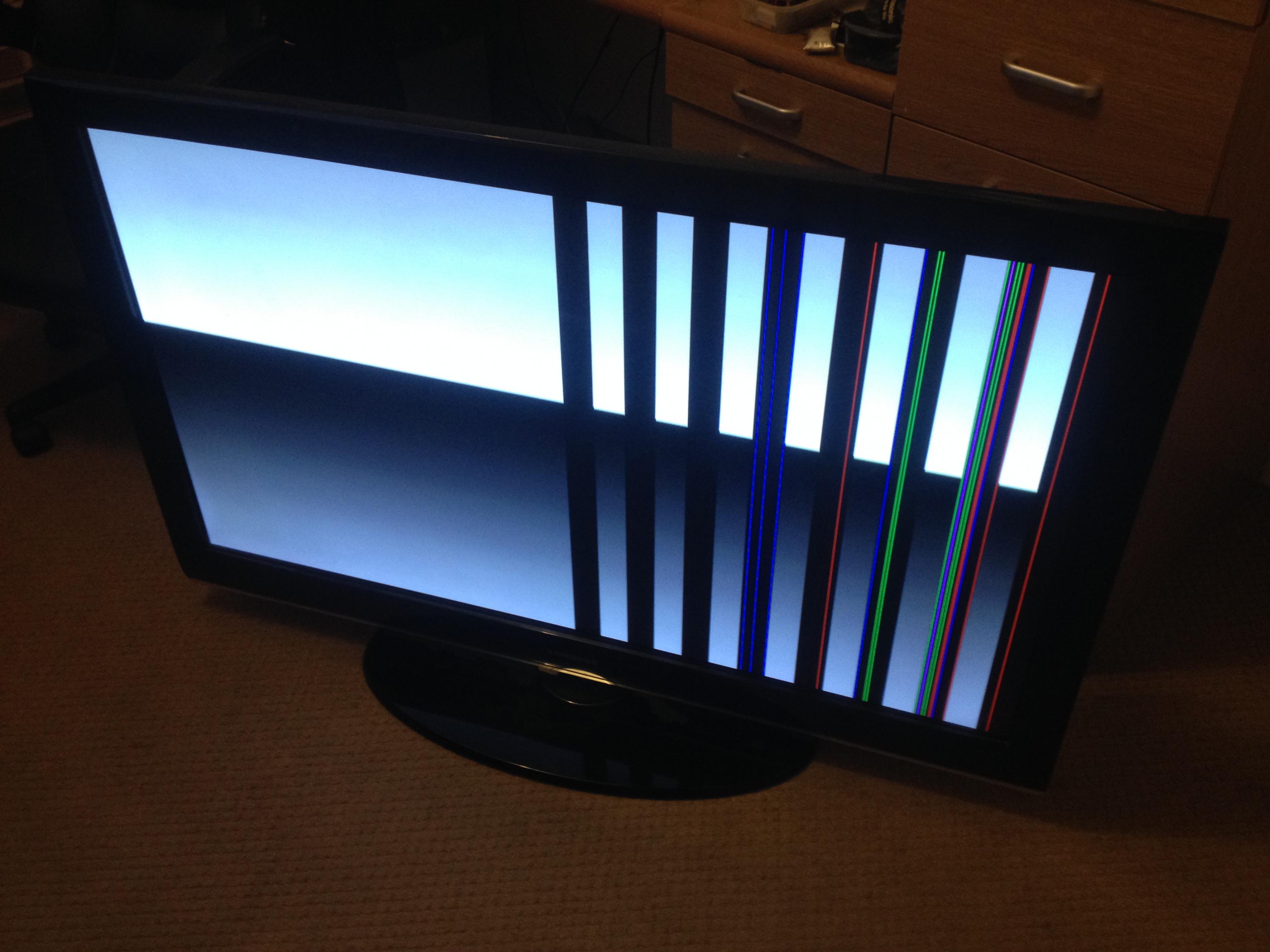

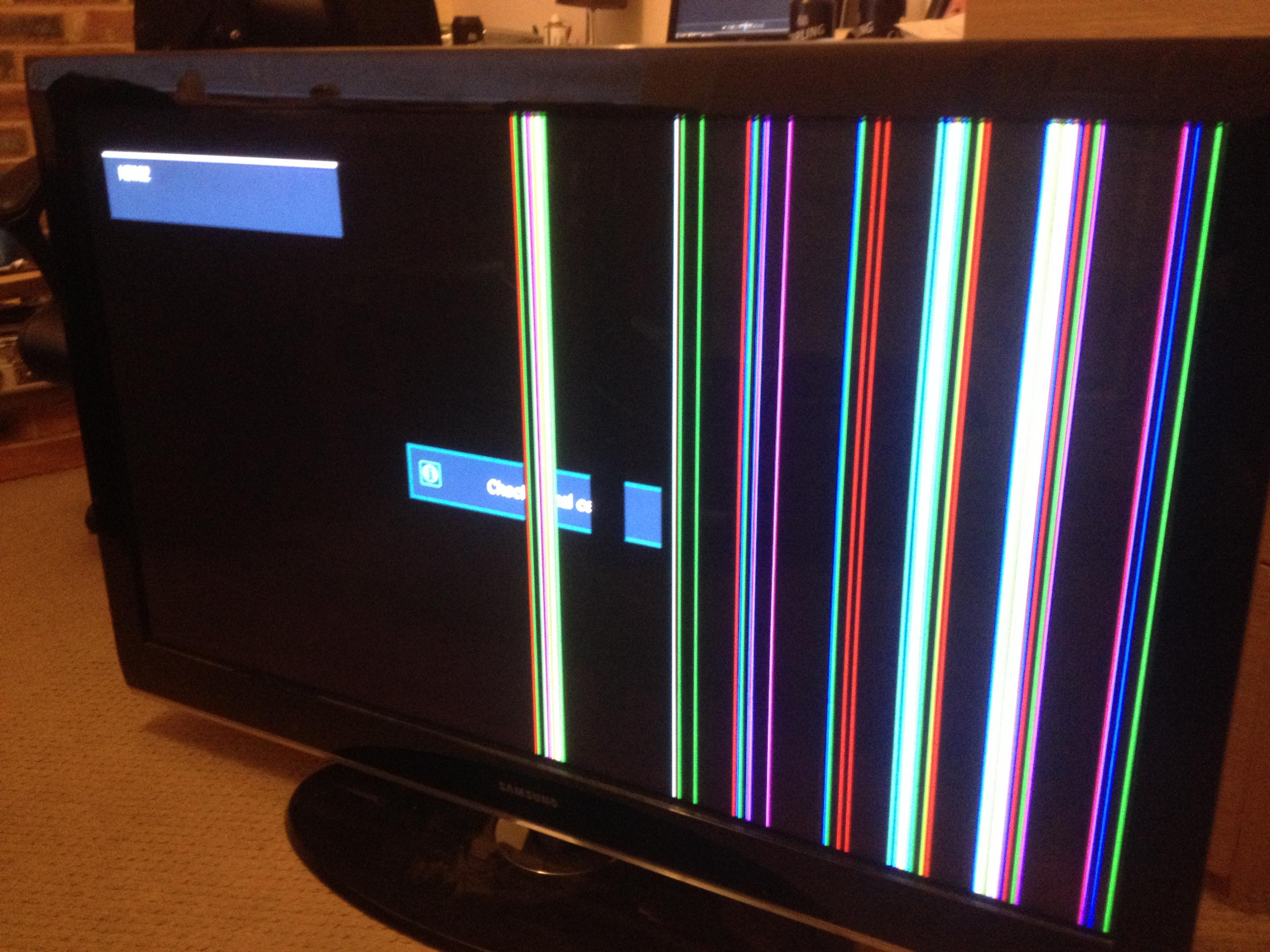

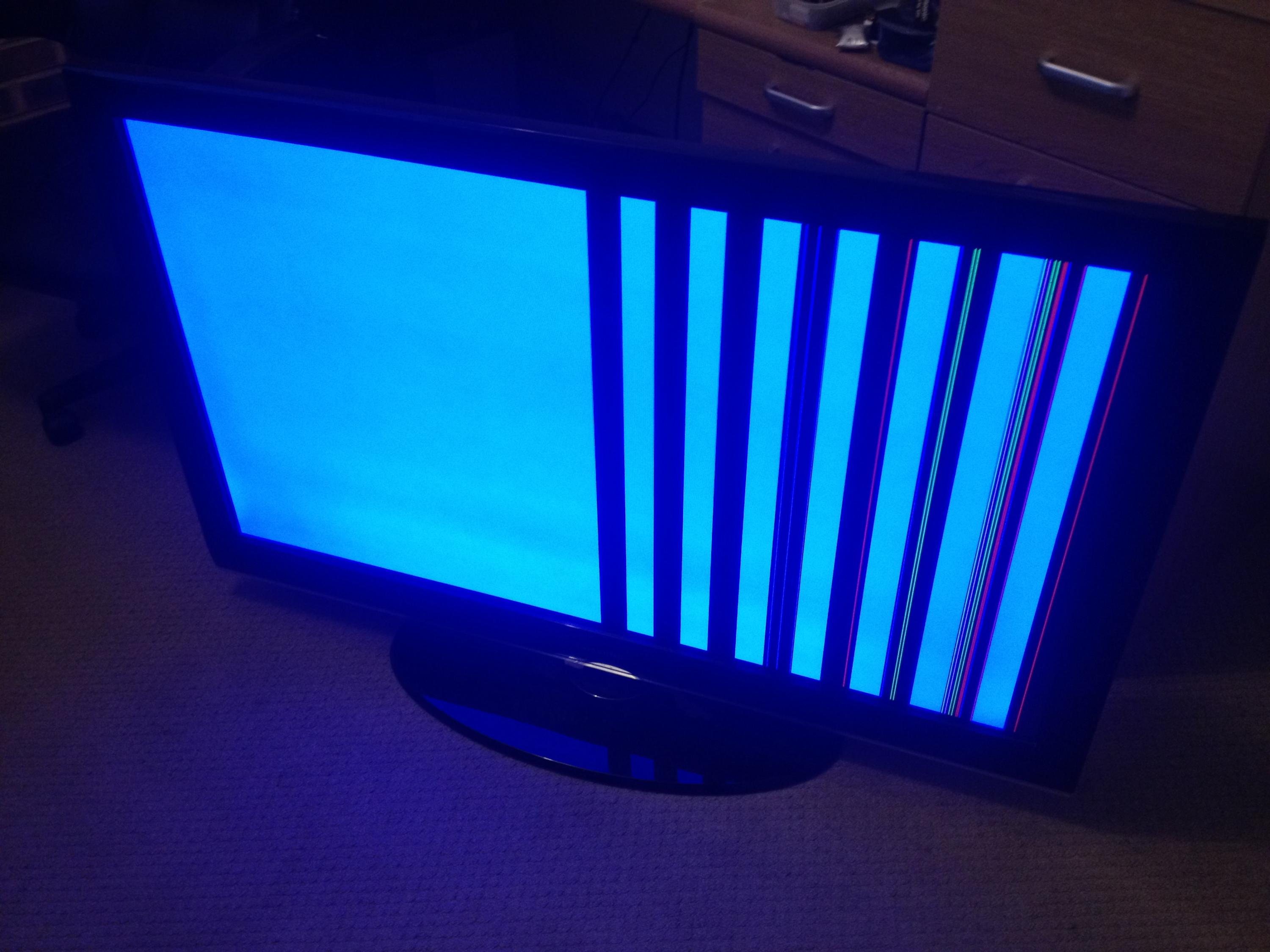

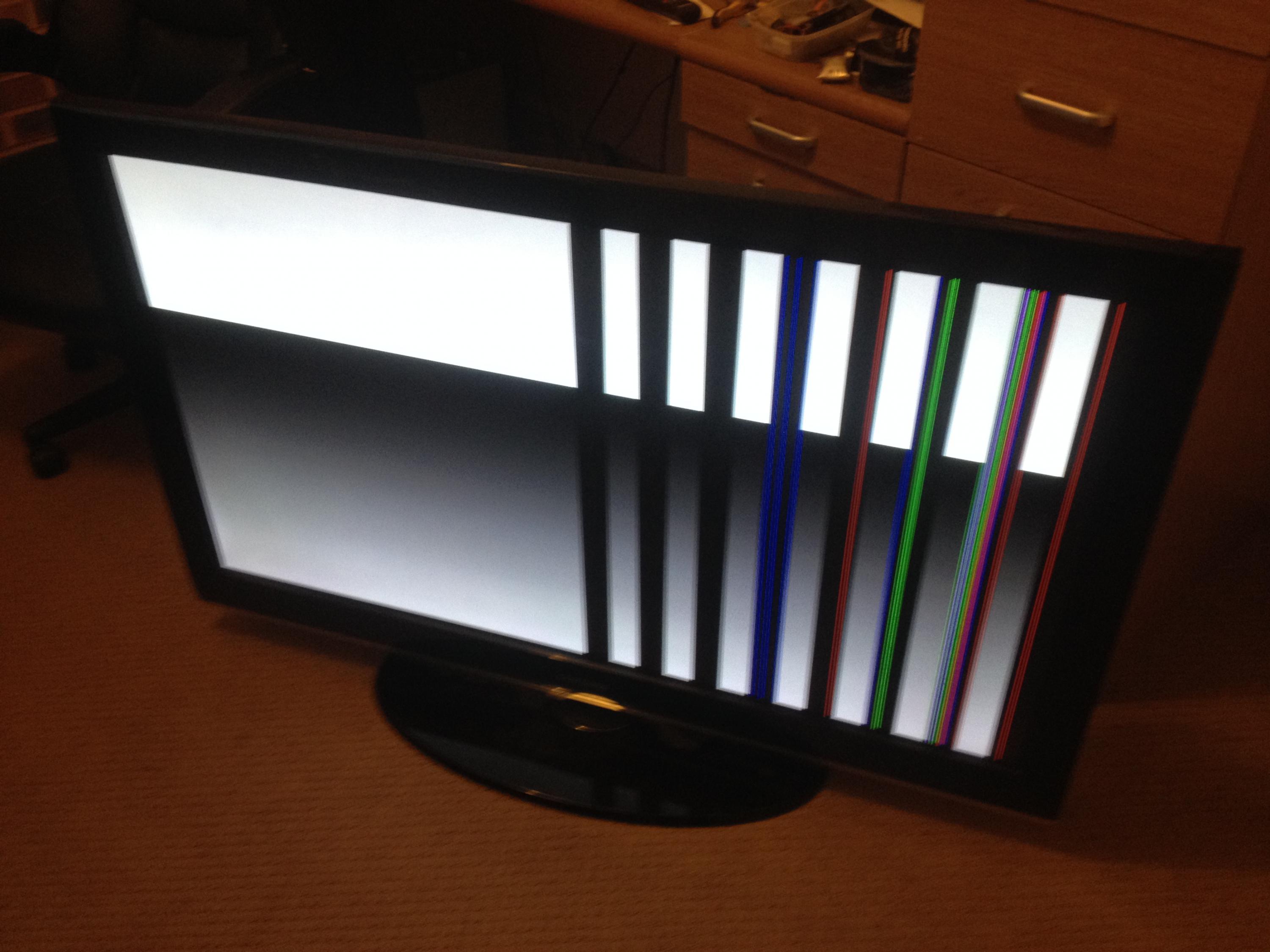

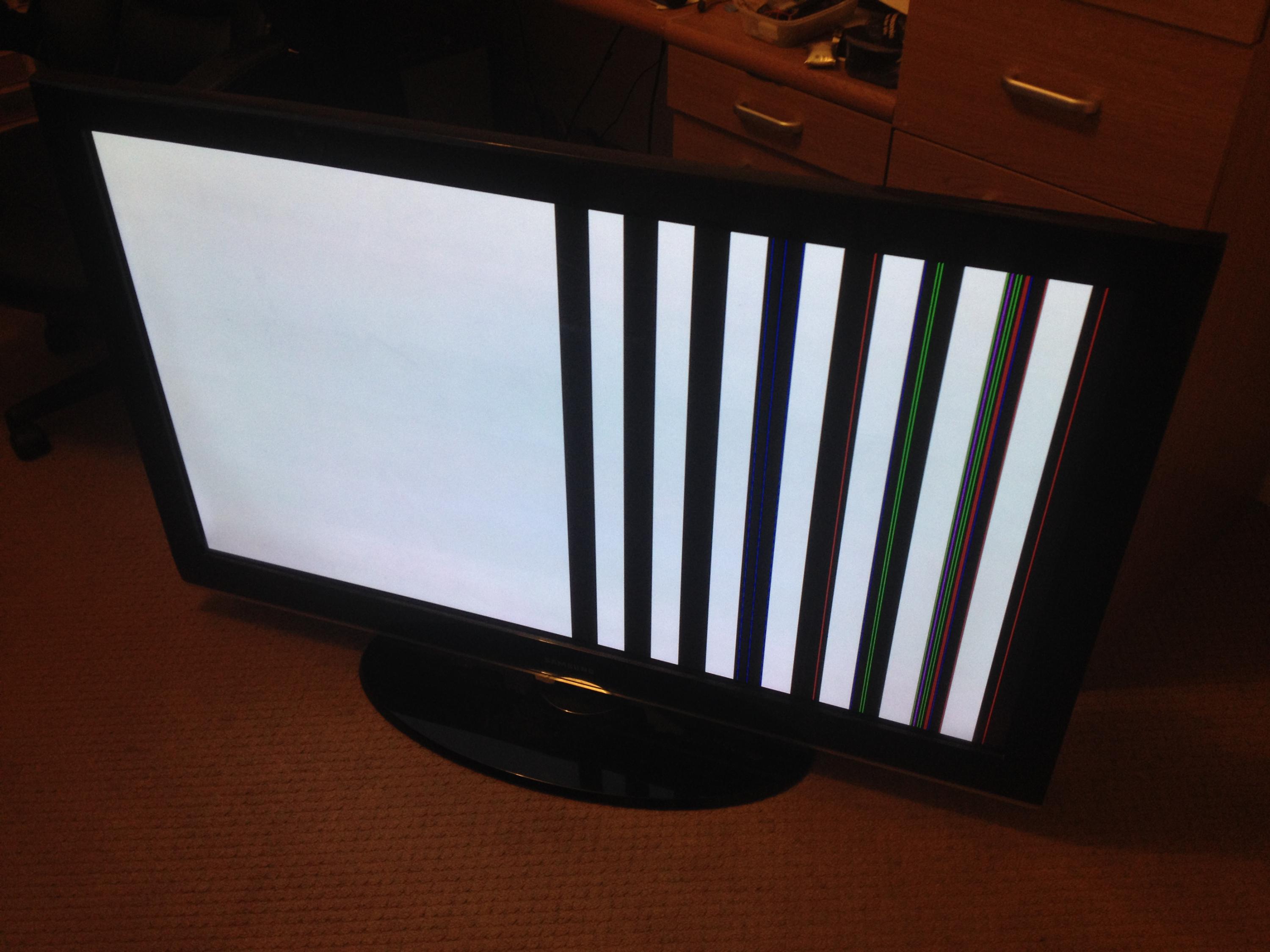

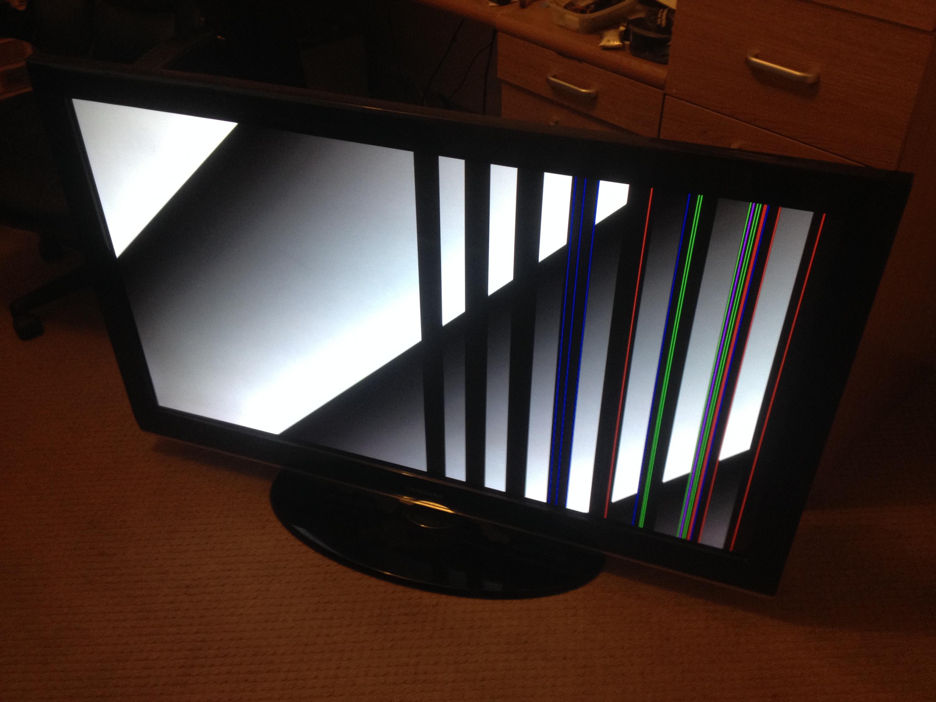

    Hi all i have a 50 inch plasma with vertical lines on one side ( right when facing screen )
    I have added some pics below, can anyone suggest on where i start my trouble shooting ?
    The pics were taken while the panel test was running
    Re: Samsung PS50A557S3F - vertical lines on right hand side
    I'm going to say about 90% that the plasma panel is dead. This is an extremely common issue with A-series Samsung plasmas. Not economical to repair I'm afraid.
    The only saving grace is that there aren't always static lines. They do vary. It's possible, though unlikely, that it is just a control board fault or loose connector. Can you take a video of the fault?

      just fyi information i got the tv with a power fault so i have been diag that so have had connectors off and on etc
      2 bad caps were on the y board and also replaced the ps
      that is now repaired and this is the first i have had the panel powered

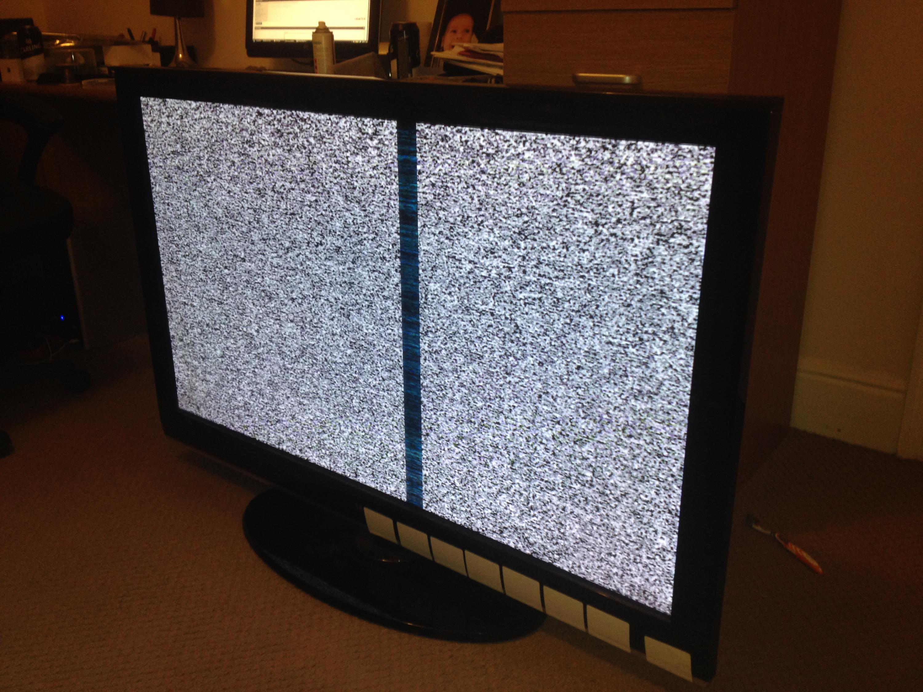

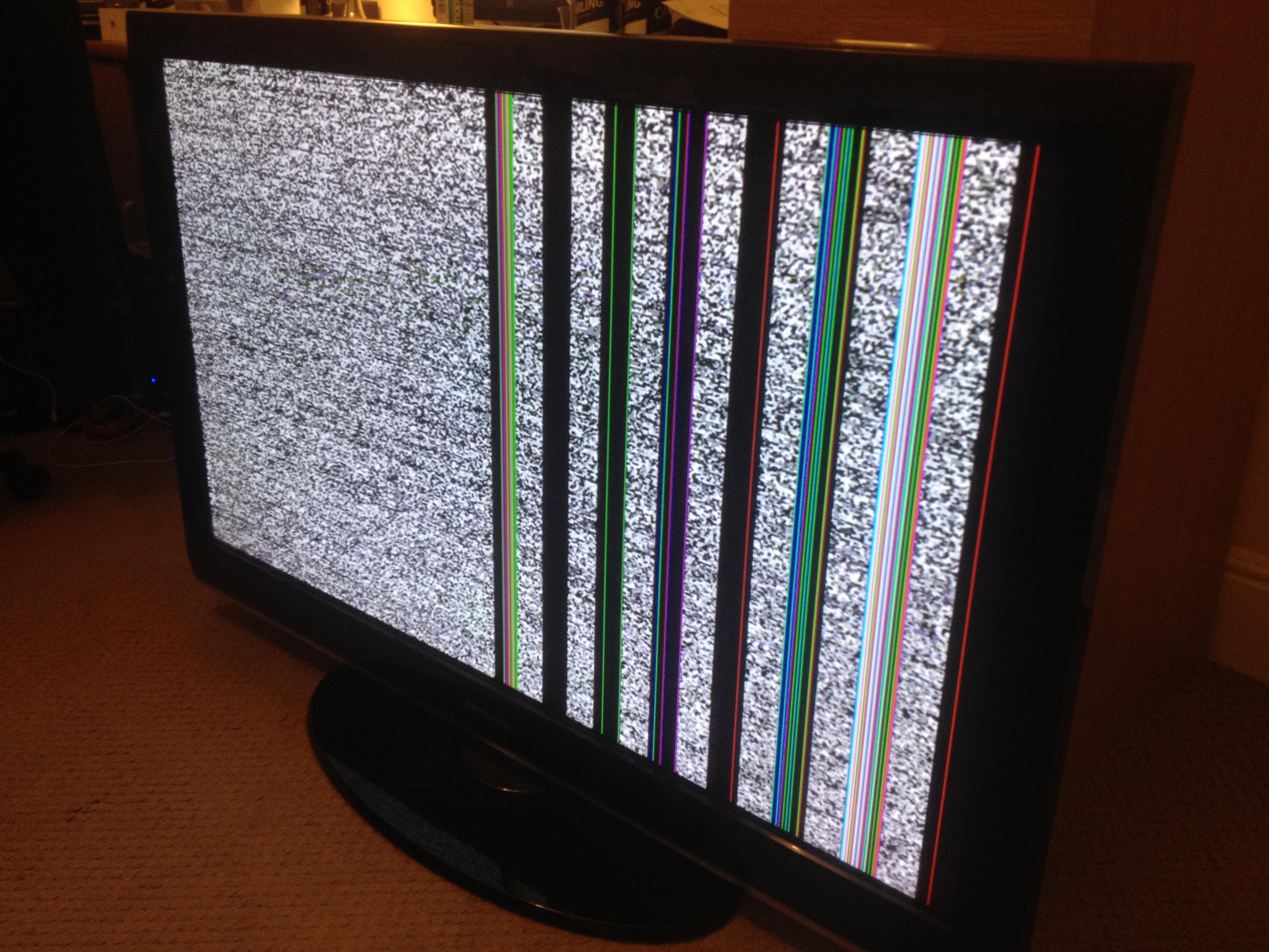

        What's it look like with analog snow or moving input... do the lines ever move? Did you ever plug in or unplug the Y-main or X-main connector while the set had power (may have caused a small spark?)
            hi sorry tom66 you reply only showed after i bumped
            snow is this - see attached pic and video is here
            https://www.dropbox.com/s/nqlsekl1ktb6tpw/IMG_0650.MOV
            no the lines never move
            i have taken the y main and buffer boards out and clean re seated cables etc
            the lines do not move at all i have tried flexing the screen and all cables never changes
            no i didnt ever remove connectors while powered always leave it for a while after power
            but there were 2 caps blown on the y main
              Hmm, yeah, looks like a bad panel to me, sorry! I give control board a very small chance of causing this because the lines do somewhat change but not as I would expect.

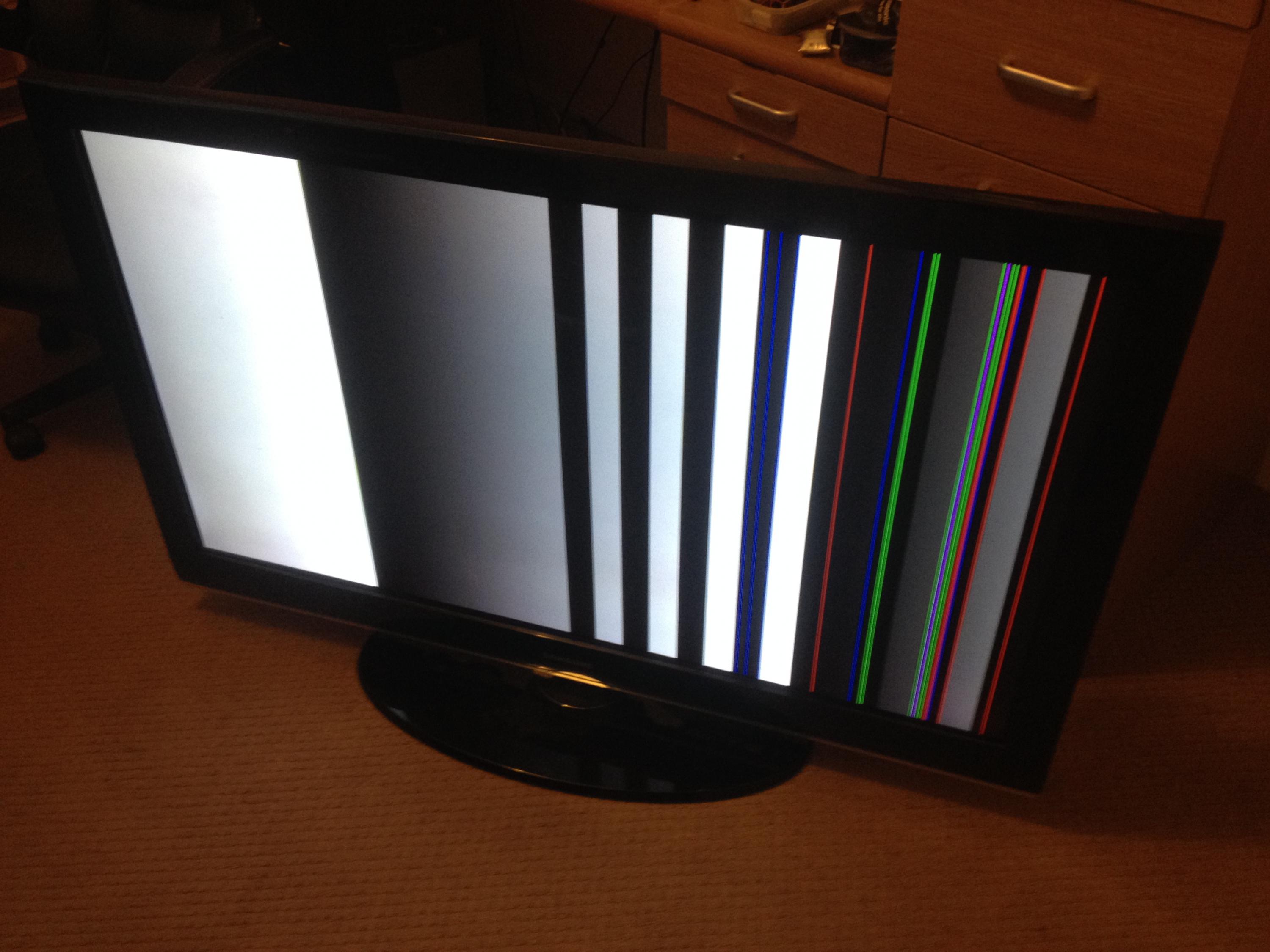

                                  hi tom66 i wanted to grab you befor you went offline
                                  i have striped the y main connectors main board connectors and the bottom pcb connectors
                                  cleaned all with PCB cleaner and re built
                                  i now only have 1 bar that has been moving
                                  pics to follow in a min my batt went and wanted to grab you before you went
                                    You could have got lucky, just a loose connector.....
                                    • noledud
                                      • Dec 2013
                                      • 413
                                      • united kingdom
                                      this is the video you can see the static behind the vertical bar
                                      https://www.dropbox.com/s/cmspd569xmmist0/IMG_0663.MOV
                                      and i have attached the pic
                                      as you can see its much better
                                      where do you think i concentrate my efforts as i cleaned a lot of connectors then i want to try and narrow it down
                                        That line looks like a loose connector now, a lot more like what I would expected. That is very strange but lucky. Just make sure it's all seated properly and it should work.
