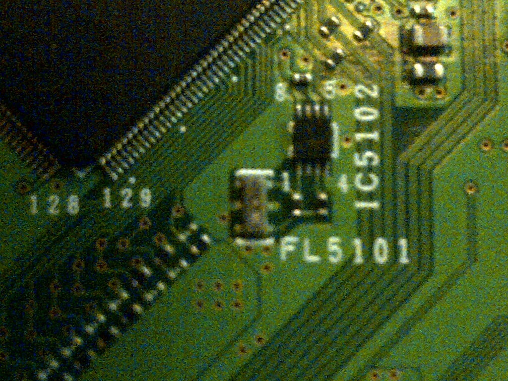

    I acquired another broken tv to repair. I have been reading the posts about different Sharp tv's with this code and all seem to be the main board. Code is: Initial communication from the main CPU is not received. (After canceling the reset, request for the monitor model No. is not received.) → Communication line failure or main CPU start-up failure. But I want to see if I can fix the main board. I was wondering, on the main board, there is a part called a filter FL5101 according to the service manual. It's metering wide open. I'm wondering if this is Sharp's idea of a fuse? Any thoughts?

    Picture of this FL5101?

      I took the pic with my phone. Let me get my camera and take another one.
      EDIT: My camera is worse. Hopefully this pic is enough.
      It looks like a smd type fuse.

                FL5101 = RFILC0132GEZZ is a filter

                  I saw the filter info in the service manual. I thought it might have been like a fuse. It's metering wide open. I guess that's how it's supposed to meter. Anyways here is the link to the manual I downloaded.
