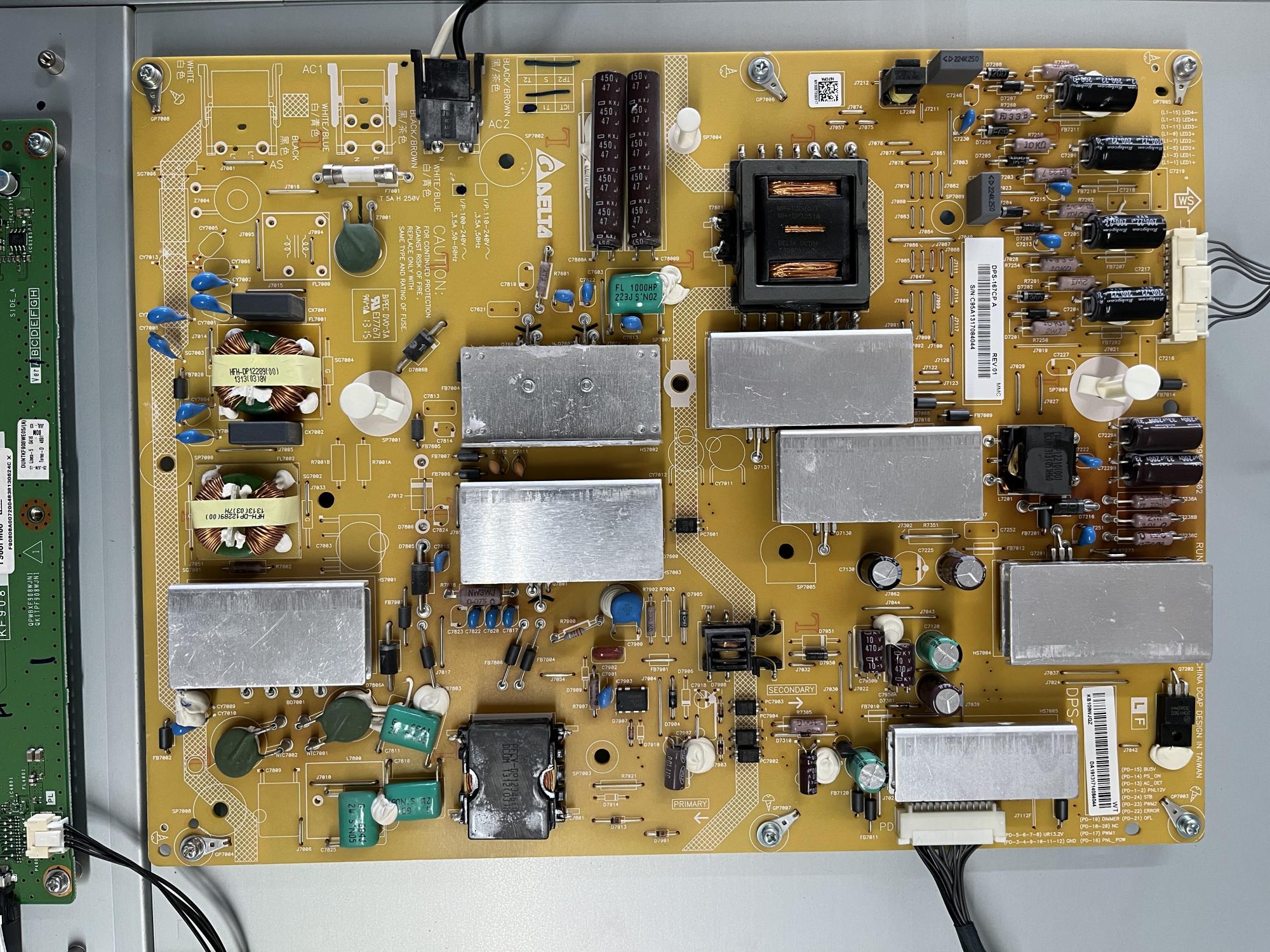

    Sharp LC-60LE550U Mainboard F905FM06 DUNTKF905WE06TV Main board keeps dying
    What would cause a main board to die when you disconnect AC power to the TV?
    This is the second board that it has happened with. All I am doing is disconnecting the power cord from the wall and plugging it back in.
    I replaced the main board because I was not getting a signal on PS_ON when pressing the power button. The PSU was/is still sending its 5v standby signal

        The firmware could have crashed, if Hdmi sources were connected, then the controller (processor) could have suffered.

          When I plug in power the front panel light turns on for less than a second and then turns off. Would bad firmware cause this symptom?

            Re: TV Main board keeps dying
            Yes, there may be a problem with the firmware.
            But first, check all the supply voltages on the DC / DC converters.
                surge from power supply would do it
                  How often do you see a PWB cause a surge only when power is removed?
                  I uploaded the service manual and an image of the PWB if for whomever needed it. TCON and Main board pics and schematics are in the manual so I didnt add them. PWB wasnt in the manual.
                    edit: I reconnected the supply and have all voltages now
