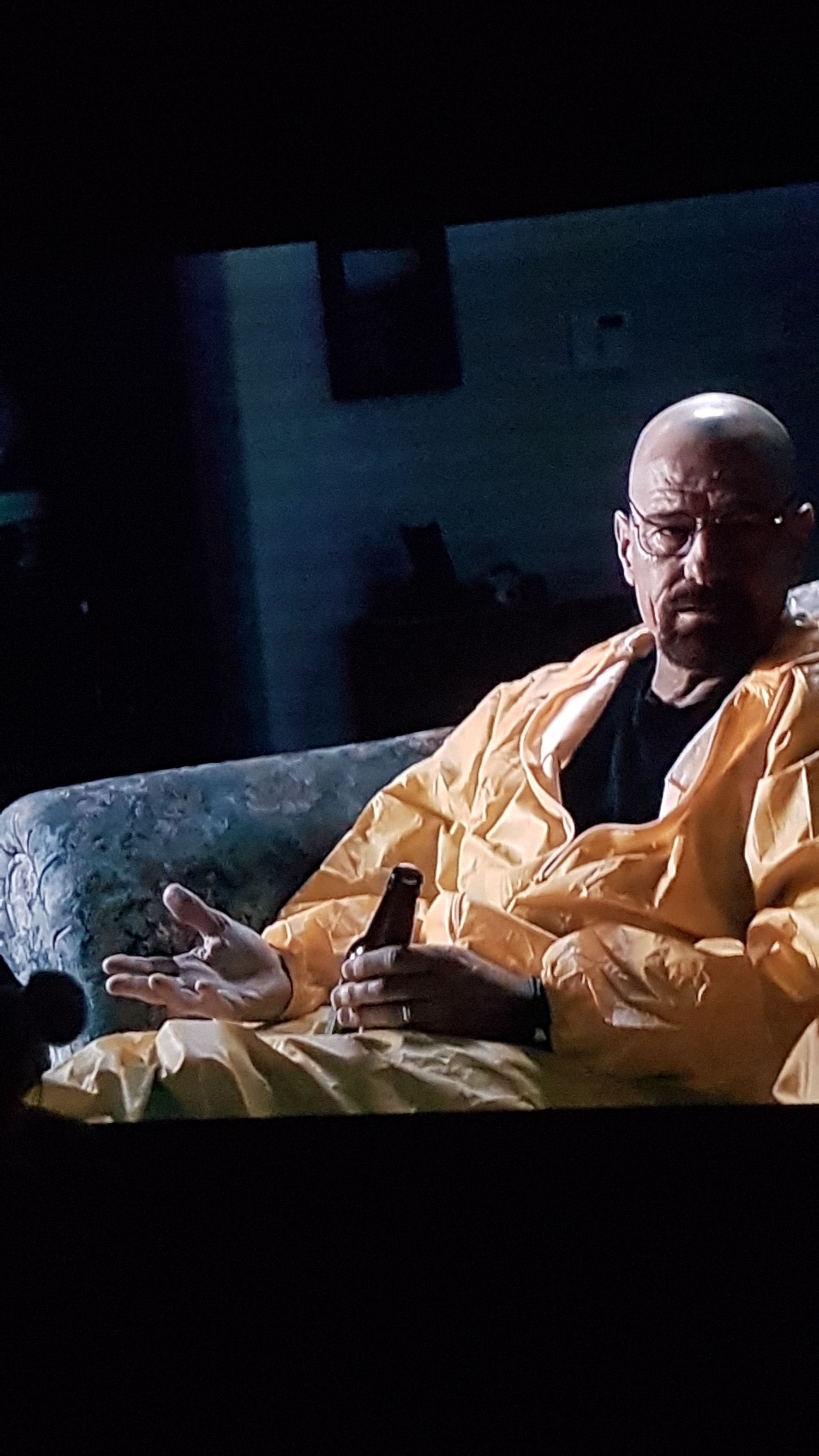

    Has anyone experienced this? Translucent streaks appear in the photo you can see them. They appear and disappear. Sometimes it's always streaks, sometimes it's not. If you put your finger in the area of the t-con chip, the stripes begin to appear and disappear every second. T-con to replace?

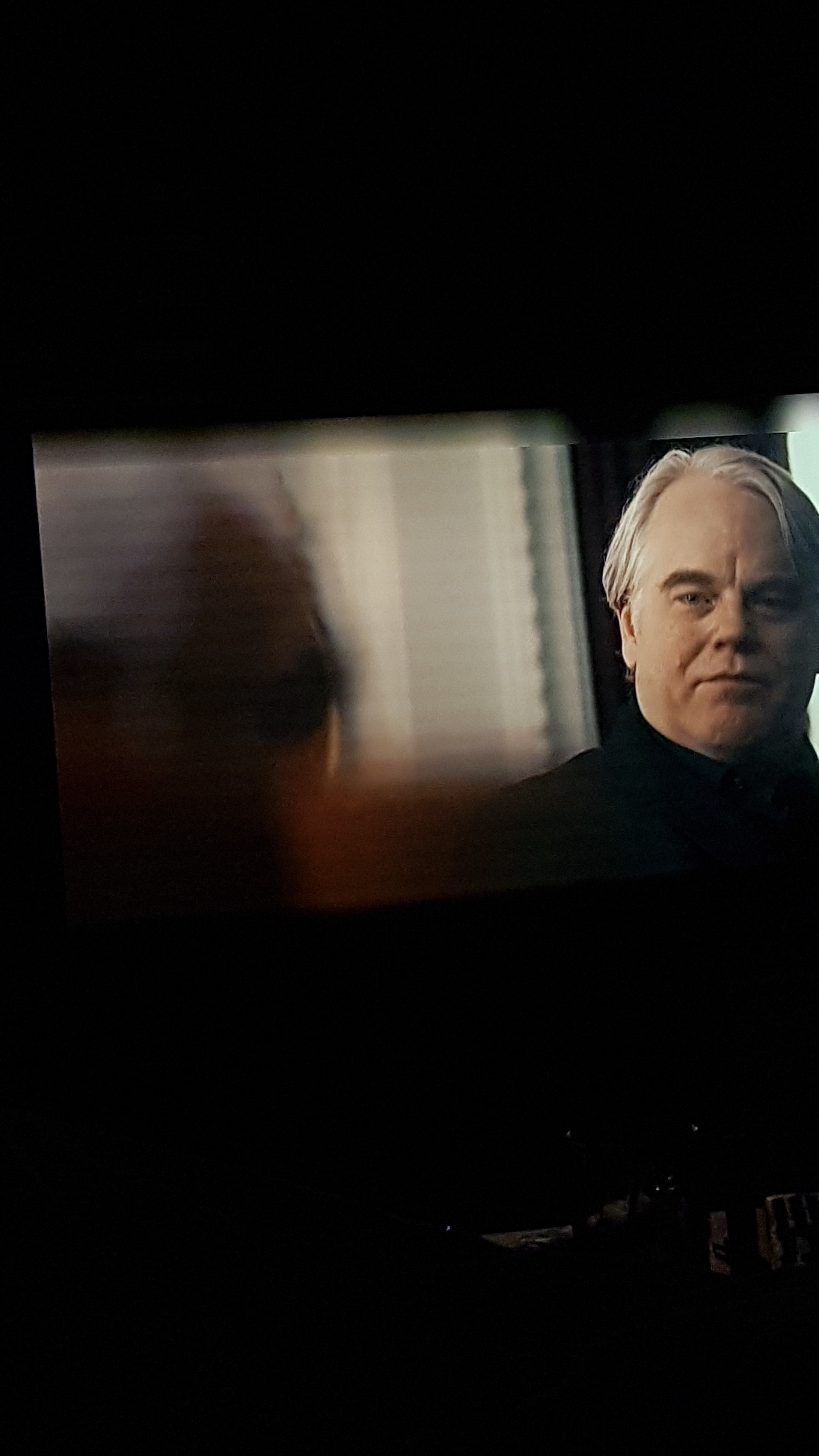

            It doesn't matter how you hold the phone. Stripes are everywhere, there are none on a white background. It seems that the light stripes are just a slight increase in brightness. Lately they have been almost constant. There are no problems with cables. I also tried changing the capacitors on the power supply, nothing changed.
            Here's another photo
              i cant notice the lines.. but from yours description they are NOISE .. 2 reason could be
              1- the signal source if its from Areal or Wall cable.. ( connect the TV with HDMI video source to see if the line remain ) if they remain.. then
              2_ T-CON problem
                I already wrote the cables are normal. There are also stripes in the TV menu. And the photo clearly shows horizontal alternating stripes

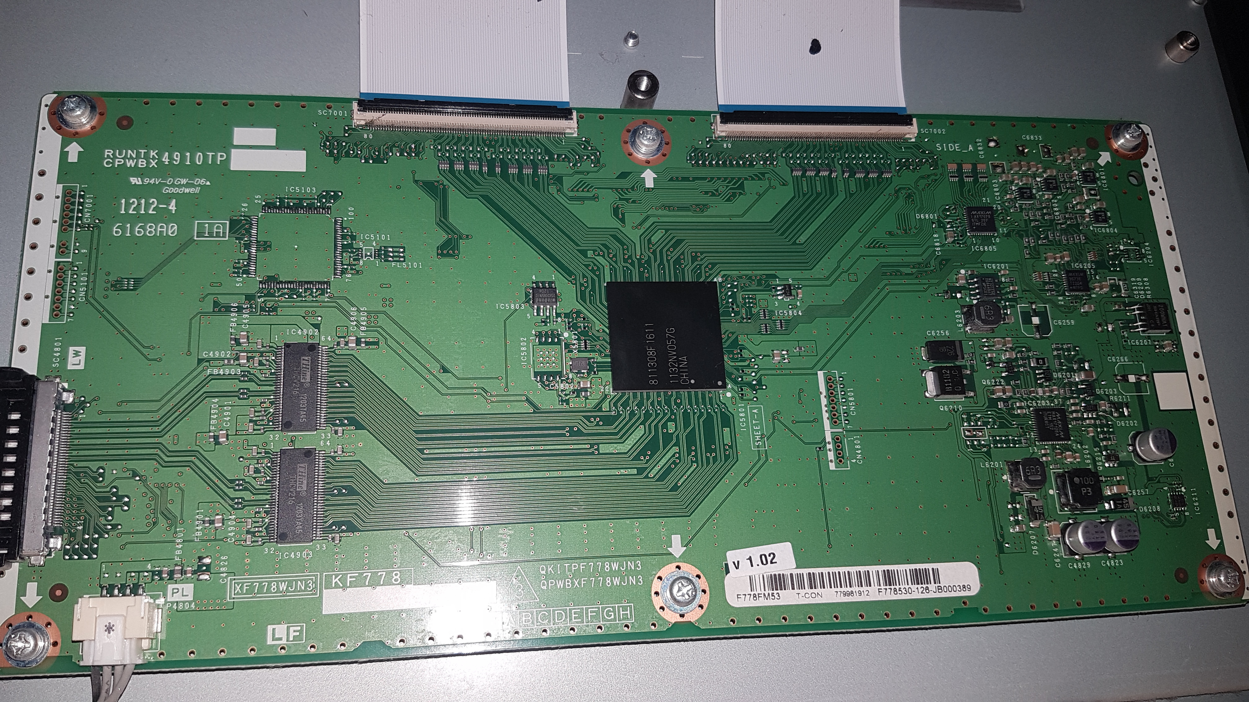

                          i wrote in my post #7 t-con problem of this noise -- why don't show us here yours original t-con to see the main CHIPs and its Gama chip
                            Runtk4910tp
                              I already told you about the tcon electrolytics, are you reading well what i write? The tv speakers could be a tester to catch ambient disturbations eventually.. traces of alternate voltage..

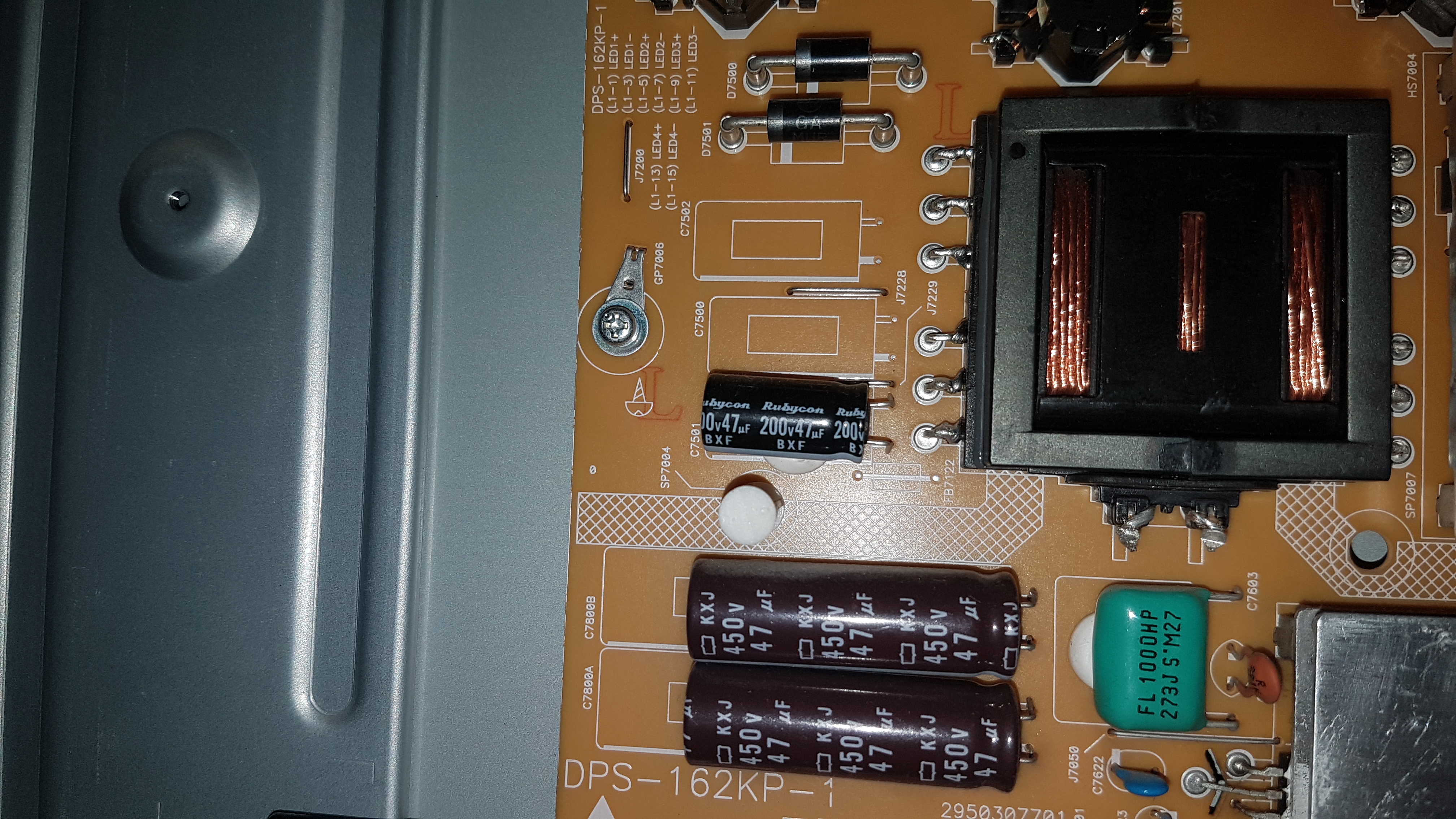

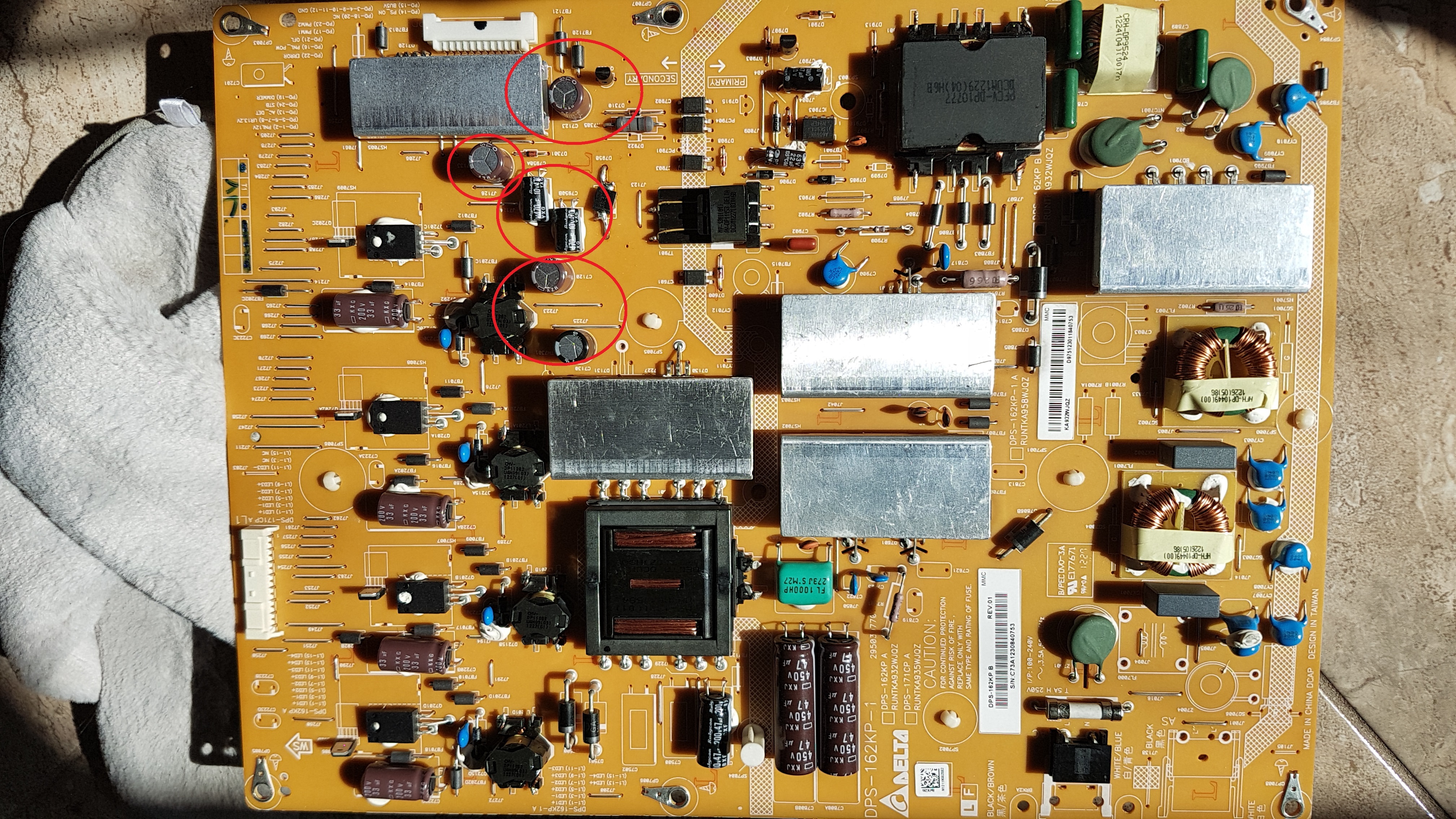

                              you tell me about electrolytics you changed, i know, i'm not dazed, i am speaking about those on the input filter, do you know? Do you have any experience in electronics? I mean polyester square types.. post a picture of power board eventually..
                                Originally posted by romasik View Post
                                Runtk4910tp
                                T_CON with out Metal Shield cover the chips !!!!???
                                  Yes, this is how it is installed in this model. the main board is covered with an iron shield .

                                    Power supply board, full image i post later, not have in my phone.
                                      This caps i try resolder, but nothing change

                                        its T-CON issue.... packing it or try to find replacement
