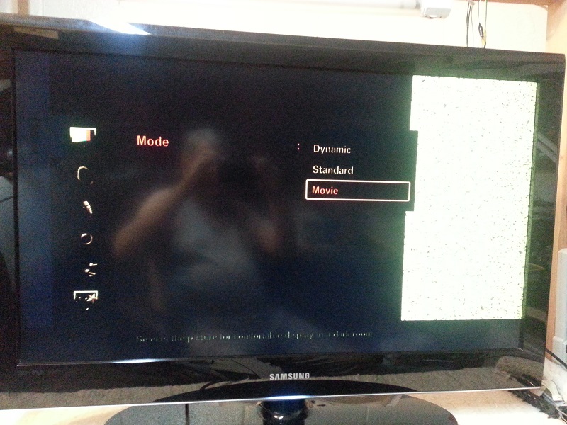

    Somebody is selling a TV (Samsung LN37A550) and he is claiming that the TV was left paused and they realized that after two days and now the screen is bunt in.
    Is this possible with today's LCD TVs?

                Here is the person's ad:
                The picture has a slight shadow and the colors are off.

                  color saturation issues won't be attributed to a burned panel, that looks more like a tcon problem or a main board issue if it is a ti con problem it could be the gamma IC or its a main board issue it could be just a problem in the board itself
                    Re: Burn in question
                    That is most likely AUO gamma chip AS15F fault, or VGL/VGH are poor.

                        So I picked it up.
                        It shows as in that picture mostly red. Other colors seem fine.
                        I can see the previous screen words from the menu for a while. To me it doesn't seem like it's a burn in issue. More like a slow refresh issue.
                        I have done a factory reset, changed settings in the screen size/model section, LVDS output, without any result.
                        I'm guessing that I will have to replace the AS15F chip on the T-con board.

                                  I have replaced the AS15F chip, twice. It seems, like the first time didn't go well, so I had to remove it and re-install it.
                                  Second time it worked, but it didn't fix the red tint. It's the same as before.
                                  I may have damaged the chip the first time or there is a mainboard issue?
                                  • tibimakai
                                    • Jan 2012
                                    • 3680
                                    Here are some picture with the screen as of now, after replacing the gamma chip, it was the same before.
                                    If I select Dynamic the screen brightens up, if I chose Movie mode, it becomes dark.
                                    Before I did a factory reset, the background on the menu it was red.
                                    The EDID should be on or off? It was off and all the positions were saying Failed. I have refreshed those settings and they turned on Successful.
                                    After this,the menu background became black.
                                    I have tried switching the screen size and model number, but the present one shows the best picture. Switched the LVDS setting, but became worse.
                                    Boards are rare and expensive. T-con is $85 on Ebay, same goes for a main board.
                                    Any ideas?

                                      Did you do voltage checks before replacing it, as instructed elsewhere? That will tell you if AS15 is bad, or if another fault exists.

                                        The voltages were all over. In some spots were dropping, but then went up and down again.
                                        I haven't checked that now, good point. I will do that tomorrow.
